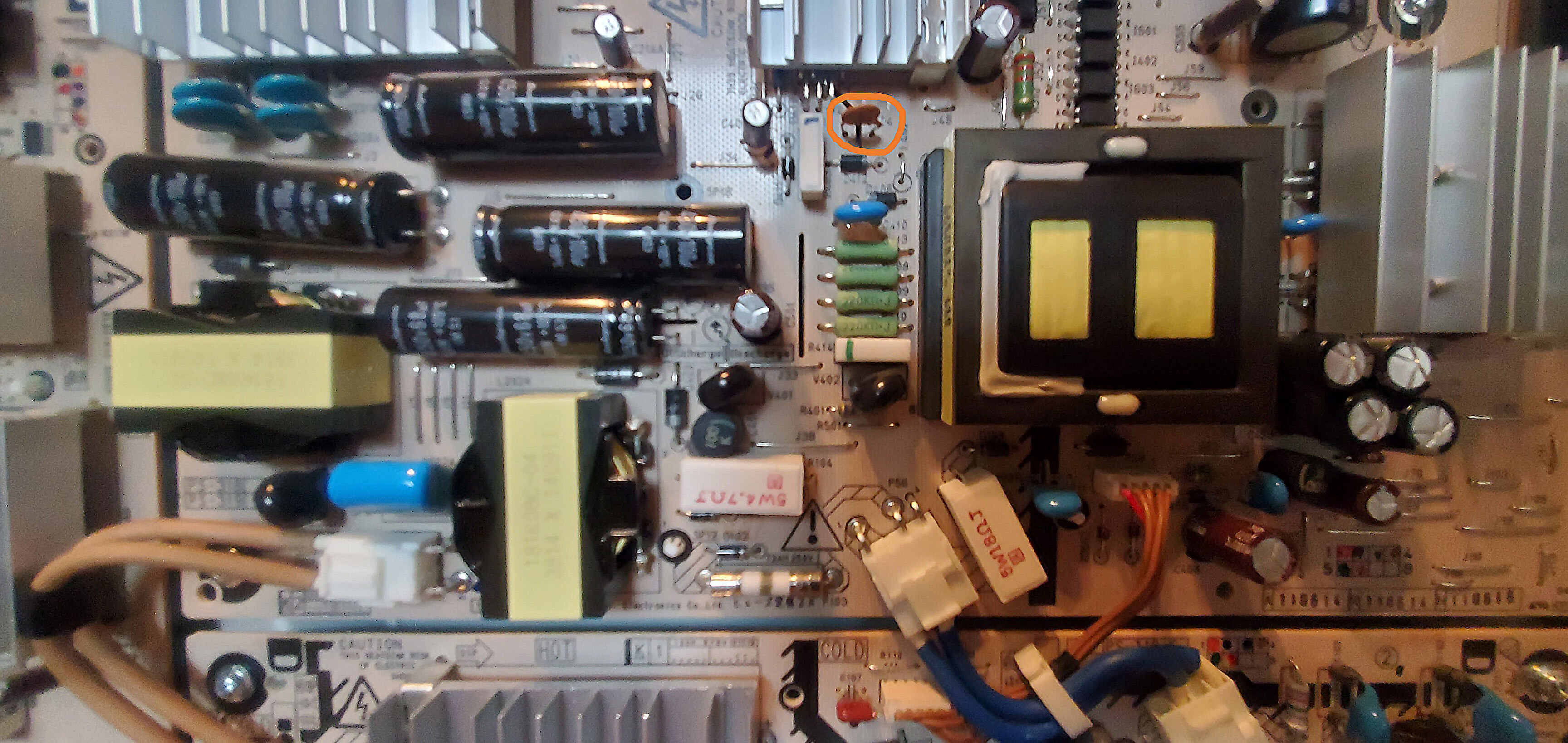

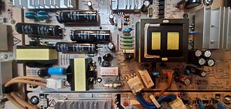

    Hi All,
    Wanting to learn some electronics repair skills.
    I found a non working Panasonic TC-P60S30 and this is my first project / attempt.
    So far I have found a blown cap on the main power supply board.
    After replacing it there's still no standby power.
    Poked around and found a resistor on the PSUB power supply board that measures open.
    An online resistor calculator shows this is a 93k ohm resister.
    My questions:
    Is that correct, 93k ohms?
    Is it a fusible resistor?
    Lastly, how do I know what wattage?

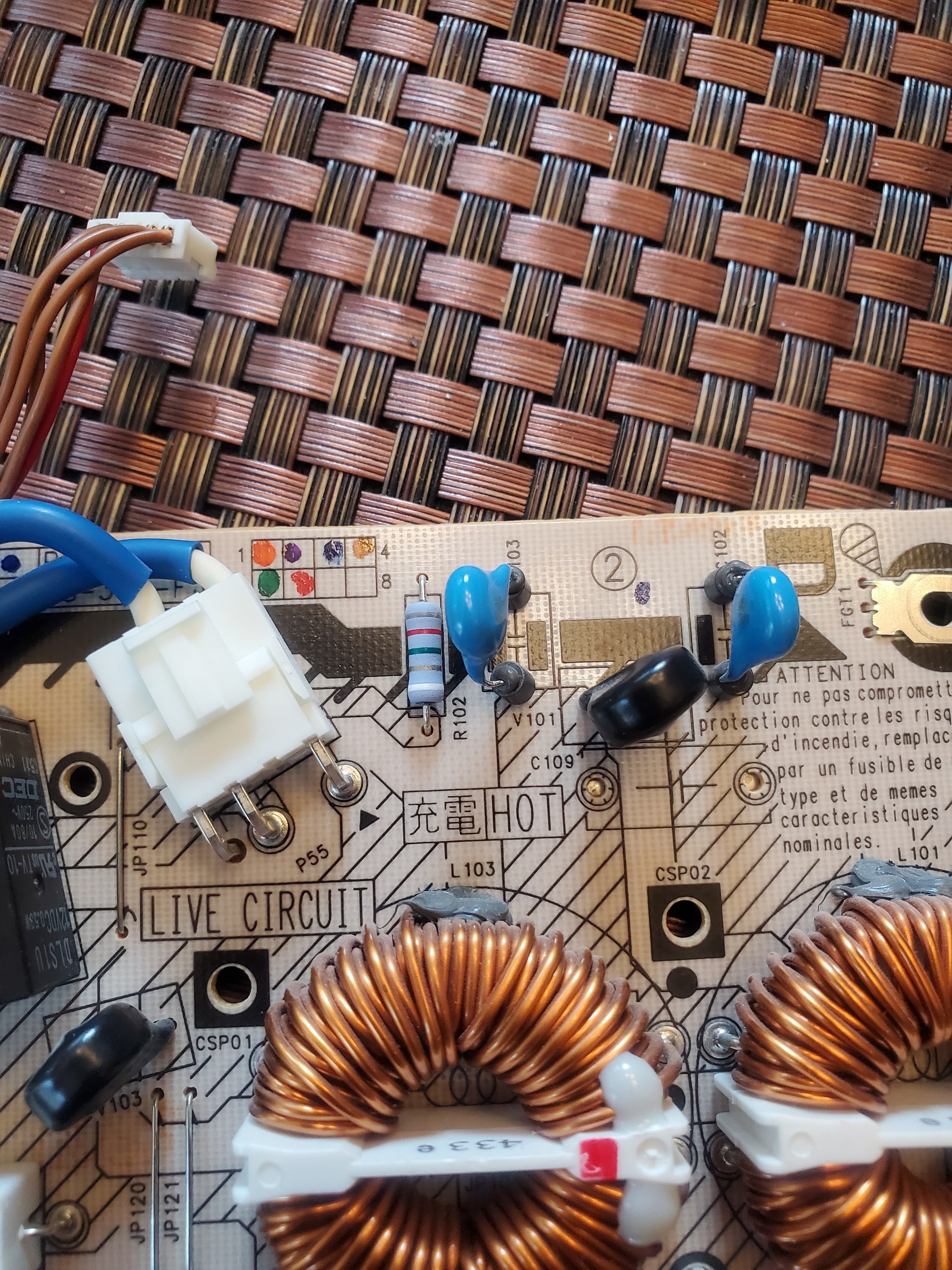

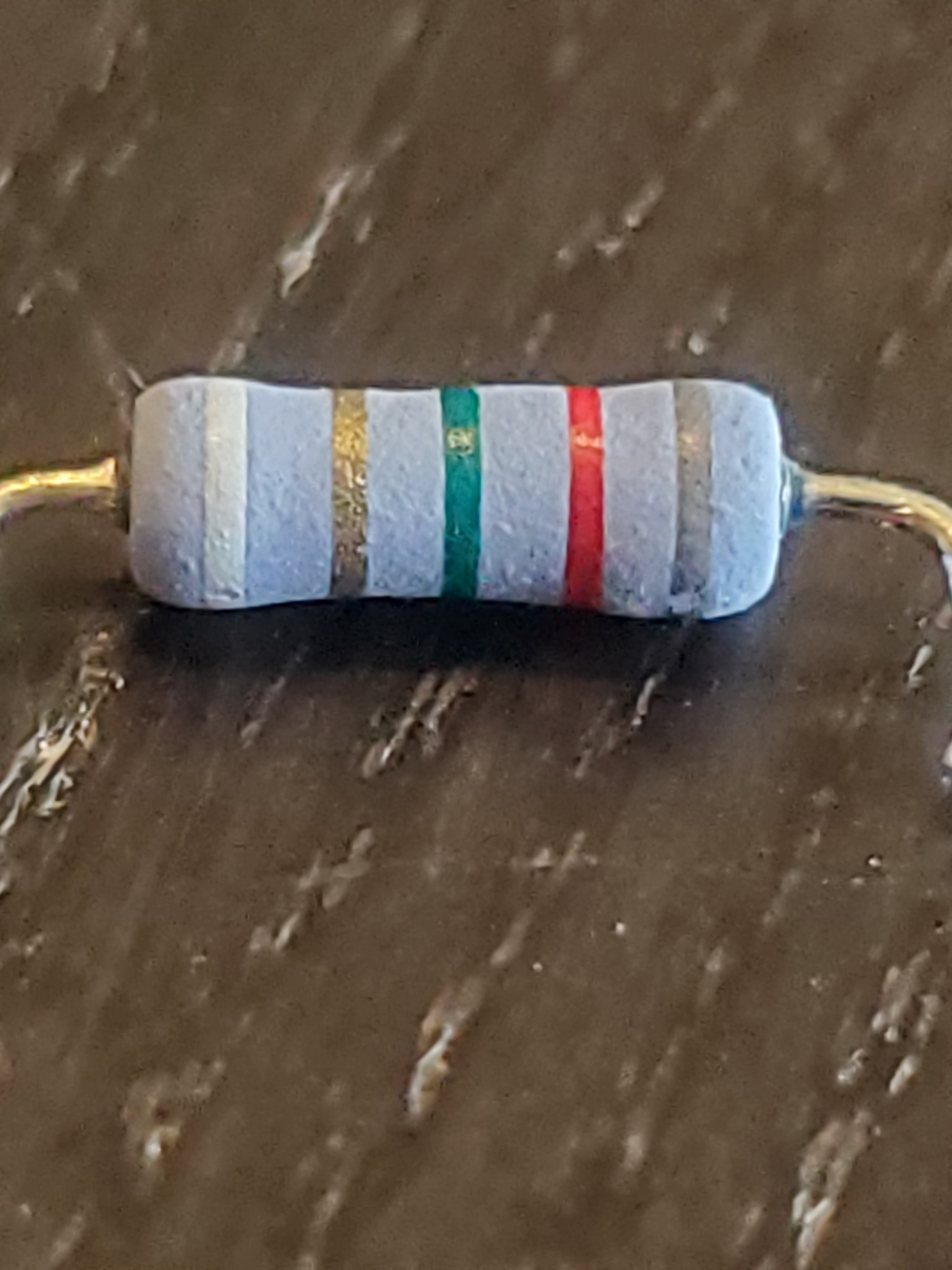

    This is a megaohm resistor. It doesn't play any role in turning on.

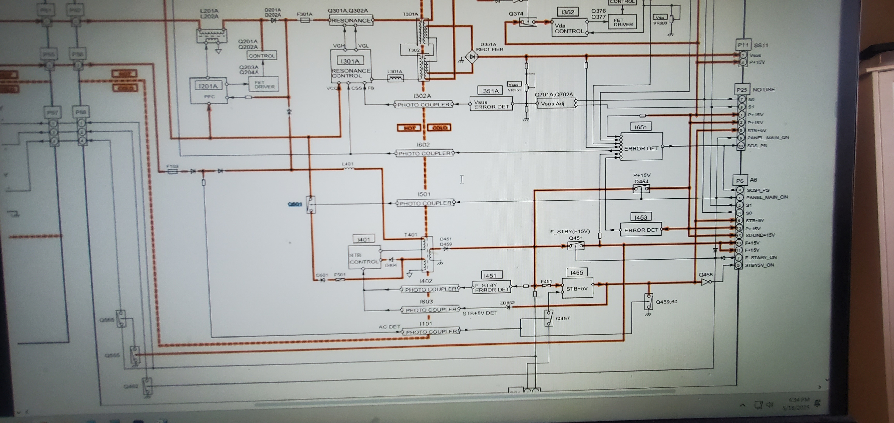

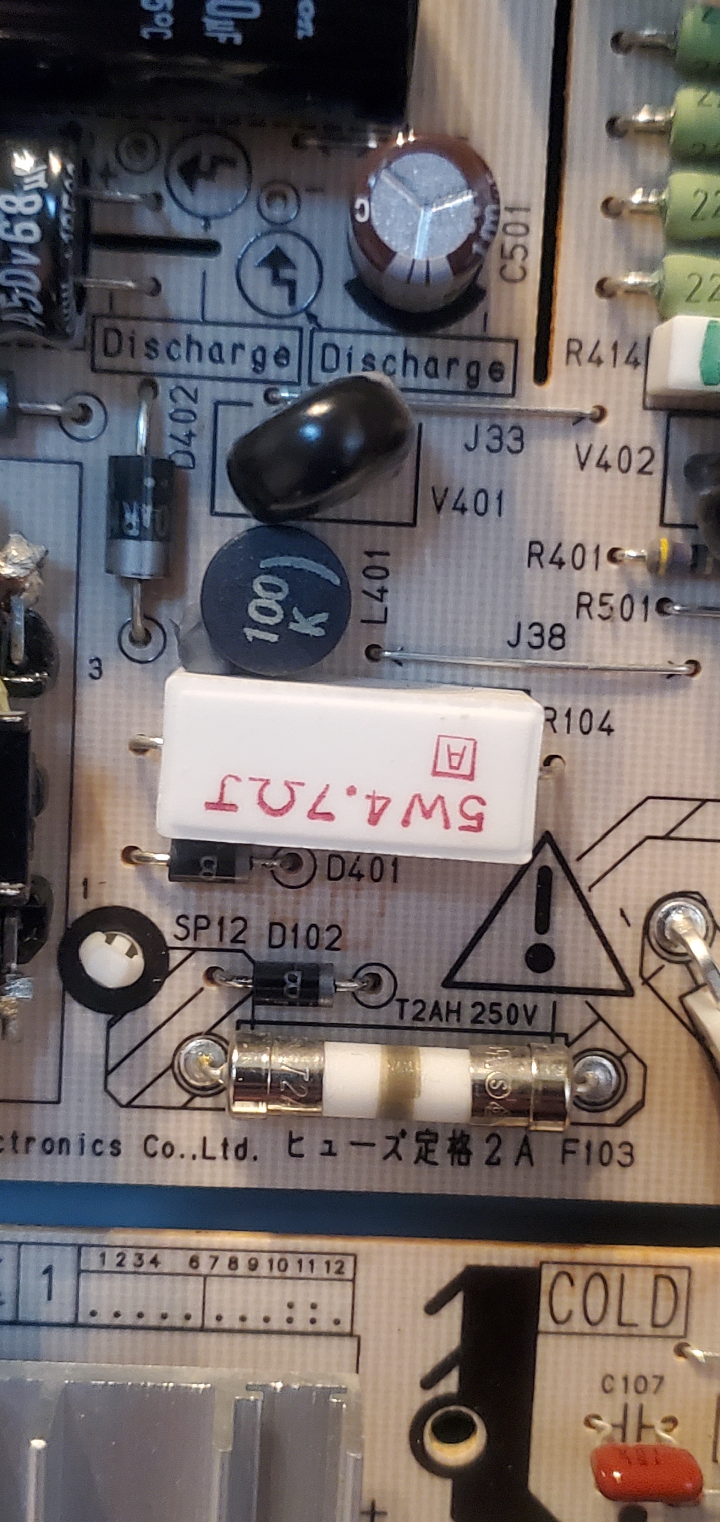

      Testing with the AC plugged in I found the following:
      F103
      D102
      D401
      R104
      D402
      J33
      All the above have over 120V
      The capacitor to the left of C501 has voltage, the other large capacitors have little to nothing.
      J38 only has 2 volts as does many things after that.
      Could L401 be the potential culprit?

        L401 is not a resistor (the resistor has the designation Rxxx on the board), but an inductor, choke, coil (they have the designation Lxxx).​

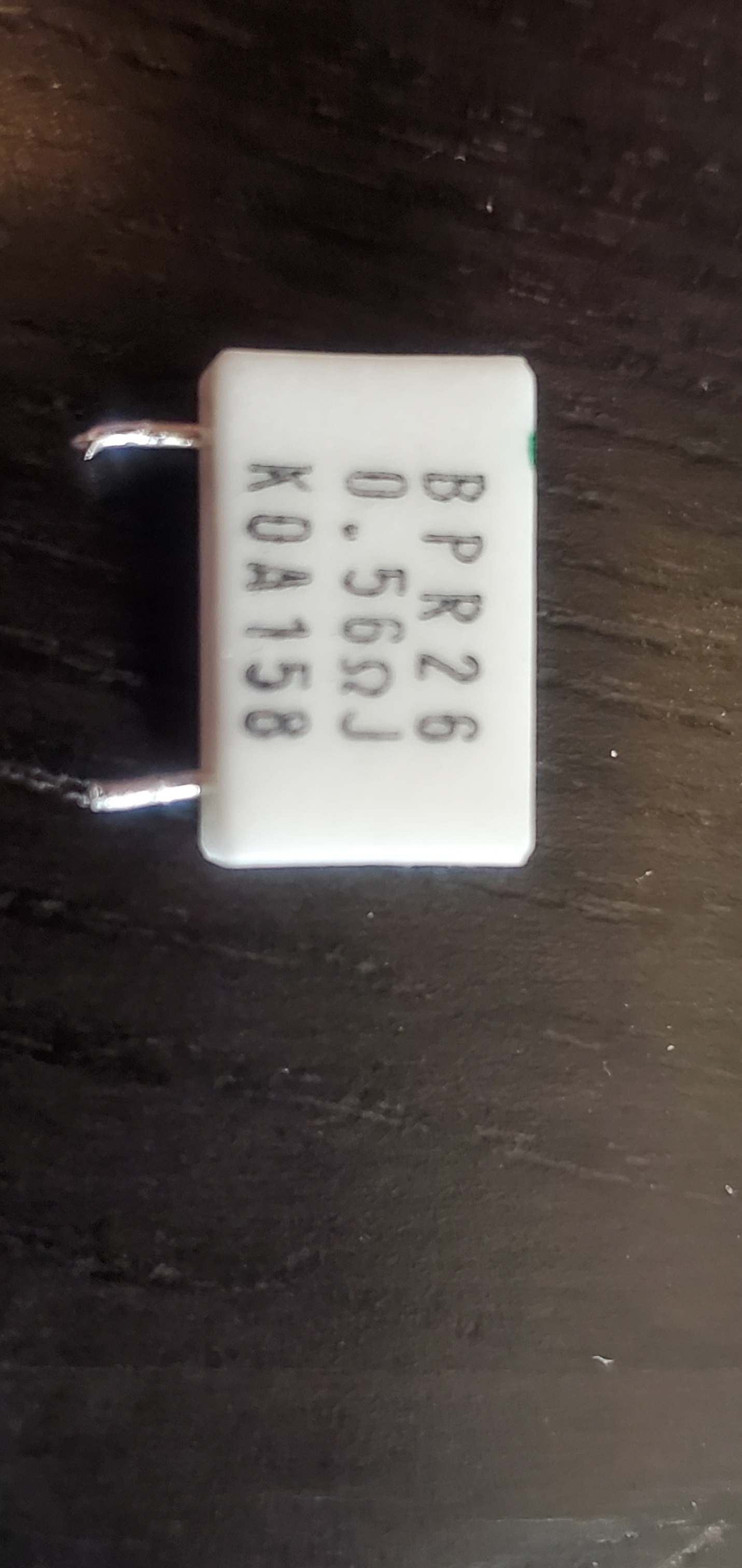

          While following where the power goes on the back of the board, came across this resistor that measures open.
          Assuming that shouldn't be the case?
          Wasn't able to find that exact one through Digi key or Mouser that's in stock.
          Know of an equivalent resistor or an alternative way to go?

          • BobbyMJ
            • May 2025
            • 12
            Can the above resistor be replaced with a metal film resistor with the same specs?
            Like this one: https://www.be-electronics.com/product_p/2wd56.htm
            • lotas
              • Jan 2016
              • 4935
              • Russia
              This is a ceramic, two-watt, current resistor and acts as a fuse, it does not just burn out, look for a short or low circuit in the circuit after it, these can be diodes, PWM microcircuits, MOSFET transistors...

                    Need to order a new ceramic resistor but am unable to find the exact one.
                    Here's the specs ( https://www.koaspeer.com/pdfs/BPR.pdf ):
                    BPR26 -- 2w .56 ohm 5%
                    The BPR26 is proving to be difficult to find.
                    Can I substitute for something like a BPR56 (https://www.mouser.ca/ProductDetail/...9wU3nkyw%3D%3D) ?
                    has a higher wattage though ( 5W) , would it be correct to say bad idea, almost like putting in a large rated fuse?
                    Or substitute with a metal film resistor with the same specs as the BPR26?

                    • lotas
                      • Jan 2016
                      • 4935
                      • Russia
                      Well, if the MOSFET is shorted, check its wiring (driver, low-resistance resistors, diodes, zener diodes,...), and you can replace the 2 W resistor with a metal film one.
