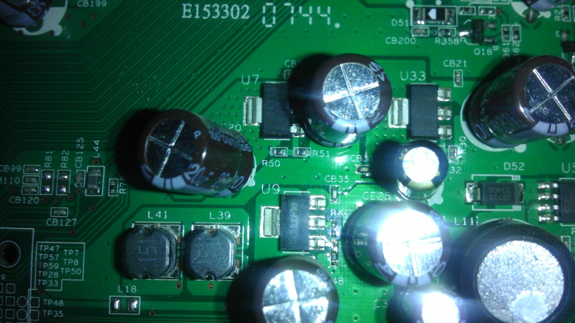

    Ok because your AMC1117's dont have a number after them then it means that they are adjustable regulators. This means that the voltage out on pin 2 is determined by what's going on at pin 1.
    If you look on the diagram on page 6 you can see an example of this on the top left.

      So we need to know what the value of those 2 small resistors are. Can you read them?

          Reading the resistors isnt an option.They are about as small as small gets and I have 20-12 vision.I would bet theres no writing on them at all.
          Their locations are R50 and R51.A service manual would be perfect about now.
          I put a meter on them for kicks and I cant get a reading on r50 at all.R51 is reading about 2.6 ohms.

            Take that back,R50 is reading 98 ohms now.I dont think i had it probed properly.
              Re: Vizio VX42LHDTV10A stuck in standby after going haywire.
              Since we are checking U7 which the reading does not look right at all, what do you see when you Ohm out Pin 2 to Ground, it may be that there are heavy load on pin 2 that it pulls the U7 output low.
              By the way, can we see real good closed up pictures of U7 and the connections around it?

                95.8 ohms
                  One of those two resistor will have one end connectoed to ground and another end is hooked up to pin 1, what value is that one, then other one will have one end also connected to pin1 and another end will be hook up to Pin2 (Vout). If we know the value of these two resistors then we can calculate what the output voltage should be.
                  Please remebertaht we are trying to do long distant troubleshooting here, good information and pictures are a great help. Jasgriff gave me great pictures and information to trace out his circuits.

                    Ok,heres the pic.I need to reread your post to make sure Im metering the right thing lol
                    • ktulu909
                      • Mar 2012
                      • 40
                      #30
                      Ok R50 is what I believe is the one to ground.It is reading 98 ohms
                      R51 is the one that is reading 2.5-2.6 ohms.

                        R51 is ground and R50 is to pin2 out by the looks of it on ur pic.

                          That very well may be the case gah.Im sorry,like I said im a newbie. I think you are correct after a friendly little continuity check

                            Thats ok thats why the pics help. its easy when you see where the capacitors negative pin is.

                                Right I think that your should be getting around 1.28v out of that regulator. based on the readings that you have proved. However I may be corrected by the next person who tries to work it out.

                                  I sure hope its the regulator.It sure would be a heck of a lot easier to unsolder and replace with the regular iron I have.

                                    Yeah I think it definately doesnt seem right! I would have thought it would be set to provide 1.8v out but either way I think it needs changing. They are not to expensive to change and eliminate it from your fault finding.
                                    It might even be worth you tracing where the out pin goes too. that will give you an idea of what it should be powering.
                                          Ok,I might be loosing my mind,but it doesnt appear to me to go anywhere lol
