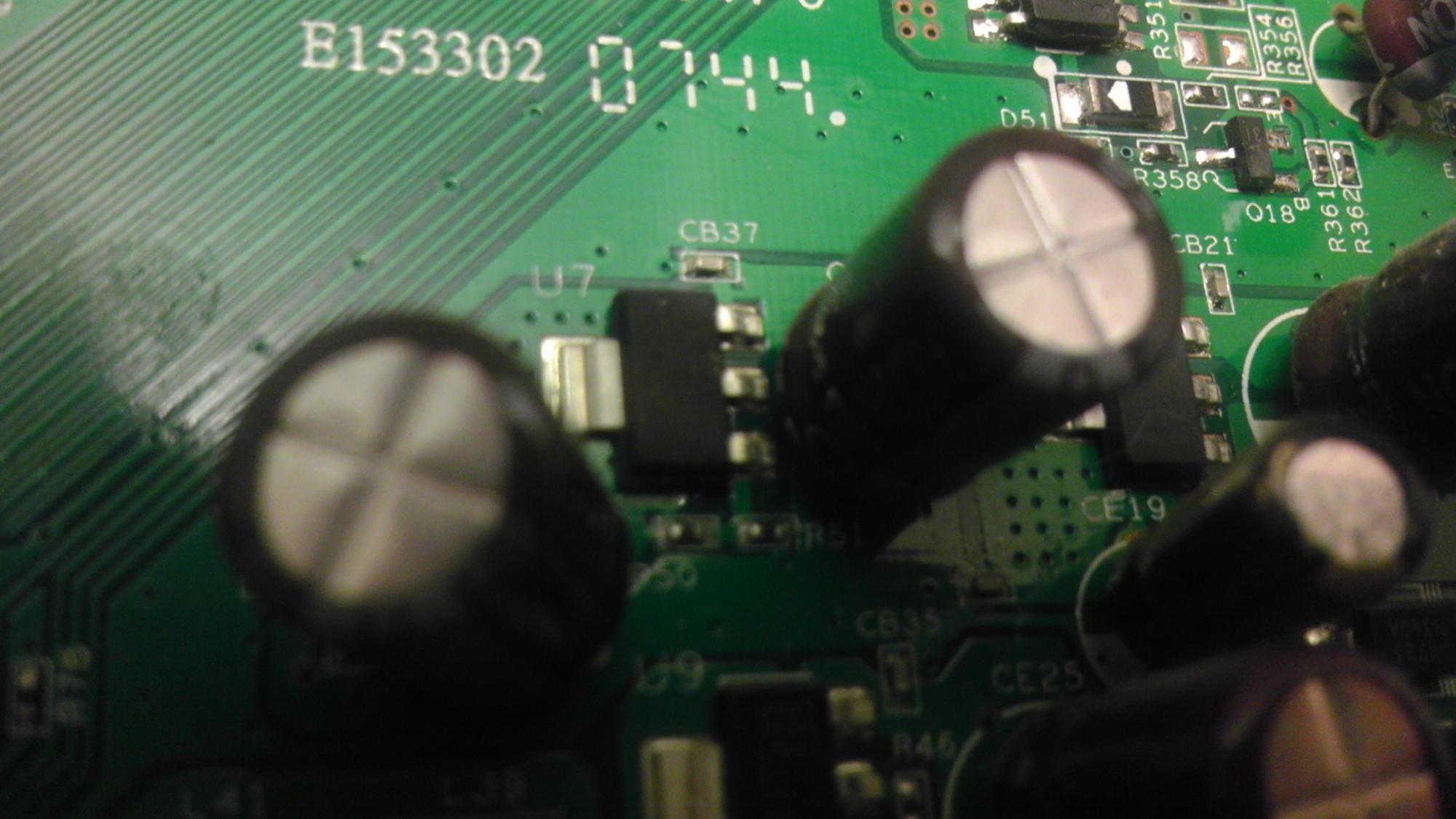

    Heres the best I can get. For that matter,it looks as if U8 is the only one that has a trace that leaves the output.Now Im really lost.

      Out of curiosity can you see if the top tab of u33 is connected to pin 1 of u7. Use your multimeter to check. Without the tv on

        Pin one the way I listed or the way the datasheet listed?

          My calculation came out the same as Jasgriff, 1.28v. I would change out the regulator, but did you Ohm out the Vout pin to ground to see if it has resistance a lot less than 100 Ohms?

            My calculation came out as Jasgriff, 1.28v. I would change out the regulator, but did you Ohm out the Vout pin to ground to see if i has resistance a lot less than 100 Ohms?
            Vout measures 98 ohms to ground
              280 ohms
                #47
                Re: Vizio VX42LHDTV10A stuck in standby after going haywire.
                That is correct about the same as the total resistance of the two resistors in series.

                  SO were going with replacing U7?
                  • ktulu909
                    • Mar 2012
                    • 40
                    #49
                    Want to give me any idea which part to get?Heres what I see.

                        I glanced at ebay,but most listings are fixed voltage regulators

                              If you look on the spec sheet it shows you pictures of the different form factors. This will help you filter through to the one you need.

                                From your picture, it looks like SOT-223-4.
                                So either one of these are OK.
                                http://www.mouser.com/Semiconductors...ng%7c0&FS=True
                                http://www.mouser.com/ProductDetail/...nqDMTPIJSx0%3d

                                  Part Ordered!! Actully I got 5 just in case.Will report back when they arrive!
