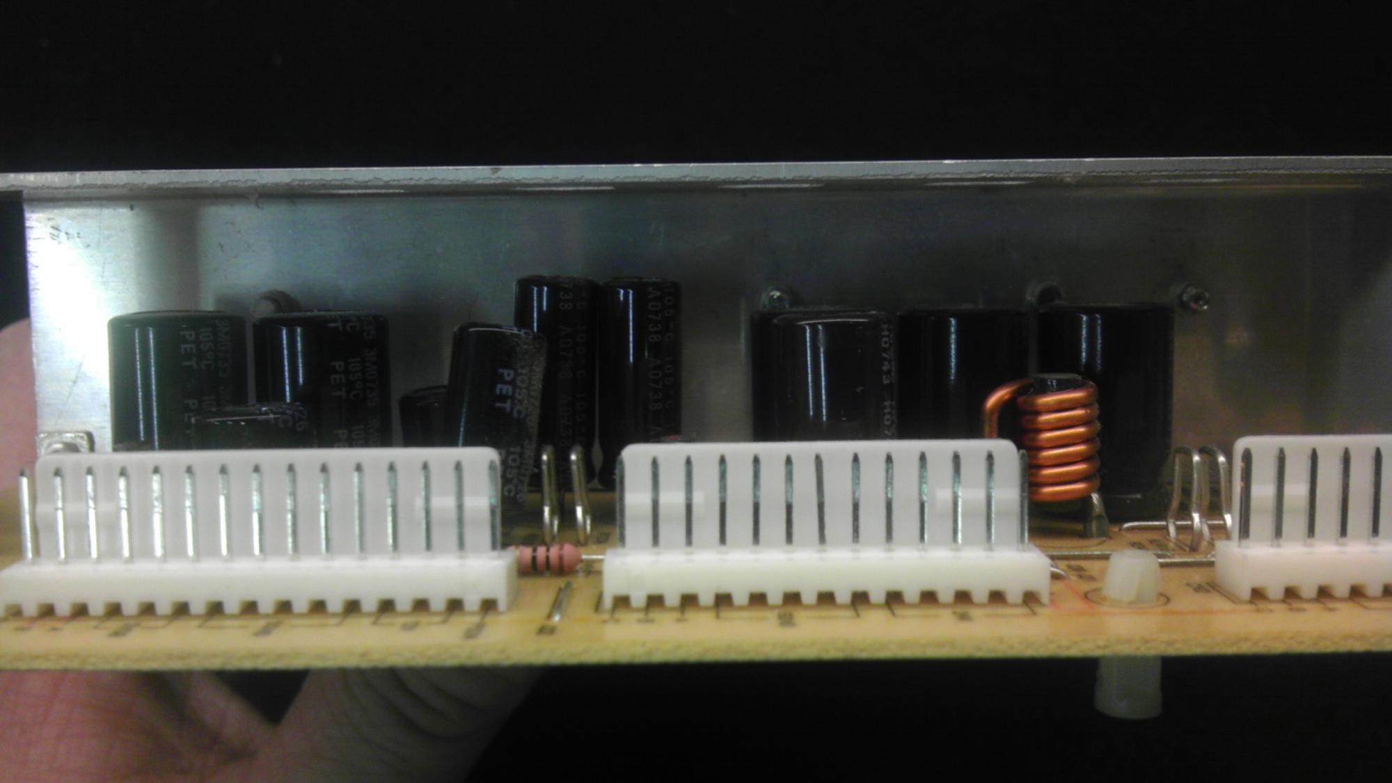

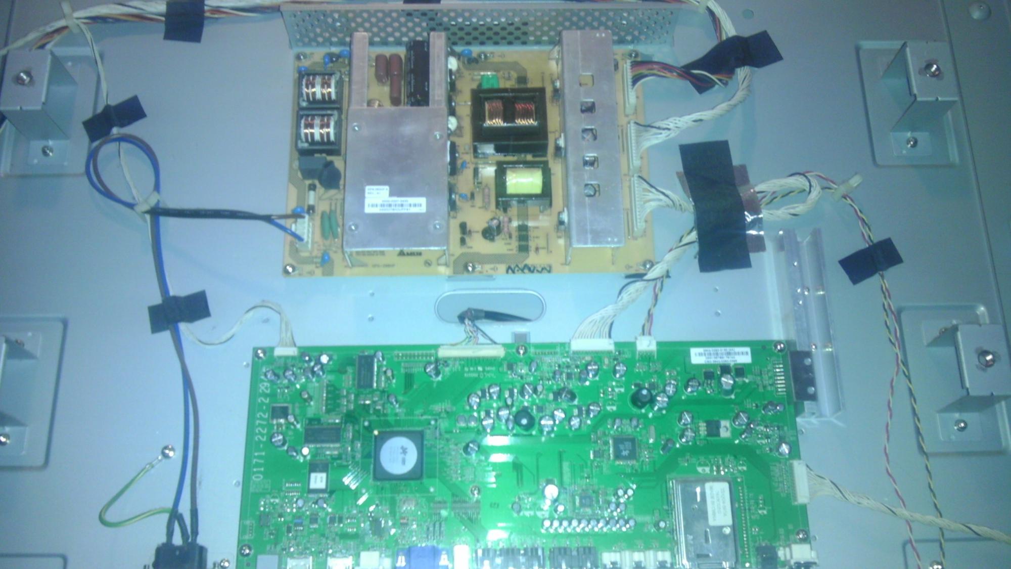

    Ok folks,been reading for the last 3 hours and could use a little guidance.I have a unit that went completely haywire last night.It displayed horizontal multicolor lines and was making a terrible squealing through the speakers and would not respond to any button presses.It had to be unplugged to make it stop.
    After letting it sit for about an hour,I plugged it back in and get the orange Vizio logo and nothing else.No response to buttons,or remote.Just an orange vizio logo.
    After reading the forums,I have found some good advice on where to start looking,but so far have found nothing definitive.I work in car audio and security and have a decent electronics background.Im proficient with a multimeter and am completely comfortable testing anything you guys can point me towards.
    I have visually inspected every capacitor in the tv and nothing has ruptured or shows any sign of buldging.This model has the singal long inverter board and the capacitors look good there as well.I have also tried powering on the unit with the inverter board unplugged and still no dice.It just wont do anything.
    I tested all the outputs on the power supply and the only thing that actually has output are the 5V lines.Is this normal?
    If anyone has any ideas on where to go from here,Im all ears and look forward to hearing from you all.

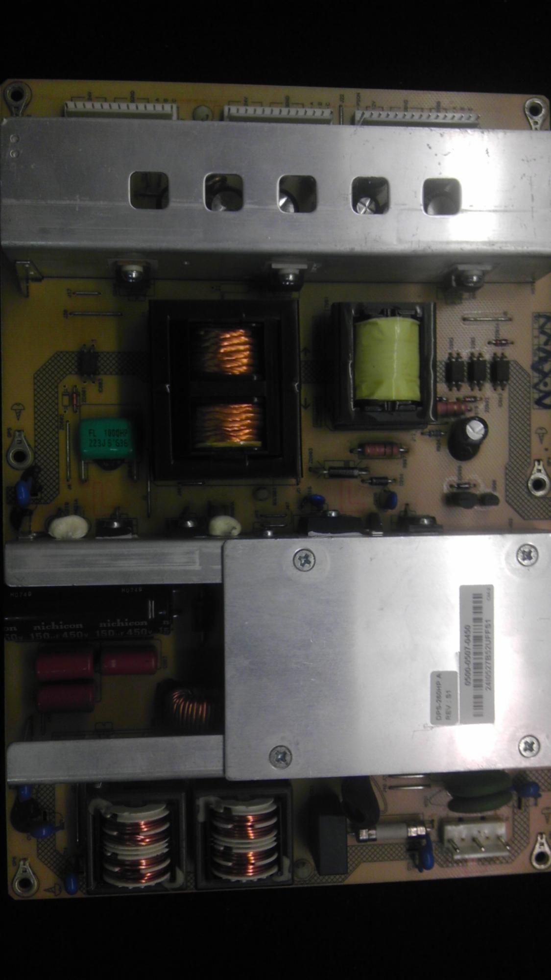

    1) Post clear focused top down view pictures of all your boards following the instructions in my sig file below EXACTLY.
    2) 5V indicates that your standby is working.
    3) The main board should be sending a signal to tell the power board to turn on the SMPS. This signal is sometimes called PS_ON and is usually 3V or higher.

        The main board is the one with all of the video connections I would say that if your TV is still indicating that it is powering on then it is likely that you need to replace this board look for things that may be bad on this board as well like a blown cap or something ... If not it is hard saying what it is look at the screen prints and check for blown fuses marked F in most cases... for instance F5 or F12 or F2 something along them lines do a continuity check some of these may not look like fuses but they are SMT variations of fuses. beyond that it gets kind of difficult to diagnose anyways good luck with your project.
        Please note: I am not responsible for any harm caused to you anything discussed is just discussion. Before you try anything discussed be sure that you have the appropriate knowledge and safety gear for the job. Like with anything education and safety are first! Do not try anything @ home without it.

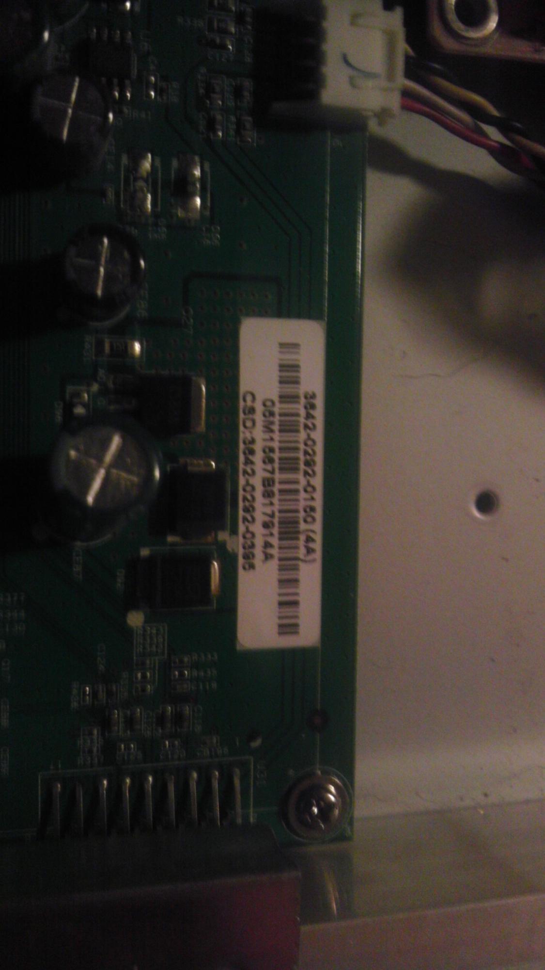

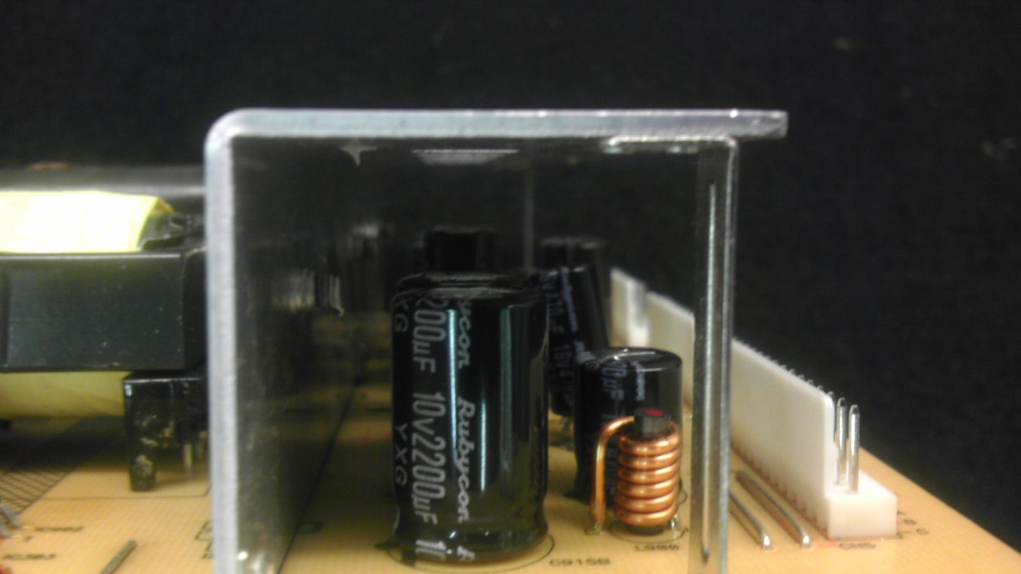

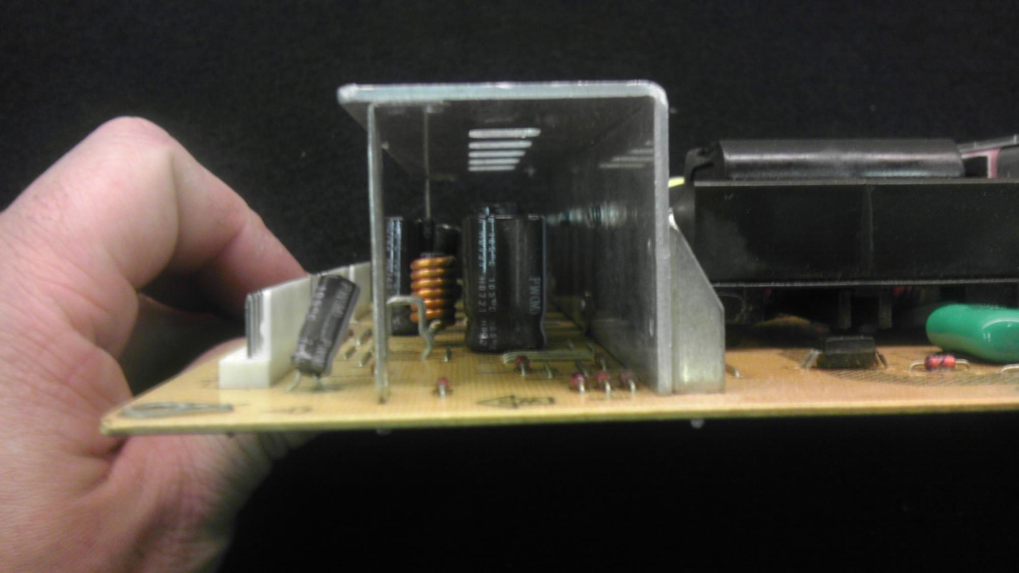

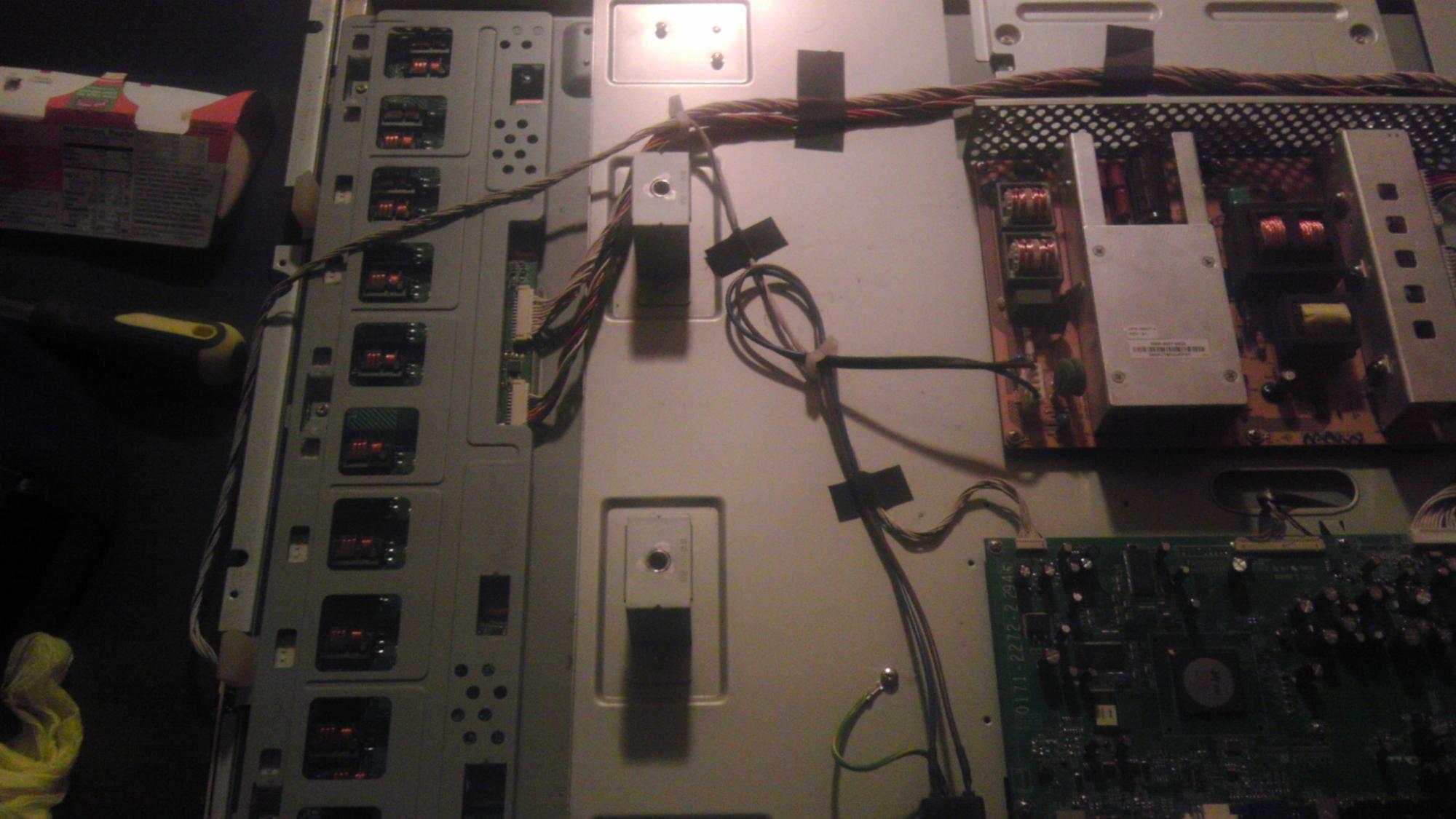

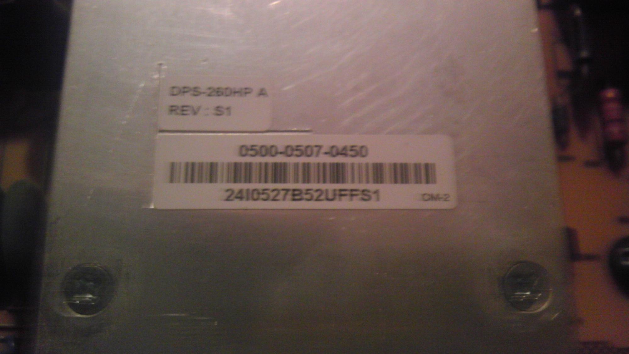

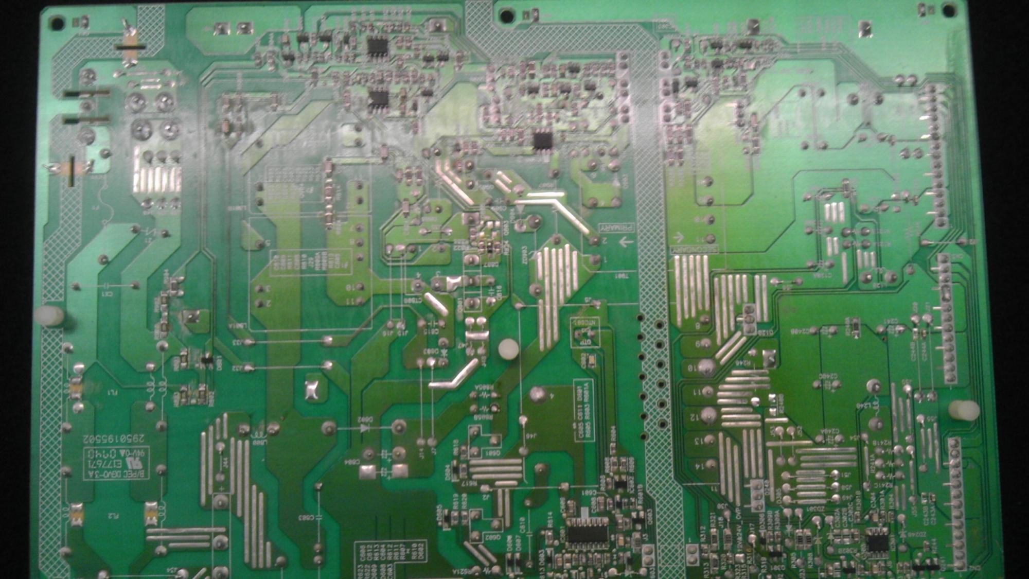

          Yea,all the fuses test under 1 ohm,so I assume (you know that that gets you) that theyre good.Also it seems that the larger heat sink on the power supply will provide you with a nice little 56v tingle when plugged in,is that normal?
          Sorry about the quality of pics,my phone is all I have
            Heatsinks are live and can potentially be 400V DC depending on PFC or not. Don't touch them.
            On the power board, there is a PS_ON pin. When you press the on/off button, does this pin change from 0V to 3V or higher?
            If not, there are a ton of voltage regulators on the main board. You will have to measure them all to see if anyone are bad. Vizio's have a problem with voltage regulators failing.
