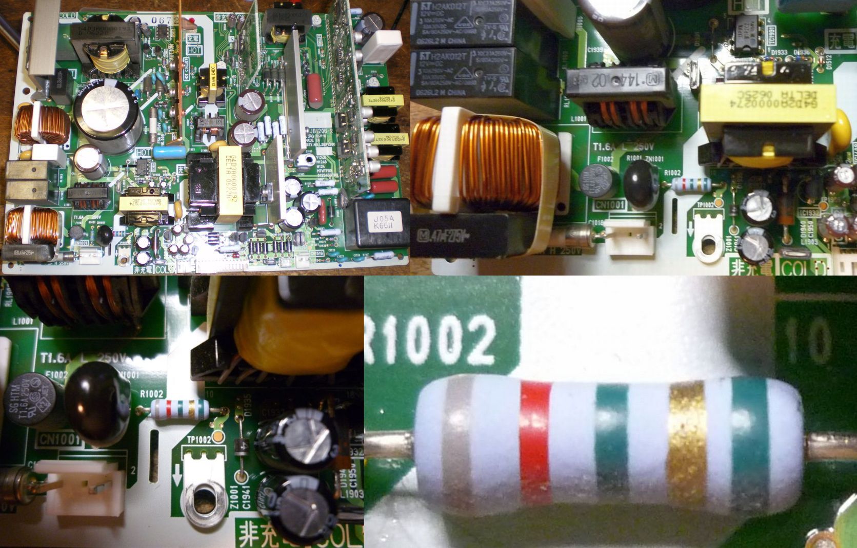

        Re: Panasonic PT-52LCX66
        Greetings BadCappers:
        --Please see attached picture(s) of Power Supply Board LSJB 1206-2 from the Panasonic PT-52LCX66 I am trying to fix for a friend (I.E. no charge). I have checked everything visually and can find no sign of anything, the board appears to be pristine. Checking the resistors in situ with a DMM revealed only one definite problem. The Grey Red Green Gold Green resistor in the pictures which is 3/8" or 9.5mm long, should be 82.5 Ohms ± 0.5% is reading 8 Megohms. It connects directly to the power chord, white wire, wider plug blade.
        --So it looks to me like I will need a 1 Watt (or better) 82.5 Ohm ± 0.5% resistor. I have tried DigiKey, no luck. Mouser has them in 1/4 watt, so I could series parallel 4 of them easily enough, if that is acceptable. Any fault finding or advice, would be sincerely appreciated. I can post higher resolution pictures if necessary. Thanks again.
            it should read 8.2 megohms.its ok.
            look also for an upgrade kit for the "ballast"
            some changes were made to resolve short lamp life and improve ballast reliability.
            if you bought a cheap knockoff lamp it could be gone again.
