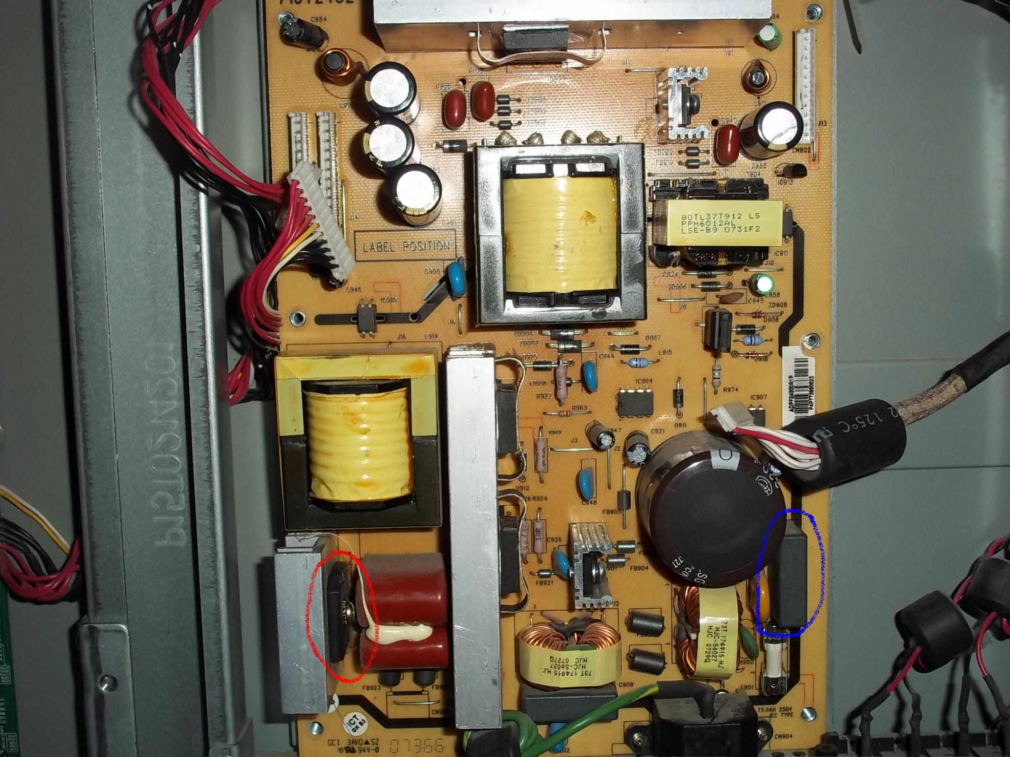

          Re: Philips 42PFL5432D/37 I May Have Made my Problem Worse

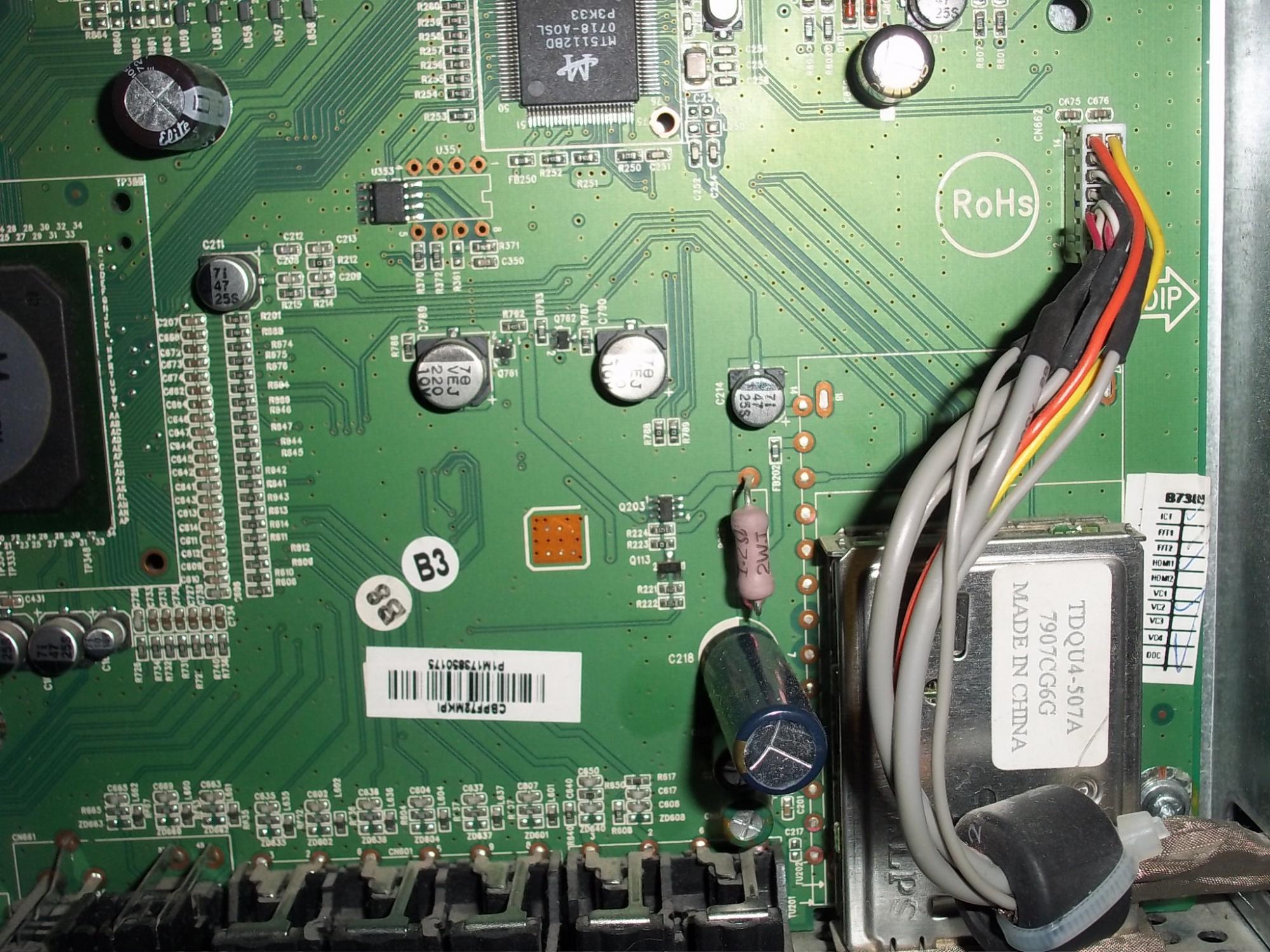

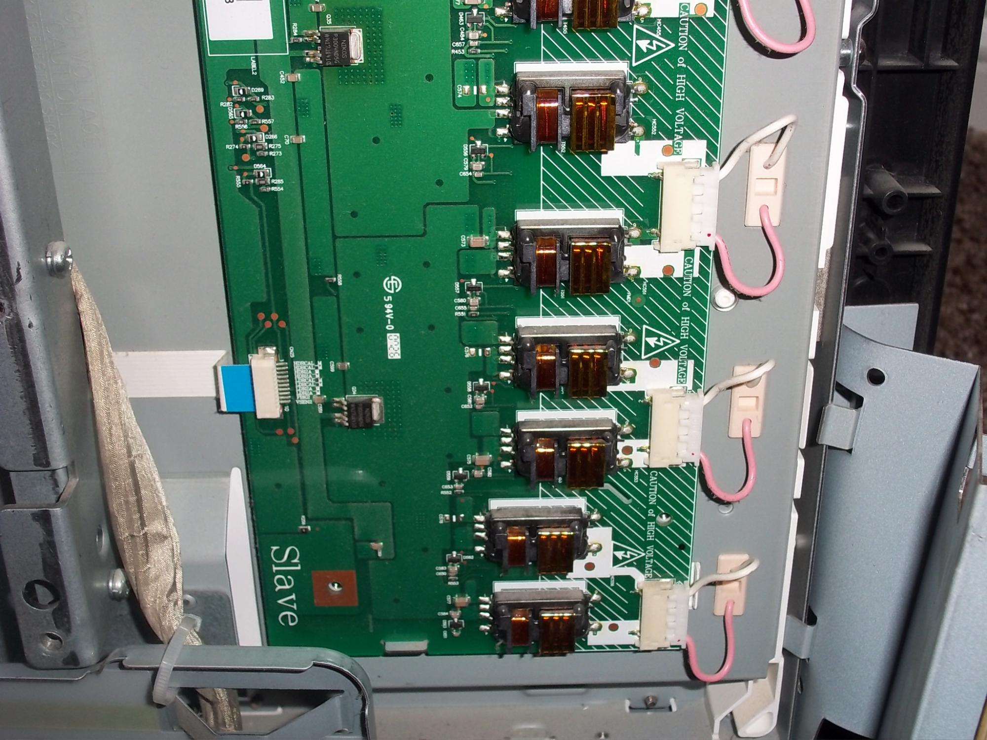

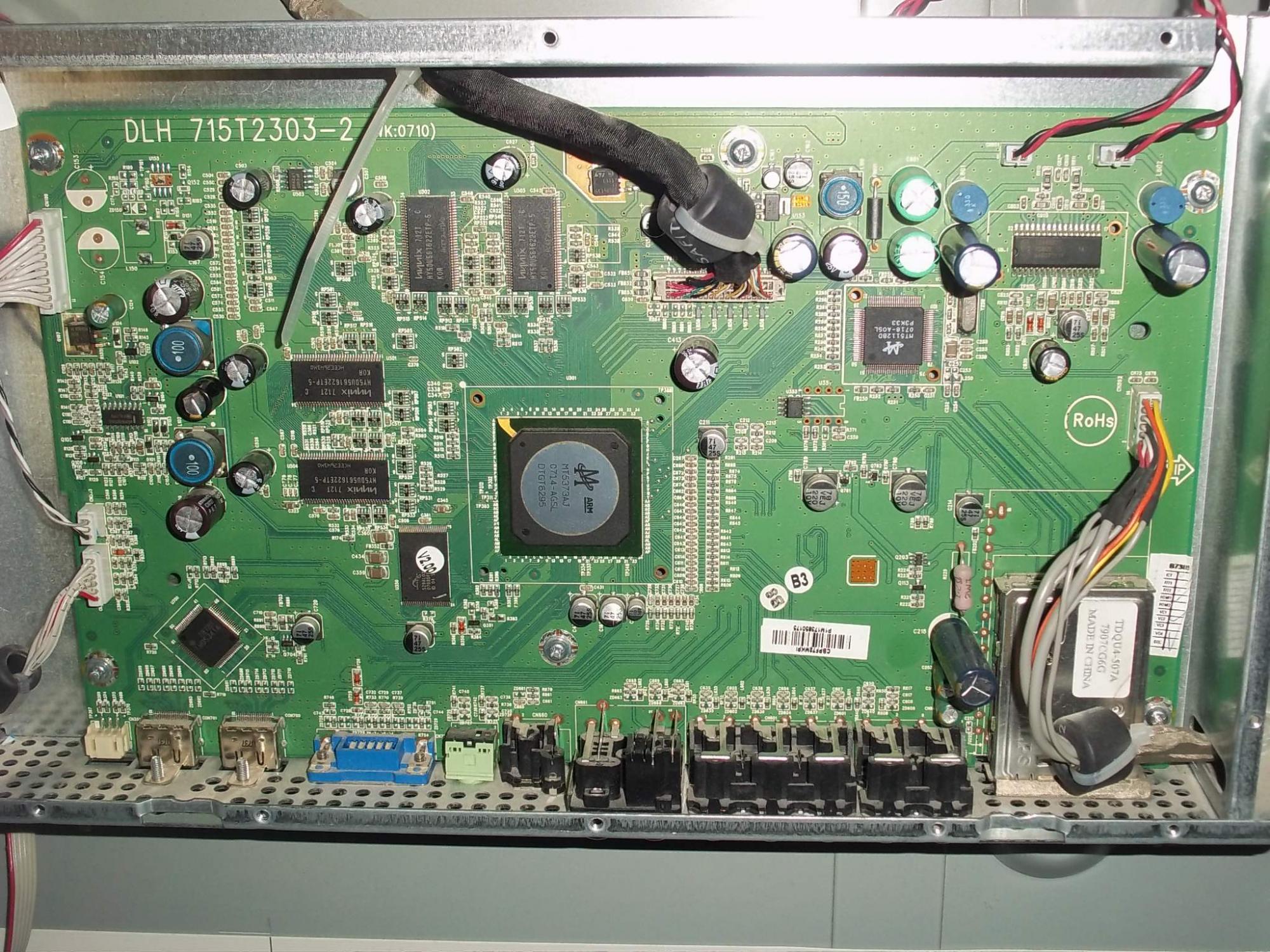

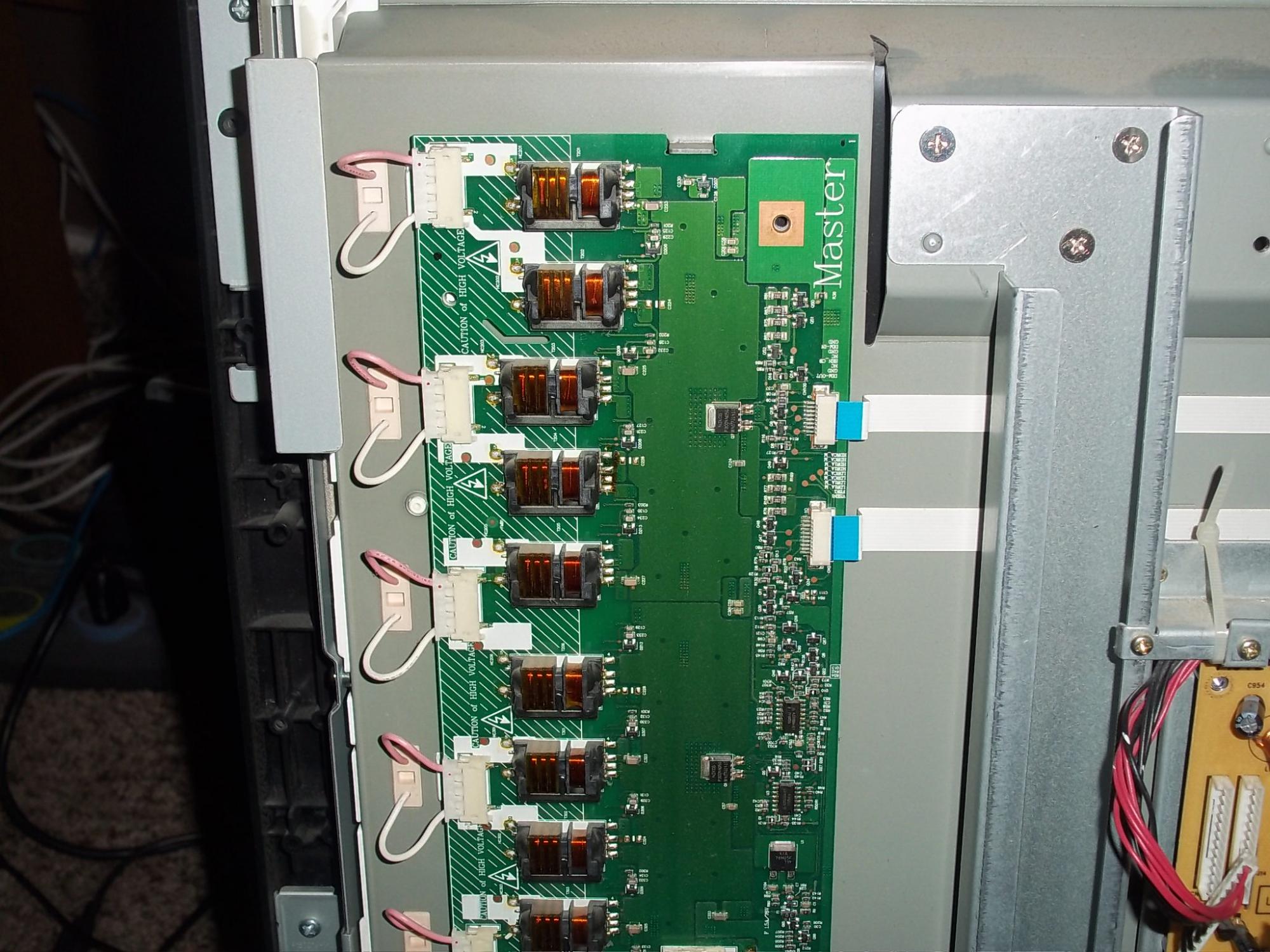

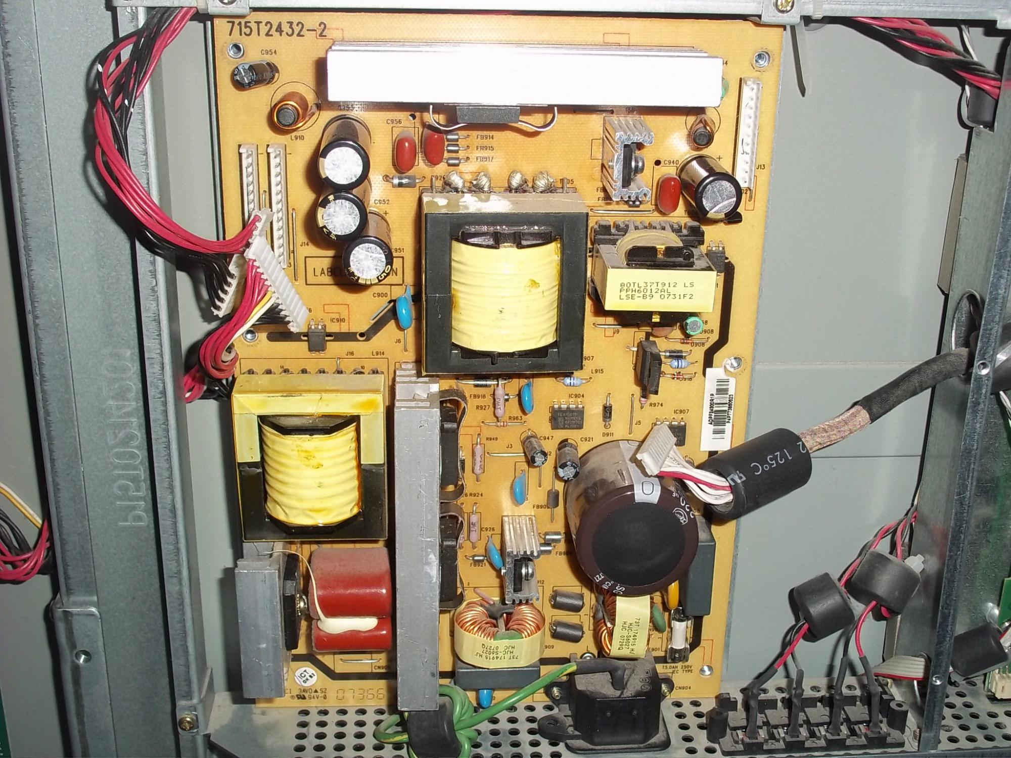

          Post clear focused top down view pictures of all your boards (both sides) following the instructions in my sig file in post #2 EXACTLY.

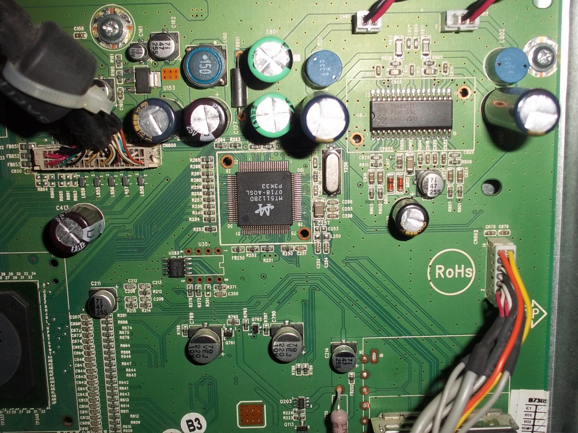

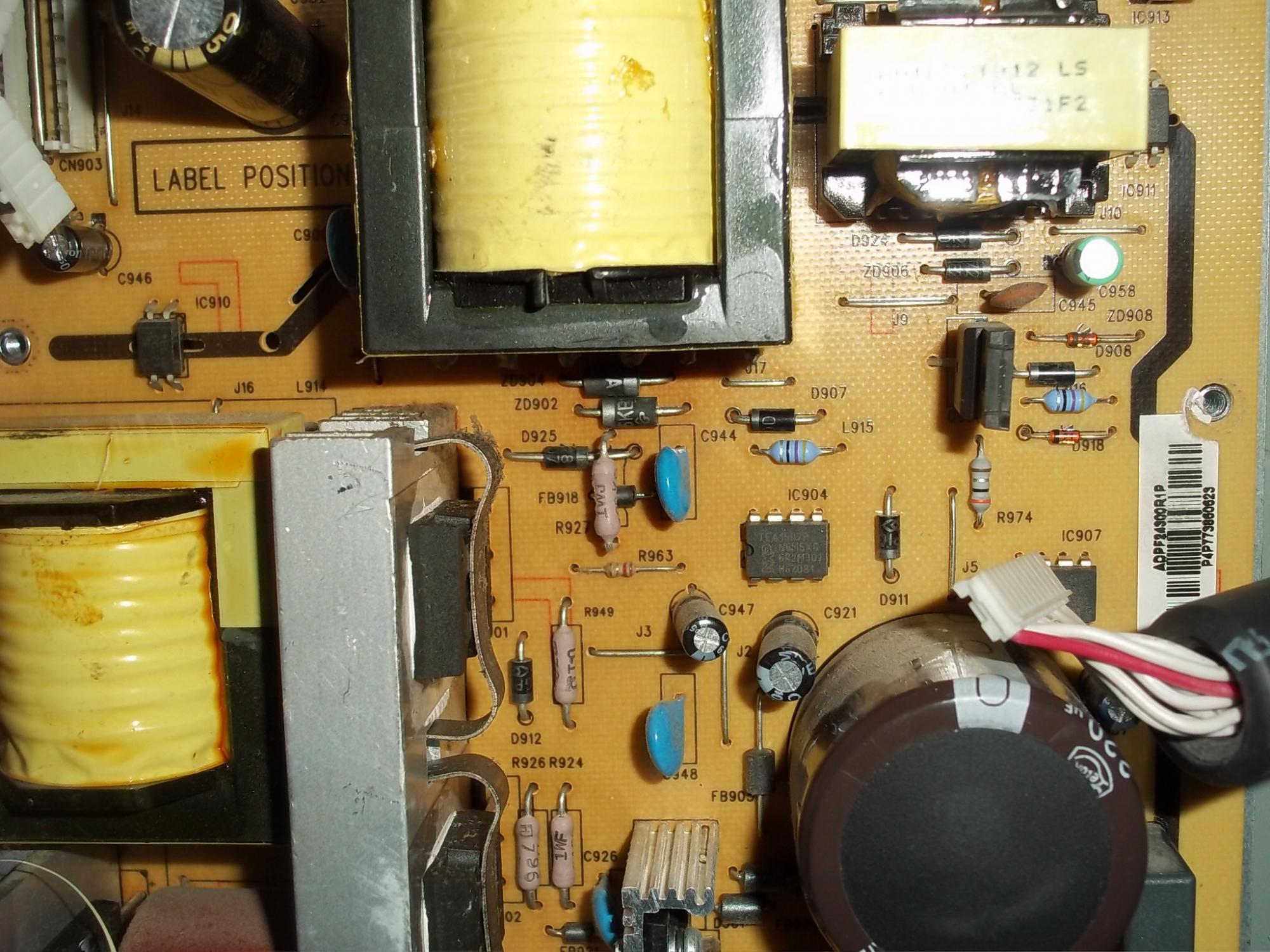

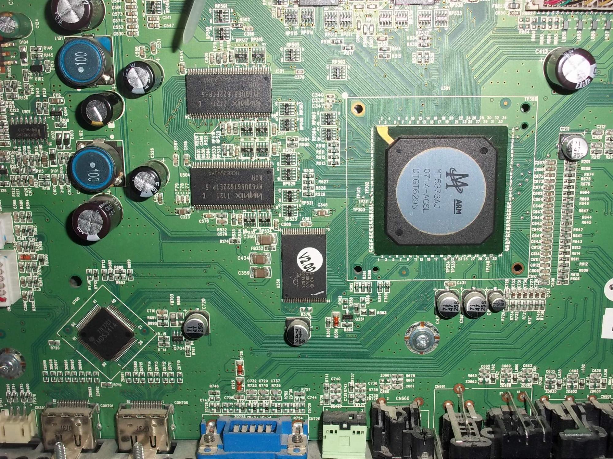

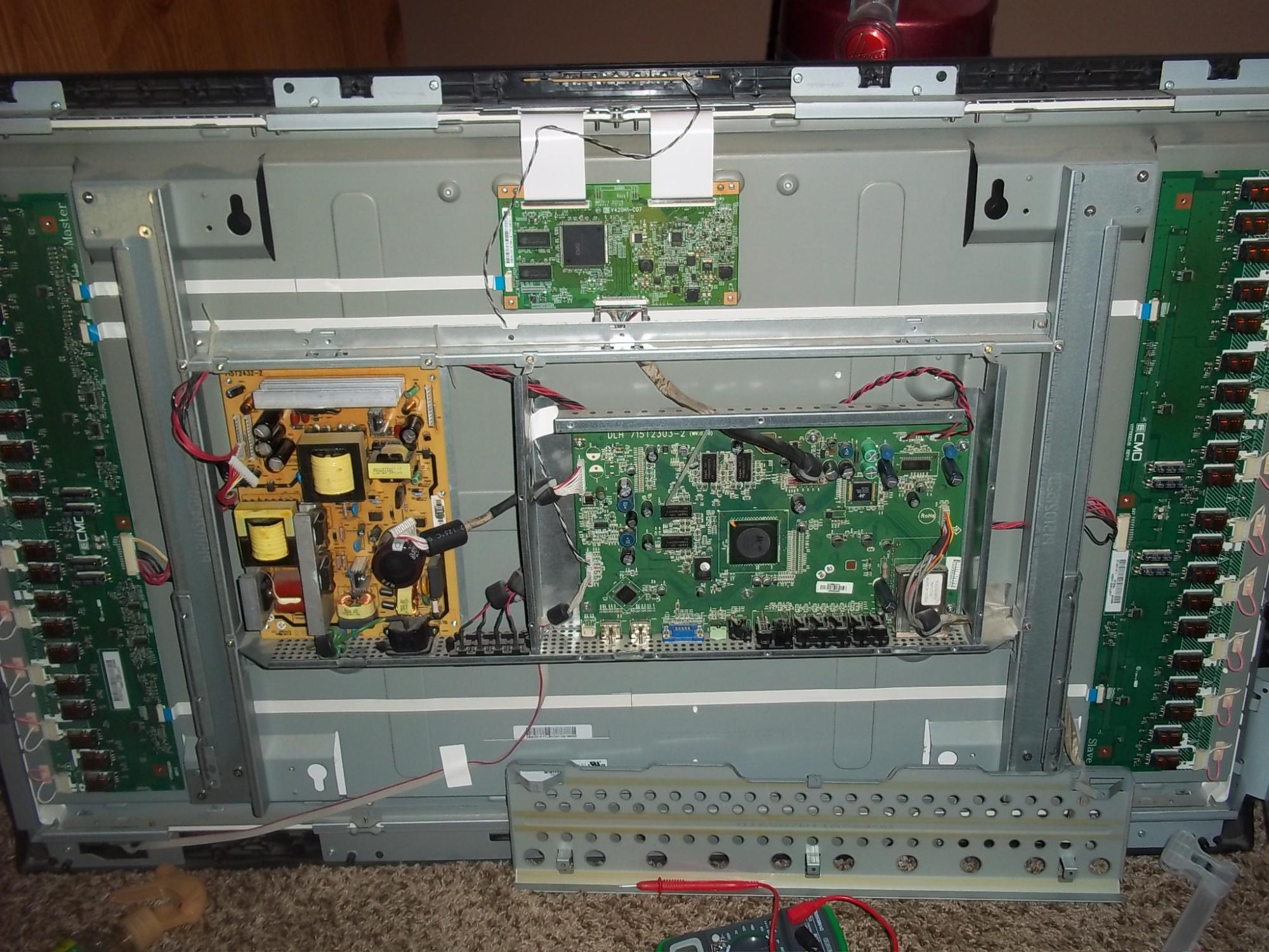

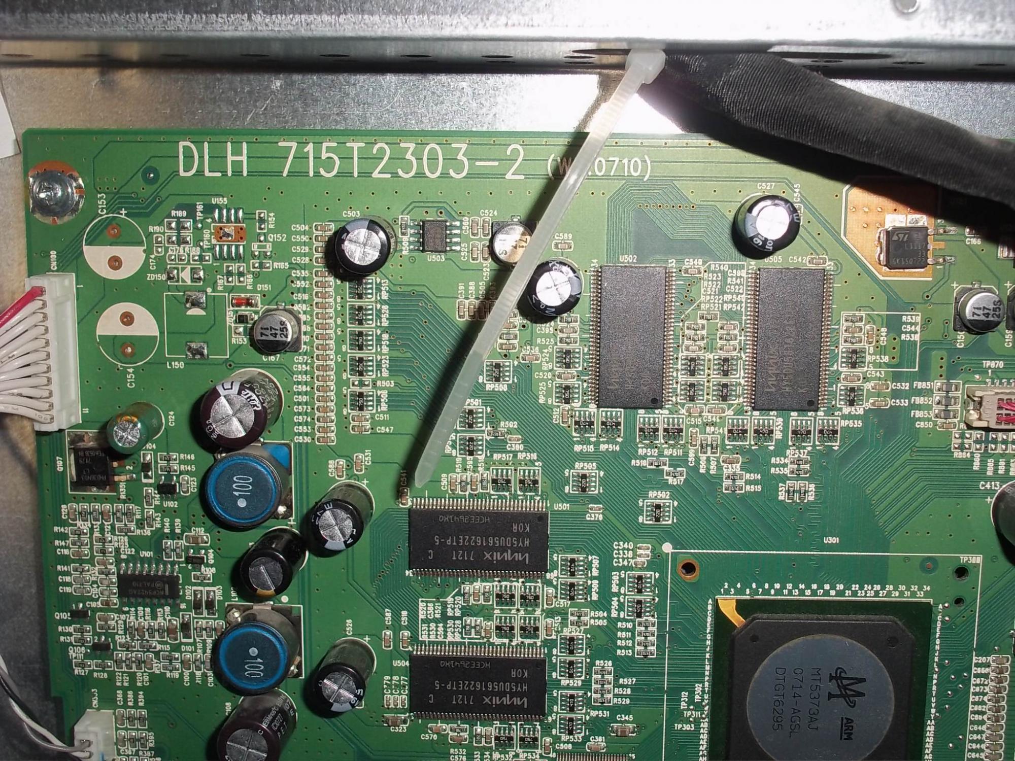

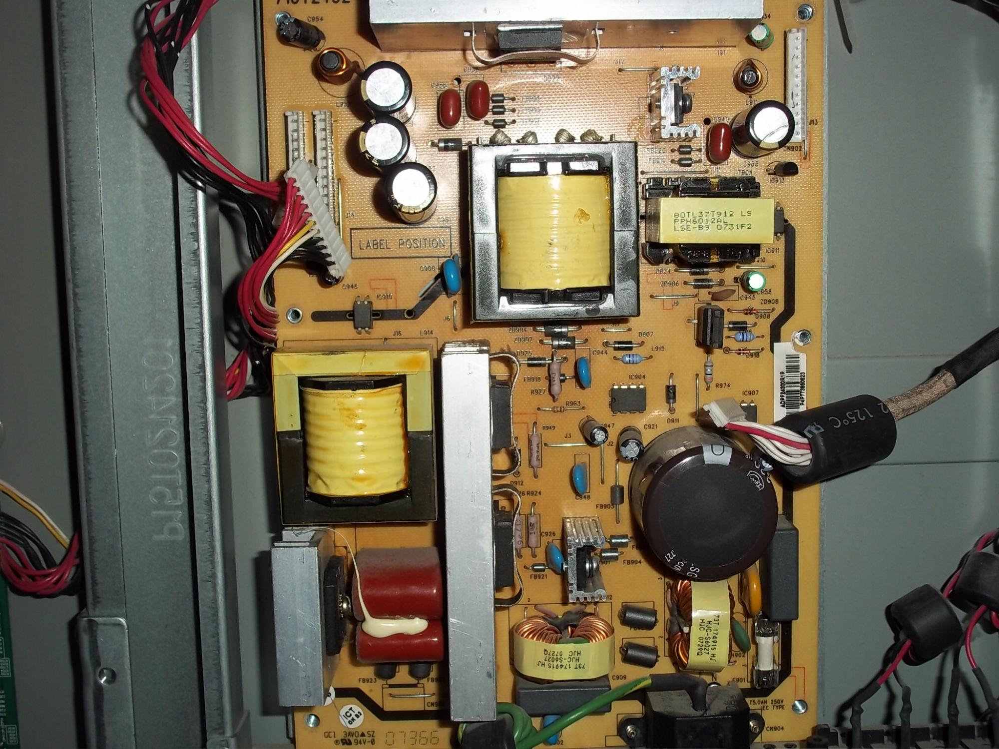

                got pics!

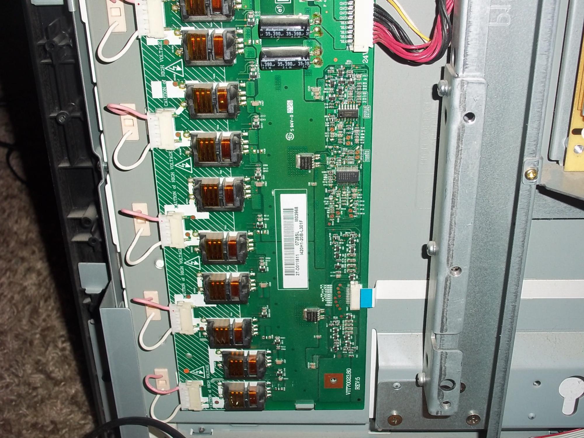

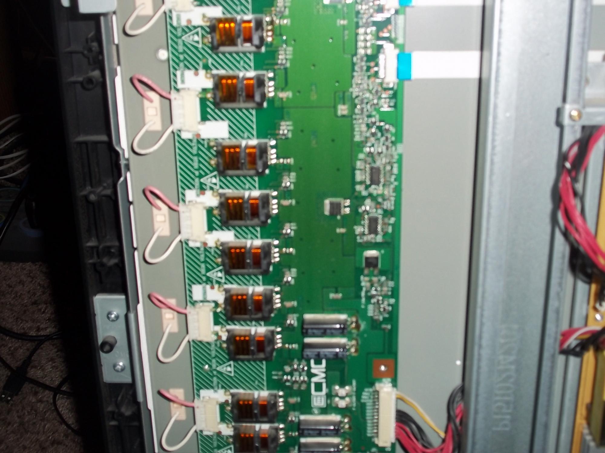

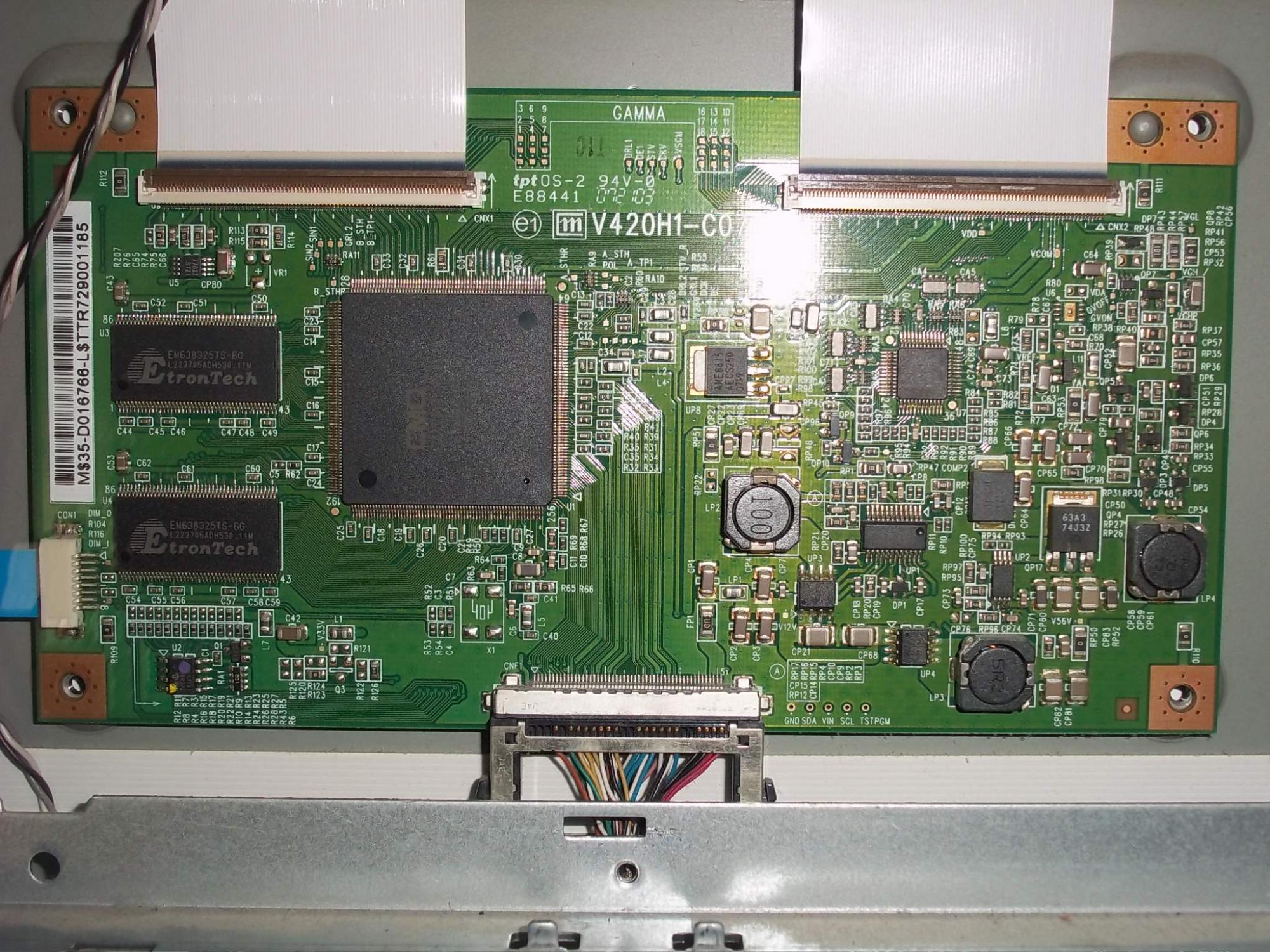

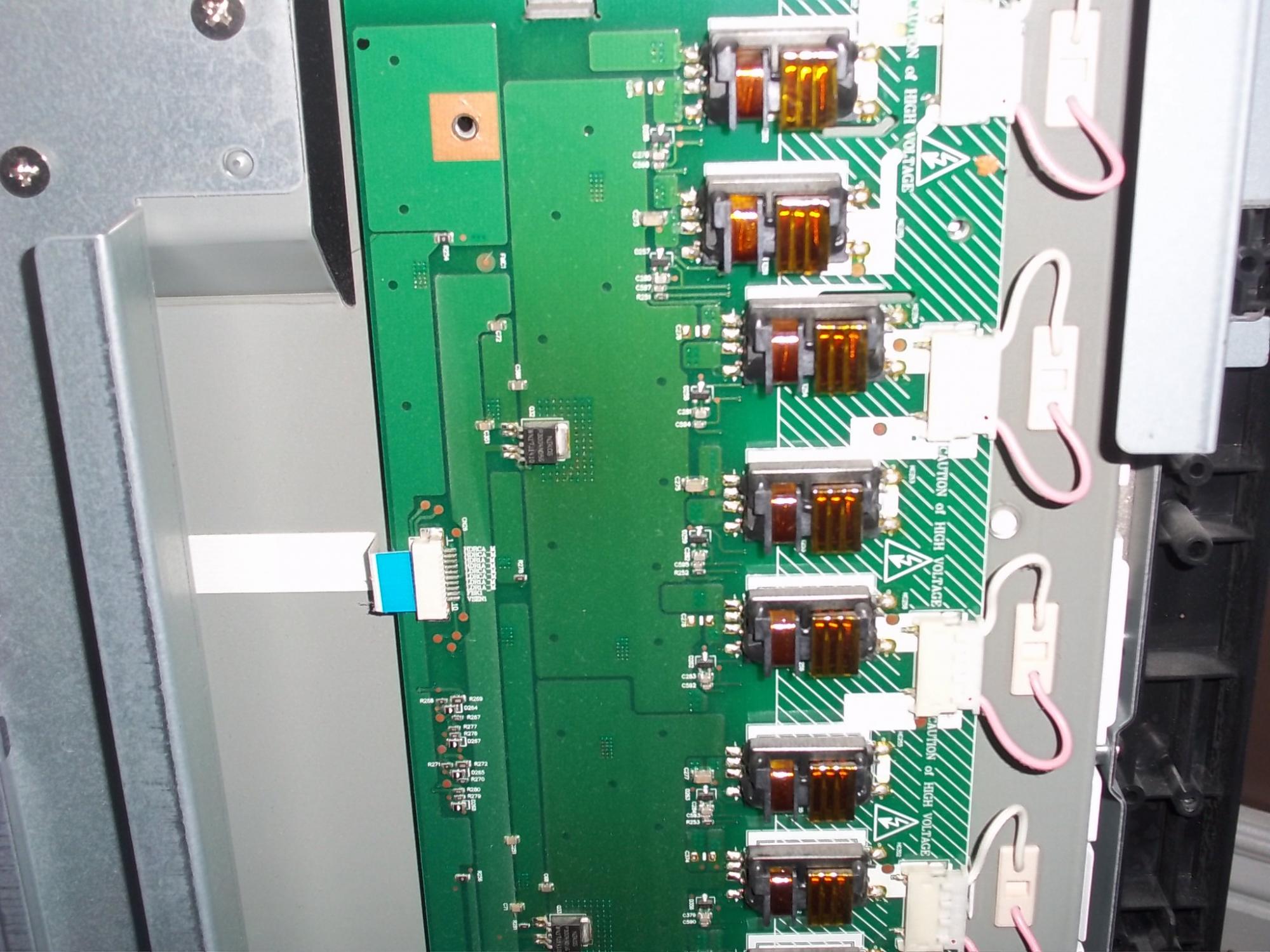

                • m1dp
                  • Feb 2012
                  • 16
                  more

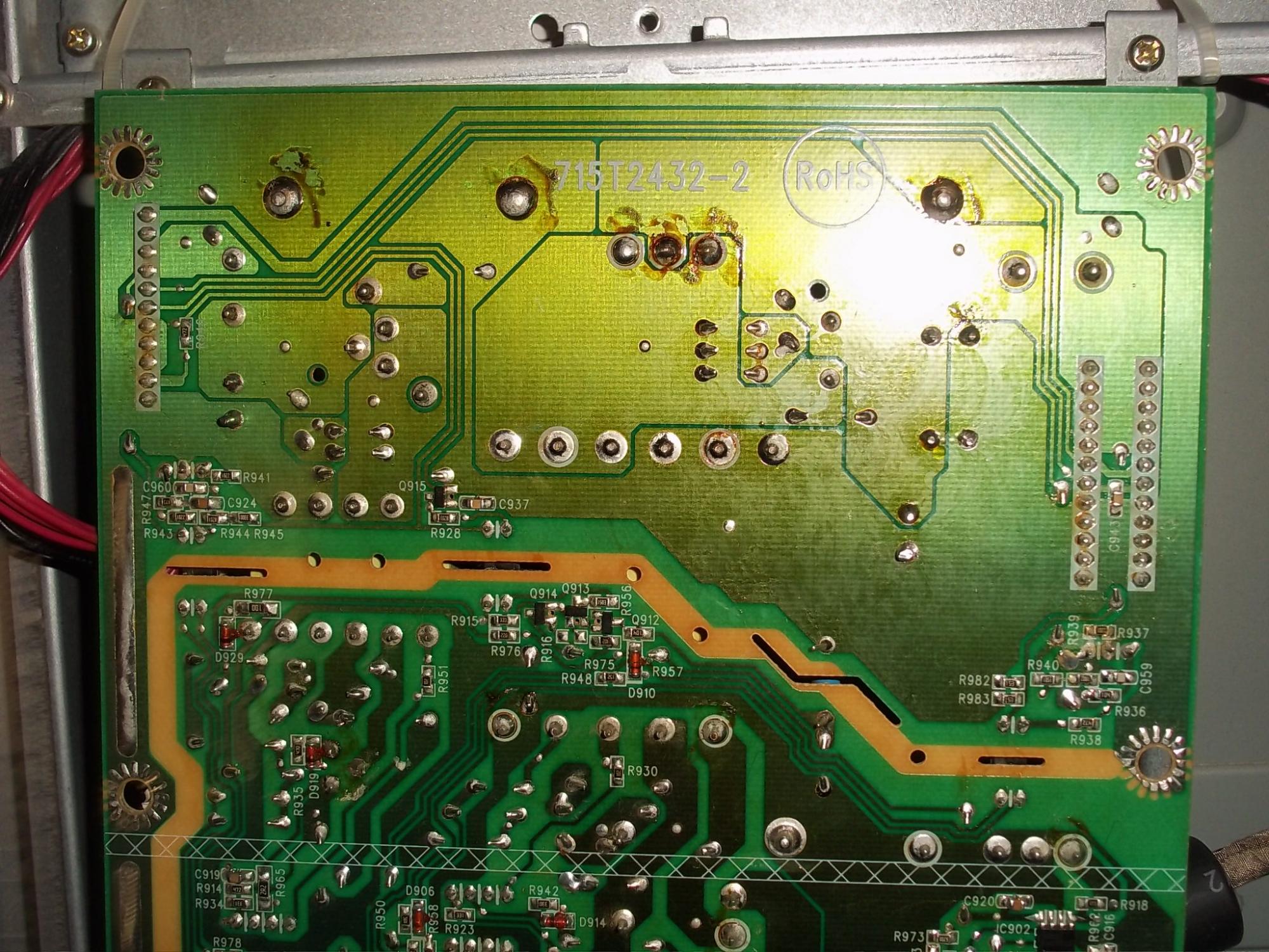

                  • retiredcaps
                    • Apr 2010
                    • 9271

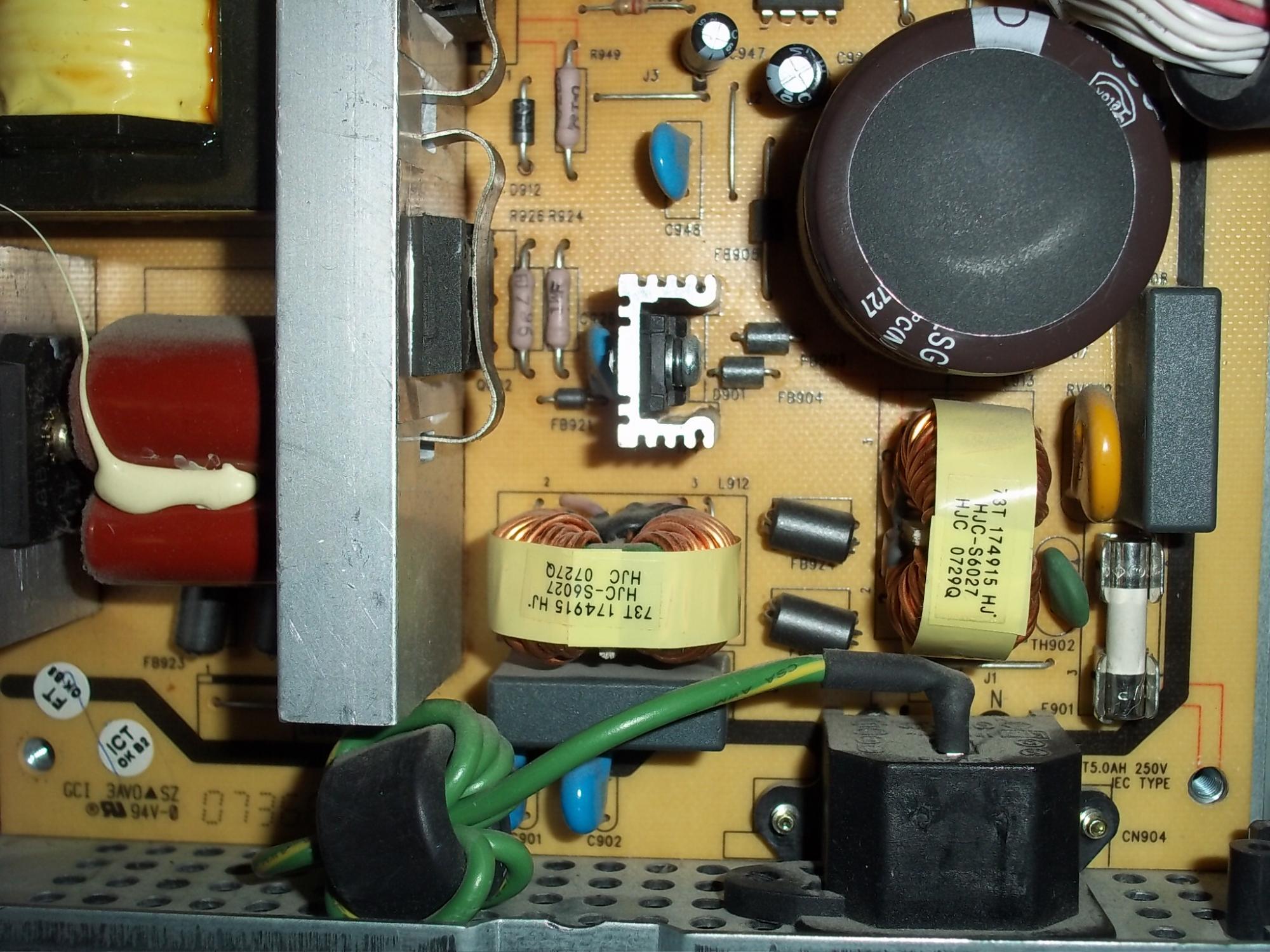

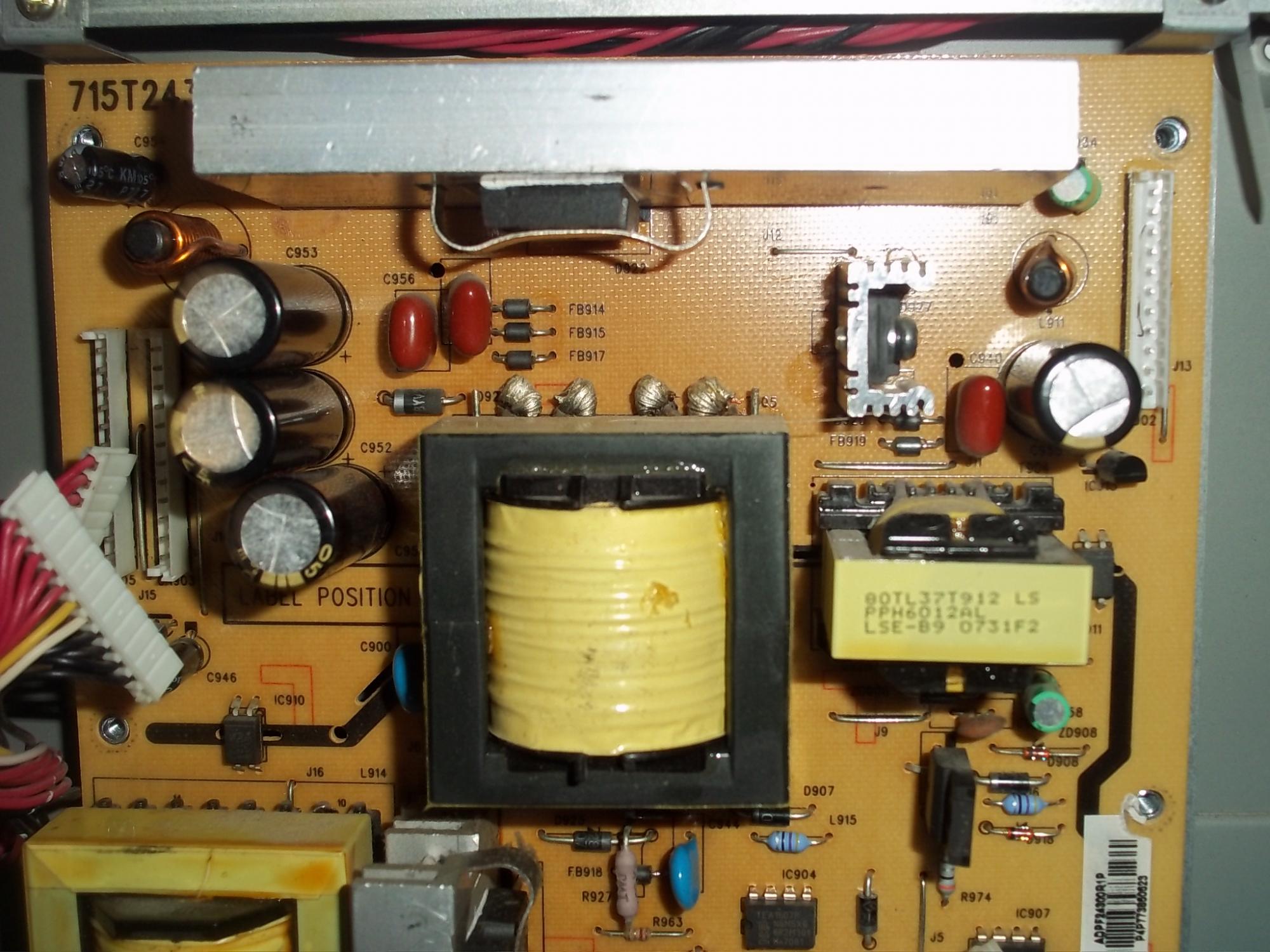

                    Originally posted by m1dp
                    fuse popped as soon as power was turned on to surge protector.

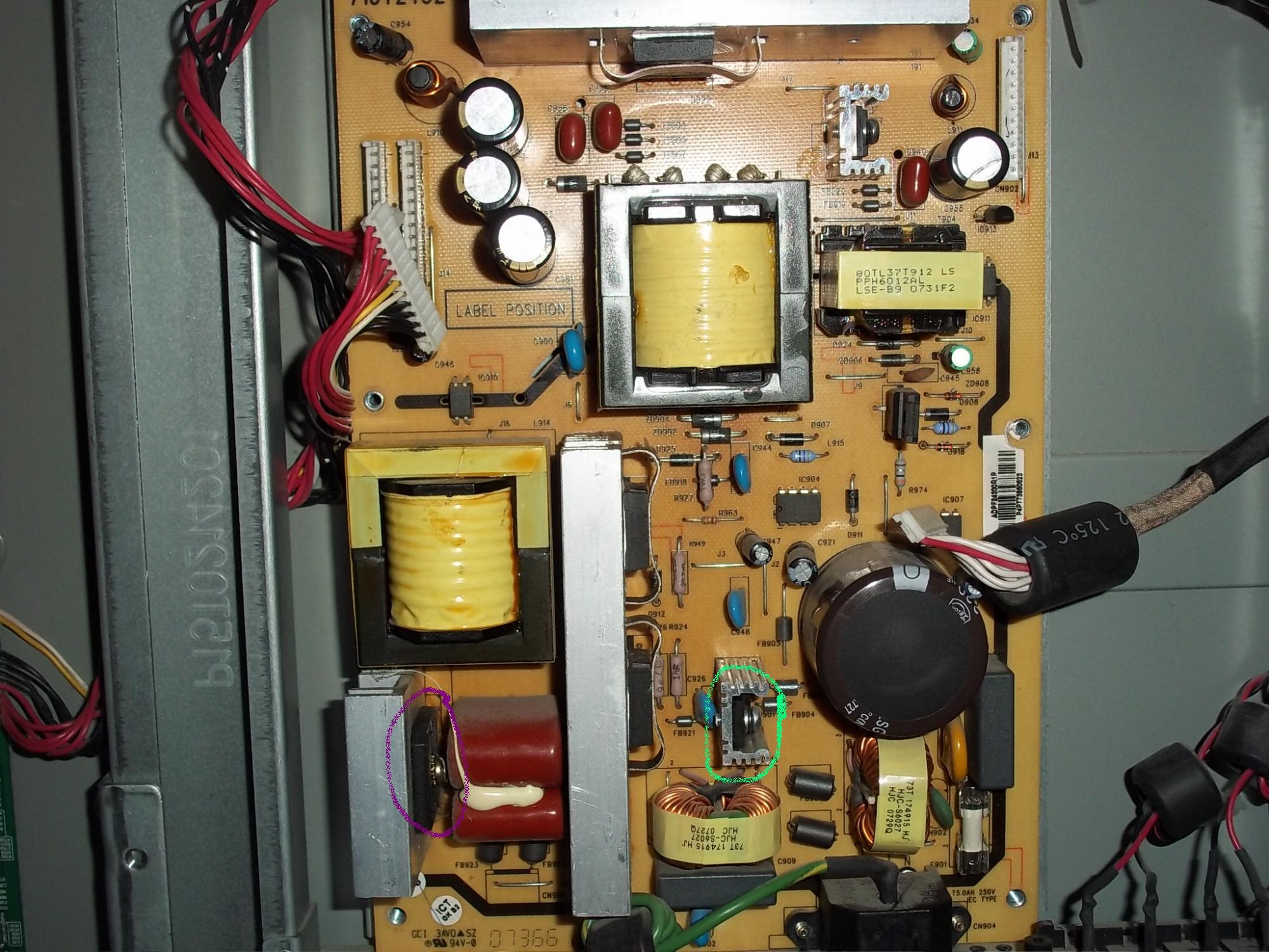

                    1) Circled in red is what I think is your power mosfet. Circled in blue is your bridge rectifier. Check both of them for shorts.
                    2) For the power mosfet, number the pins 1, 2, and 3. Measure the resistance between pins 1-2, 1-3, and 2-3. Any reading under 30 ohms suggests a short and must be desoldered and retested out of circuit.
                    3) For the bridge rectifier, number the pins 1, 2, 3, and 4. Measure the resistance between pins 1-2, 1-3, 1-4, 2-3, 2-4, and 3-4. Any reading under 30 ohms suggests a short and must be desoldered and retested out of circuit.
                    4) I noticed you didn't replace ALL the electrolytic caps on the power board. I see green Lelon and possible more small Capxon caps.

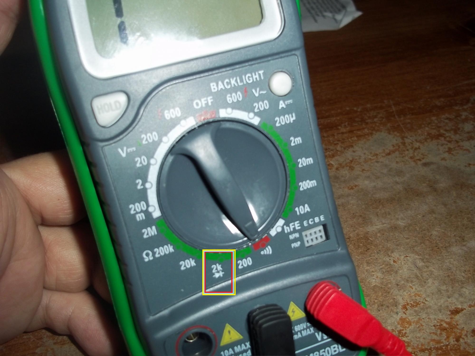

                          • m1dp
                            • Feb 2012
                            • 16
                            the power mosfet you circled is 4 pins, the bridge rectifier is two pins.

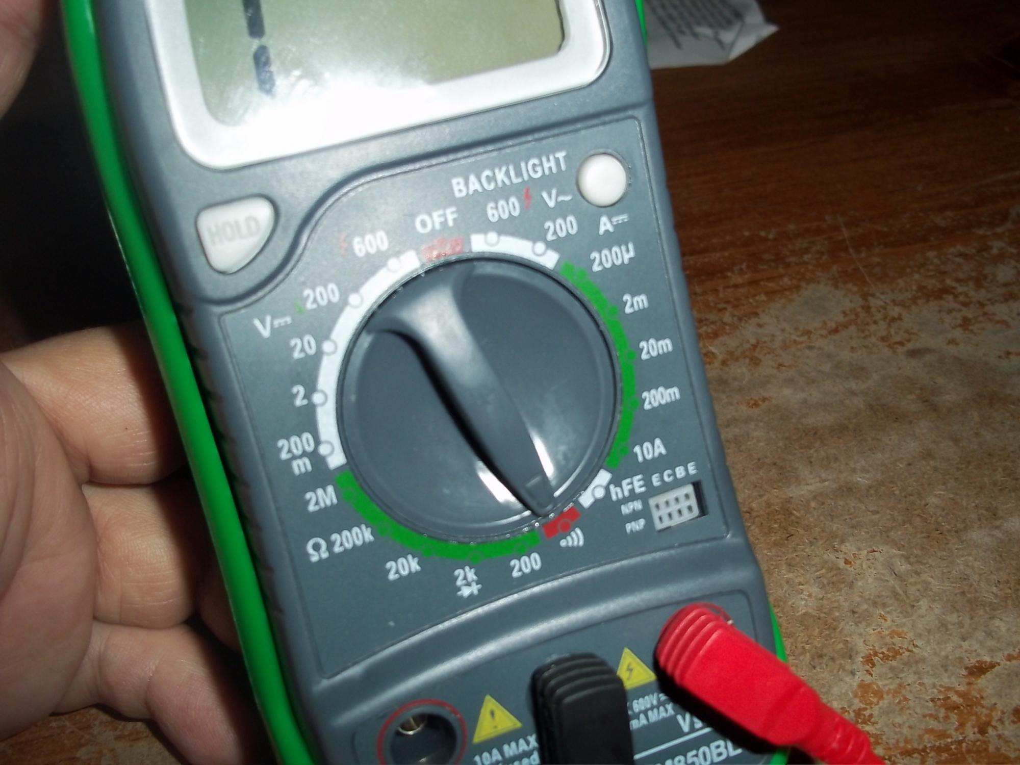

                            will you please tell me what setting to use for ohms? i am only getting results from the continuty beep setting. also notice the smudge on the big brown lelon does it look bad to you and can that be the fuse popper?
                              I think the one in RED circle is the Bridge rectifier (4 pins), and the blue with 2 pins is the AC line filter cap.
                              • retiredcaps
                                • Apr 2010
                                • 9271
                                Arrgh, let's try this again. It is hard to tell from the angle of the photo and I can't read the pcb designations.
                                1) In purple, I think that is the bridge rectifier.
                                2) In green, I think that is the power mosfet.
                                3) Set your multimeter to 200 (two hundred) ohms.
                                See the section on multimeter below
                                https://www.badcaps.net/forum/showpo...4&postcount=19
                                and mistakes
                                https://www.badcaps.net/forum/showpo...2&postcount=31

                                  i removed the power mosfet you circled in green and was getting jumpy readings with the 200 ohms setting. I noticed on the pcb in front of the chip is a voltage drop sign so i adjusted to the 2k ohms with voltage drop setting and got no change one way and a reading of .454 ohms the other.
                                  • m1dp
                                    • Feb 2012
                                    • 16
                                    I now removed the bridge rectifier and like the mosfet am getting jumpy readings do thes indicate shorts?
                                    i've tried every pin combination. some do stay at, 1. ,with no change and others jump high then back to 1. on the 200 ohms setting. the only results i am getting that stay steady on are when i change the meter to 2k voltage drop. anyway you can clear this up for me so i can get the proper results you need

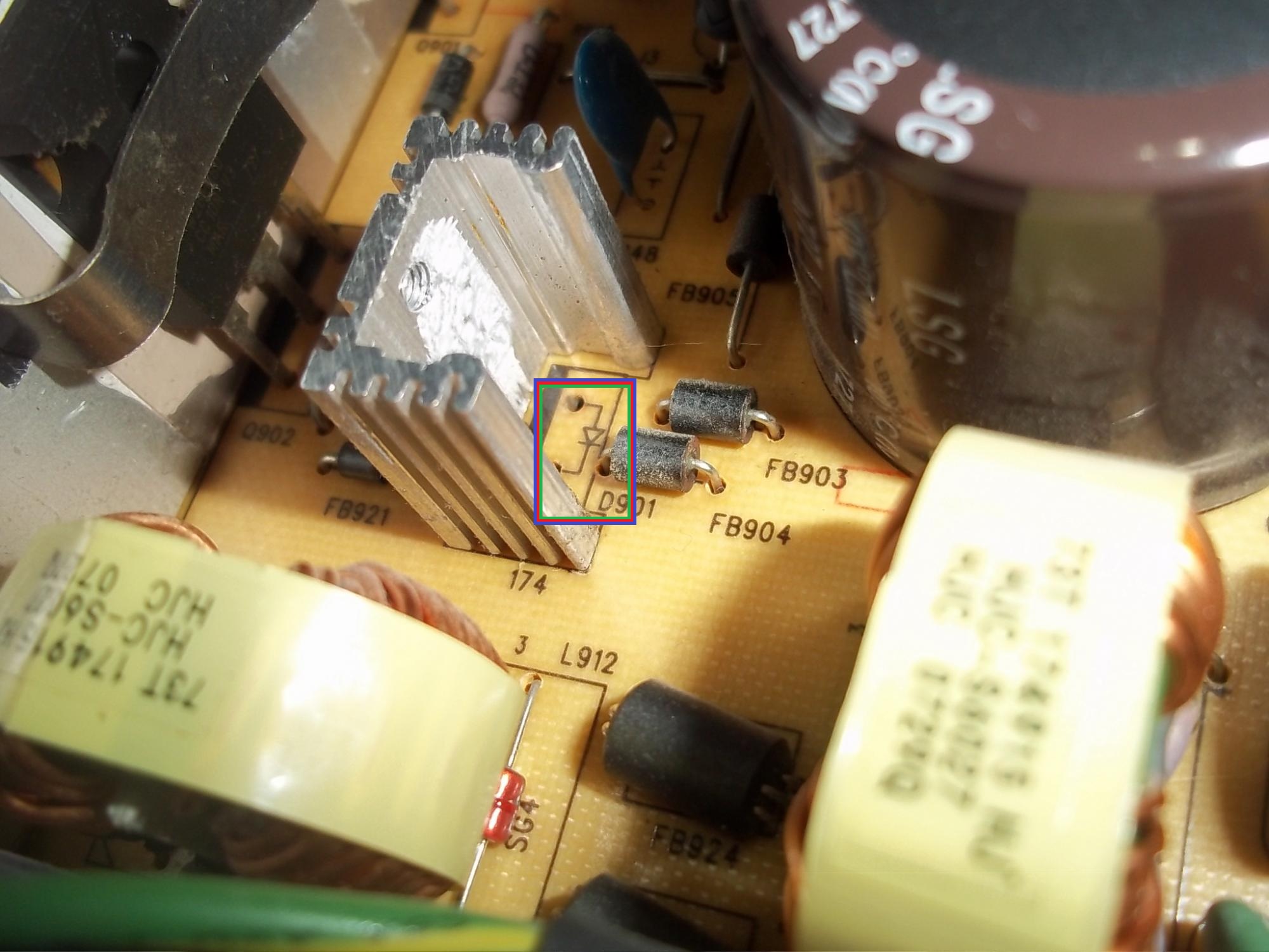

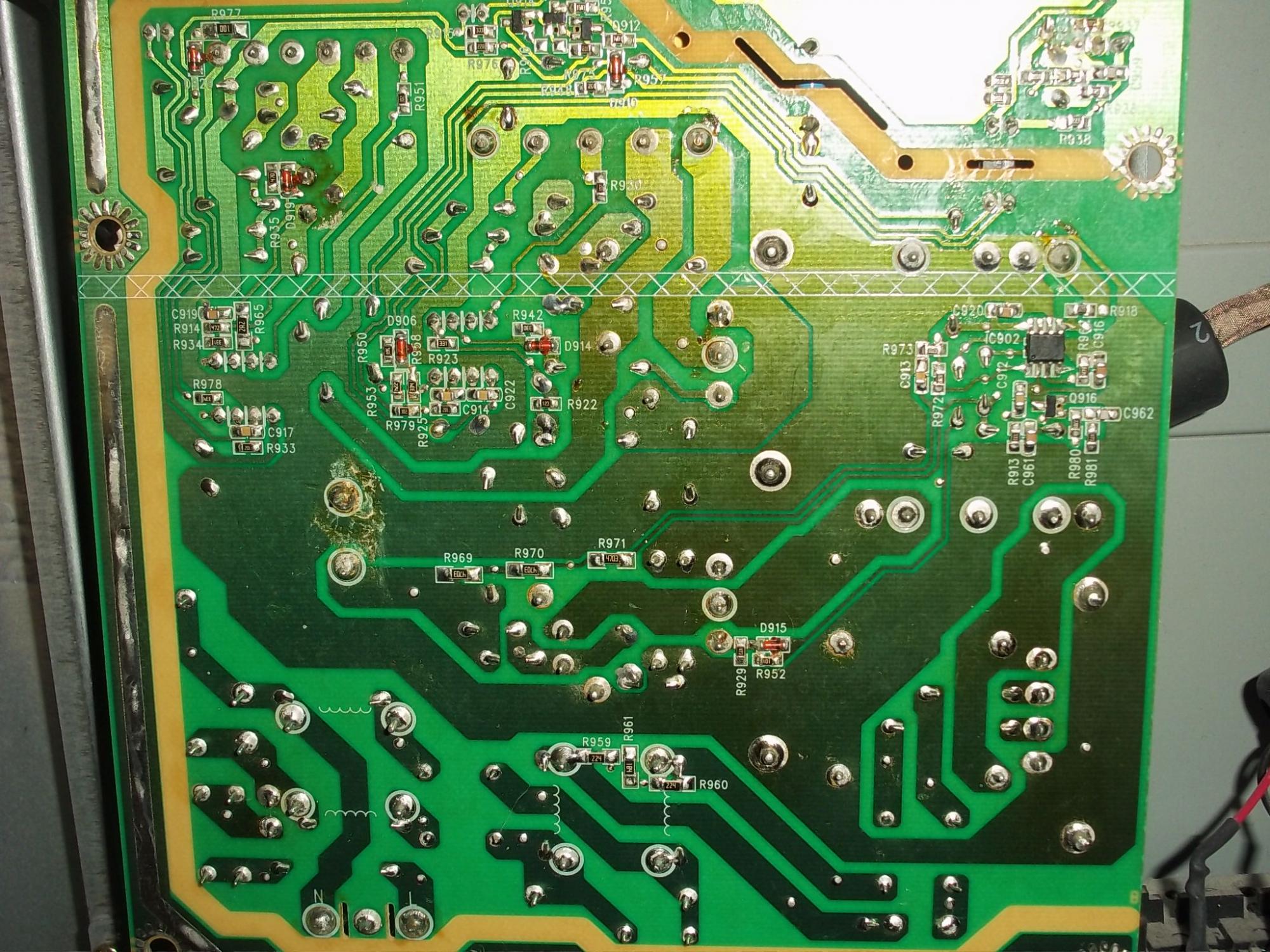

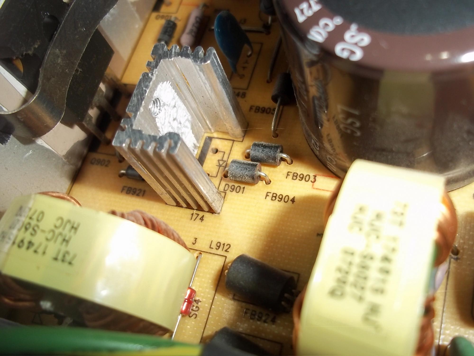

                                    • Mr Bill
                                      • Nov 2011
                                      • 648
                                      https://cdn.badcaps-static.com/pdfs/...8a934e8c25.pdf
                                      http://www.youtube.com/watch?v=dqkT6hF0O3E Here is a link on how to check a bridge rectifier. Your multimeter needs to be in the diode function (picture below).
                                      The ??mosfet?? you removed actaully looks like a diode (marking on board) The mosfets might be the 2 chips behind that one with the 2 bands clipped on them. Can you get a photo of the 2 chips?

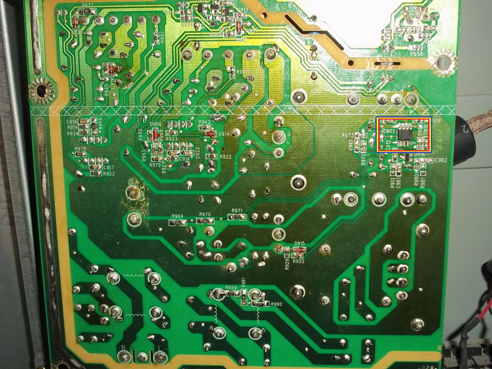

                                      Also, I circled a chip on the backside of the power supply, can you make out the numbers on it. Its a real pain but sometimes you get lucky, a magnifying glass helps.
                                      • Lobo
                                        • May 2010
                                        • 59
                                        I have the exact same TV and PSU and the best I can make out on the chip is
                                        SG6961S7
                                        B1AG2897728E
                                        Hard to tell if the first digit in the second row is a "B" or an "8", I just guessed B.
                                        Also, the "mosfet" is actually a diode.
                                        STTH8L06FP
                                        GK0G7 VU
                                        CHN 725
                                        The chip behind it in the picture is a mosfet.
                                        W26NM60
                                        CC126 V3
                                        MAR 719
                                        The one next to it (not in the pic)
                                        W18NK80Z
                                        CC099 VW
                                        MAR Z25
                                        Hope that helps
