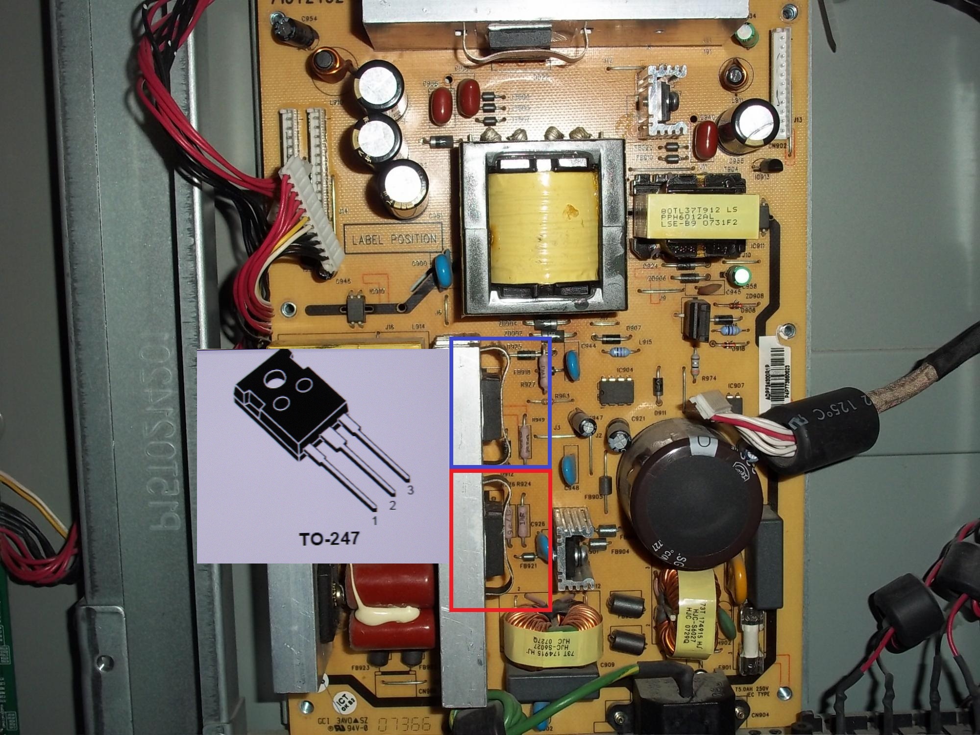

    ok here we go,
    W26NM60 (red) & W18NK802 (blue) are your power mosfets. Check them for shorts (under 30 ohms). I clipped a pic on your photo to help you. Check pins 1-2, 1-3, 2-3

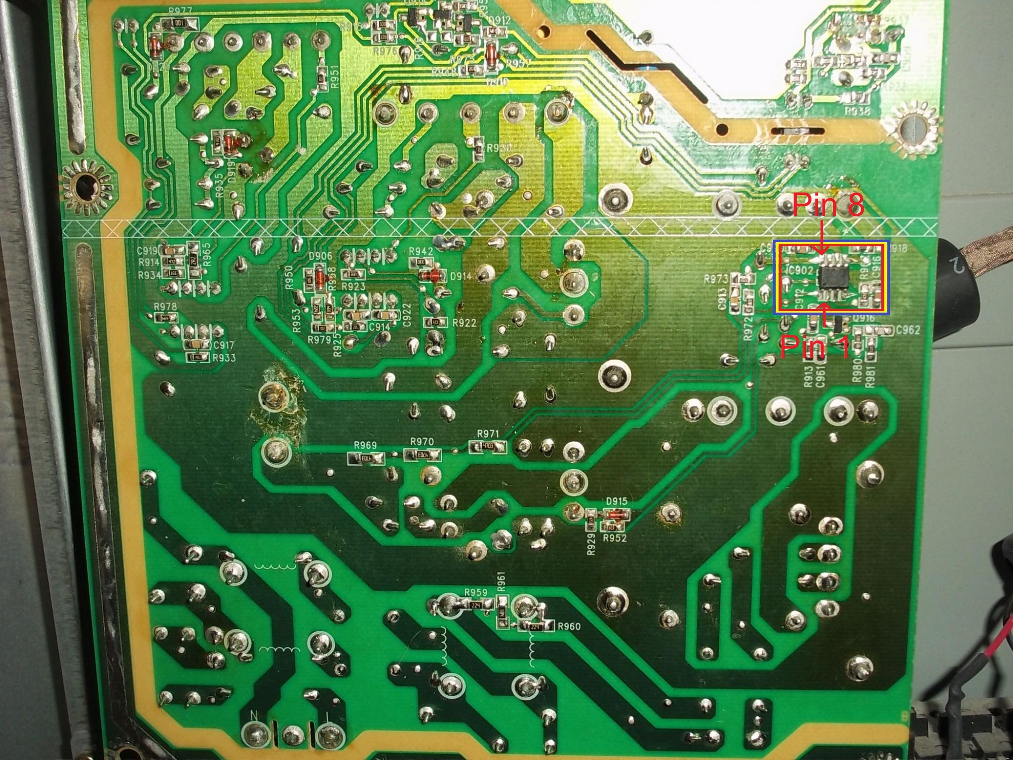

    IC902 on the back of the power supply is your Power Factor Controller (PFC). Assuming the dot on the chip is pin #1, check between pin 6 & 8.
    Both above check with meter on the ohms setting (Ω). The 200 scale will work fine. Anything under 30 ohms will need to be removed from the board and checked again. If they are good the meter is going to display either 1 or OL because its going to be in the (k) or (m) range and thats well above 200.
    I had a bad pfc controller that shorted out and took the fuse with it. Let us know the results.

          Re: Philips 42PFL5432D/37 I May Have Made my Problem Worse
          removed mosfet you circled in red test results
          with positive on pin 1 to pin 2 =no change or 1.
          positive on pin 1 to 3 =no change or 1.
          positive on pin 2 to 1= no change or 1.
          positive on pin2 to 3 = no change or 1.
          positive on pin 3 to 1 = no change or 1.
          positive on pin 3 to 2 = .514
          all under 2k. i tried to use 200 setting but the number goes away too fast and is never the same
          Now, the chip on the back. With positive on pin 8 to 6 is no change or 1.
          positive on pin 6 to 8 is .651 did i do this correctly or did you need me to test all combinations? just trying to be thorough.
            here are the results from mosfet circled in blue
            positive on pin 1 to 2= .003
            positive on pin 1 to 3= .003
            positive on pin 2 to 1= .003
            positive on pin 2 to 3= .000
            positive on pin 3 to 1= .002
            positive on pin 3 to 2= .000
            • Mr Bill
              The one i circled in blue appears to be shorted. What setting did you have on your multimeter? The one you got .514 (red) maybe ok if you had the multimeter set to 2M. It would be .514 Mohms. For giggles retest with the highest ohm setting your meter has which i believe is 2M. If its shorted you should still get a value under 30 ohms.
              As for the pfc chip on the back. I uploaded the datasheet. Ground and ZCD are the 2 corner pins. So atleast try the other 3 corners. If its under 30 ohms then its bad but i'm leaning towards the one mosfet (blue)
                the setting i use is the 2k setting it has the " -->l-- " symbol on it i posted a pic of it on post #14. i tested the bad mosfet under 2m, 200k, 20k and all pin combinatons tested .000. i tested good mosfet got no change or 1. on all pin combos. (under 2m, 200k, 20k) so now i searched for the replacement and found that it is an obsolete part (http://search.digikey.com/scripts/Dk...Words=W18NK80z). i got on help chat with them and they recomend this (http://search.digikey.com/scripts/Dk...-5-ND&x=7&y=11) do you guys think the specs are close enough?
                then on the pfc, with red on pin6 (gnd) to pin 7 (gd) i get reading .115 then i switch red to pin 5 then back to six the reading changes to .026 (under 30 ohms .030 indicates short right?) should i just desolder and test out of circuit? sucks cause digikey says this part is also Non-Stock. http://search.digikey.com/scripts/Dk...Words=sg6961sz i am alsso thinking some other diodes went bad causing the mosfet to go bad or does the pfc control the mosfet?

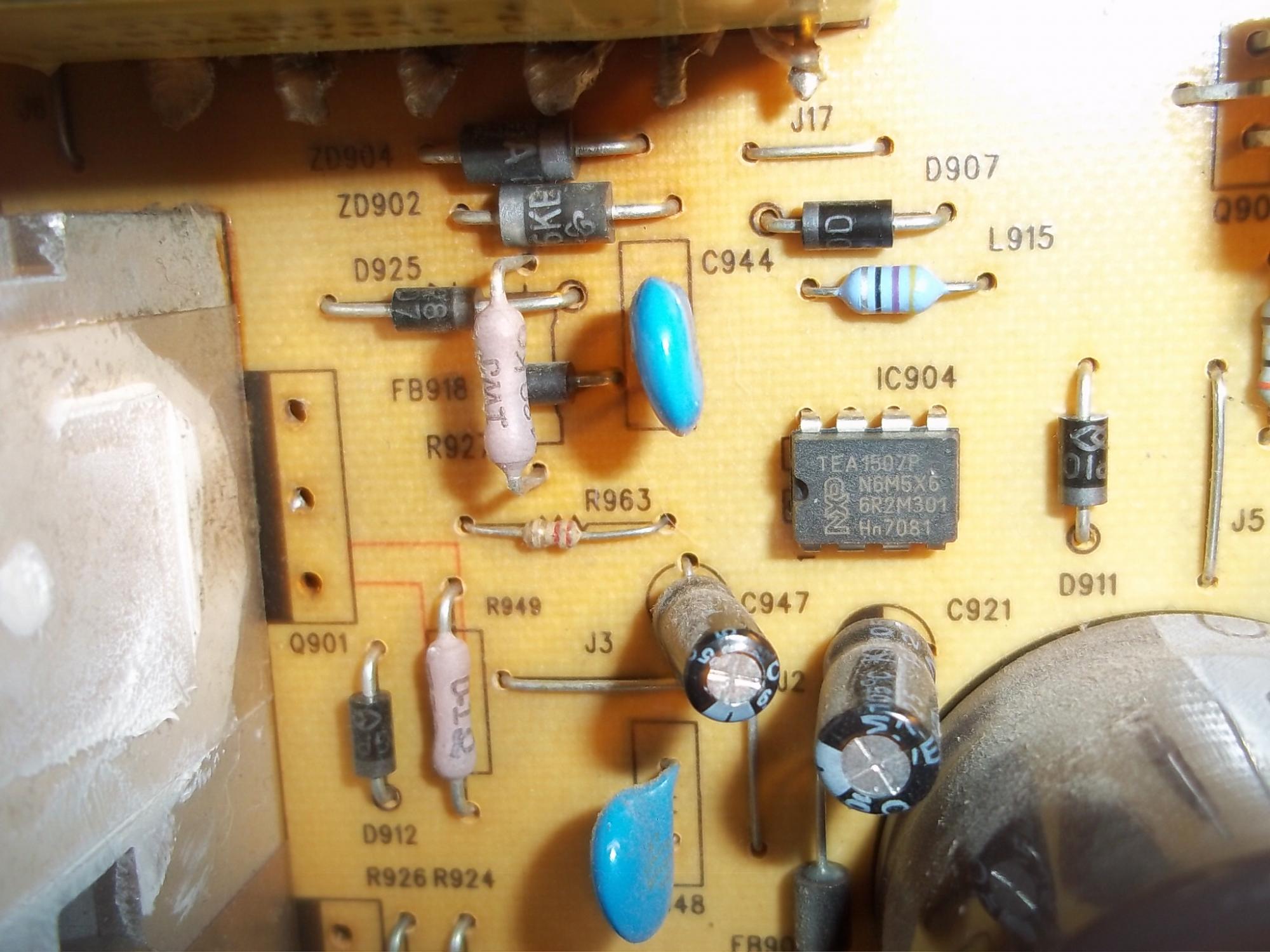

                  diode readings all "in-board"
                  BLACK DIODES IN PIC
                  zd 904 .638 reverse no change or 1.
                  zd 902 .638 reverse 1.
                  d 907 .555 reverse 1.
                  d 925 .533 reverse 1.
                  fb 918 .000 reverse .000 ??
                  D 912 .000 reverse .000 ??
                  d 911 .564 reverse 1.

                    #29
                    D912 is bad. Remove from the board to verify.
