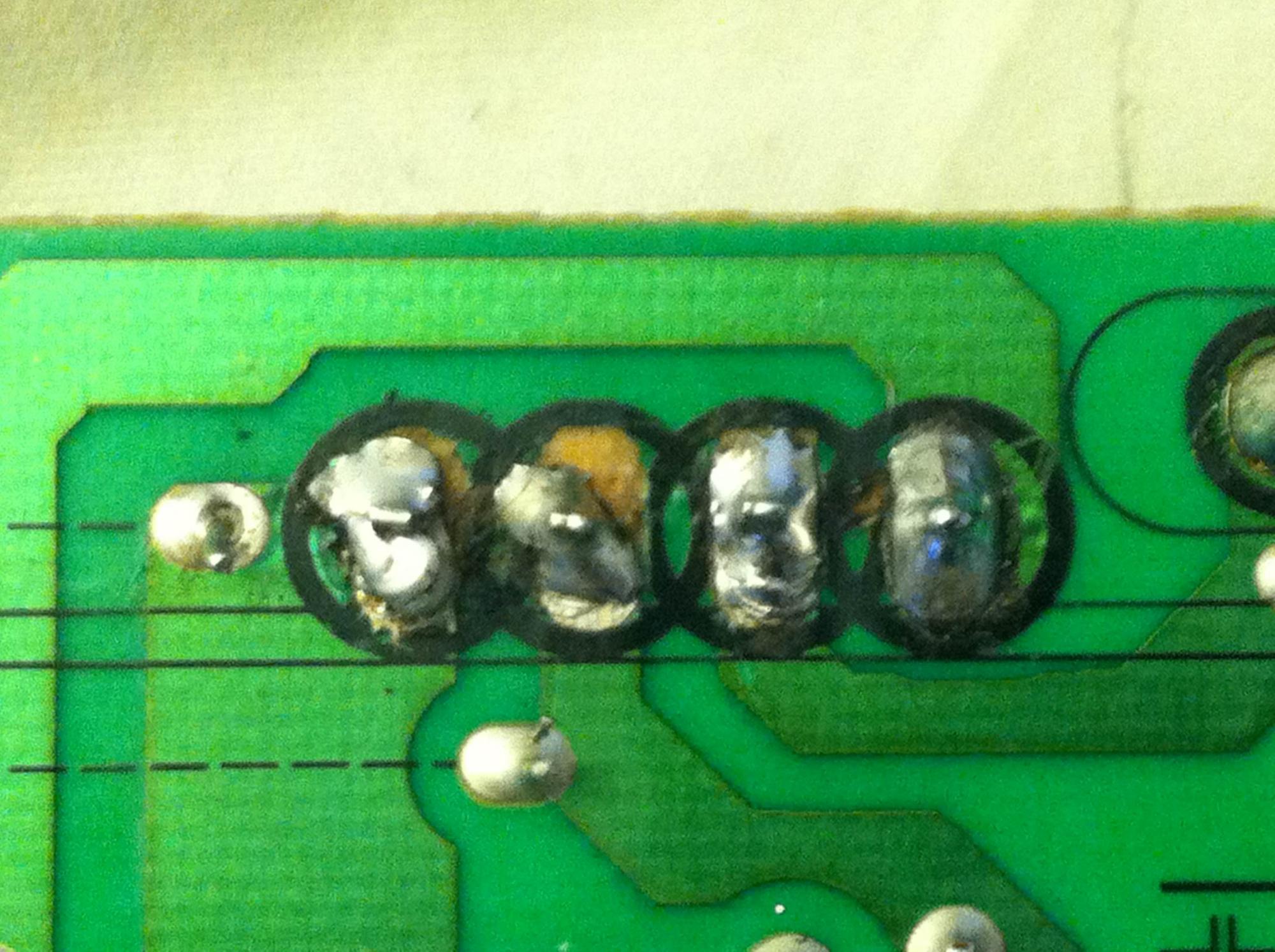

                                    After looking over the board, it looks like everything is intact. Aside from a nice scorch mark under the bridge rectifier, everything looks good. No shorted mosfets, no blown diodes, etc.
                                    Under the bridge rectifier is another story. It isn't shorted out, but between one of the AC legs and the + leg there was a nice burn. I think it arced between those two and that's what tripped off the fuse.
                                    Now a few pages back I mentioned how I was getting some burning that was between those same two leads. Before I just cleaned it up real good with some rubbing alcohol as there was a nice layer of flux. I'd like to clean up the rectifier connections so this can't happen again. Unfortunately the last owner really made a mess of these connections. It looks the pads are starting to lift. Attached is a picture of how they look now, if you think of the connections from 1-4 from the left to the right, the spark was between 3 and 4.
                                    I think connection 4 looks good, the others need some work. Any tips on how to fix them? 1 and 2 are the pads that were lifting off.
                                    Edit: when cleaning the connections with rubbing alcohol I noticed it arced bad enough to pit the circuit board a little. Nice.

                                      What I do is to remove the solder, then scrape off the green coating on the PCB to expose the copper layer, the n wrap small piece of wire arounf the pin and solder the wire on the leg and the other end of the wire will be soldered to the exposed copper. It sounds like it did not have good connection on the old joints. Make sure to clean off any solder residues, carbon marks, etc. real well, also make sure there is no solder splatter from the previous works. Ohm thing out when you are done.
