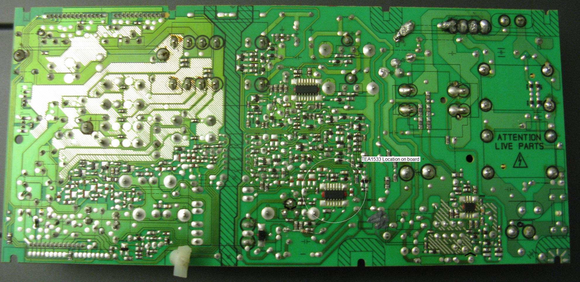

                    3) On the top heatsink marked "Danger" what is that big IC mounted on the heatsink? Maybe that is the power mosfet?
                    4) On the back of the power board, there are two 16 pin ICs. One is the TEA1533. What is the other part number?
                    5) Also can we get a close up picture of the new TEA1533 installed?
                    6) Can you also identify/point out where TEA1533 is on the back?
                      TEA1601T
                      See attachment, I used my camera phone. It's my first SMD soldering attempt, so it may not be the best.
                      See attachment, it is circled in white.

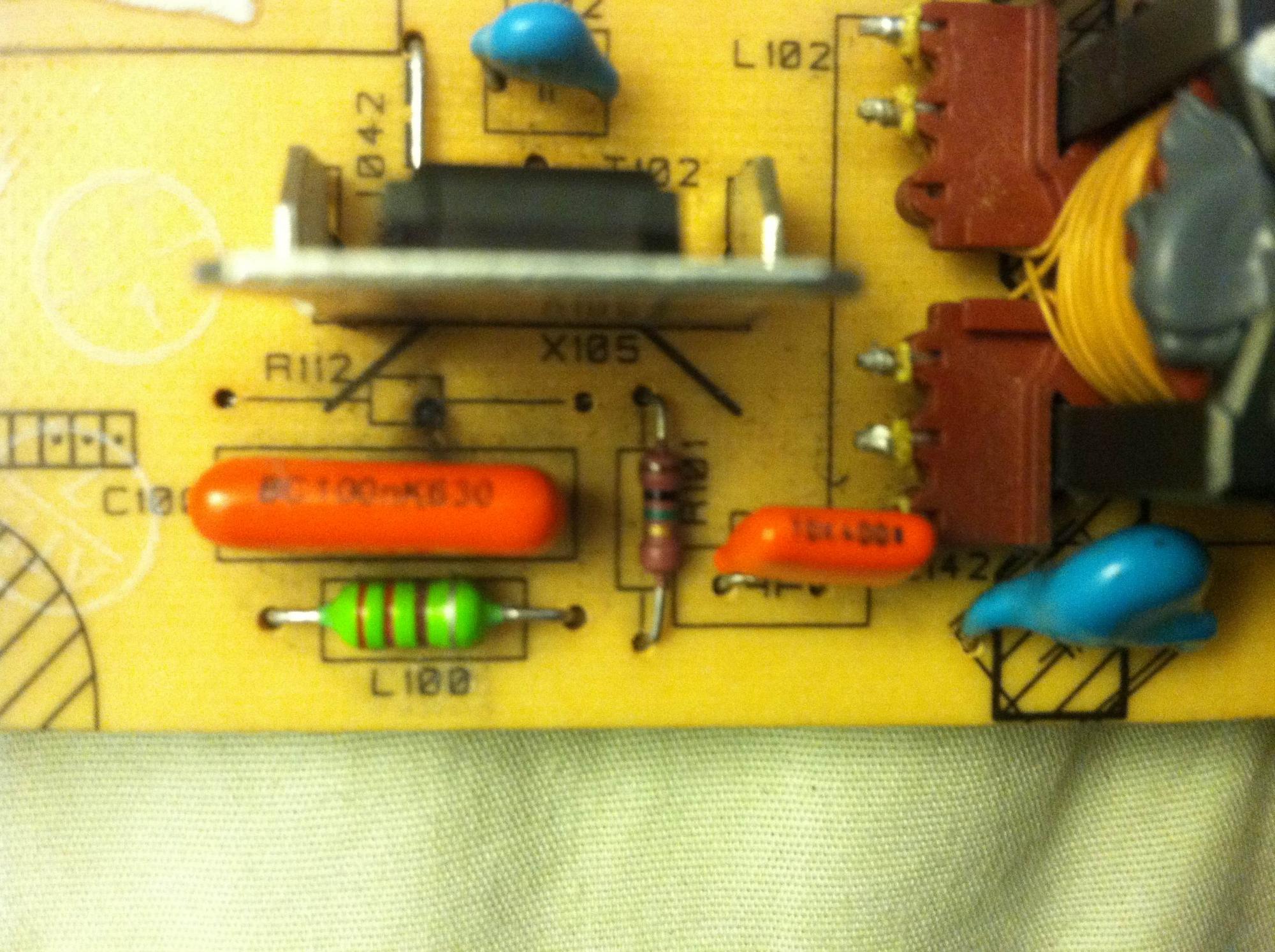

                          On both the red dot and the blue dot, the voltage is 0.16v.
                          The blue dot connects to the drain of the TEA1533AT, or pin 14. I did not detect any solder bridges.
                          The patch resistor was installed by the seller. On the top of the board where the resistor originally ran, you can see a burn mark. Looks like the whatever happened burned up the original resistor pretty good.

                            #33
                            Re: Philips 32PFL5322D/37 power supply repair
                            Can we get a close up picture of that?

                                    #37
                                    1) Do the pads of R112 have any continuty to the big cap?
                                    2) If the patch resistor is really R112, I wonder if you should desolder it from the backside and put it back on the front side properly?

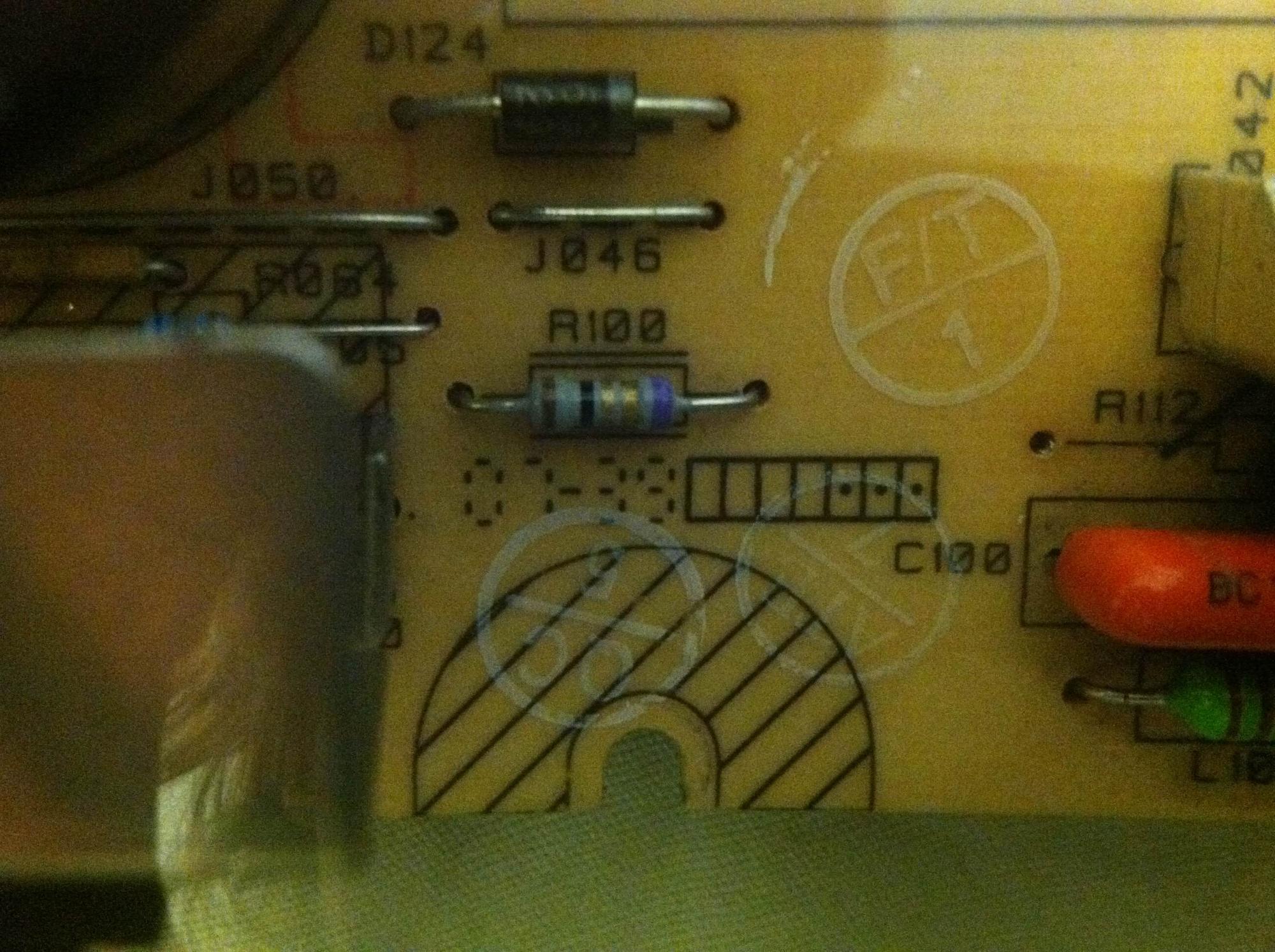

                                    3) I hope you see what I'm trying to do here. From the big cap, we have 166V DC and somehow it is disappers before it reaches the red dot on the patch resistor.
                                    1) No.
                                    2) Judging by the looks of the resistor, the leads were too short to fit across the span between the pads, so it was added to the bottom. I may go buy a new one with longer leads so it will be in the right place.
                                    3) I do see what you are trying to do here. I started tracing with my meter, starting at the big cap. Power is not applied, just using diode test mode. I made it not very far and I encountered a glob of glue. After picking some of it away with my fingernail, I found a lead under it. Wouldn't you know, it is connected to the main cap! Looking around, I found it is actually R100, which can be seen in my overall picture. I put my meter across R100, and bingo! Open circuit. I even cranked it up to the 20 megaohm range, and still open circuit. Looks like an open resistor!
                                    Now my problem is: I have never seen a resistor with this sort of color scheme on it. It has Brown-Black-Gold-Gold-Violet.

                                      #38
                                      Post a close up picture so we can see it.

                                        #39
                                        See attached.

                                          #40
                                          I should add, that when I start on the other side of R100 and continue my journey towards the patch resistor, everything is connected (as it appears it should per the conversation in this thread). R100 goes to L100 (inductor?), which is connected to the primary side of the transformer, and then to the patch resistor, and finally the drain of the TEA1533 controller.
