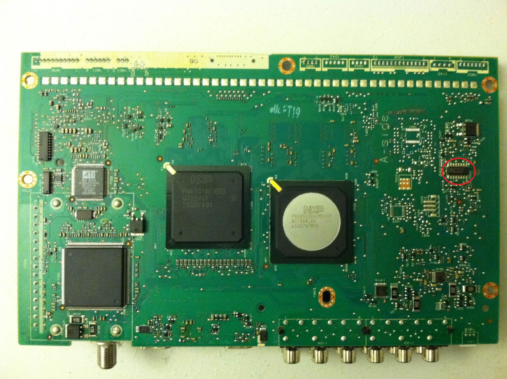

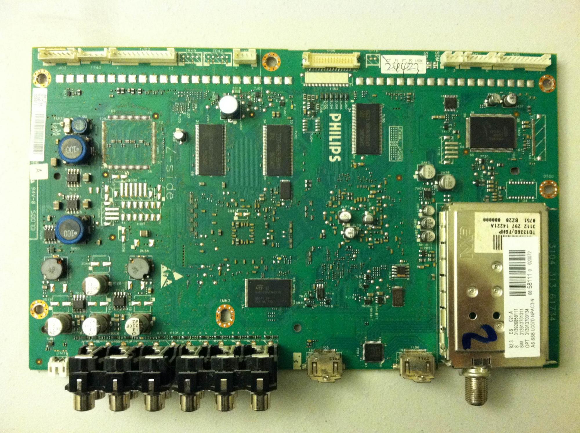

                  • rpgruss
                    • Jan 2012
                    • 124
                    #69
                    Re: Philips 32PFL5322D/37 power supply repair

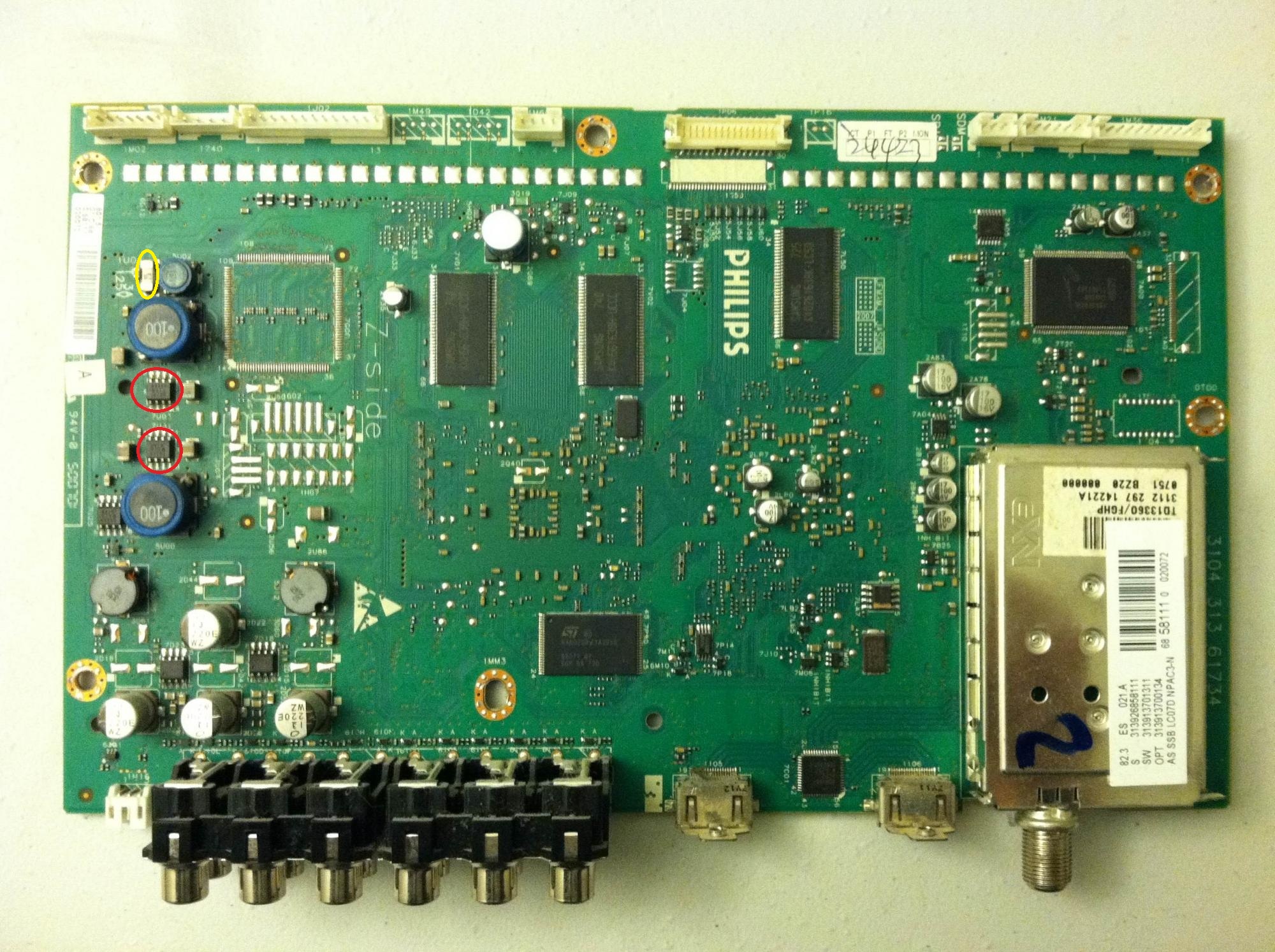

                    Attached are pictures of the SSB.
                    • PlainBill
                      • Feb 2009
                      • 7034
                      #70
                      On front:
                      Yellow circle - fuse, check if it is open.
                      Red circles - power FETs - check for shorts.
                      On Back:
                      Red circle - dual DC-DC controller - replace if FETs are shorted.
                      PlainBill
                      • rpgruss
                        • Jan 2012
                        • 124
                        #71
                        Bill, I don't see your picture, but I checked fuse 1UO1 and fets 7UO1 and 7UO3 which are discussed in the manual, I did not find any shorts and the fuse is good. I'm going to plug the board back in and see if any of the voltages are present so I can follow the troubleshooting steps in the manual.
                          Duh!!
                          Note to myself - don't assume similar problems have a identical cause. It could be a problem 'downstream' in the 1.2 Volt supply, or even an excessive load.

                            Trying to read the service manual, and for some reason I can't figure out where I'm supposed to read 1v2, 3v3, etc. on the board. All the manual says is check to see if they are present even for a short time, with no indication that I can see on where to read them from.
                            However, I went and retested the FETs that Plainbill circled. Before I tested off the datasheet looking for shorts. I'm assuming it is each one is basically 2 FETs in one? Anyway, I went did just a pin-by-pin check, and sure enough, the lower one is shorted between the lower left and the upper right pins.
                            I am going to start an order, but before I press ship I wanted to make sure there isn't something else I should be checking.
