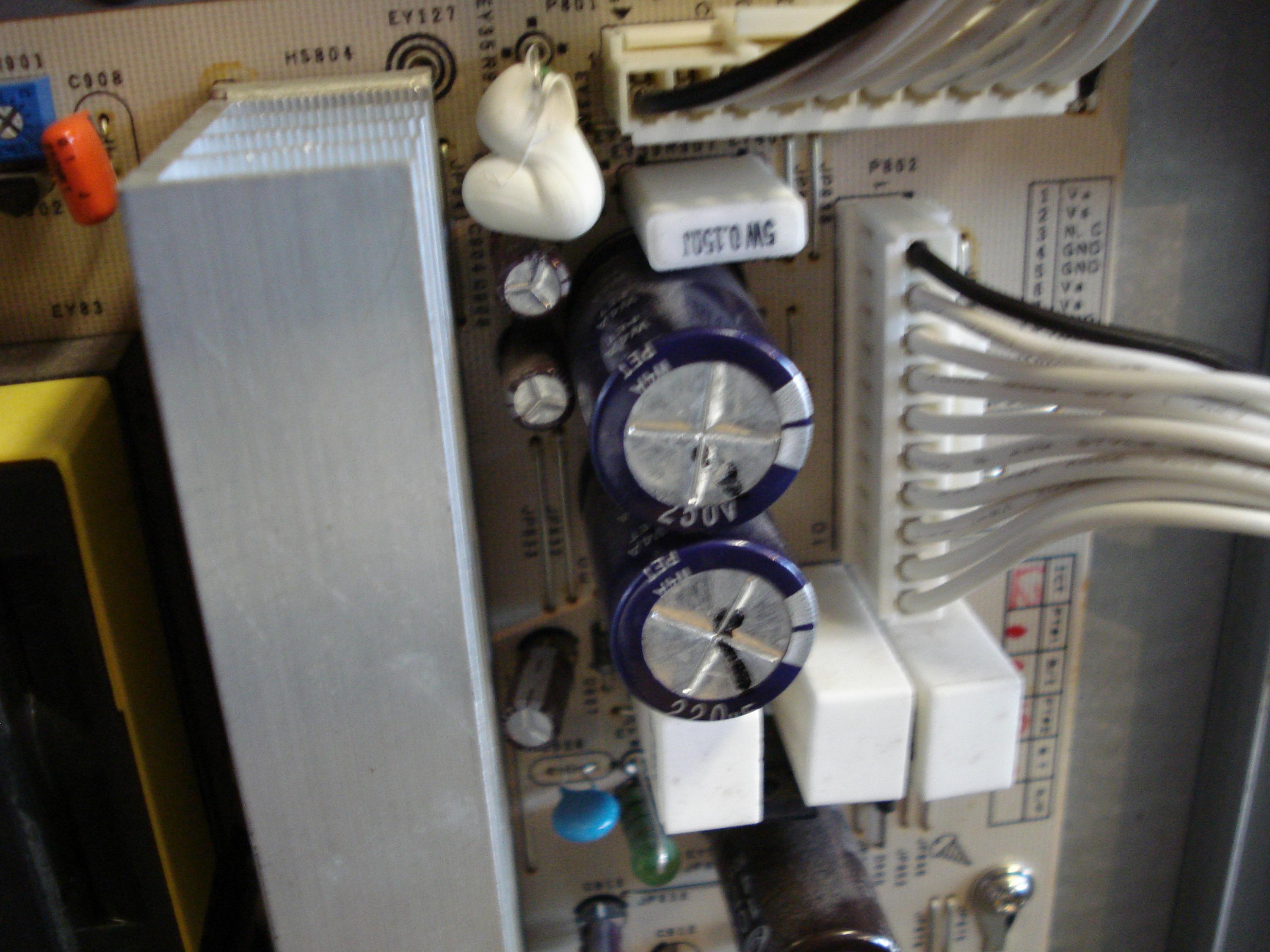

    What you need to do is find out where the fault is as it is heat related (as set warms up the fault occurs.)
    So use a hairdryer or other heat-producing device and heat up parts one by one, and see if you can make the problem occur much quicker.
    I'll do some re-soldering. I'll let you know later.

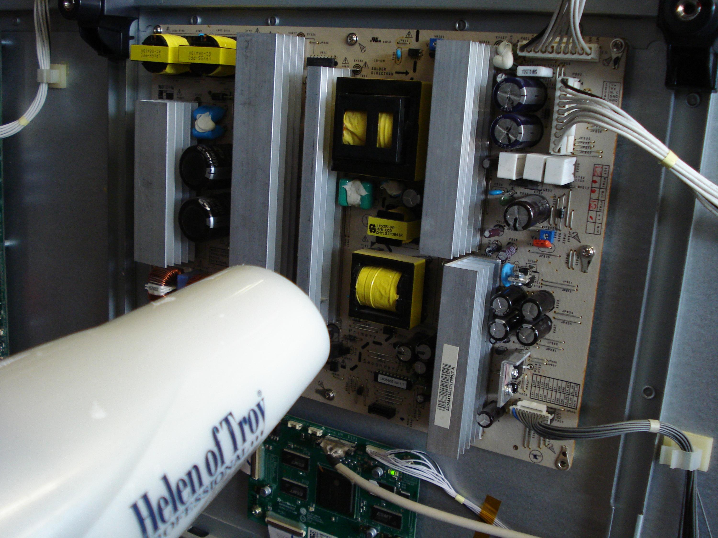

      I re-soldering lots of (but not all of ) solder points. Still do the same.
      I found out something you guys may help me out to understand.
      Hot air works! Cold air don't. Hot air blow can make tv works more than 15 minutes. I put a small ceramic heater behind TV instead of heat gun I used. TV last more than 30 minutes before it shut off. Then I tried to push ceramic heater little closer immediately some noise sound came out of back plus some smoke. Now I think power board are toasted. Ceramic heater might have some interference with TV electronically since is not even hot yet when I pushed it closer (about 10 inch from the TV).
      Now I'd like to know where I can find another power board or someone still think it is fixable.

          Smoke did not kill the power board. This morning I put hair dryer on low heat and aimed at up right corner of the board. It has been running ever since.
          Does someone can provide the explanation or fix for this?
            #105
            Re: A guide to fixing/troubleshooting some common plasma TV problems
            Can you try focusing your heat on those two cyan/turquoise objects (capacitors) gunked together, near the yellow transformers?
            You have temporarily given the TV some life. Enjoy it for maybe a day. It will likely fail in short order.
              Warm air has to focus on up right corner (as shown in the picture). The same place that producing the smoke.

                With TV off (& unplugged) shortly after running it can you feel the tops of those capacitors? Are any much warmer than others?
                  All three are warm (not hot) and about the same temperature.
