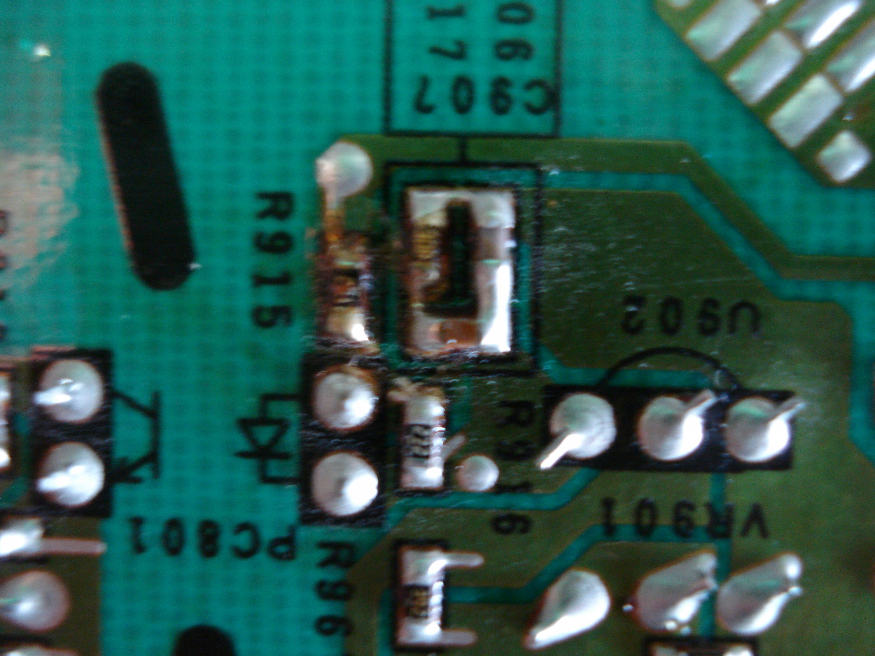

                                #95
                                LG 50pg25 power on and off after a couple of seconds.
                                This is best troubleshooting thread on line.
                                Tom,
                                I have lg 50pg25 will shut off from a couple of seconds to a couple of minutes after turn on. Every thing looks great when is on. What could be the problem?
                                Thanks in advance.
                                  #96
                                  Re: A guide to fixing/troubleshooting some common plasma TV problems
                                  Your problem is quite likely a cold solder joint on the power supply somewhere.

                                    #97
                                    Looks like these resistors have been burned. Can it be fixed? If so where can I buy them?
                                      #98
                                      Looks just like flux to me -- not a fault.
                                      What you need to do is find out where the fault is as it is heat related (as set warms up the fault occurs.)
                                      So use a hairdryer or other heat-producing device and heat up parts one by one, and see if you can make the problem occur much quicker.

                                        #99
                                        This is more clear picture.
                                        • jimmyking
                                          • Sep 2008
                                          • 32
                                          #100
                                          Here is front end. Those resistors are located between PC801 and U902 in the back. I really don't know much about this thing. Please help.
