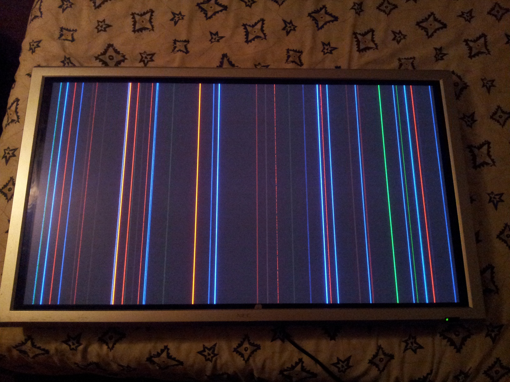

      Re: A guide to fixing/troubleshooting some common plasma TV problems
      That is most likely a bad plasma panel. Sorry, but it is not repairable.
          @tom66, i did place this in another thread, but i'm going to reply here to follow your reply. I did try to change the t con board and got the same outcome. Tab bonds? what does that look like or what do I need to do to repair it? Thanks for your wisdom! Shared knowledge is so awesome.

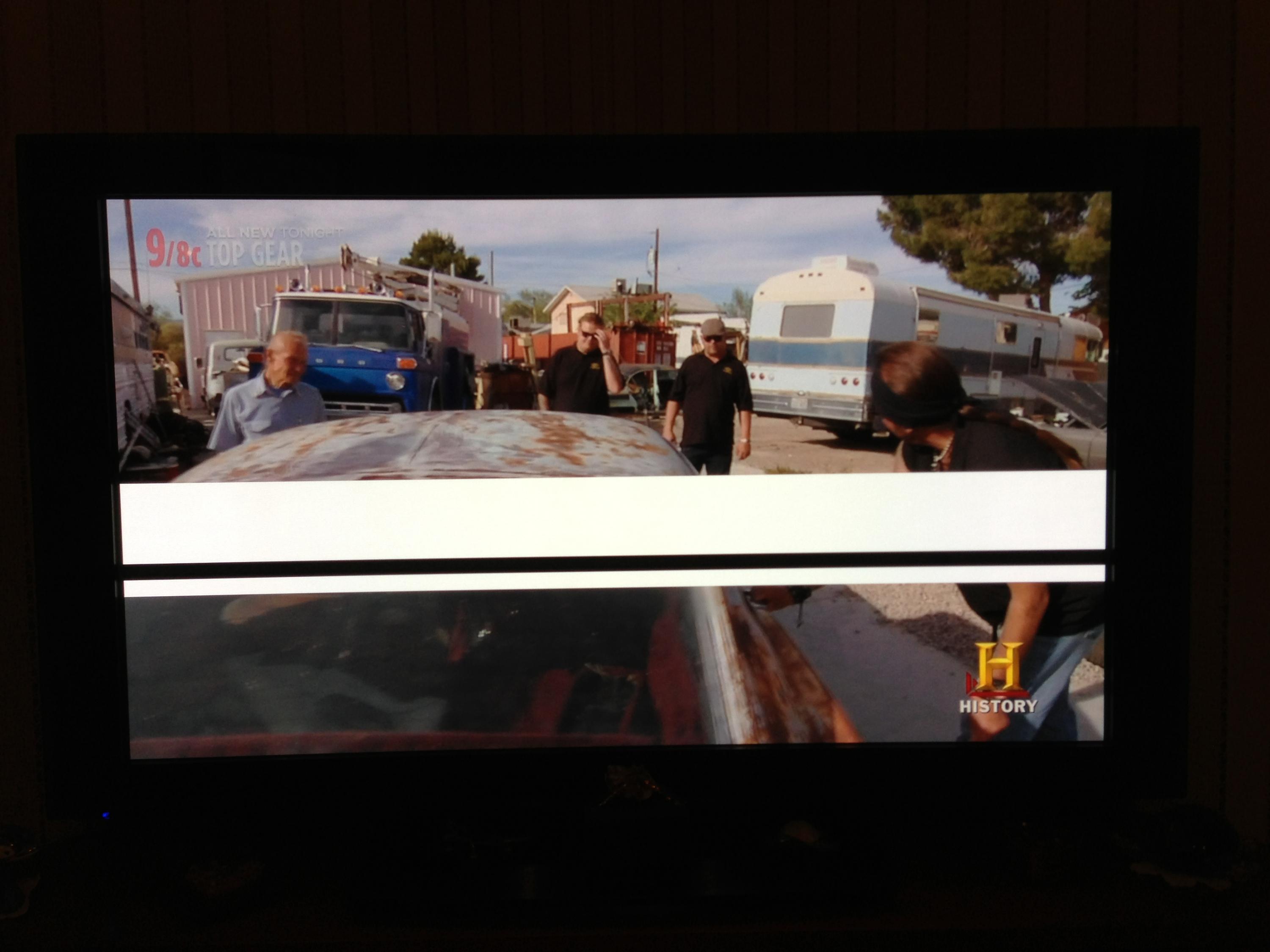

                  I own a Pioneer Elite FHD1 plasma that was purchased new many years ago. Yesterday, the set powered itself down with a fault (Red) code of 4. Now there is a large horizontal band running across the lower section of the screen about 3” from the bottom. It's about 5” wide, white with a 1 inch black band about 2/3 of the way down. The stripe shows on the screen when the monitor is initially turned on before the picture comes on only it is a muted grey. Occasionally the set powers down with the same fault code (4). I would appreciate hearing what you think the problem is…..
                    #49
                    That could be a bad plasma panel. A picture of the exact fault would confirm the diagnosis. 4 blinks possibly means short on plasma electrode. Unfortunately, it is probably not repairable.

                      #50
                      Could it be the Y Drive assembly or the lower buffer board? These are the boards listed for the fault in the repair manual.
                        Hmm, horizontal is left to right. Derp. Not top to bottom, which is panel failure. Left to right may be a Y-drive or Y-scan problem, more likely to be Y-scan (I think that's what Pioneer call them.)

                              #54
                              Here is a photo of the issue - the line remains the same if you switch to an input with no signal.https://www.badcaps.net/forum/attach...1&d=1360112045
                                #55
                                OK, I change my diagnosis. Definitely looks like a Y-buffer issue to me. I hope a panel fault did not damage the buffer, though, that is rare and only happens on certain older Panasonic plasmas as far as I am aware.

                                  #56
                                  Damn nice TV when working!
                                  OK, so do you think it is the drive board, the scan board, or could be either so better to replace both? I already ordered both boards, but they came out of an old FHD1 and are used.
                                    #57
                                    I think the SUS (drive-board) is probably OK, but the lower SCAN is bad.

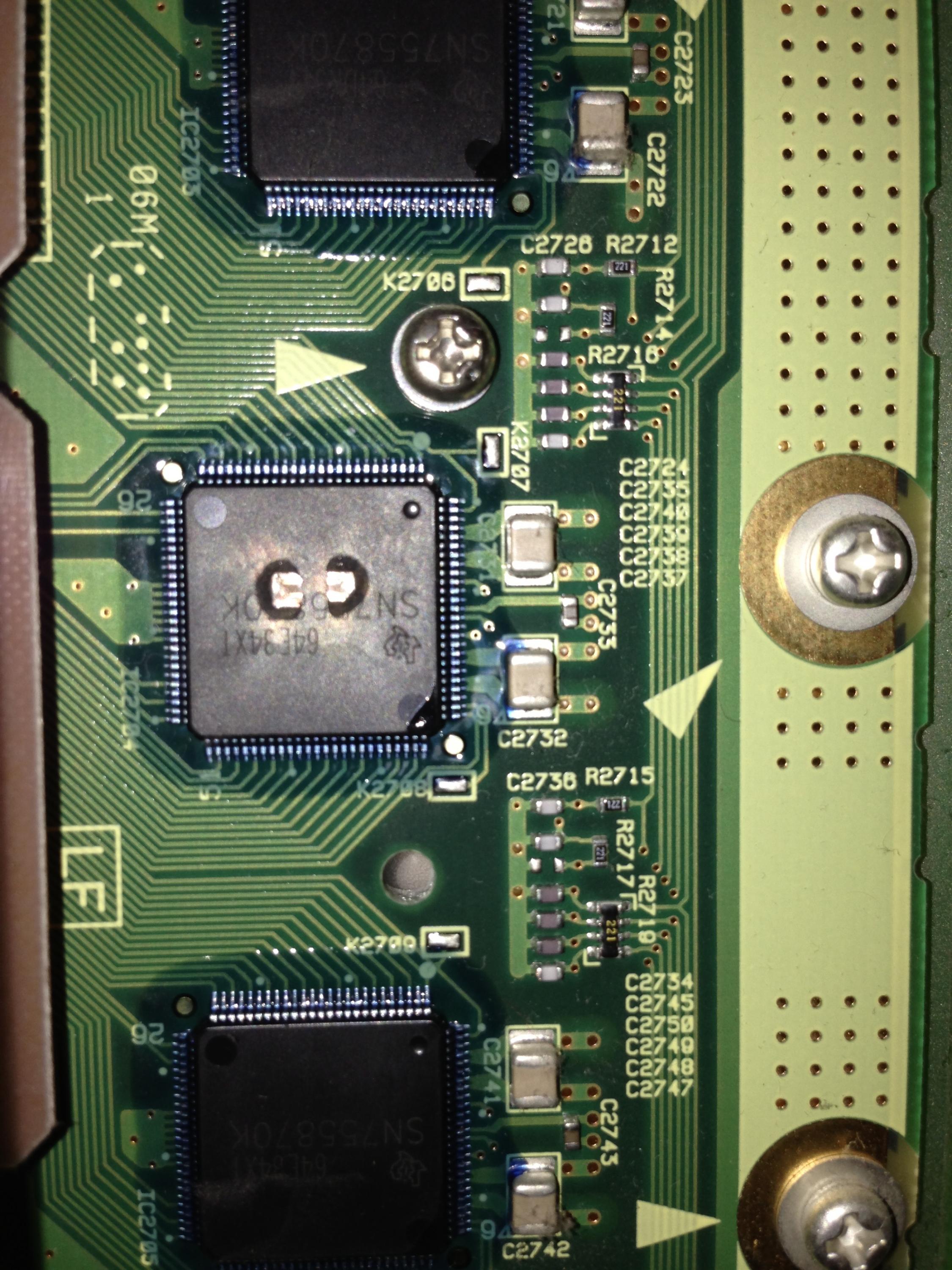

                                      #58
                                      Well the problem got worse today. The TV powered down and won't come on fully anymore. Turns on and powers off at the point when the picture normally comes on. So I took it off its base and opened it up in preparation for the part swap. I think I may have found the bad IC on the scan board (see Photo). I'm still up in the air on changing both boards at the same time or one at a time. Could the drive board cause the problem with the scan board?
                                        #59
                                        Yes, that IC is definitely very bad.
                                        The drive board (when it fails) usually kills either: all the ICs, or the top/bottom most IC. It's very rare for one in the middle of the pack to fail. And as far as I am aware, like most well designed TVs, a failure in the drive board on a Pioneer does not damage the buffer ICs.
                                        You should only need to change the lower board... however, if you've got both, swap both for longevity.
                                        I hope the panel is OK, because I know some Panasonic panel failures can damage the buffers. But I thought it only happened to certain older series. Don't have much info on Pioneer unfortunately.
