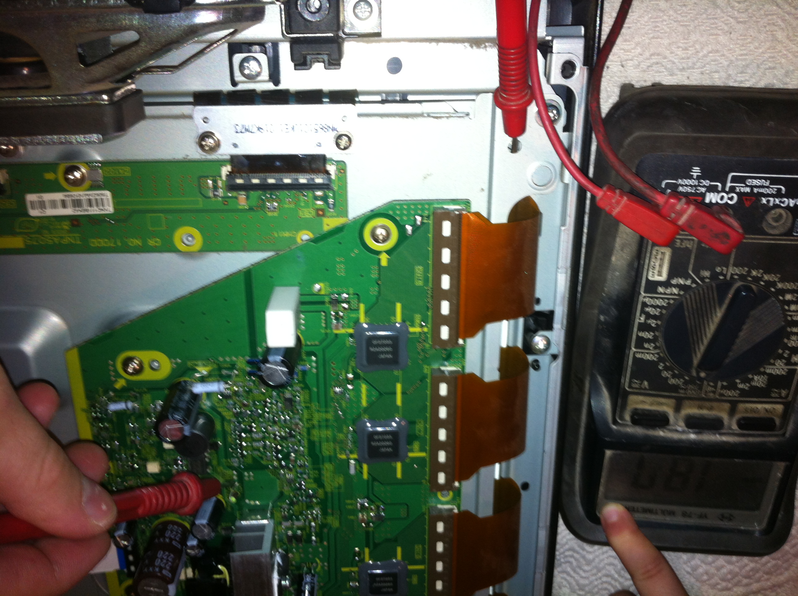

      Originally posted by tom66
      Range should be 1000V/750V. Set to DC mode. (AC is squiggle, DC is one broken bar and one solid bar.)
      Red probe on TPVAD/TPVSCN black probe on the metal chassis of the TV.
      TPVSCN reads 42V on both sides...TPVAD on on connection 187V..on other where the cap is reads 0V on bottom..and on top of the cap reads 187V! is that ok now ?
      picture is here...
        #263
        Re: A guide to fixing/troubleshooting some common plasma TV problems
        Is your VAD positive or negative? If your Vscn measures like that, I think there is a problem with the SN board you have.

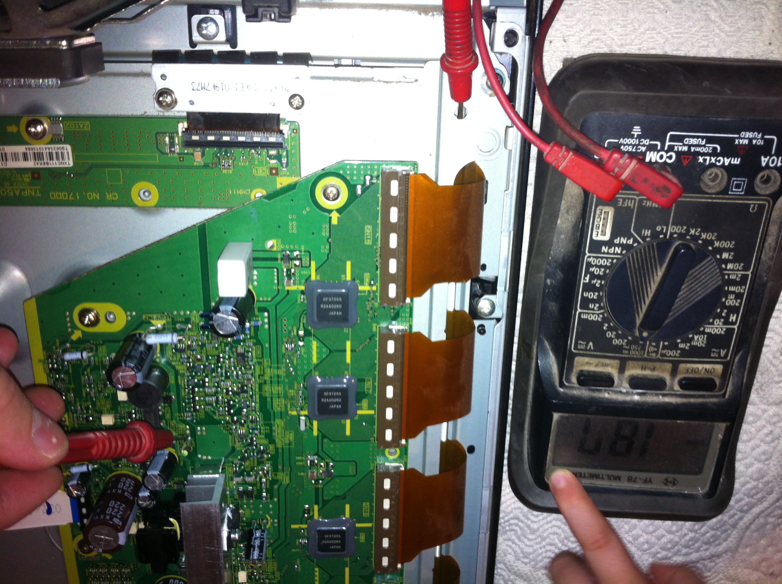

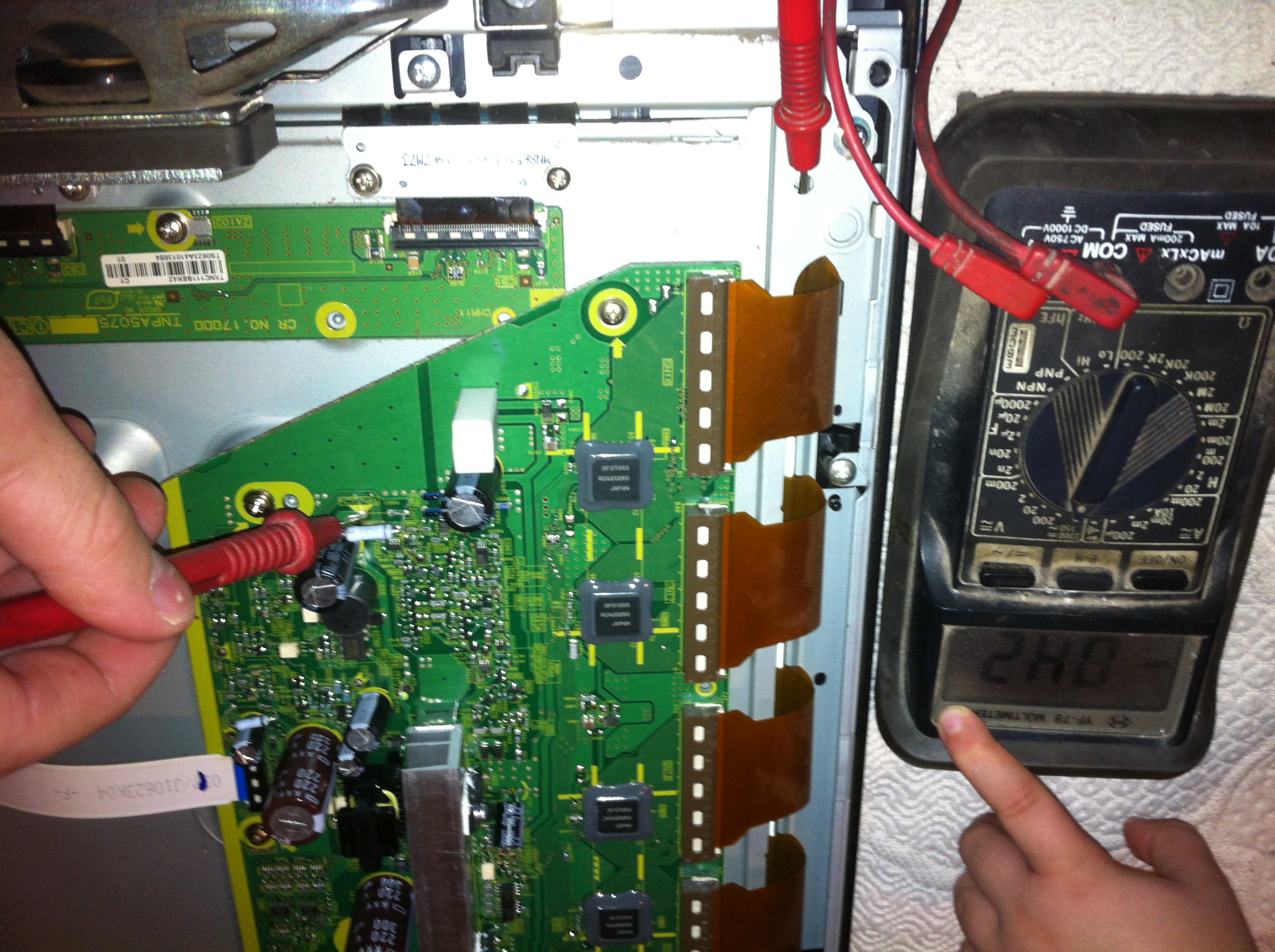

          this is what i get ....
          im sry...the pictures are upside down :S ...but you can see that i get all negative measures !
                It looks like either your SN is defective or the AC is not an acceptable sub for AB.
