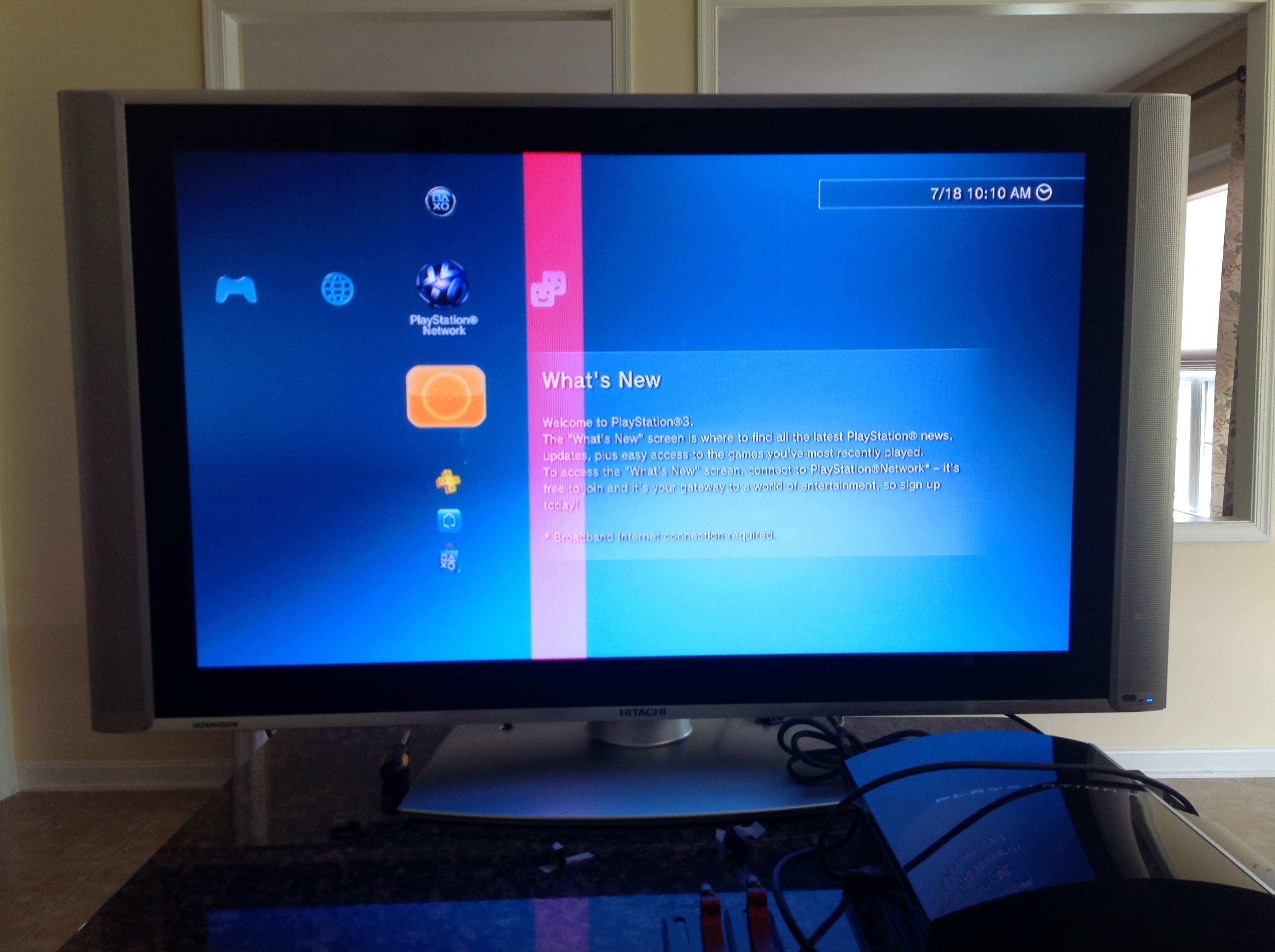

              Hello, I have a Hitachi 42 inch plasmas, model number: HD42S69. I have a 3 inch thick vertical red line, left of center (if your facing the tv) that sporadically appears, but often. I took it to a repair shop. The guy told me that its not the control board and it isn't the display panel, it's a buffer board. He wanted $200 and he said the part is like $60. I figured I can just do it myself, but I don't know where the buffer board he was talking about is? Can you help me locate it? How do I even know what board is causing the issue?
                Re: A guide to fixing/troubleshooting some common plasma TV problems
                It's more likely just the connection between the X-buffer board and panel. Start a new thread and provide pictures of inside your set, and you can probably fix it yourself.
                  Here are pics:
                      I don't have privileges to start a new thread for some reason.
                      I included two pictures for your review.
                        Where is the x-buffer board on the picture of the rear of the tv I provided?

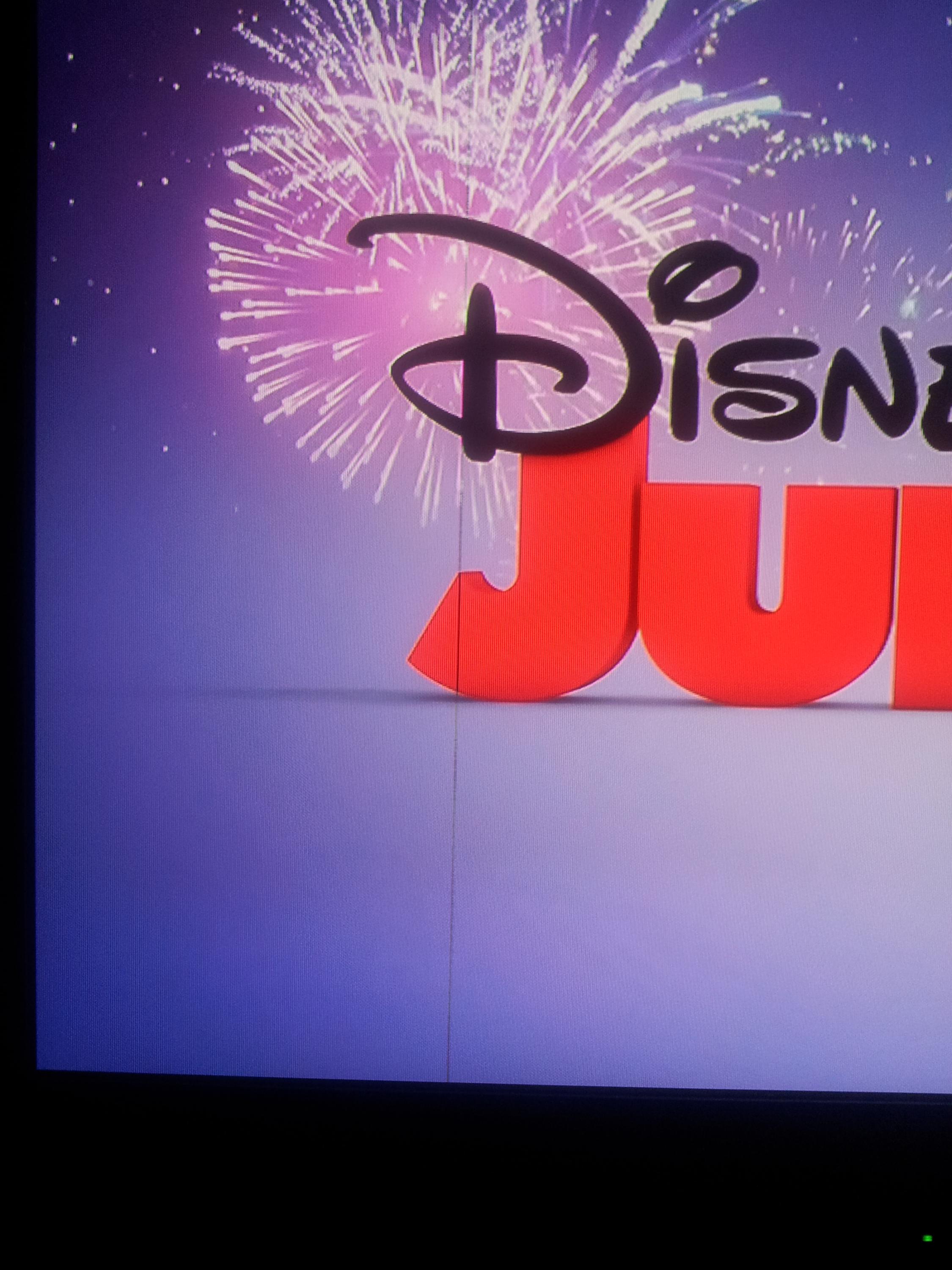

                              Hello there, just need someone to take a quick glance at the display on this photo to see if this TV is repairable.
                              Philips 42" Plasma - Model 42PF7320A
                              Thanks in advance.
                                Thanks in advance.
                                Yes - bad X-main, replace the X-main. Post a thread if you need more help.

                                    Looking at the picture, it also looks like the Y-buffer may be bad, but the X-main is causing the discolouring too.
