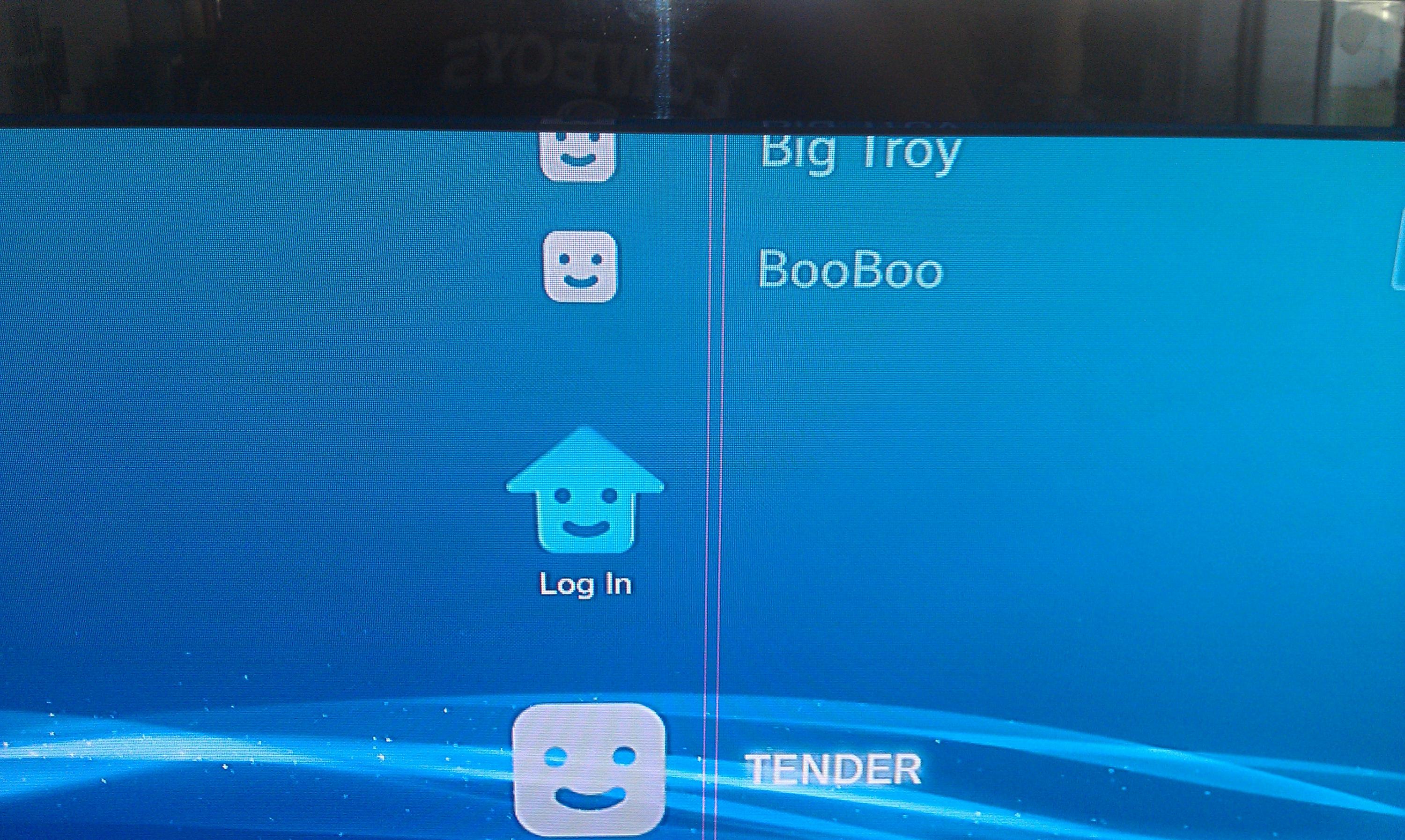

        I would like to repair my LG Plasma 50PC5D-UL. My TV started with one red vertical line down the middle,(not directly down the middle it's a inch to the rt. middle), of the picture. Today another line showed up next to the first one. What parts do you think I should replace to fix this problem.
        Help me please, I can not afford a new TV or to get this one repaired by a Shop.

          It looks like your panel is dying. See my comments in the post previous to yours.

            I would agree, it is pretty common on these LG panels, very strange that the lines go red, which means the blue/green is probably dying.

              Sorry, I'm a little new to TV repair. Is there a way to fix the panel, is it cost effective to look for a new one? What would you do Tom and Cap? Specifically what cables left side or right side should I look at on the LG Panel?

                No, it cannot be repaired without replacing the plasma glass. The plasma glass will cost around $300 to $500 for this model (thinking of new price; used may be cheaper but risks future failures in the same way), so is generally considered uneconomical when you can buy equivalent, new TVs for $400.

                  Since I like to try to fix everything, I'm inclined to say that you should look for a used, non-working TV. Realistically, as Tom stated, new TVs are so inexpensive now, and you get the added benefit of a warranty.
