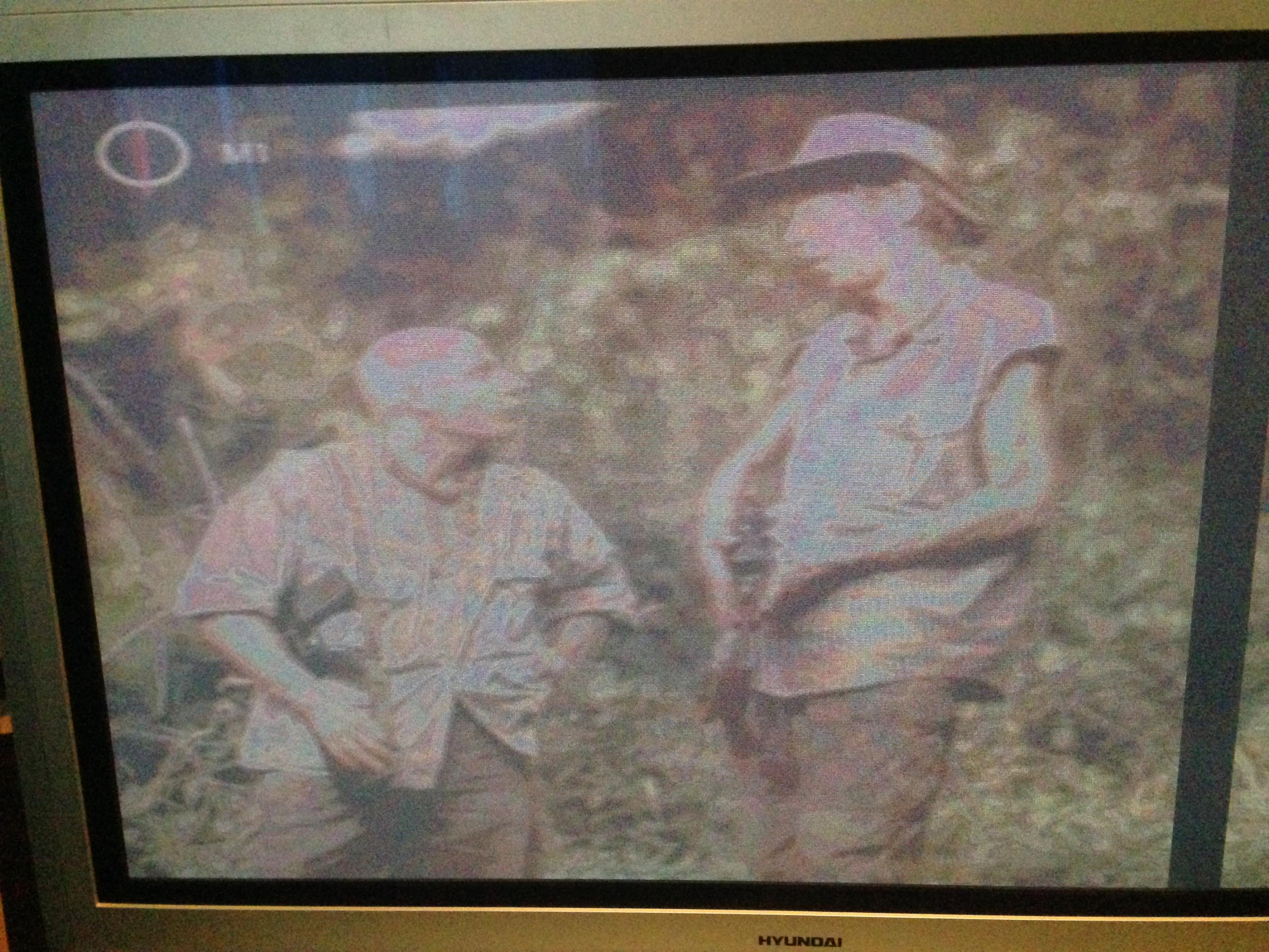

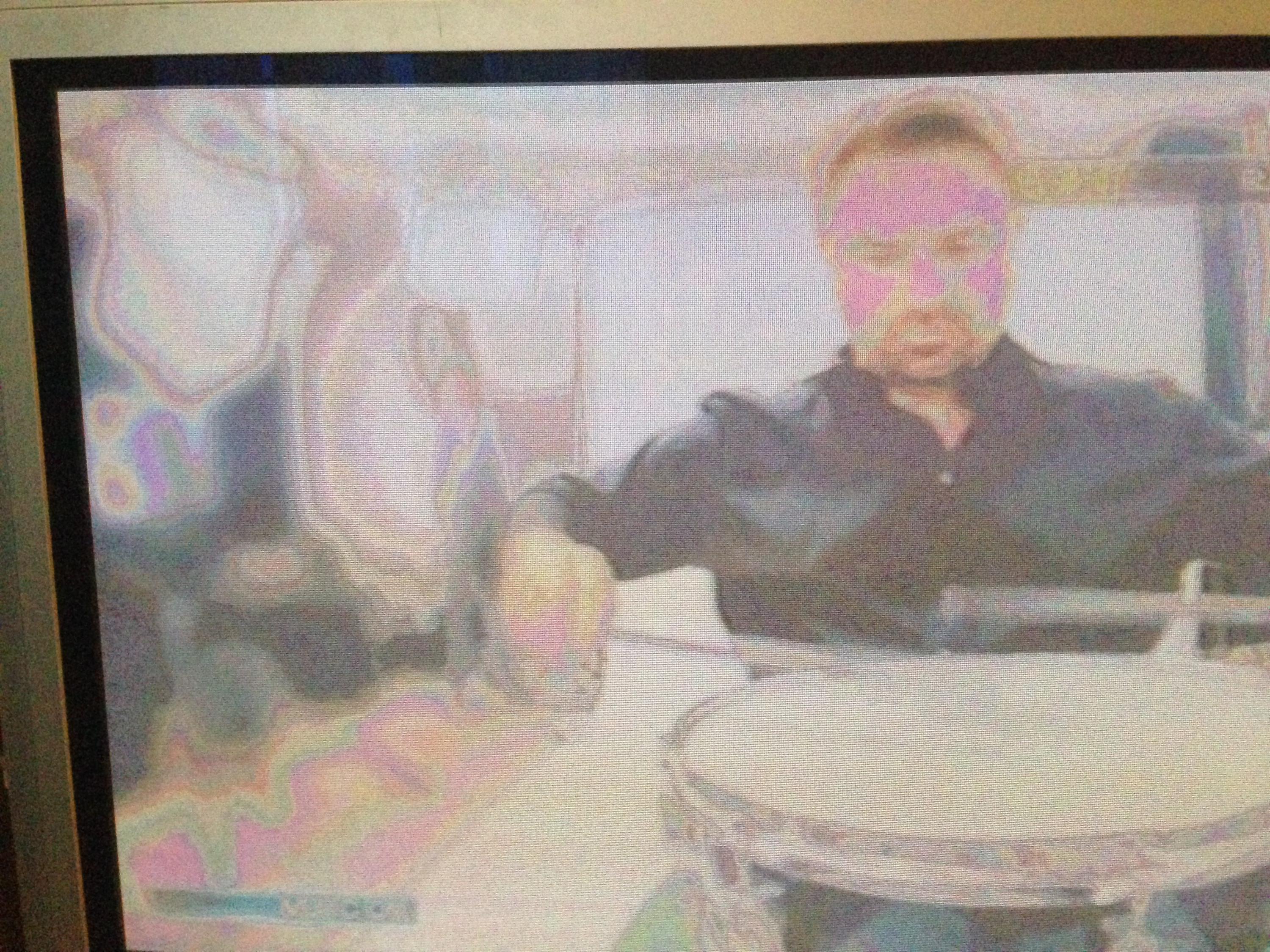

                #407
                Re: A guide to fixing/troubleshooting some common plasma TV problems
                hi tom ... I have plasma PDP42V61001 WITH IMAGE QUALITY PROBLEM SEE attachmemts ... soryy for my English ... thanks
                respect .
                  #408
                  Z-sustain bad plus a cold joint on the X driver connector for part of panel which is black.

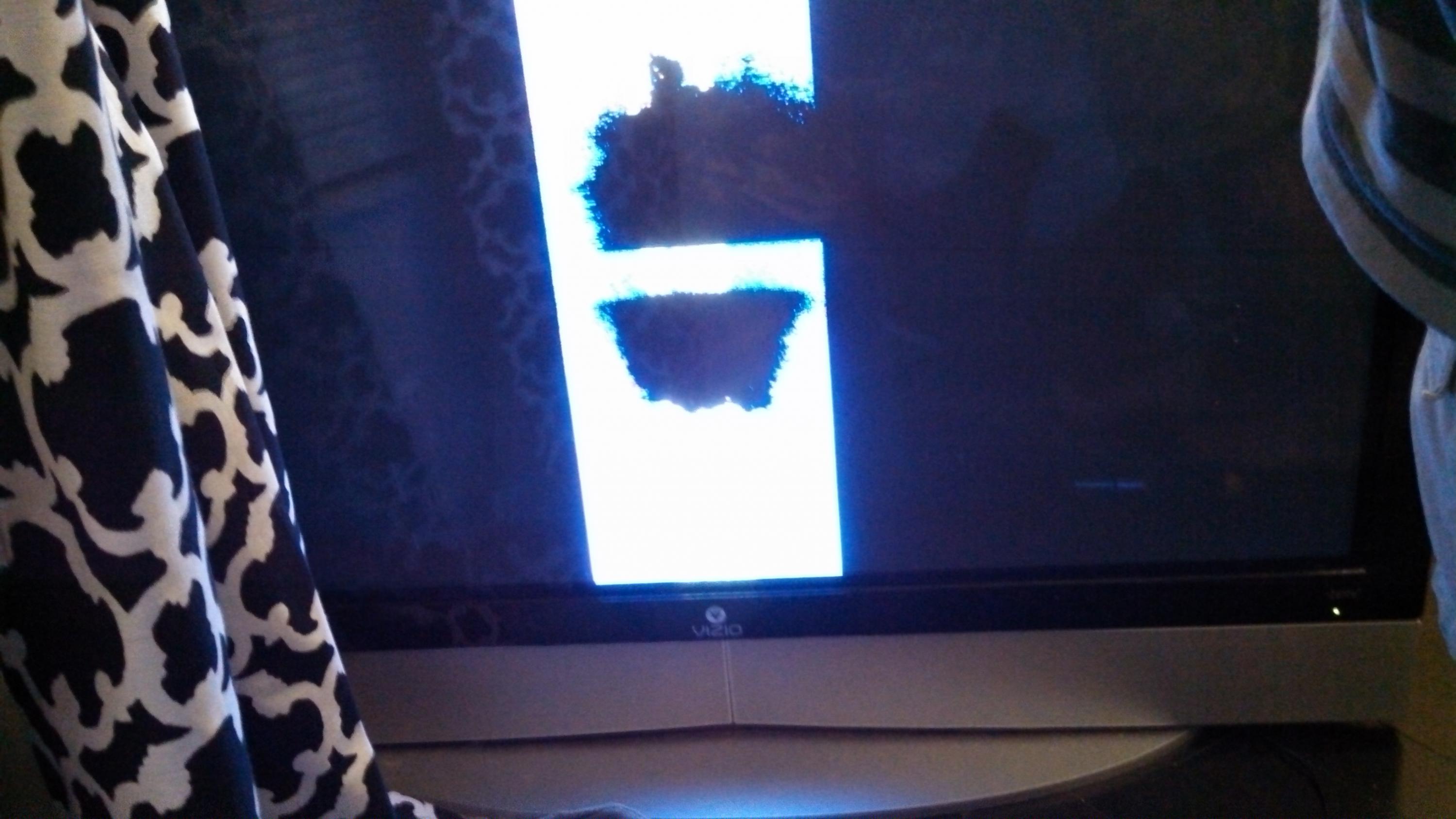

                          #412
                          I have a Visio P50HDTV with this on the screen.
                            #413
                            Looks like a bad Y-buffer. Common issue with these is shorted FETs.

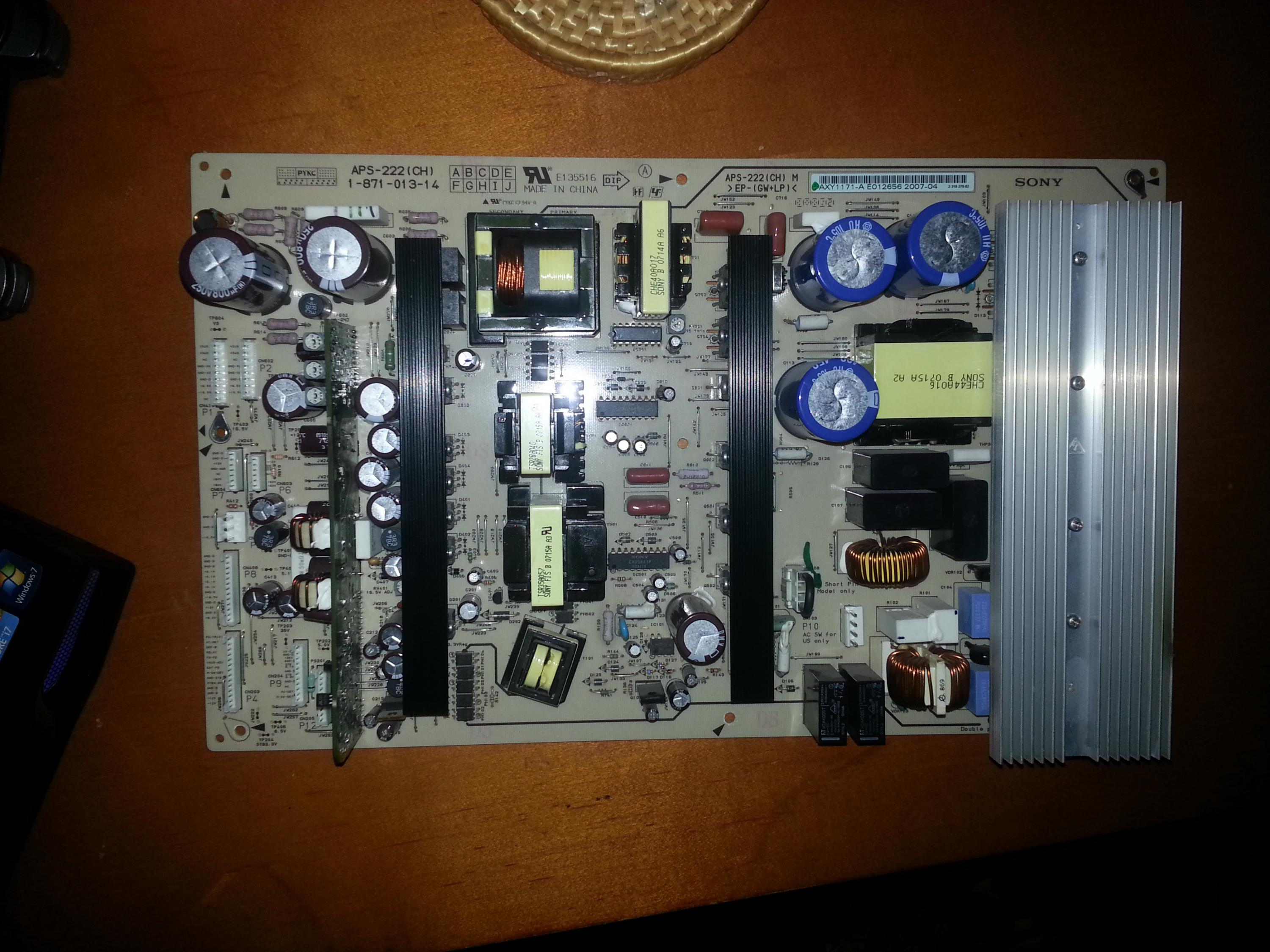

                                #415
                                Hi guys.First of all i apologize for my english ,but i will try to explain my self to be understood.I have a plasma Panasonic TH42PX80E and the power supply is broken.I give it to someone to repair it and his make,s test on my supply also missing some parts. Now i try to restore it,because i find one identical power supply and the tv is working.The power supply is LSJB1260 -1 ,the pieces are D416 (1SR153) i wanna replace it with 1n4148 if is ok, and D411 (ST02D-170) with this i have a problem because is not available in my country ,unless i order for 2014.The D411 is a 2 component piece one zener +one fast diode. So what do you think that i have to buy separately to build this overvoltage diode? If you wanna see the datasheet for St02d-170 you will find them in pdf in SHINDENGEN site which build ,it.Thanks all.
                                  #416
                                  You cannot replace 1SR153 with a 1N4148. Attempting to do so will likely result in flames, fire, damage, etc.
