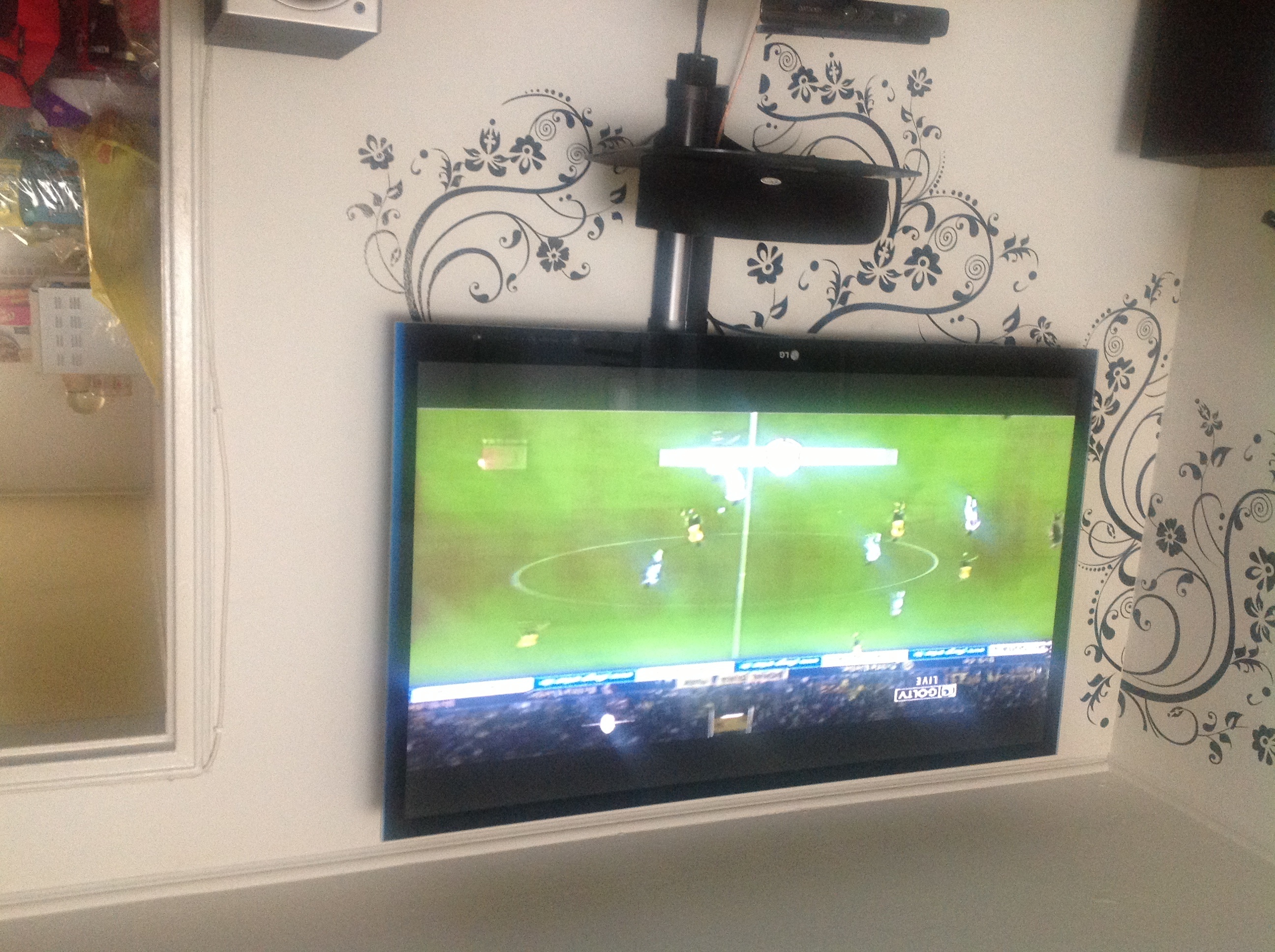

        #243
        Re: A guide to fixing/troubleshooting some common plasma TV problems
        I bought this tv LG 60pz750 in november 2011, it has an awesome picture but few days ago we notice a type of flickering burn image.
        I attach a picture so you can see it. Also, i have video in you tube too
        Code:
        http://youtu.be/ZZKig9N0bZo
        Please if someone can help me
        Thank you

            #245
            It looks to me like low Vs or Ve voltage. Easily fixed. Start your own thread.

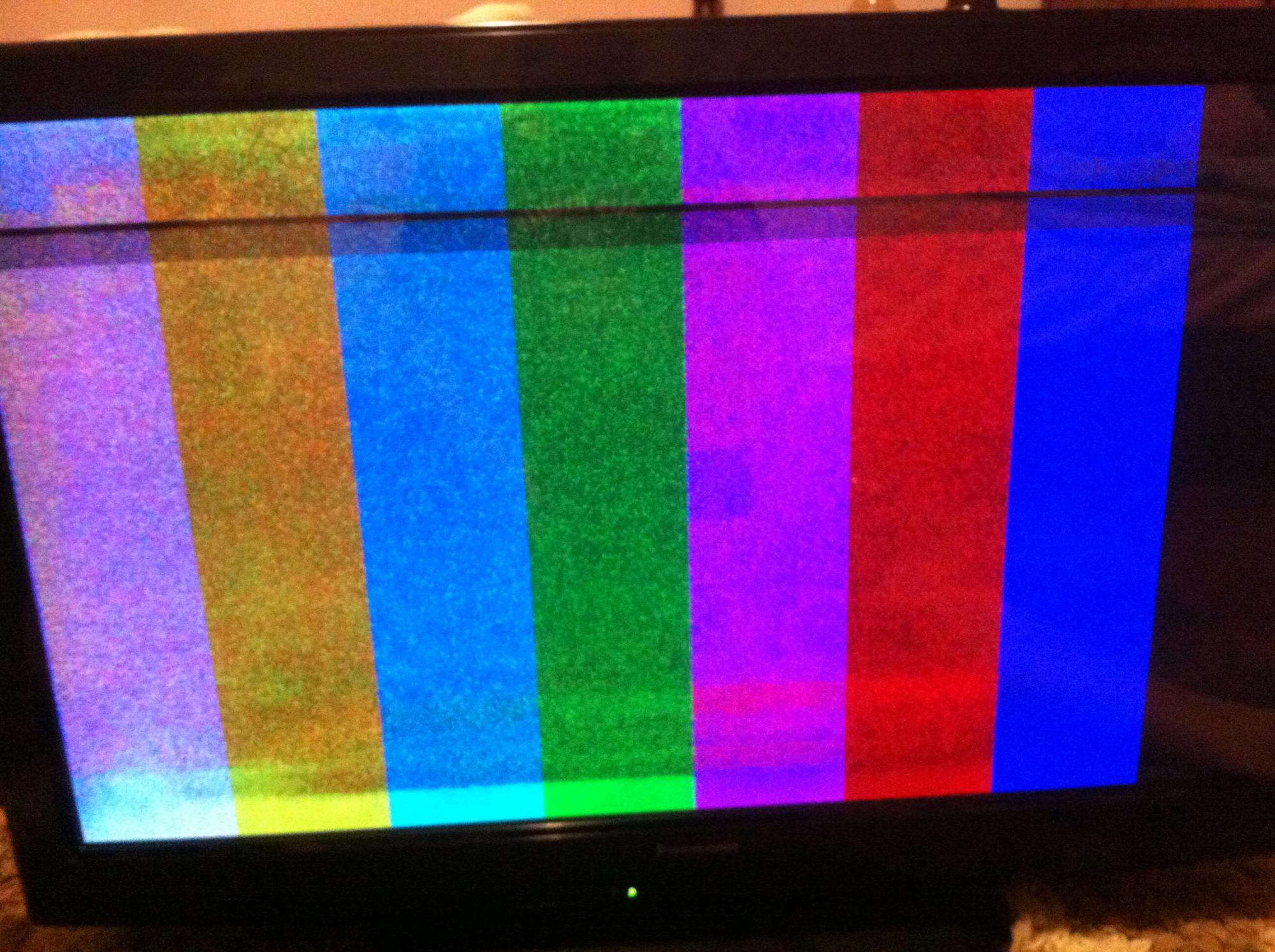

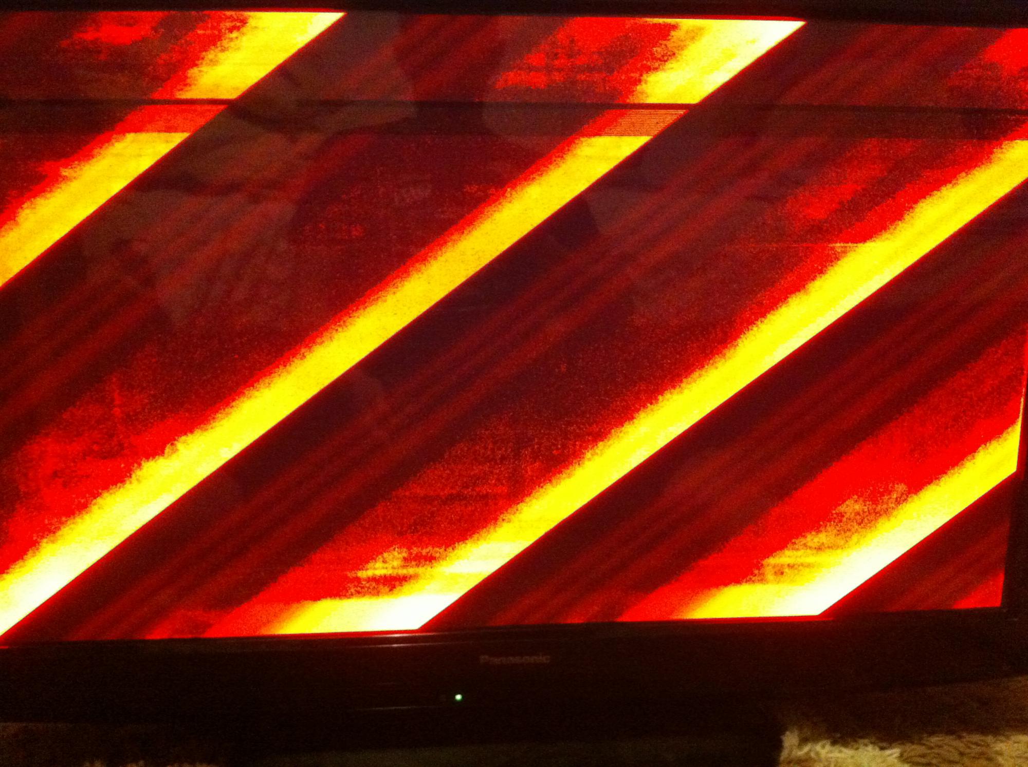

                  hi tom..i hope you can help me..i had a 7 blinks on my Panasonic Plasma TX-P42X20E...i searched the net and found out that the problem most likely is in the SN board...i ordered it ,and succesfuly replaced it. The plasma fired up,the picture was on but the colours were all mixed up...like red and green...i hope you could help me somehow! thank you
                    #249
                    Can you show a picture?
                    Does the distortion also affect the menus?
                    Did you match the board suffix too? (May not be important for SN board.) Board suffix printed near TNPA.....

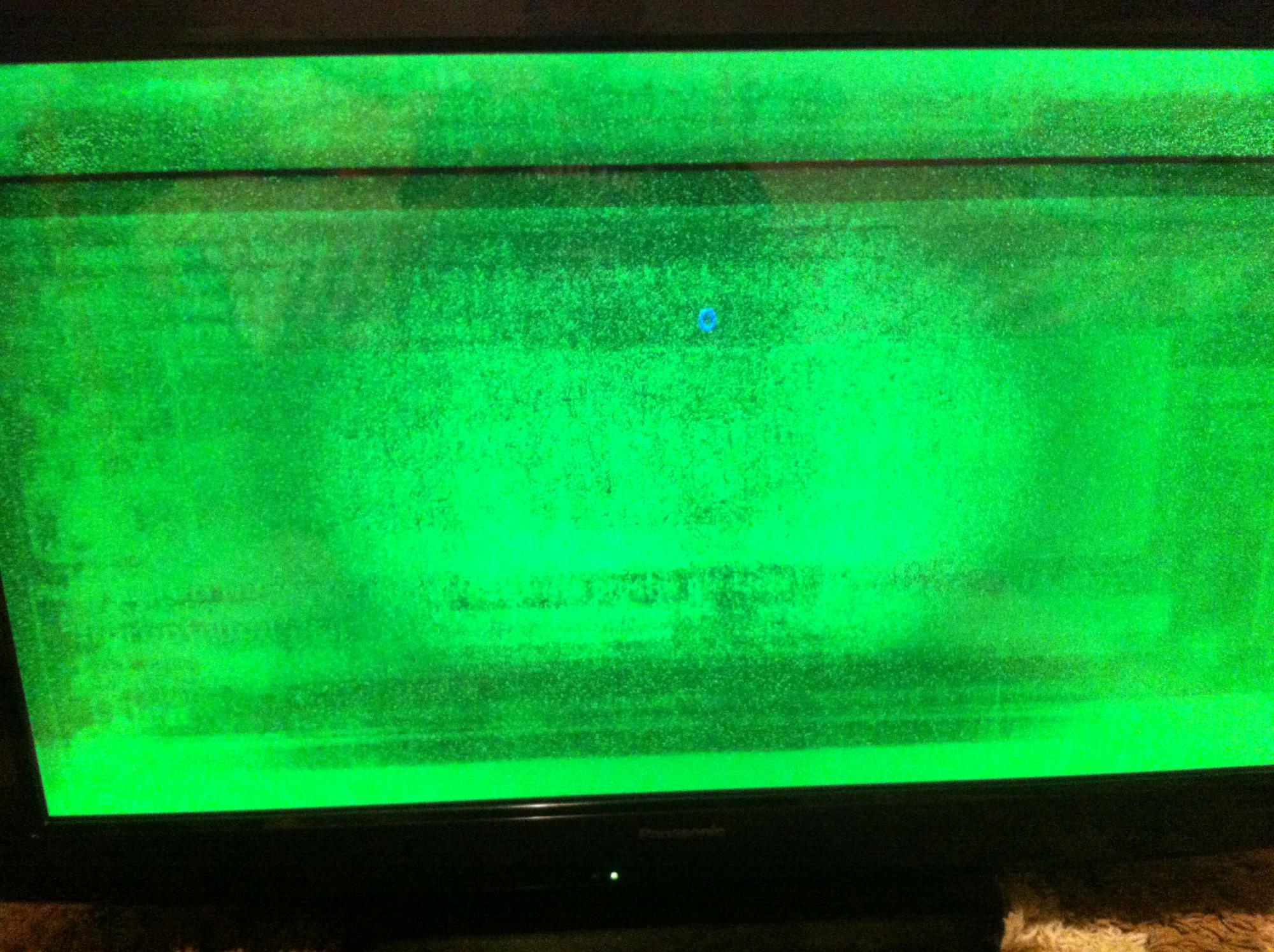

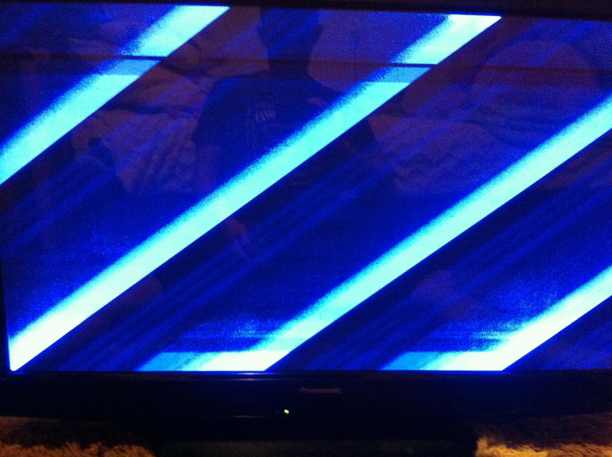

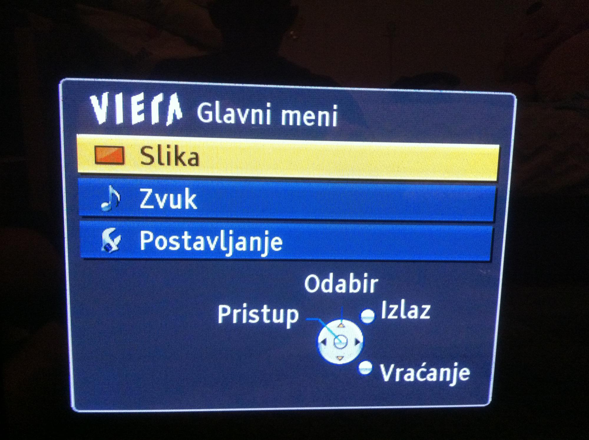

                      #250
                      Here are the pictures...the menu is affected as soon as i open the settings,first menu where i choose some options like picture,sound,security isnt affected !
                      btw. Original part has this mark on him TNPA5066AB,but i wasn able to find it,i found one seller that had TNPA5066AC,and that part has been marked as substitute part for my original!
                        #251

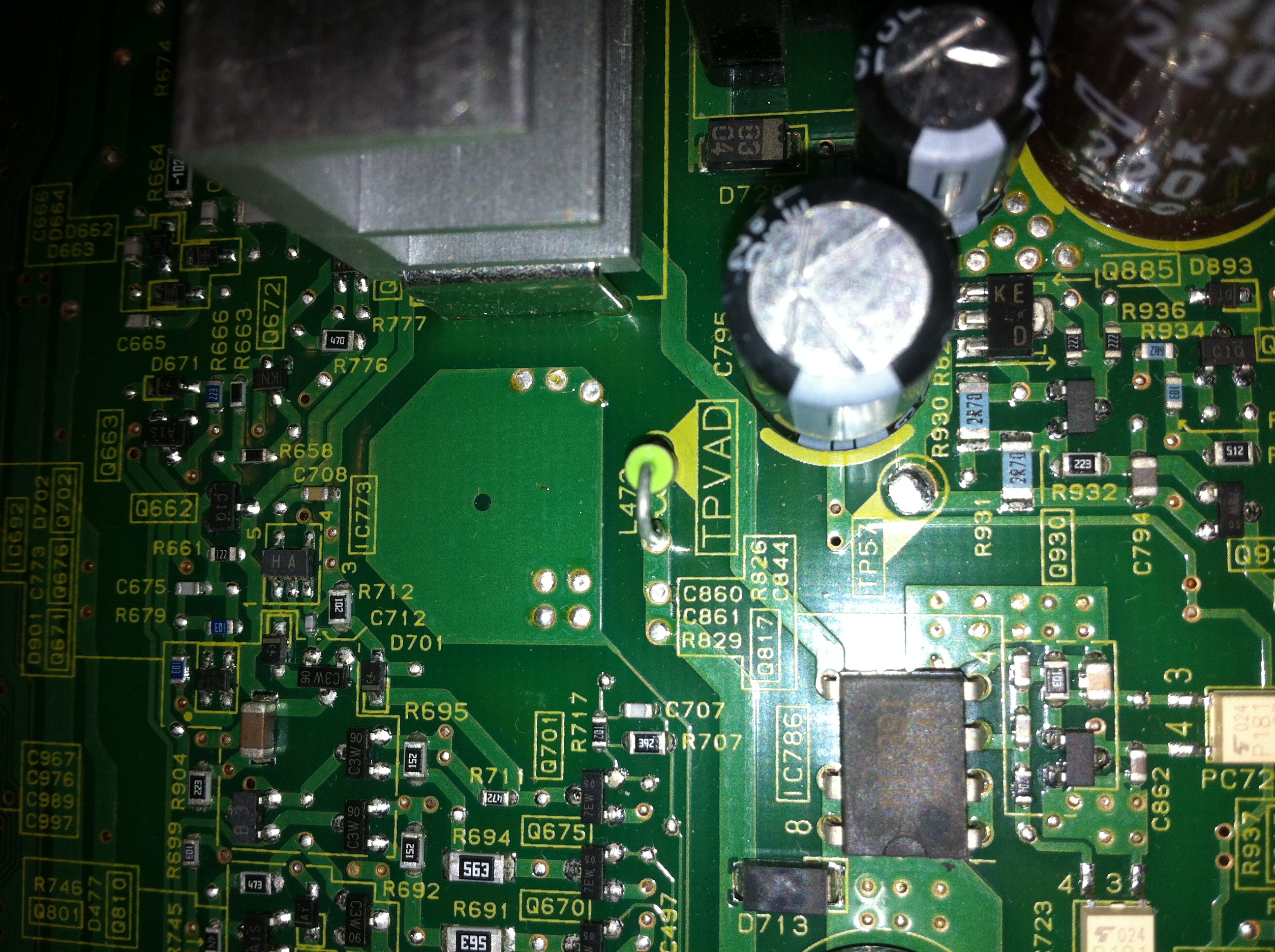

                        It may be that the VAD or VSCN voltage is not correctly set.
                        Vad is typically -100V to -190V. Vscn is typically +90V to +200V.

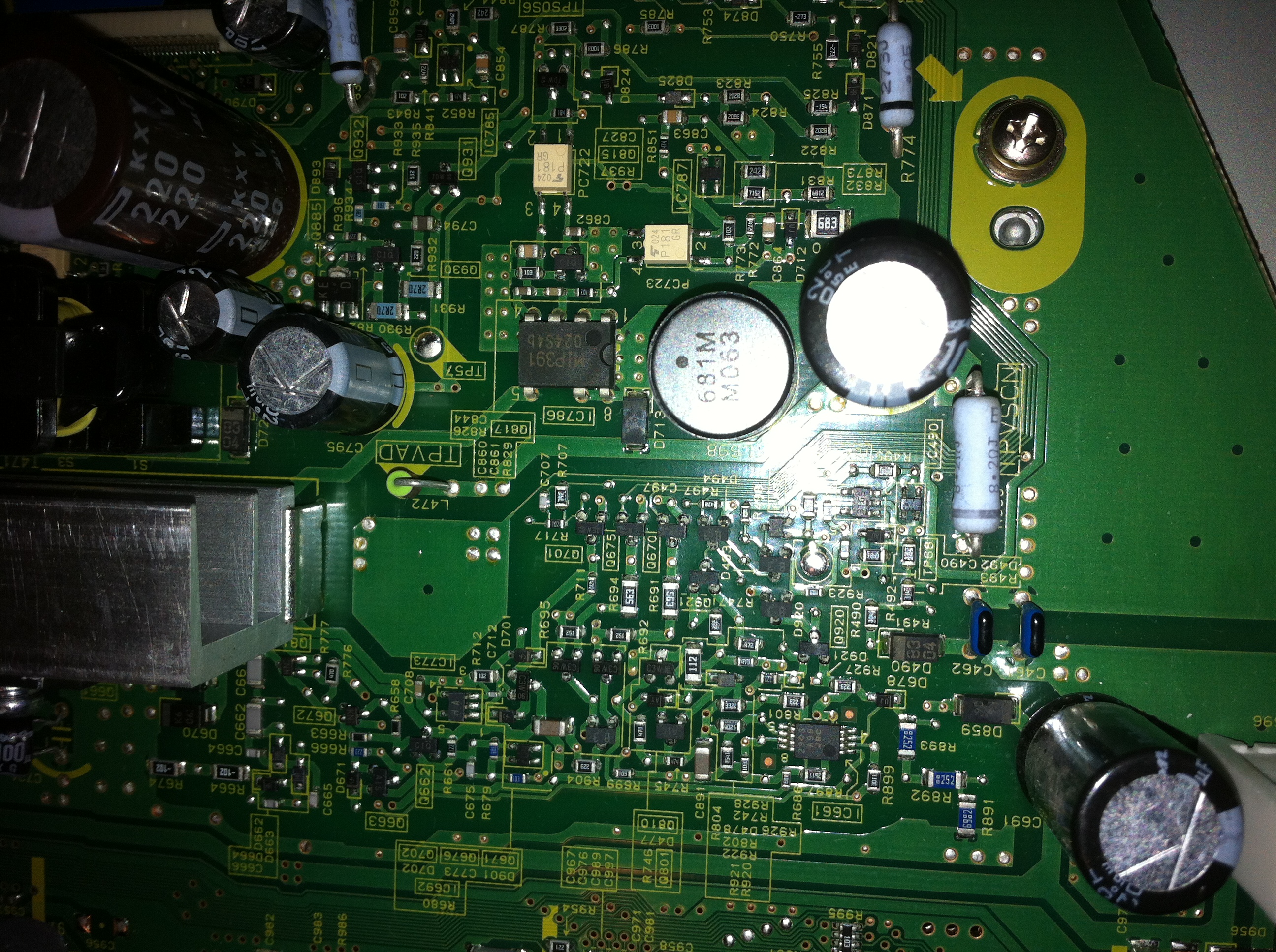

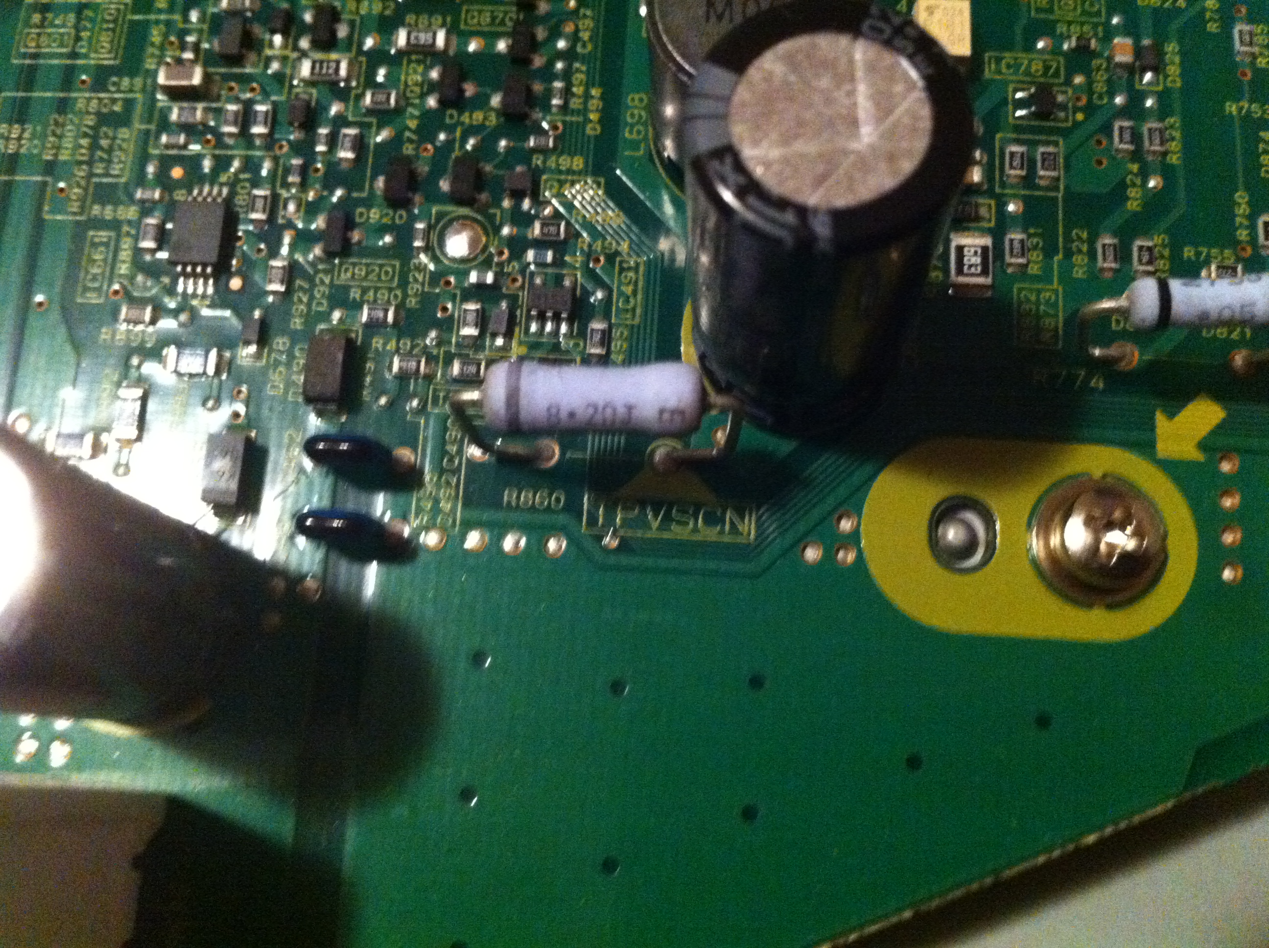

                              how can i set that up?
                              First, you need to get a digital multimeter and measure the Vad and Vscn test points on the SN board, they are labelled typically TPVAD and TPVSCN.

                                    #257
                                    tpvsn shows me 0.08V.....and tpvad 0.188V....if i correctly checked it !?!

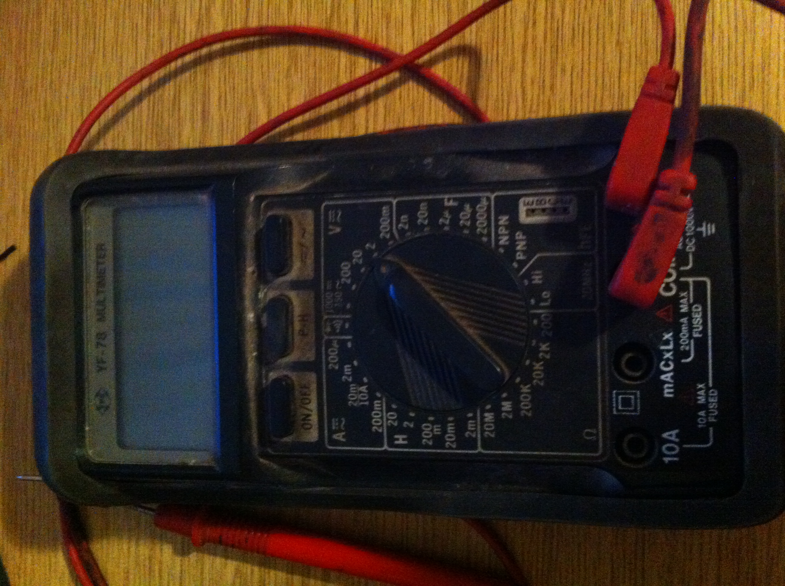

                                      #258
                                      How did you check those?
                                      • MeanBoss
                                        • Sep 2013
                                        • 15
                                        • Croatia
                                        #259
                                        with a multimeter on picture...it was set as on picture...on positions that are in the pictures!? is that right ?
                                        btw. i fixed that line on top...
                                          #260
                                          Range should be 1000V/750V. Set to DC mode. (AC is squiggle, DC is one broken bar and one solid bar.)
                                          Red probe on TPVAD/TPVSCN black probe on the metal chassis of the TV.
