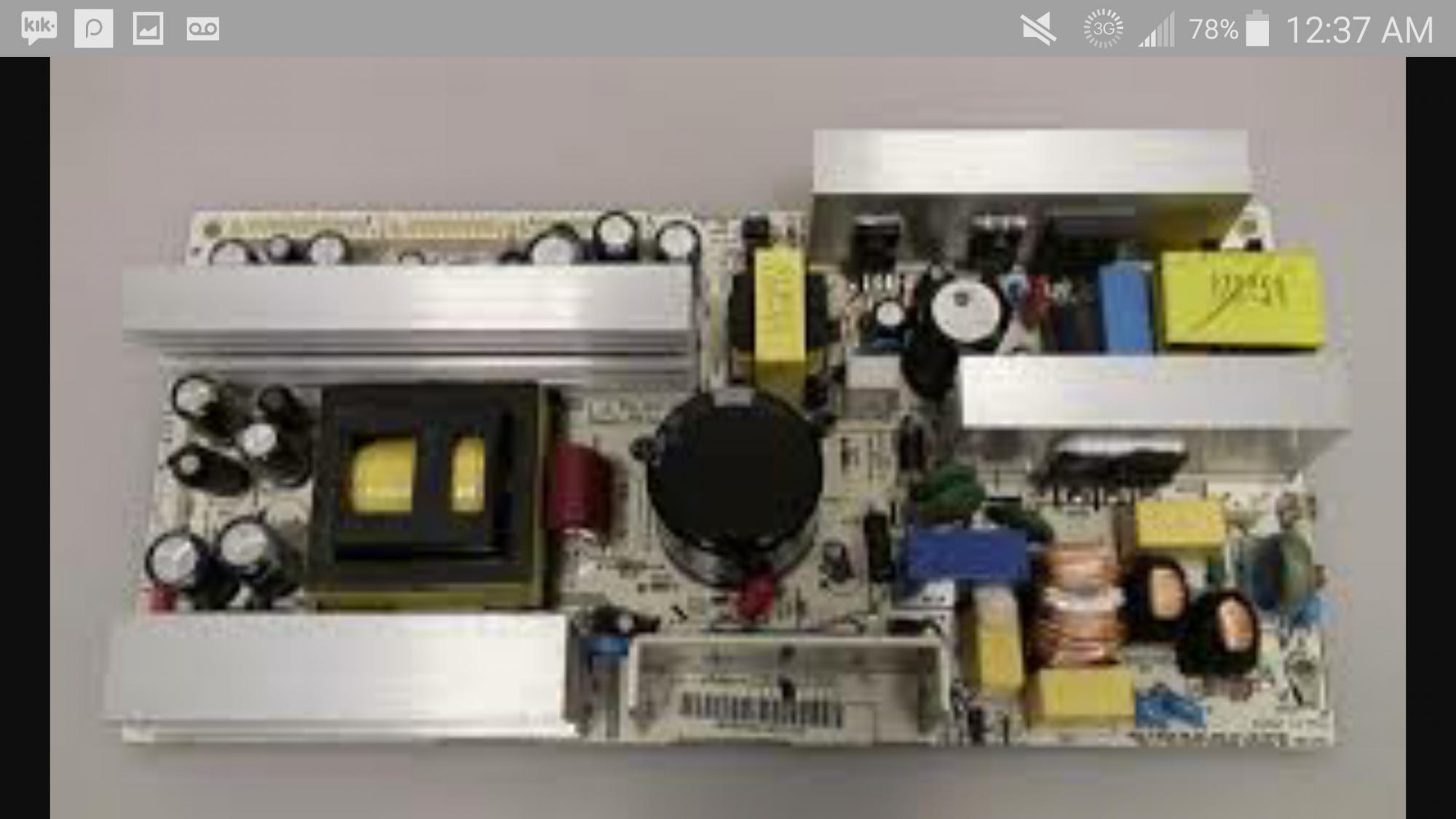

                    Not been on for a while as had no problems
                    Hope you don't mind me resurrecting this thread ?
                    But now I have returned with another duff LCD PSU , not mine ,
                    just had it dumped on me by Number 2 Son ?, ( mend it dad)
                    ( muggins)
                    Looks identical to the one in this thread , but from a 42 inch screen .
                    I'm now a bit limited in equipment now , only iron and Fluke meter redface:
                    So grovelling for some help
                    Tv reported as working some of the time ? but mostly just a Whistling sound from the psu .
                    I found 5 bulging caps so replaced them ..
                    Powered back up and no whistle .. yeah!!! short lived tho' .. after about
                    1 min the 450V 65Ohm Cap popped and smoked ..
                    replaced that and Ditto , so something a bit more serious then ..
                    but now obviously can't do any voltage checks without a mask
                    hmm wot now!! Maybe just try and source another PSU ?
                    ta Chris
                      #190
                      Re: LG 37LC2D No picture, believe bad power supply
                      Cap installed properly? Or the PFC Voltage booster lost its regulation and cause the Voltage on the cap to go way higher that 450V?
                      Pictures of the your board?

                        #191
                        All caps in correctly ..
                        PC as requested.. Those with small Red dots were replaced.
                        Cheers
                        Chris
                          #192
                          So that big cap C500 with bulging top is the original cap that was OK before and now it just blew up?
                          http://www.shopjimmy.com/lg-6709900016d-smps.htm
                          • ceedy
                            • Nov 2008
                            • 76
                            #193
                            yes, the 450v 68Uf just popped . nice jet of white smoke
                            found uk based seller of this PCB,
                            so will investigate this as an easier option
                            C
