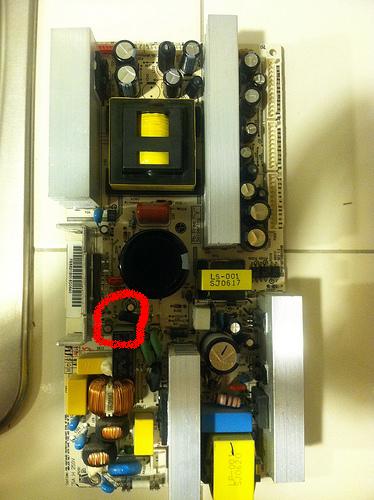

Re: LG 37LC2D No picture, believe bad power supply
I would repalce all the caps on the cold side of the power supply as a set, the hot side (line voltage) capacitors are exposed to only 120Hz, the cold side (DC output side), the capacitors are exposed to 50~100KHz frequency, that is why they have to be low ESR type. I use Panasonic FM/FC series.
