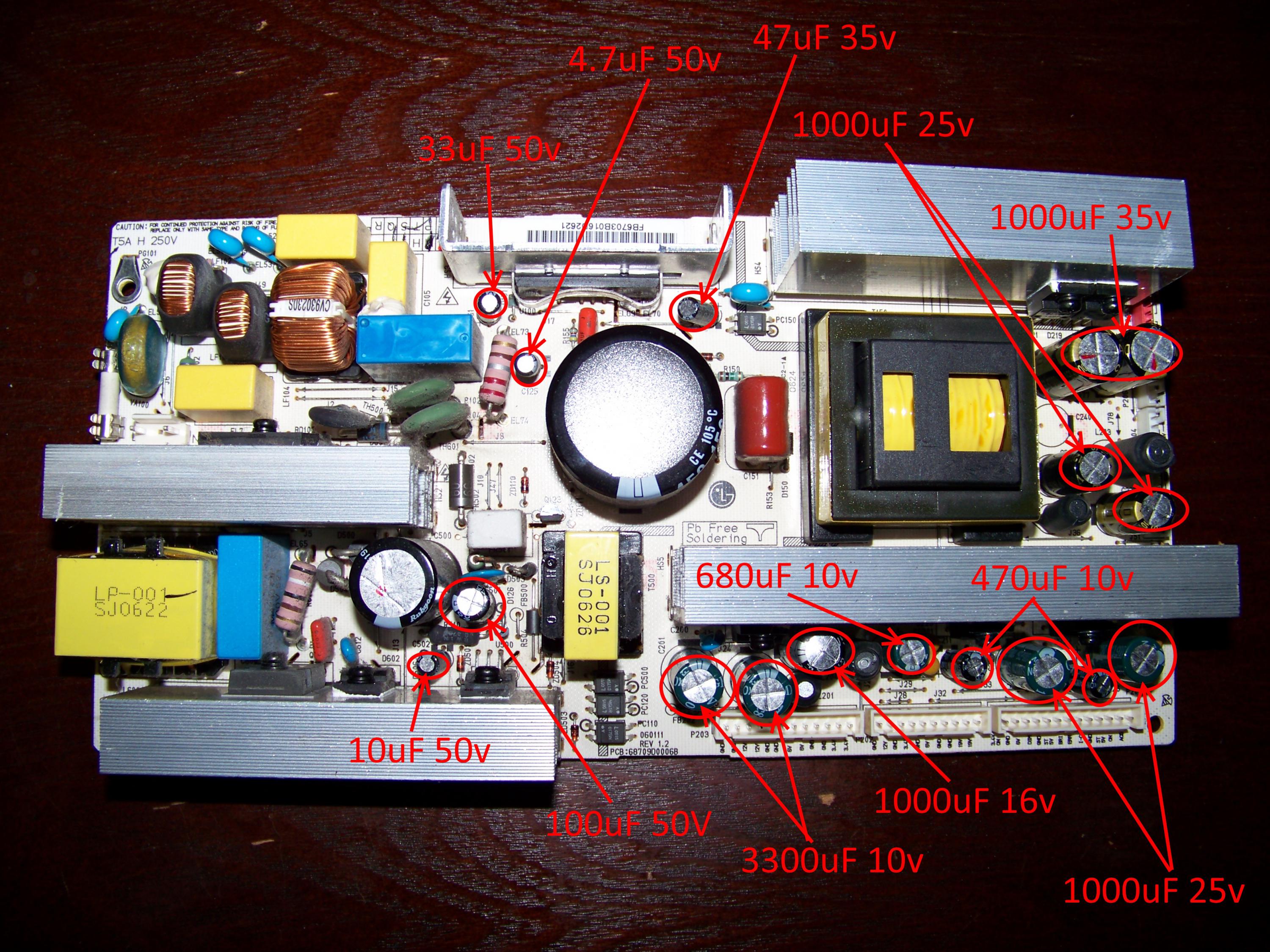

                                #175
                                Re: LG 37LC2D No picture, believe bad power supply
                                I offered to fix my folk's LG 37LCD2 based on the common symptoms that pointed to capacitor replacements for the power supply, and I figured hey, I have a soldering iron and took Electronics 101 20 years ago, I can help them. I went ahead and bought the capacitors for all but the 2 largest (C500 and C150).
                                I went ahead and desoldered everything, without thinking to diagram which needs to go where. Ignorant newbie mistake I guess.
                                Does anyone have a listing or diagram which could help me with which specific capacitors go where?

                                  #176
                                  I got an LG 37LC2D for $20 because after 30mins of being on, it would turn off, then it would not come back on. I found this post online and I wanted to say thank you all that have provide enough info and cooperated to help others with issues.
                                  So far what I noticed is 1 cap that is bulge (1000uF 16v). I have an in-circuit tester that allows me to test the rest of the caps. I know I won't get the correct reading all the time if caps are parallel, so I will have to remove them and check them with the Supco MFD10 Digital Capacitor Tester I have.
                                  @cm12 - I have added a picture with the caps location, hope it helps.
                                  Thank you all for such a GREAT site

                                      #178
                                      Finally put the TV back together and it's working like new once again. Thanks all who have contributed to this helpful thread and helped!
