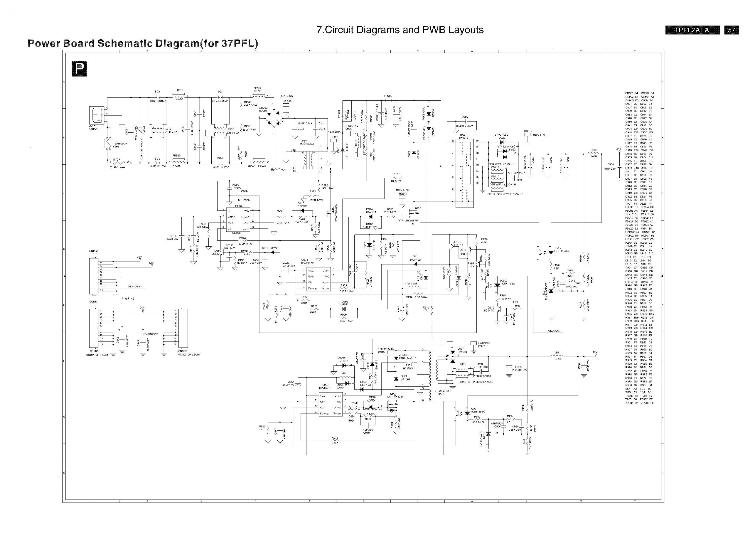

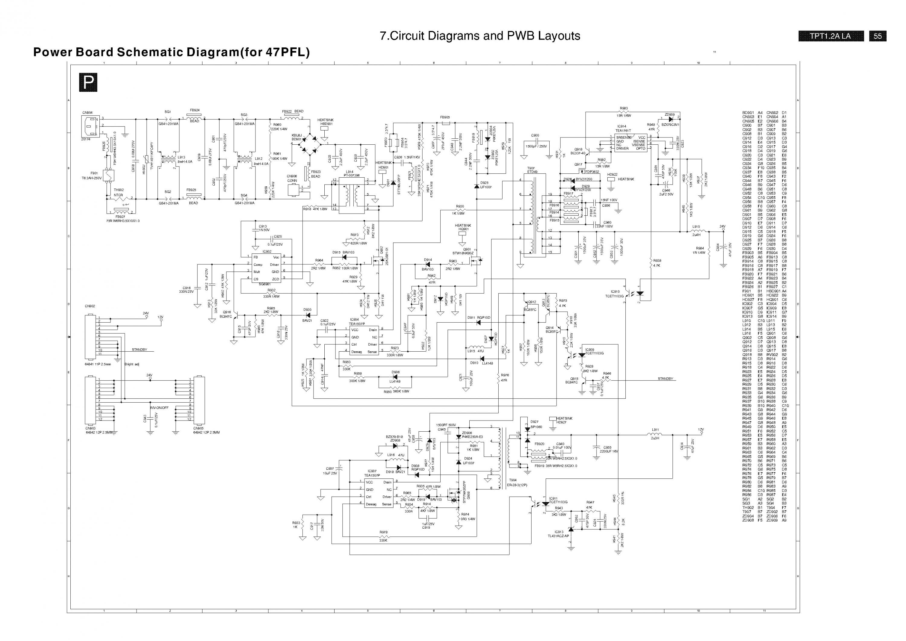

                  Re: Philips 37PFL5322D/37 Chirping from psu
                  Originally posted by lizzrd
                  I have my board out and ready to order some parts. I guess i am still looking for clarification on the 3 diodes... zd902 + zd904 next to the transformer are P6ke zeners.
                  I cannot read or find info for the one at position D925 ? is this a zener diode also ?
                  D925=UF1007 (UF1007. 1.0A ULTRA-FAST RECTIFIER)
                  here i attach a 37" to 47" PFL series of service manual look from pg 57 to 63
                  hopes this help those who need it.
                  regards
                  ktgoh
                    I can not say " i can read an electrical circuits' drawings" , but thanks for your reply.
                    I google that uf1007 and found nothing like it at Dig-it-Key... ?
                      • 31304
                      #30
                      uf4007
                      • lizzrd
                        • Jun 2014
                        • 21
                        #31
                        Thanks for your replies and help...
                          #32
                          Digikey, UF1007:
                          http://www.digikey.com/product-detai...DITR-ND/248654
                          Mouser:
                          http://www.mouser.com/ProductDetail/...XLfVE5J3hj8Q==
                          Spec:
                          UF4007 will work
