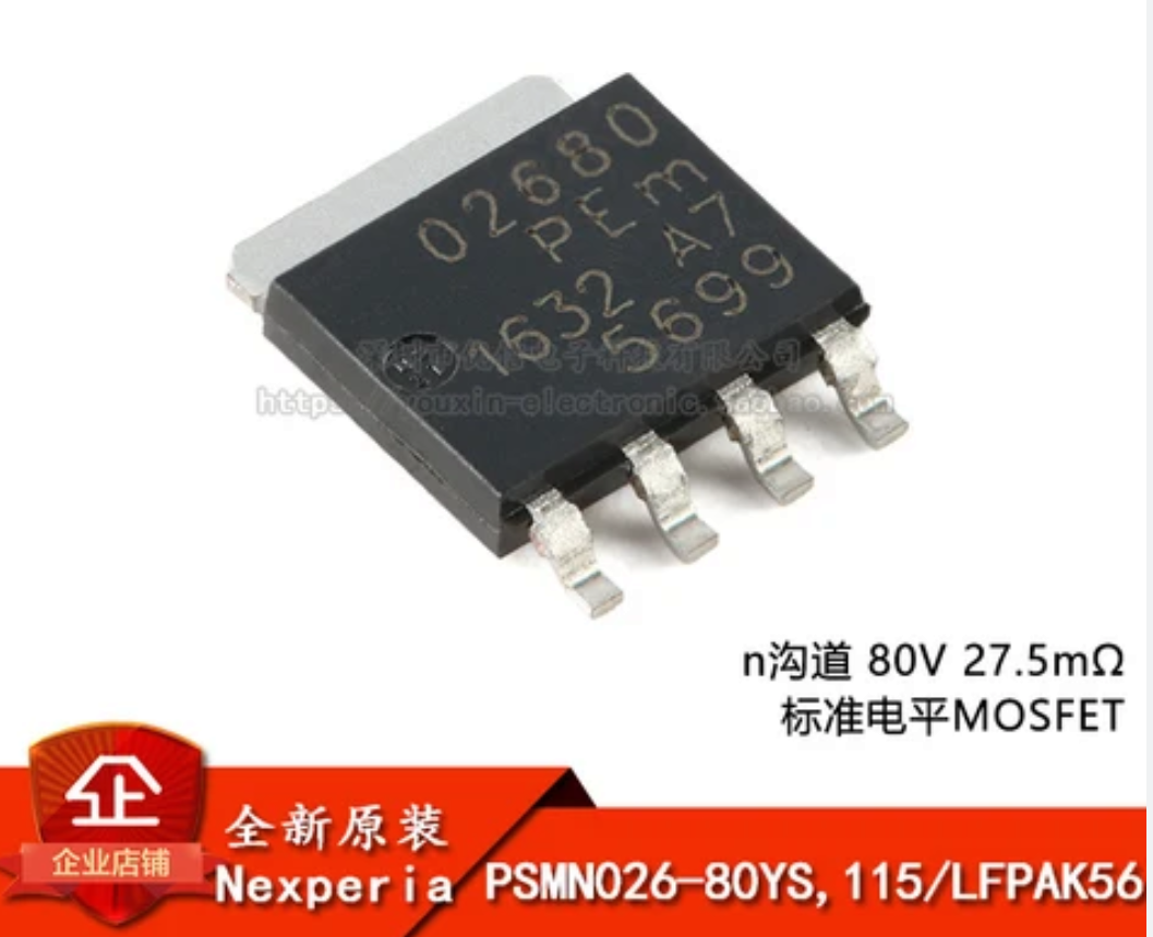

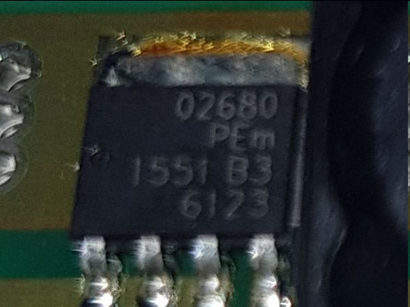

                                      what is the part number on the ic chip that has 4 pins on it would be the first thing I would check google search the part number to see what this device does and post it here so we can look at it as well
                                      02680
                                      PEm
                                      1551 B3
                                      6123
                                      I can't find the datasheet, but it appears to be something like this:

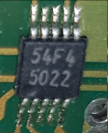

                                      Originally posted by sam_sam_sam
                                      Also what is the part number on the other ic chip that has 10 pins on it
                                      54F4
                                      5022
                                      Can you please take another picture of the small board straight on and focus on the lettering so the image is clear so I can see the other components on the board thanks
                                      Straight on the light was bouncing off, but I've managed to get the writing on the components in photos above. Here's an overall view:
