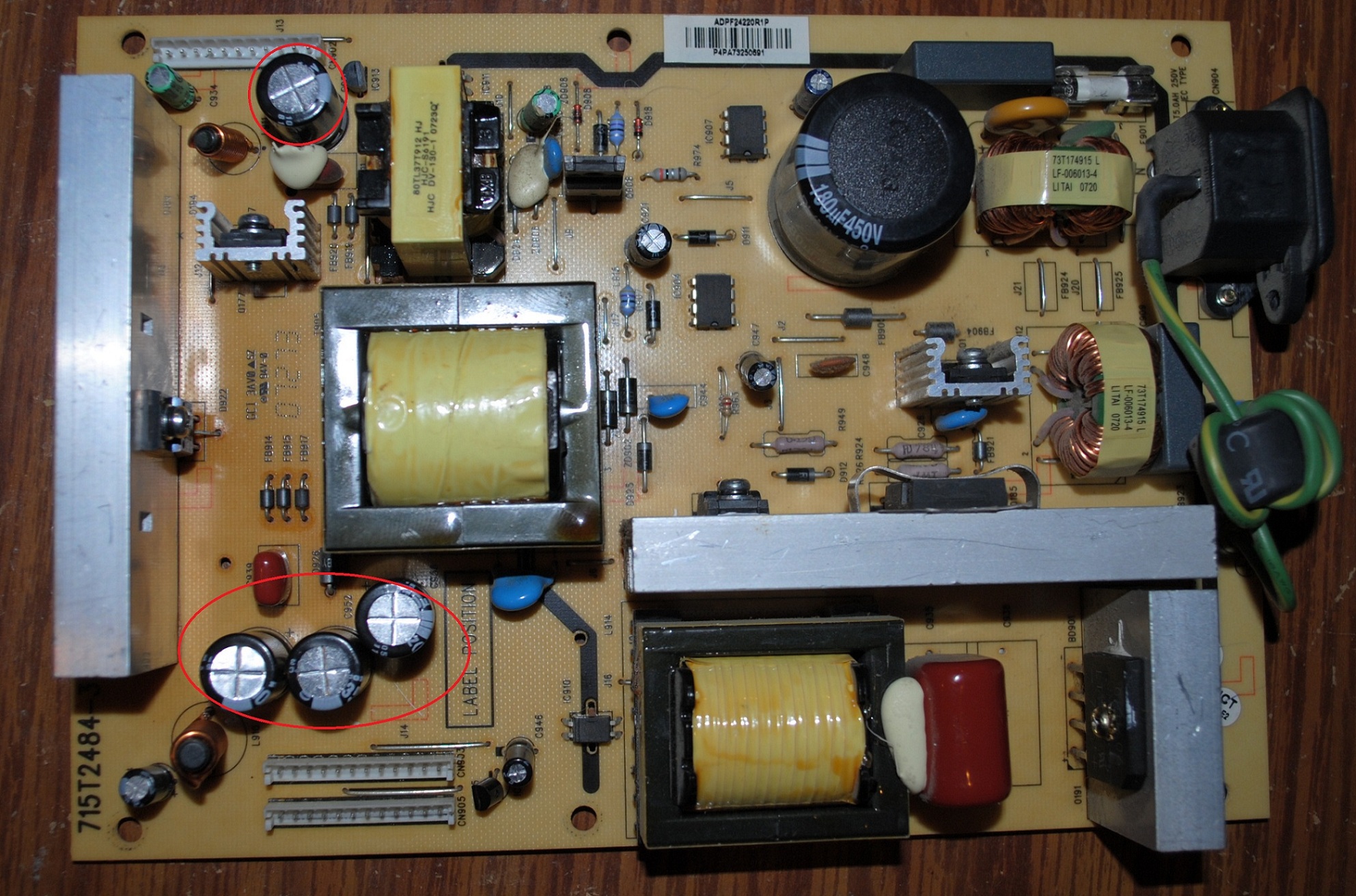

    I'm trying to repair my cousins 37" lcd. I was told the tv just flat out shut off while watching it. We pulled the back cover and discovered the 3 capacitors were bad. The 3 in a row that are circled. 1 was swollen and the other 2 leaked. We replaced the 3 and one more thats also circled in the picture. The capacitors were replaced with Nichicon 1000uf 35V capacitors. All 4 that were replaced are all the same value. We plugged the tv in to verify and now we are getting a chirping noise from the power supply. The standby light is illuminated red and it changes to green when the power button is pressed. I'm having a hard time narrowing down exactly where its coming from but my guess is its in the neighborhood of the verical transformer. Does anyone have any sugggestions as to where to start checking. I do have a multimeter but thats it. If anyone does have any suggestions i'm probably going to need specifics on exactly what to do considering i'm a total NOOB in this area.

    Here is an update. With the tv plugged in but powered off you can hear a very faint ticking. Turn the tv on and you get the chirping. I read in another post that the TEA1507P chip goes bad. I checked the pins and when i checked pin #4 you can hear the ticking alot louder. Its doing it on both chips.

        The original capacitors were CapXon GF series. The 4 i replaced are VZ(M) series i think. 105 degree celcius. The Tv is still dead. It wouldn't power on at all before the capacitor swap.
          Re: Philips 37PFL5322D/37 Chirping from psu
          Here's your problem..
          VZ are general purpose, not low ESR, nor does the ripple and esr come anywhere near a GF spec capacitor .
          Rip them out and do it again.
          Replace them with this
          Panasonic FM
          http://search.digikey.com/us/en/prod...2405-ND/613766
          High ripple, low esr.
          3190mA 15 mOhms to be exact.
          GF were 2780mA 19 mOhms, VZ were 810mA doesn't list impedance.

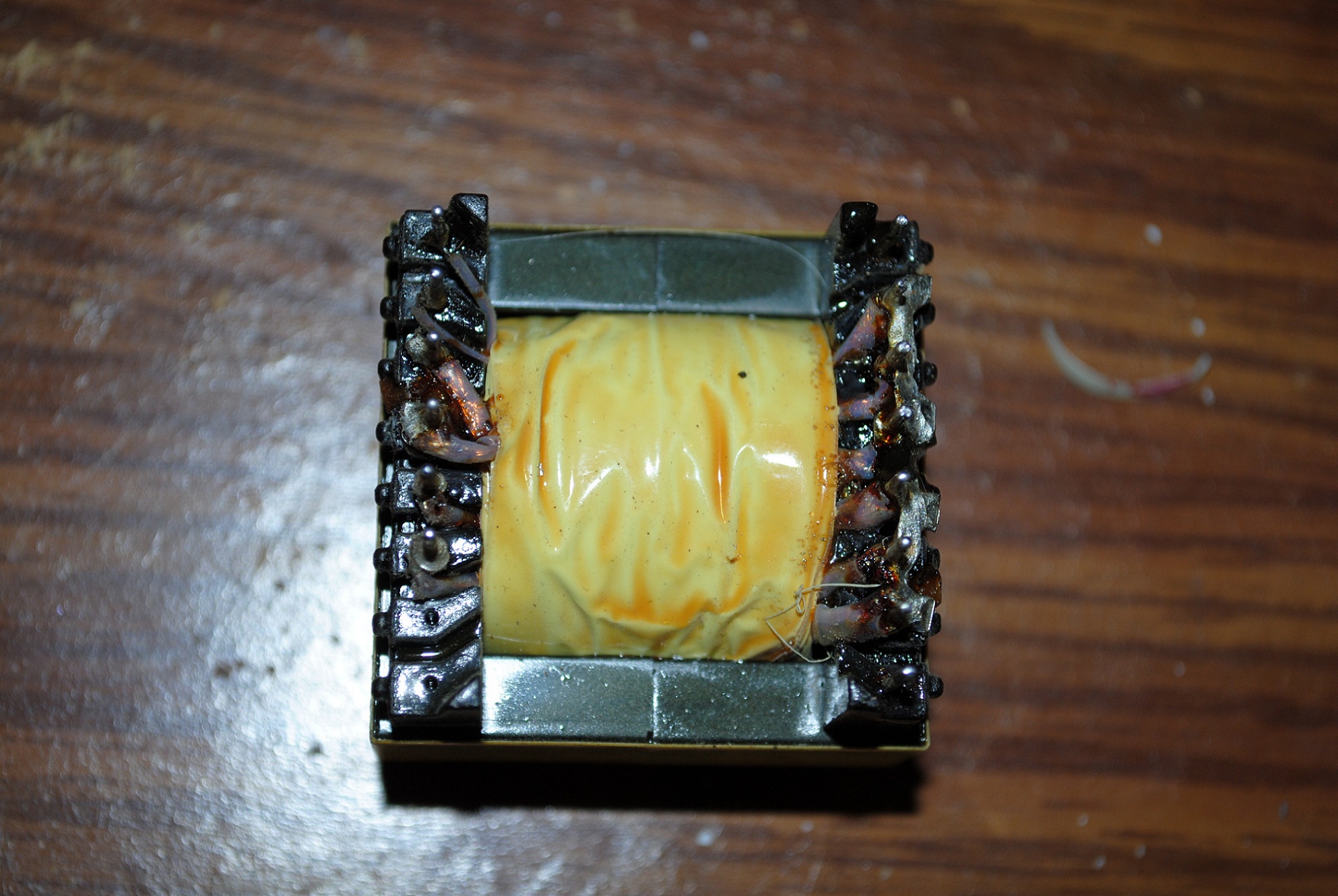

                    Does it looked cooked to you? And whats up with the solder puddles on the one side? Is that normal?
                      It looks normal. If you are sure the puff of smoke was from the transformer, replace it.

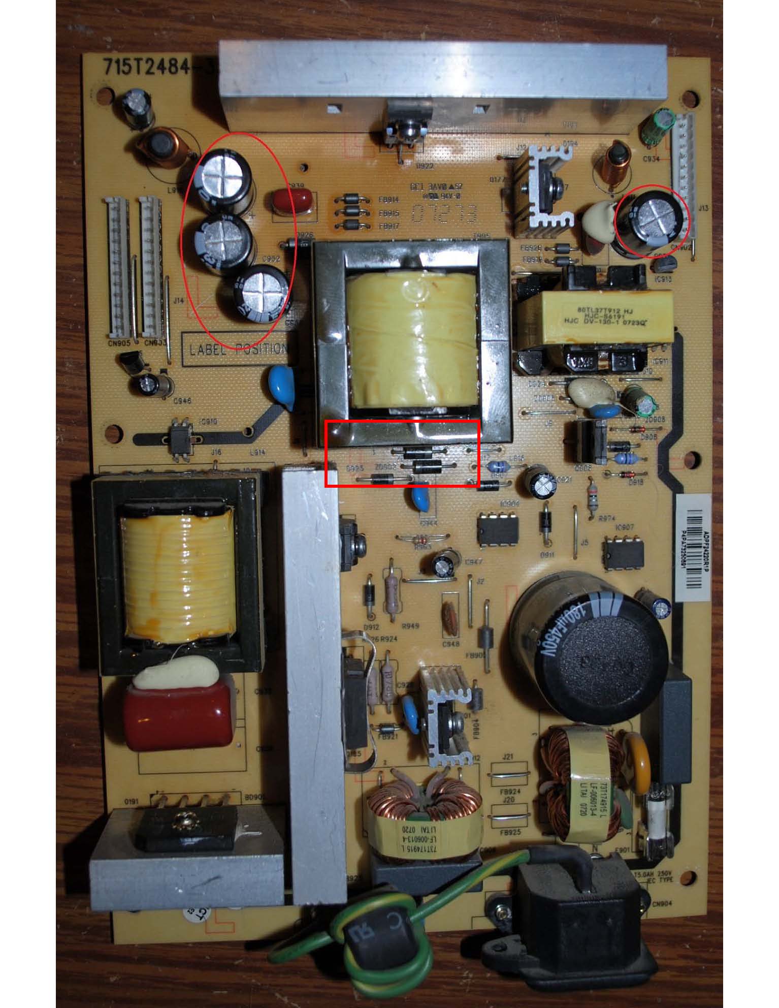

                        Its FIXED!!
                        It wasn't the transformer. The puff of smoke was coming from the one diode directly next to the transformer. P6KE120A
                        I went to radio shack and got a diode. Installed it and the chirping is gone and i have a screen. I'm gonna now order the correct part from digi-key and that should seal the deal.

                              ZD902 & ZD904
                              The 2 diodes directly next to the transformer
                                Check those 3 Diodes, remove them to test them out off the board.
                                The one Bill replaced is part of the snubber circuits.

                                    They are not all the same, look at the p/n as printed.
                                    The one Bill replaced:
                                    http://www.mouser.com/ProductDetail/...4Drj3a5ZKuw%3d
