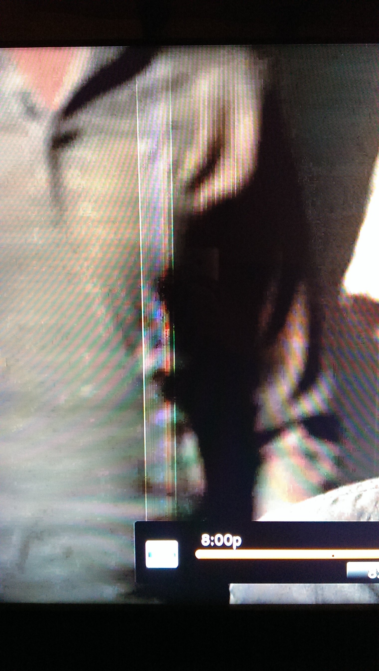

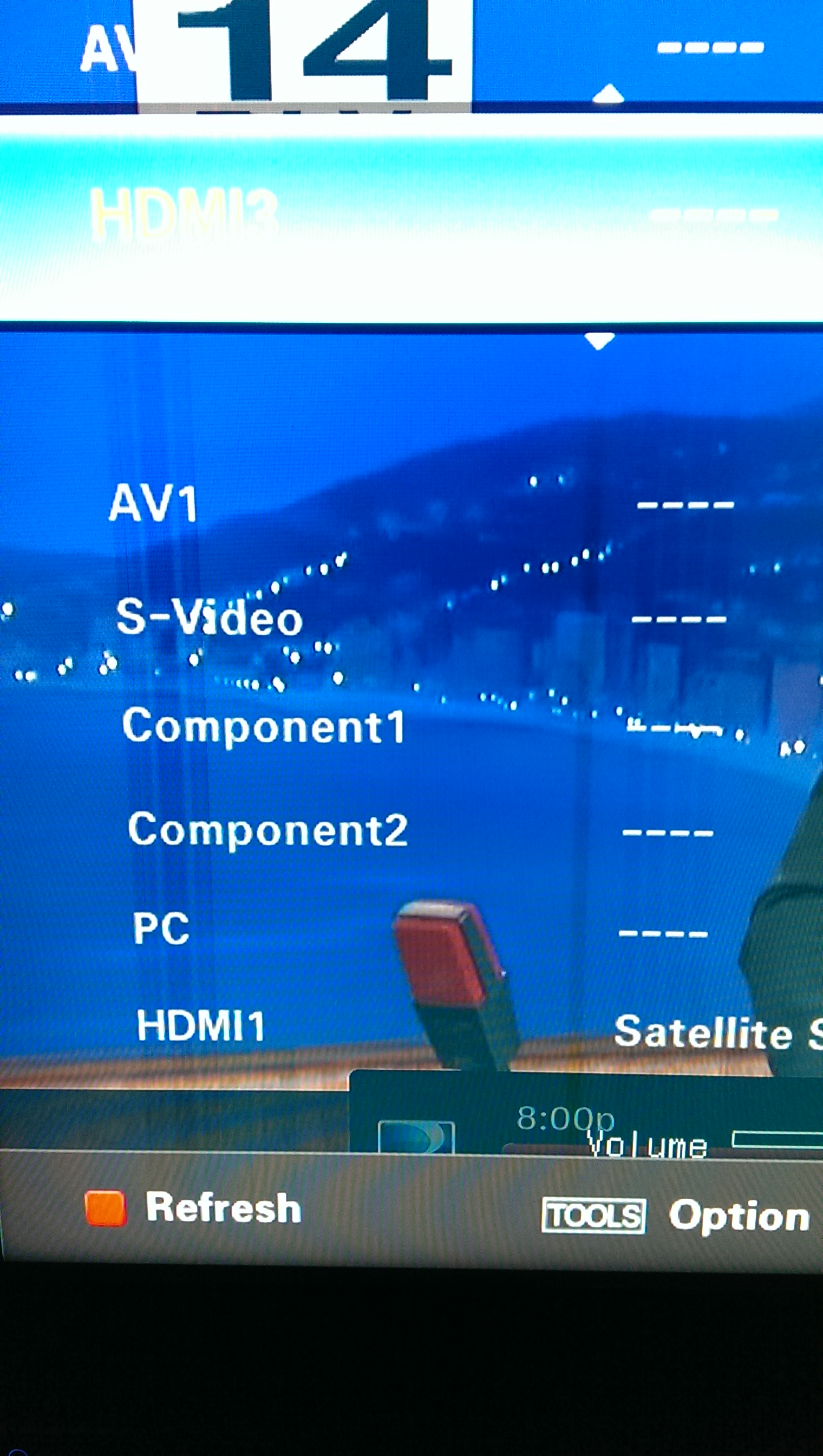

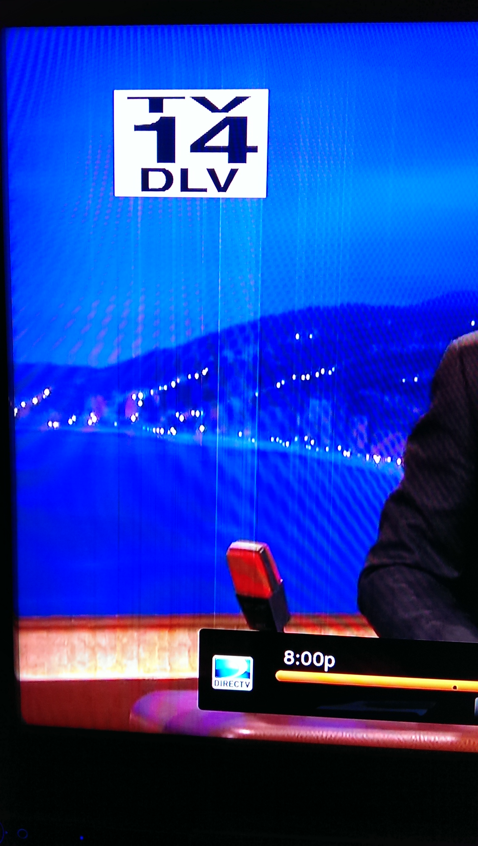

        Hey guys,
        I registered for this forum just to post to this thread.
        I too have the same problem with the vertical lines.
        My TV is a Samsung LN40A750 purchased back in 2008 when it was brand new. I'm really bummed out because it is of course out of warranty, but only 5 years old and basically garbage after this recent problem. The pictures don't do the extent of the problem justice, it's getting worse.
        I am no stranger to DIY electronics work so I am gathering that what needs to be done is a T-Con replacement... Has anyone had any success with this particular series of samsung? I ordered a new T-Con off eBay for 40 bucks. Have already taken it apart and cleaned out the ribbon connectors from the Tcon. Easy stuff, considering I usually work on smaller boards. Put it back together though and no change...
        Sidenote: Samsung TVs are great... when they work. This will be it's 3rd repair and my first out of pocket. I initially had to get the bezel replaced after it had a separation issue with the red coloring, and a couple years ago had to get some bad caps replaced due to the cap plague. Samsung footed the bill for both.
        TL;DR - Vertical Line issue on a 5 year old Samsung LN40A750. Looking for success stories/suggestions.

              T-Con didn't work out for me. Then oddly enough the TV seemed fine after reinstalling the old board back in. Was good for 2 weeks then the capacitors went bad on me again. This would mark the second time I had a cap problem in this TV. Had the clicking, not turning on symptom. Samsung installed new caps once again. Then the TV was good to go again... for a week. Now I'm back to square one with the vertical lines and no real solution.
              I am so fed up with this TV I'm about to part it out. May be the last Samsung product I buy.
              Anyone else has any solutions I am all ears...
