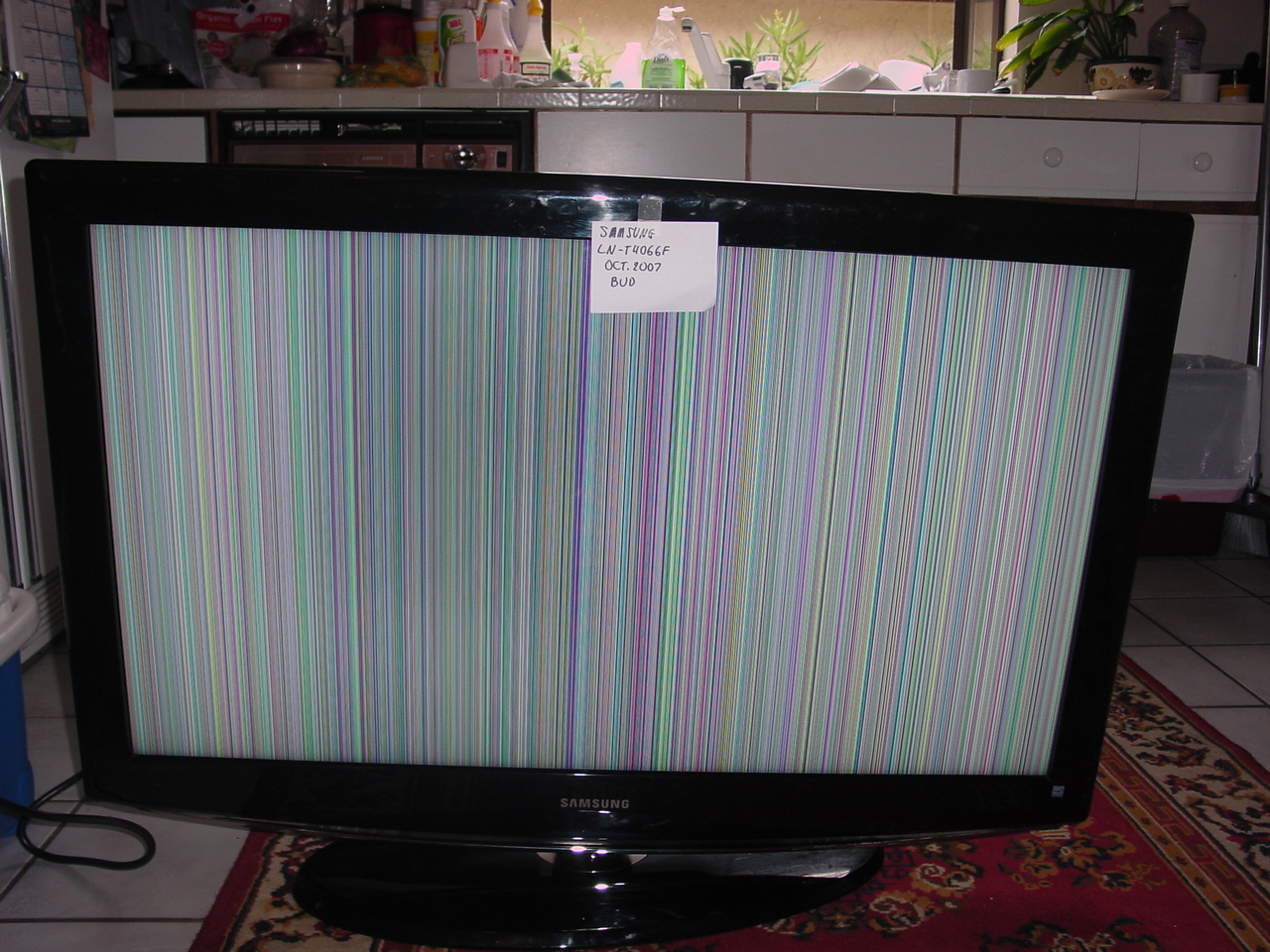

    I'm new to these forums. I have a problem with my Samsung LCD TV. There appears vertical lines where ever there is text on the screen. See my picture attachced. I asked a local TV repairman and he said I have to replace the whole pane. Could this be fixed by replacing some kind of printed circuit board that drives the lcd panel? Thanks for all the help in advance.

    It could be the tcon, it could be the panel.

      Thanks PlainBill. I'll try opening this unit up and see. It's already broke, what is the worse that can happen other than electricute myself. I promise not to do that. I was suspecting it to be not the panel since the lines follow the overlayed OSD type display. The adventure begins. Thanks again.

        The panel displays exactly what is sent to it, as does the T-con. Neither differentiate between OSD and video.

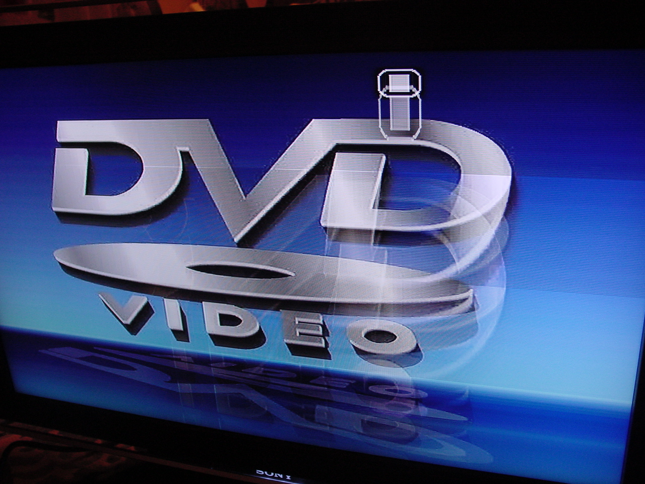

                      What is the exact model number?
                      Is it the Tcon?
                      What happens to the display if you bring up the TV setup menu?

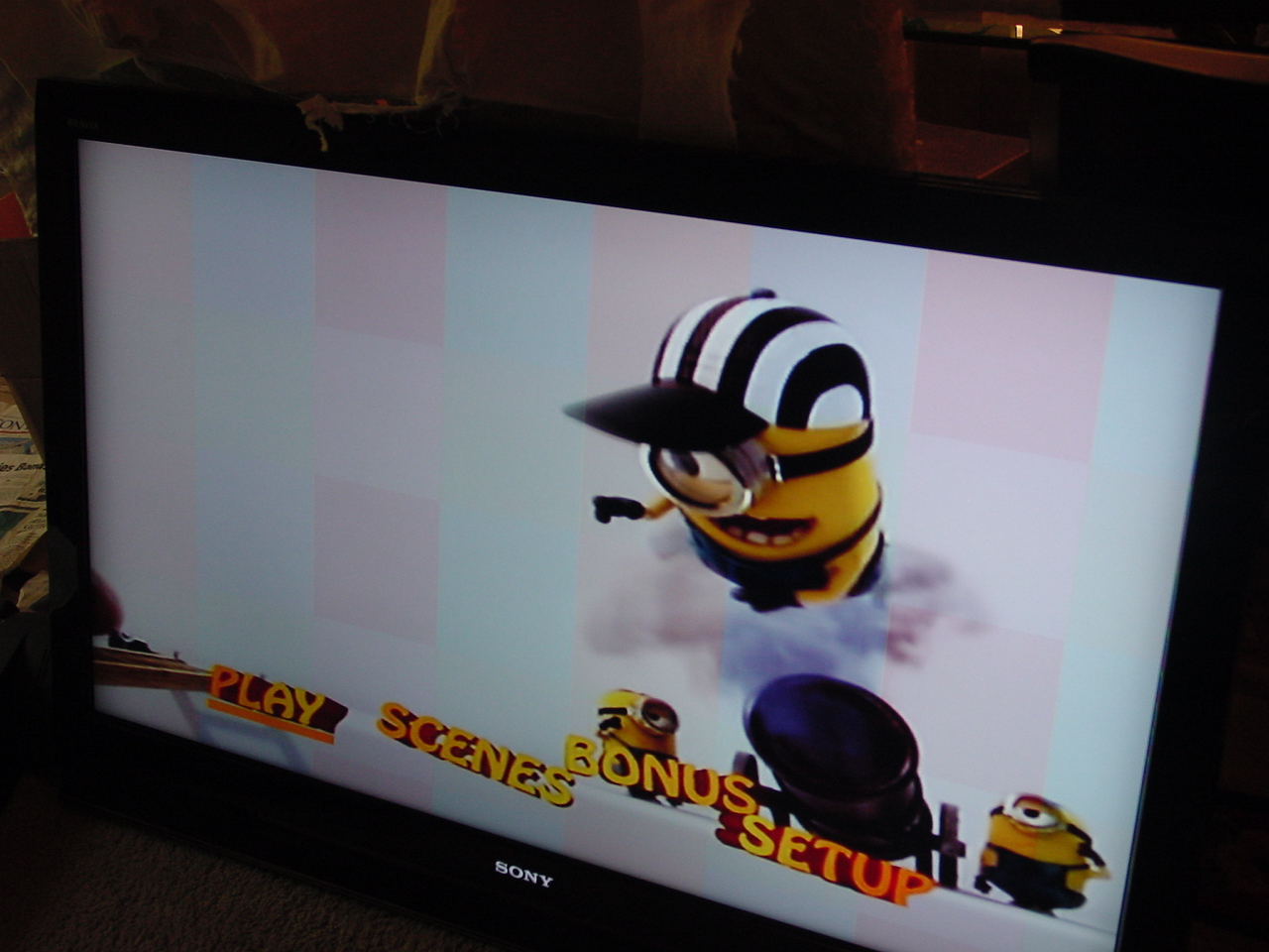

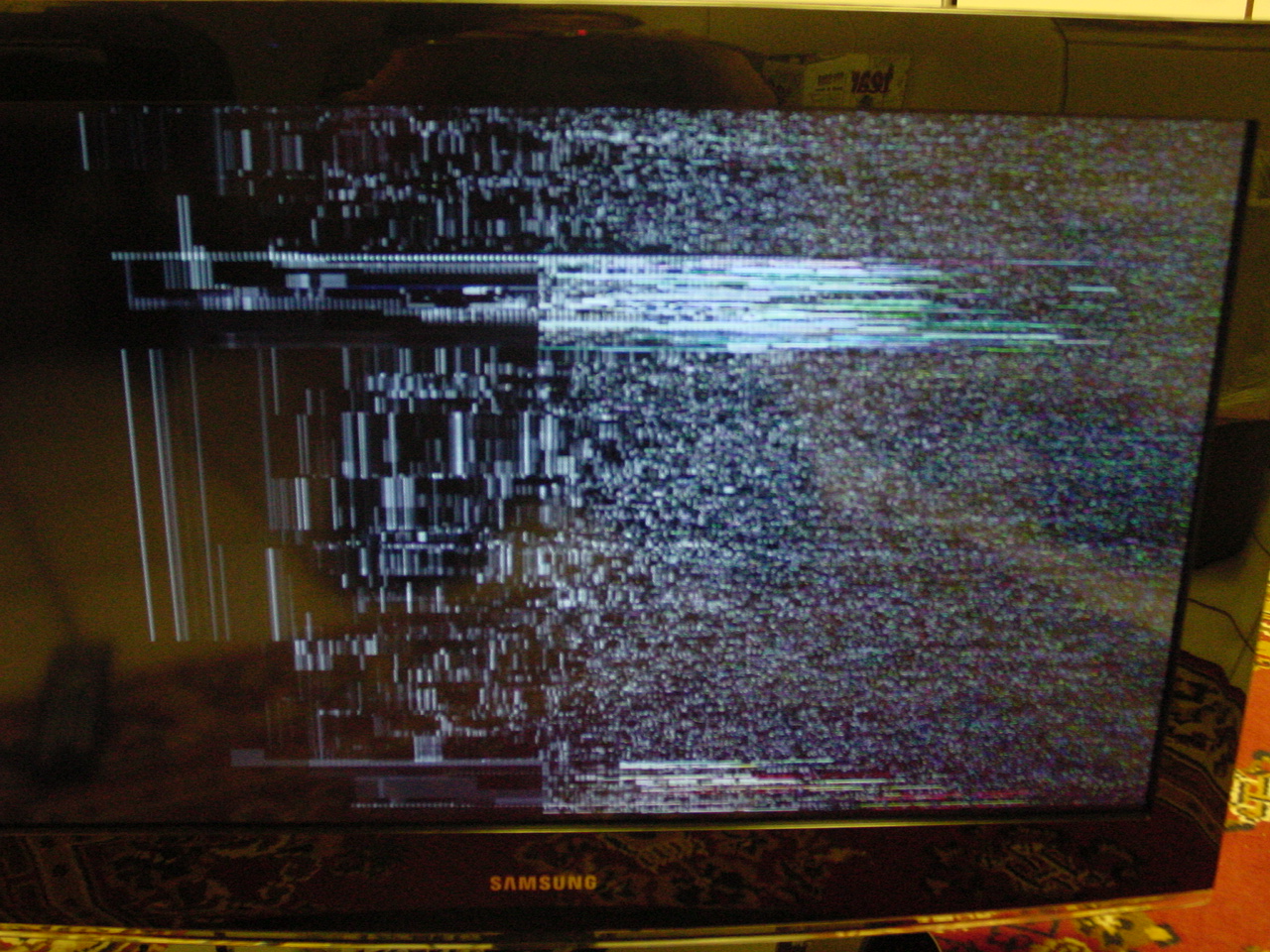

                        It happens sometime in the left side, then the right side. I would try reseating the ribbon cables between the T-CON and the LCD panel first. This kind of problem is hard to be 100% sure, I would spend the money on the least expensive board first.
                        See the examples of what I have found and the fixes are.

                                Make pressure where you have the lines. If it corrects, then the problem are the contacts.
                                I fixed some monitors by adding styrofoam to make the pressure.
