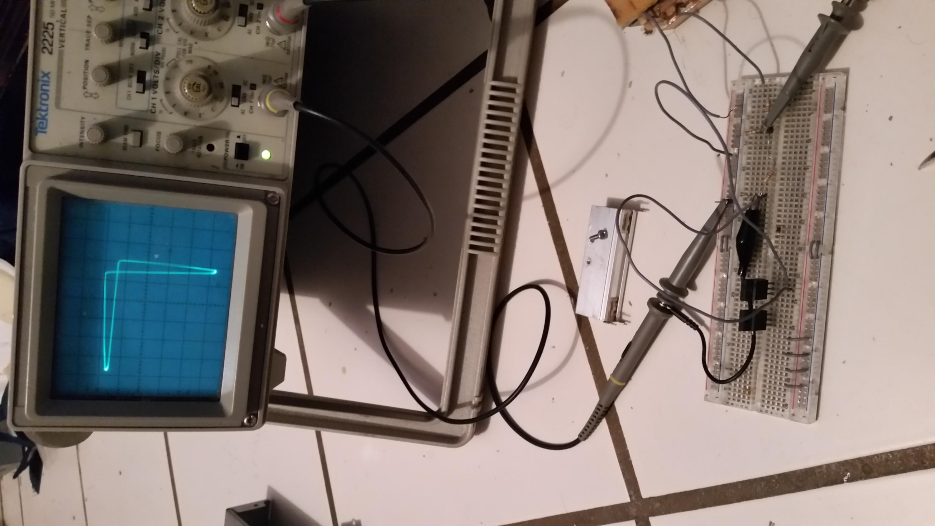

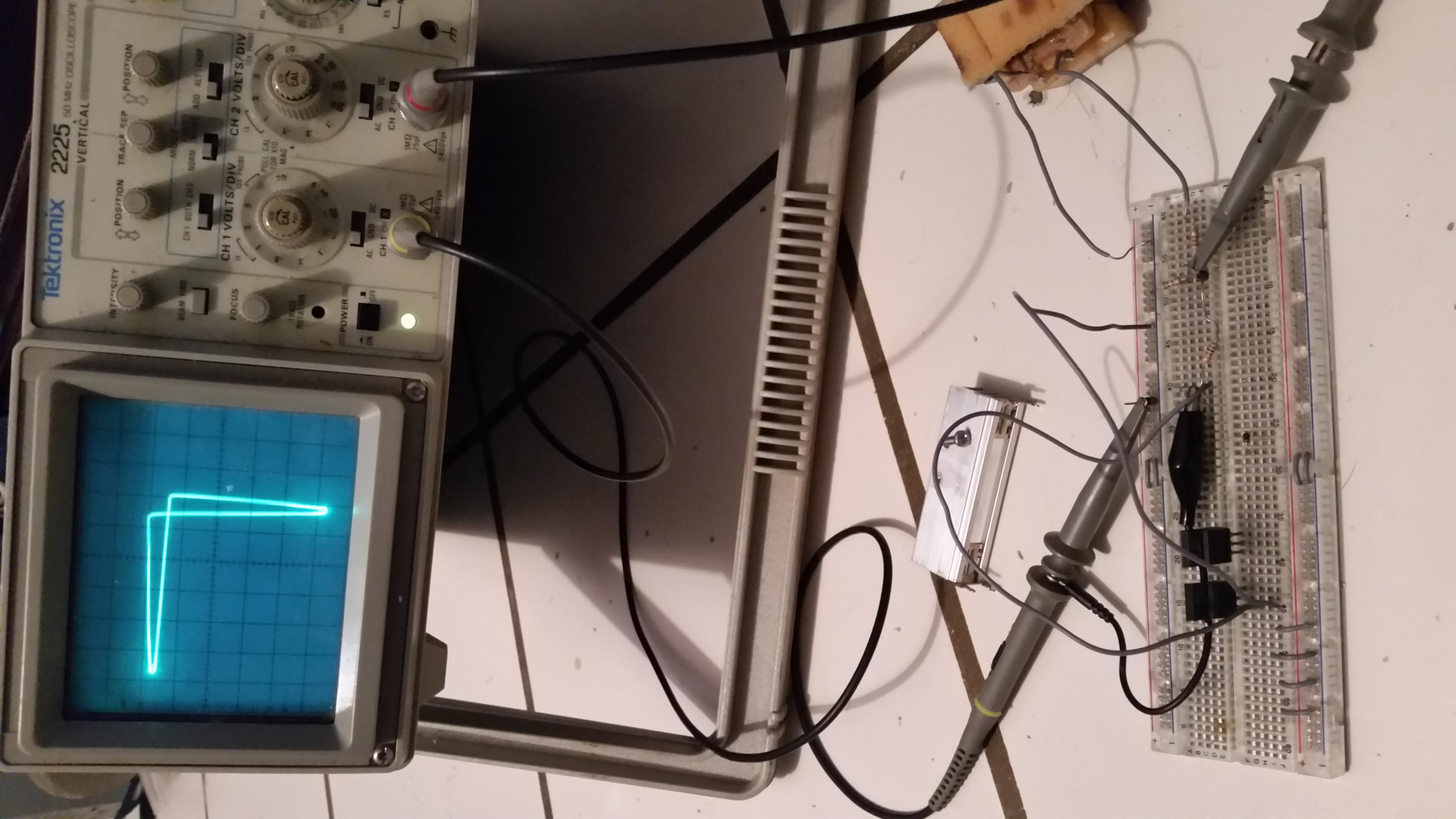

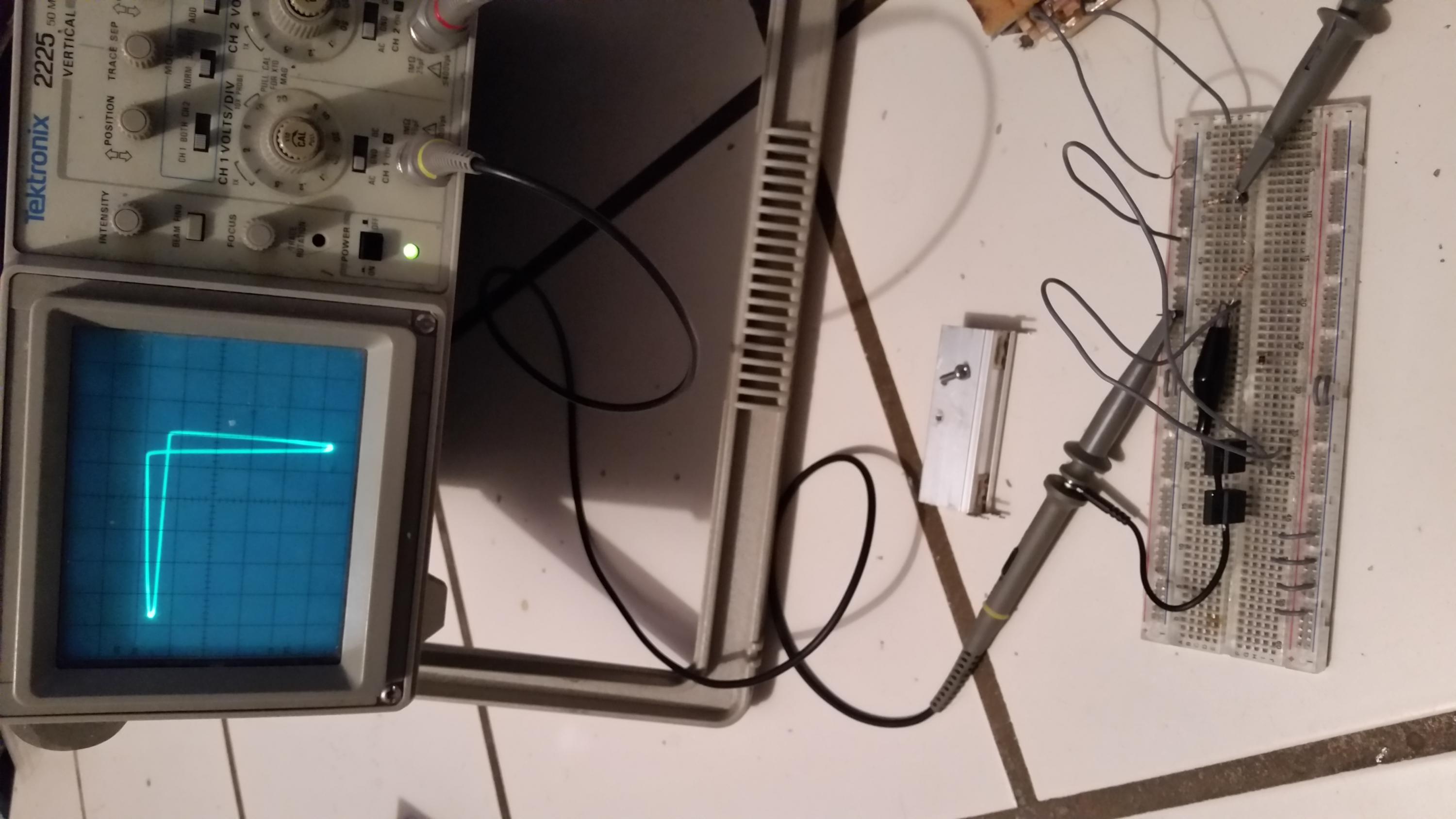

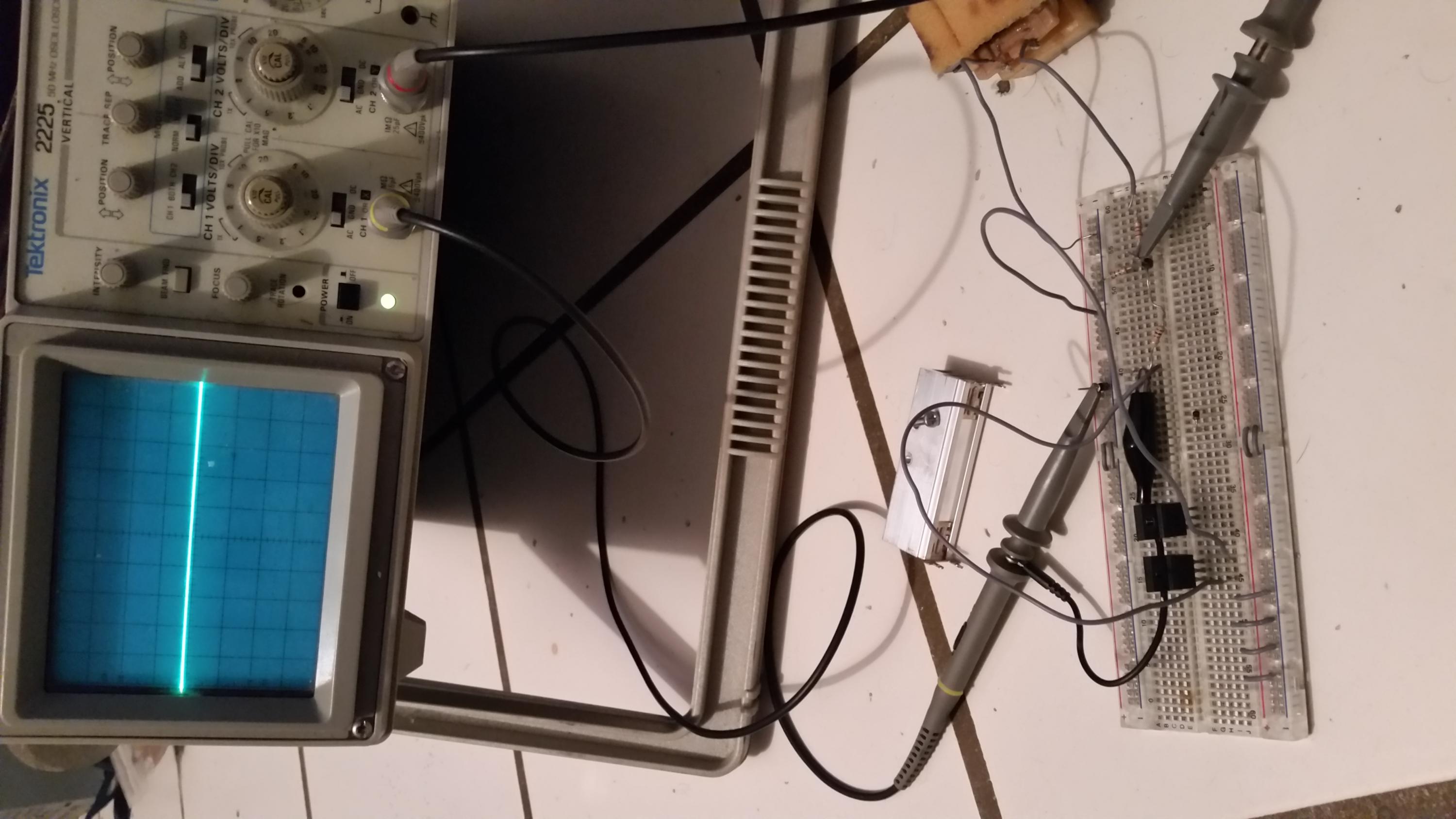

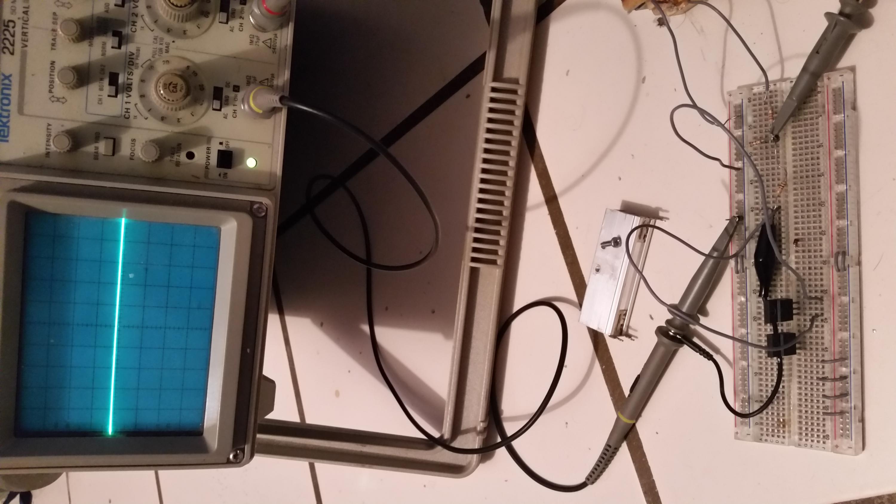

                      #90
                      Re: Samsung LE32R88BD/ BN44-00155A
                      I checked those earlier but just to double check them here are some photos of curve tracer on them. They seem to be working properly, not shorted and show to be working like a diode on its respective polarities.
                      They read same value all around. So no shorts there.
                      1st anode to cathode on A diode
                      2nd anode to cathode on A diode
                      1st anode to cathode on B diode
                      2nd anode to cathode on B diode
                      anode to anode on A diode
                      anode to anode on B diode
                      Edit: Pictures got rotated by the forum server :/
                        • 31283
                        #91
                        hmm - i never liked that type of testing.
                        if your sure then check the 2 1000uf caps.
                        if they are bad the zener will get hammered by high frequency spikes.
