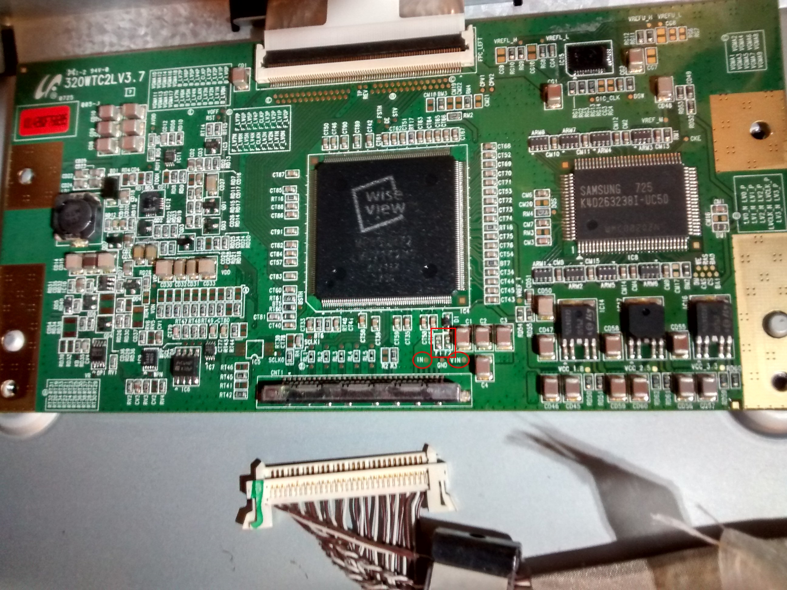

    Pictures are not clear, it looks like there are two fuses, F1, F2.
    Check for DCV at both ends of both fuses with ref to chassis GND.

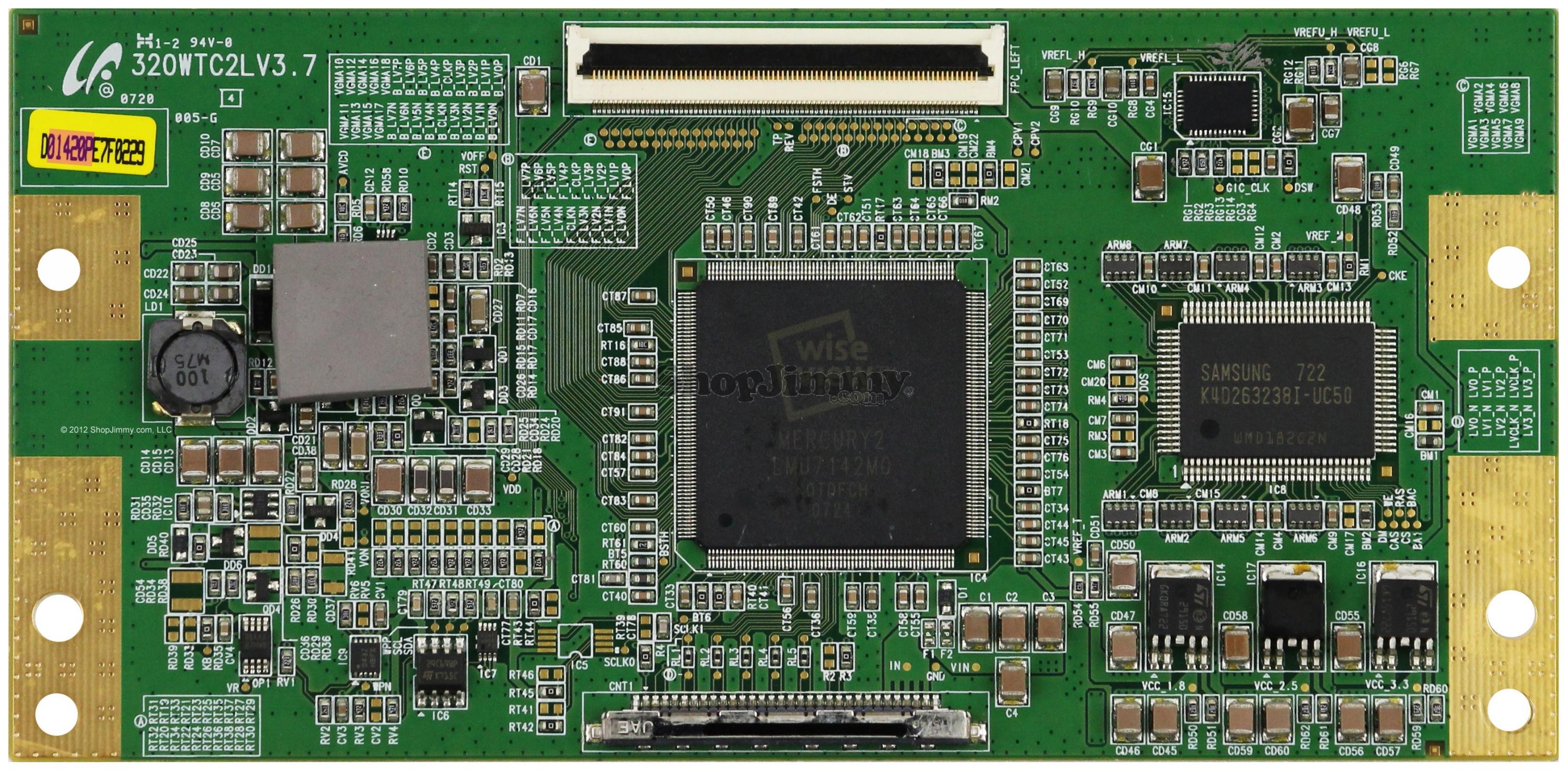

      Pictures provided by shopjimmy.
      Samsung LJ94-01420P (320WTC2LV3.7) T-Con Board.

        #223
        Re: Samsung LE32R88BD/ BN44-00155A
        A good picture here budm
        http://www.placilcd.ro/en/produs/pla...tc2lv3-7--577/
        you are right f1 and f2 just above lvds connetor on the right hand side
          U guys are great and helpful.
          So my measurements are 1.6V on three ends and 5.2V on F1 on closer to big chip end.

            #225
            can you measure and write the readings just too make sure, maybe test f1 bottom of fuse what voltage is it? top of fuse what voltage is it? and the same with f2 its just easier for us to understand as we havnt got the board in front of us thanks

              #226
              on a picture @budm posted, all ends 1.6V except F1 top end 5.2V

                #227
                so that means f1 fuse has blown for some reason maybe budm has some more tests you can run. im not sure how cheap these tcons are in your country.
                  #228
                  So F1 is blown.
                  OK leave the the LVDS cable disconnected from the T-CON, then take the resistance reading between the 'GND' test point on the T-CON board against the three ends of the fuses that show 1.6V readings and report the readings, make sure if the readings are shown in OHM, K OHMS, or M OHMS on your meter.

                    #229
                    seems more as i set meter if set on 200K it measuring 60K resistance, more if set to 2M. So no shortage on all three ends. Fuse is blown i see now also

                          #232
                          So thats it? Just change fuse and could be good to go if there is no short as i measured resistance?
                          or short fuse.. donno how are correct words in english, maybe some bad part blow away and we'll see, that's how my old coworker made repairs in pulse power factory repair station maybe too destructive in this situation, where i don't have infinite number of power units, but one tv
                            #233
                            The shorts may be AFTER the active circuit/device that is only drawing when it gets the ON command. You can try a new fuse to see if it blows again or get the new T-CON board. I just hope that it is not due to shorts circuit in the panel itself.

                              #234
                              Do you know how much amps fuse to get? Can't find in datasheet you provided.
                              Can i get to know before purchasing new t-con that isn't short circuit in panel itself?

                                #235
                                It looks like it has 'P' printed on top, so it may be LittleFuse with 'P' code for 3A.
                                I cannot tell from the pictures if it is 1206 or 0603 footprint.
                                You can try 3A fuse with leads for testing.
                                You can run the T-CON board WITHOUT having the ribbon cables between the LCD panel and the T-CON board connected to see if the fuse will blow right away, if not , then connect the ribbon cables back in place and try again.
                                  Got on it before while. I put there 3A bigger fuse on wires and picture is working, all seems good. Do you think its safe to assembly and it was only some one time accident that blown fuse?
                                    #237
                                    You can keep it running with this 3A fuse which is safe as long as you do not let it shorts to anything else, but make sure to put the gray heat transfer pad as shown in post 222 back in place with the shield.

                                      #238
                                      Yeah i put whole metal housing with pads back on that t con board (not on picture), just fuse is outside on wires, same type as you using probably, with legs.
                                      So thanks a lot for helping me out and saving some mom's money. Really great community here i'm still surprised. Have a good time.
