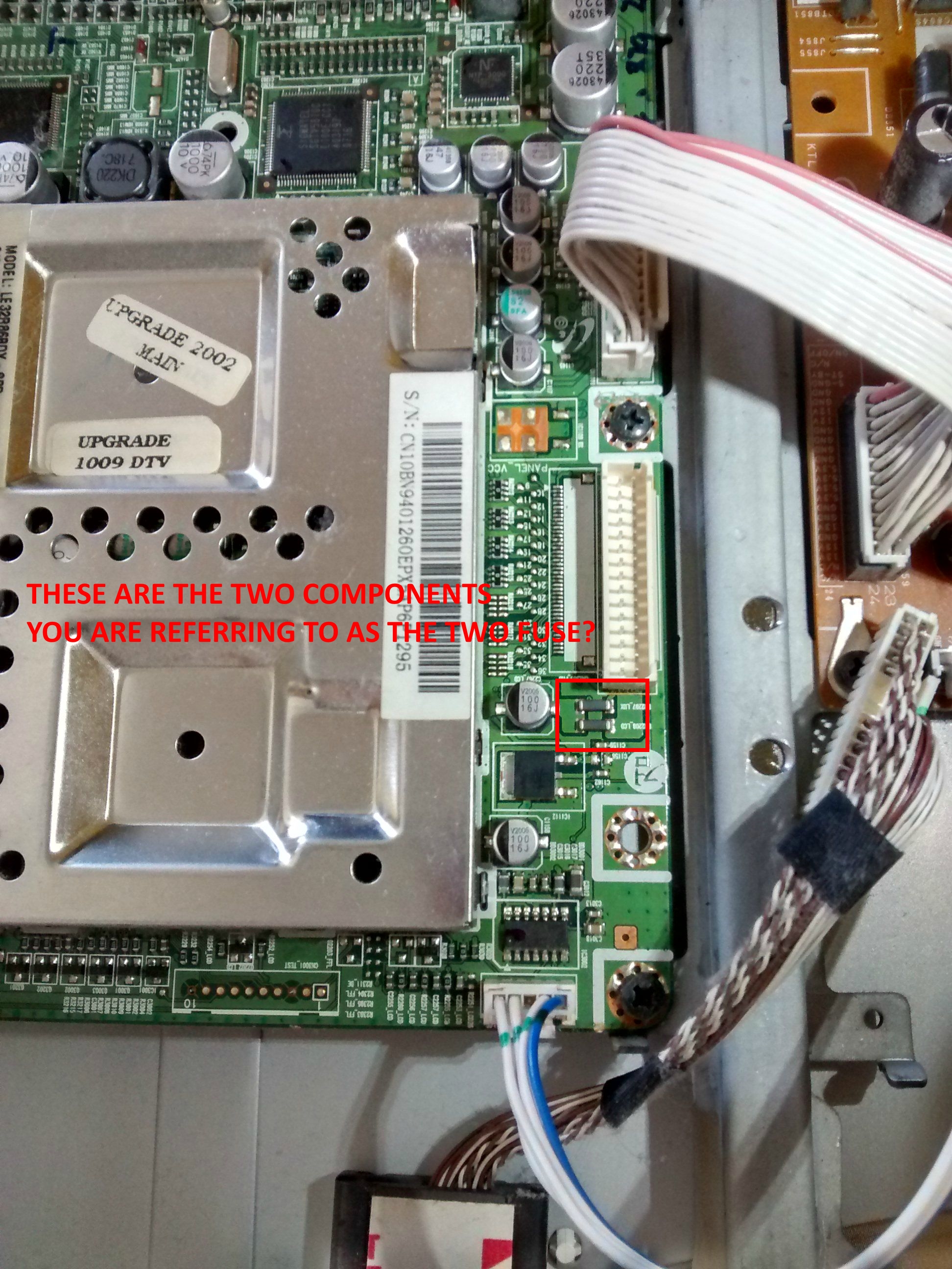

Can I see the pictures of these two fuses?Never stop learning

Are you referring to these two components?Attached Filesif you find these attachements useful please consider making a small donation to the site

Those two are NOT fuses, they are Ferrite inductors.
What is the LCD panel model number as printed on the sticker?Never stop learning

OK, your T-CON board runs on 5VDC so you do have DCV to the T-CON, so you need to find out if you do have 5VDC at both ends of the SMD fuse on the T-CON or not.Attached Filesif you find these attachements useful please consider making a small donation to the site
