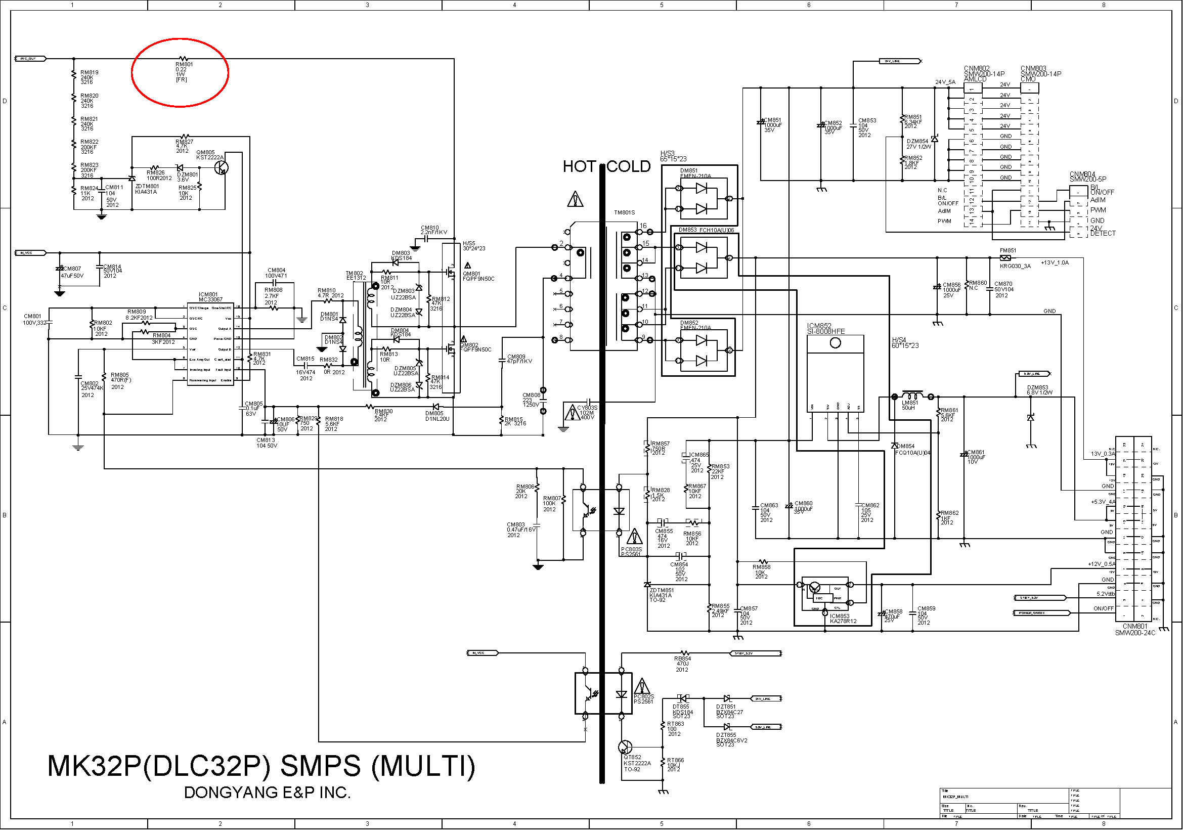

          Can anyone tell me the value of the resistor RM801 please? I can see from the schematic it is 300K ohm, but I'm not sure of the power rating?
            Re: Samsung LE32R88BD/ BN44-00155A
            I look at my SCH , RM801 on page 2 is 0.22 Ohm 1Watt resistor.

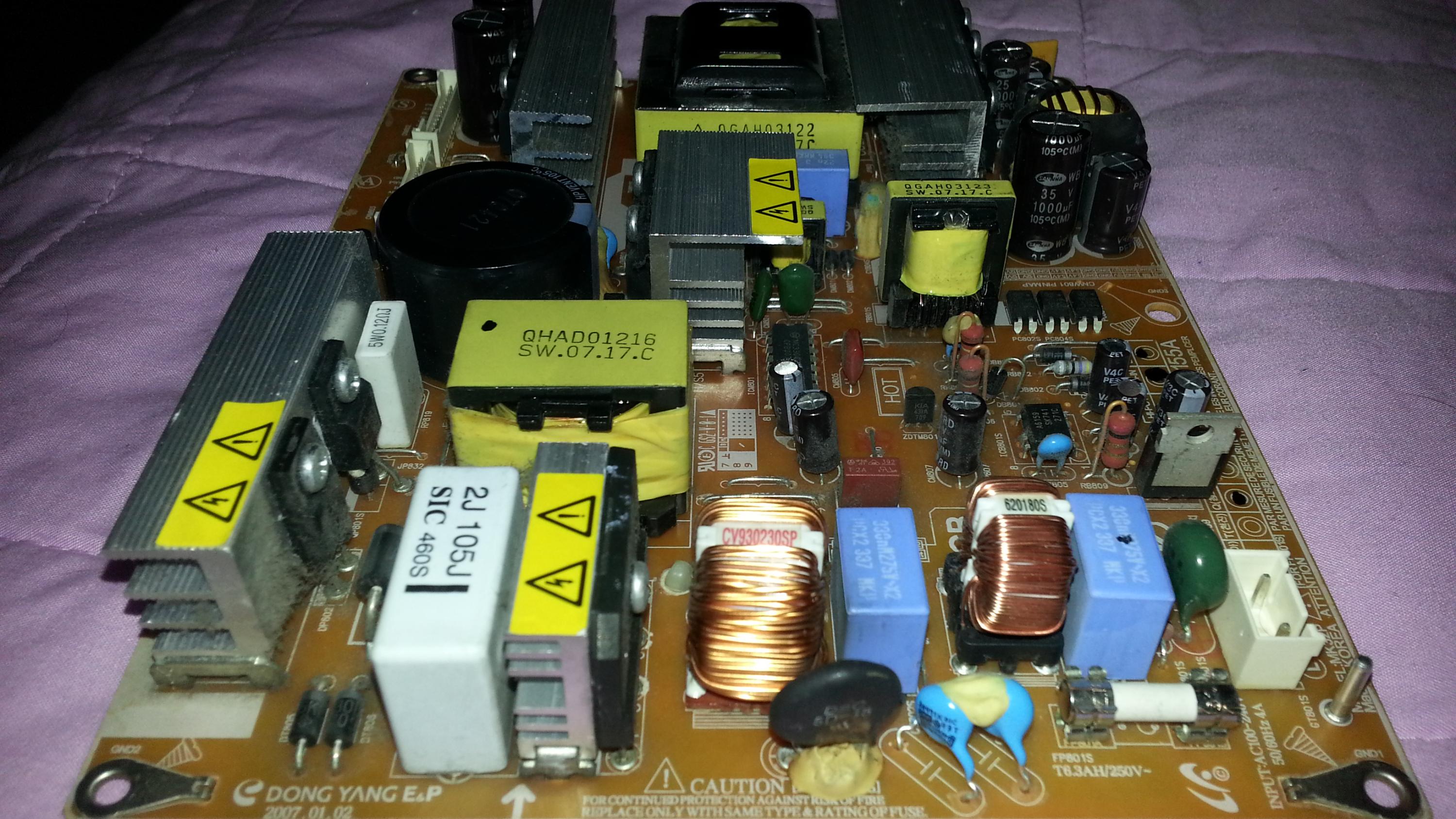

                  • APKIS
                    • Apr 2013
                    • Norway
                    #29
                    Hi there!
                    I am the very new user here, but I managed to find the thread I was about to create.
                    I have BN44-00155A power supply board in Samsung LCD TV. Same problem as everybody mentioning.
                    As you can see from the picture, RM801 is burnt, and some of the glue are really dark brown, which should be removed (as i understood from the posts).
                    I can't see any of physically damaged caps.
                    Could someone give some hints if they understand what could be wrong with the board that caused RM801 failure. Thank you in advance!

                        #31
                        @APKIS, RM801 fusible resistor is blown is more likely due to shorted out MOSFETs, see the attached diagram.
                        Make sure to remove all the yellow/brown glue.
