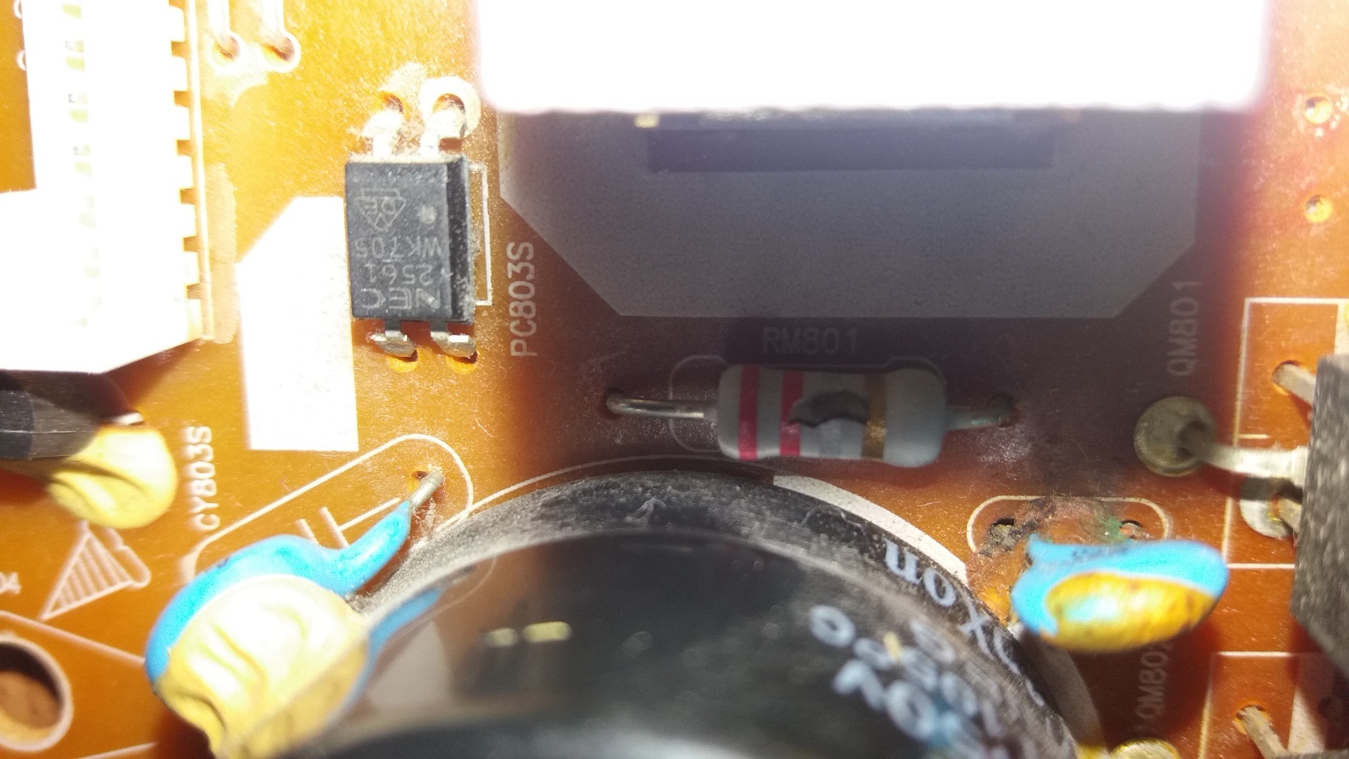

      Originally posted by dsc
      Well my set has crapped out again, as a refresher it is a Samsung LN3253HX with the BN44-00155A board.
      Since the cap, fuseable resistor and mosfet replacement it has been golden. I am gone frequently for extended periods so I unplug the set each time.
      This time I heard a soft pop, much like when you plug in a power supply for a Macbook, when I plugged it in but everything worked fine for a couple of day. When I turned it on last everything started as normal (set had been plugged in for 48 hours) when all of a sudden the set went dead, not even a standby light.
      I looked over the board and couldn't see anything so out came the meeter. So far I have only found an oddity on diode DB851. I'm getting a reading in both directions (sorry, didn't write down the value) but when removed from the board it tests fine.
      Is this normal or do I have something else I should be checking.
      Photo is not of my board but of the right model.
      I assume you have checked the parts you replaced last time?
      We need a better photo too, of your own board. A tiny photo of someone else's board doesn't help much.
      Might help as well to show where DB851 is too? Is there a schematic on here for your set?
      -David VanHorn

          If DB851 tests OK out of circuit then I guess it's OK.
          I assume you get no output on ST/BY rail? Should be 5.2 volts.
          Do you get any power to CP803 (Main filter capacitor?) - should get rectified line voltage there, about 160v-170v without the PFC on.
          If you do have right voltage on CP803, check power to Pin 5 of ICB801S and Pin 1 of TB801S.
          -David VanHorn

            Vinceroger69, I did pull it and test, checked ok. Thank you for the sch, I've been on the thread before but forgot it was here.
            Agent24, I'm on the road right now, will post a better shot when I get back. Had checked majority of the board (everything I had replaced before included) statically, ran out of time to check it powered.
            Will check the point you listed.
            Thank you for the help!

                  Had enough of searching for the problem so I picked up a power board on ebay for $28 total.
                  Works perfect so worth the savings in time alone.
                  Now I have a board I can pull apart and learn on.

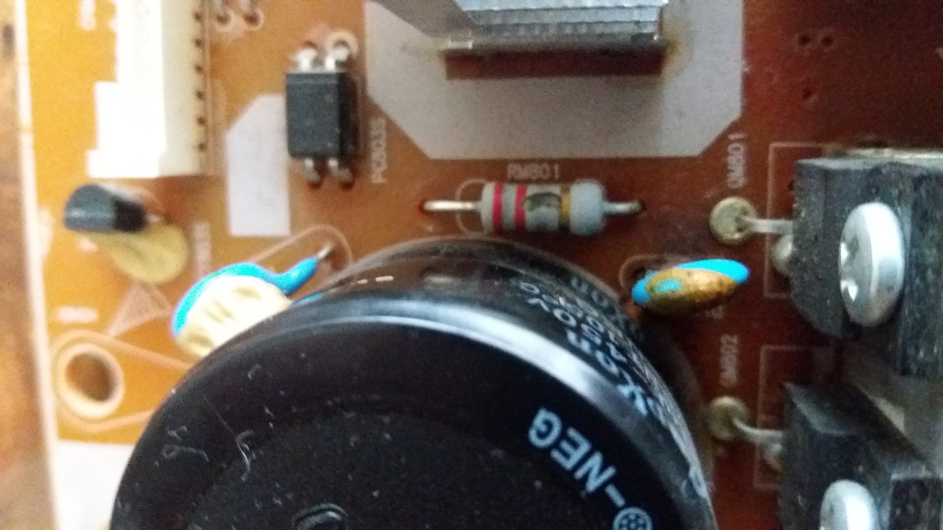

                      Re: Samsung LE32R88BD/ BN44-00155A
                      Add me as another person that replaced the RM801 FR, and brought life back to Samsung LNT3253H containing this power supply board, as per...
                      https://www.badcaps.net/forum/showpo...2&postcount=60

                        Hi,...
                        I manage to revive my tv set LE32R88BDX, after i read this thread.
                        Thx again to all for your advices.
                        I just remove the glue from the QM802 and reuse, RM801 is toasted and i use one 0,22R 1/4 W for testing, all its ok.
                        I cant find until now one 0,22R 1 W fusible resistor, and question is if i can use another one.
                        Any hint value and power (0,1R , 0,3R , 1/2 W, 2 W)?

                          I popped in the MOX resistor (non-fusible) listed below, and it has been working perfectly for over a month now...

                              I've got the same set, RM801 confirmed bad. Replaced, all OK.
