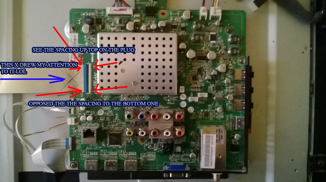

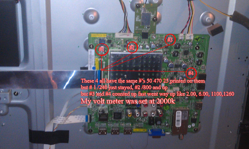

                              I have the same model of tv
                              and having a different issue anyone could please help me
                              tv turns on back lights come on and dim down as normal but no video
                              I can't tell if it has sound or not as for I can't see the screen to select the video source.
                              I have the back cover off and have search through all of the boards and can not find anything wrong no burn marks no bulging caps, Everything looks as new.
                              no smells from anywhere.
                              But I was testing around the video board on some silver caps with 50 470 25 written on them total of 4 the picture will explain more in detail of my findings with the volt meter any help I would appreciate it much thank you.
                                #35
                                Re: Vizio M470NV LED LCD Help Needed!
                                It sounds liek the T-CON board is not getting the voltage feeding from the main board if you do have backlights but no pictures. Pictures of the whole back side of the TV so we can see all the boards?
                                • Jaymzway
                                  • Oct 2011
                                  • 15
                                  #36
                                  Re: Vizio M470NV LED LCD NO MORE Help Needed! FOR ME
                                  Thank you good sir lmao hahahhahahhahah hell ya boy i got it working on an accident im so excited omg and i payed $40 for this bubba it was the ribbon.
                                  someone apparently had done some work to it and snagged the ribbon.
                                  Now all I need is the original remote to go with it man this thing looks great! hell yea movie night. Sorry guys I never have this kind of luck so I'am dancing all over this one... thank you all for trying to help me anyways. hope the picture shows my findings here

                                    • Jaymzway
                                      • Oct 2011
                                      • 15
                                      #38
                                      me 2 bud i didnt find this out till you asked me to take some pictures and when I did I took notice to that ribbon with an X on it and I was like what the how that get on there. I didn't remember seeing that. so I took it off and looked at it and checked the ribbon for defects and saw nothing and then when I went back to look at the picture I then seen that it was partially out of socket lmao....
