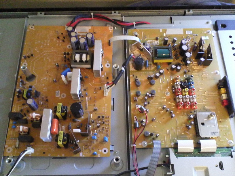

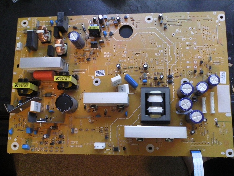

    Hey Guys,
    You very helpful badcap members previously helped me repair a power supply issue by replacing 3 caps in a 42" Philips, thank you very much!
    I got my hands on a newer LCD (42PFL3704D/F7) that turns on and stays on, has audio, but no picture. I can see the light in the back turn on and the screen is illuminated but black.
    Any idea where i can start on this? Thank you for any feedback in advance!

    Re: 42PFL3704D/F7 No picture
    Originally posted by fellim
    Here are some pictures i took of the 2 boards on the back: http://imgur.com/a/ZFpKc
    For many reasons which I won't go into, we want the pictures uploaded to this forum using the "manage attachments" and not offsite. Pictures should be no bigger than 2000x2000 resolution. Also, please do not post inline.
      Edit made, sorry about that.

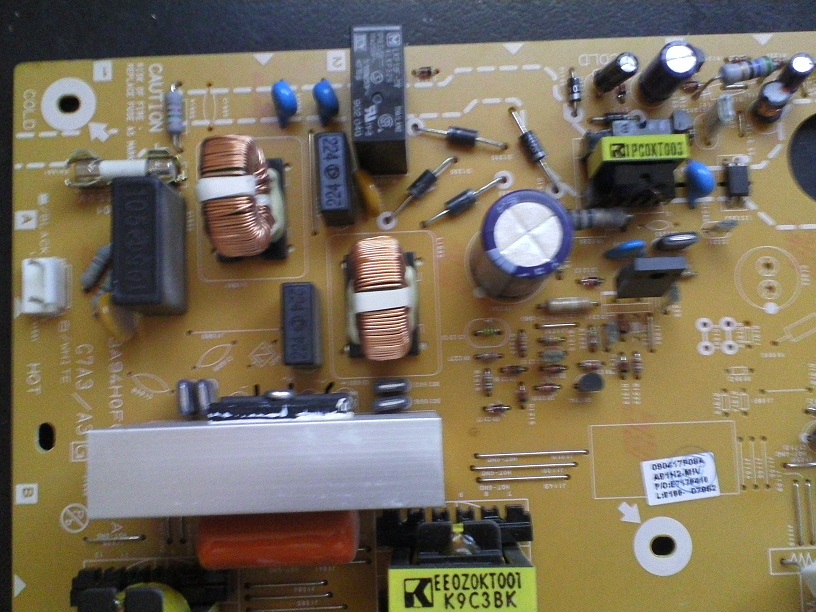

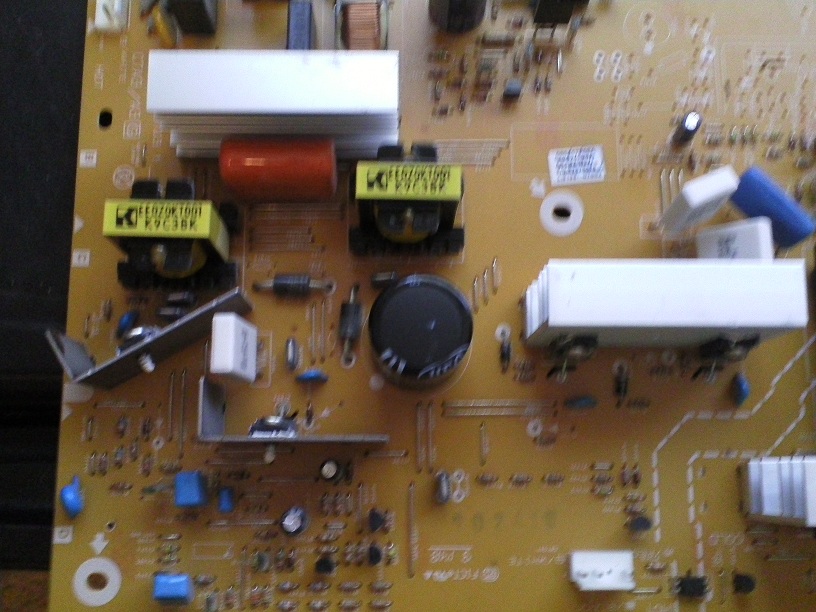

        The power supply is probably okay, but just to rule it out have you checked the output voltages on it?
        Also that power supply is disappointing to see in a Philips, full of cheap caps and the design doesn't seem well thought out.

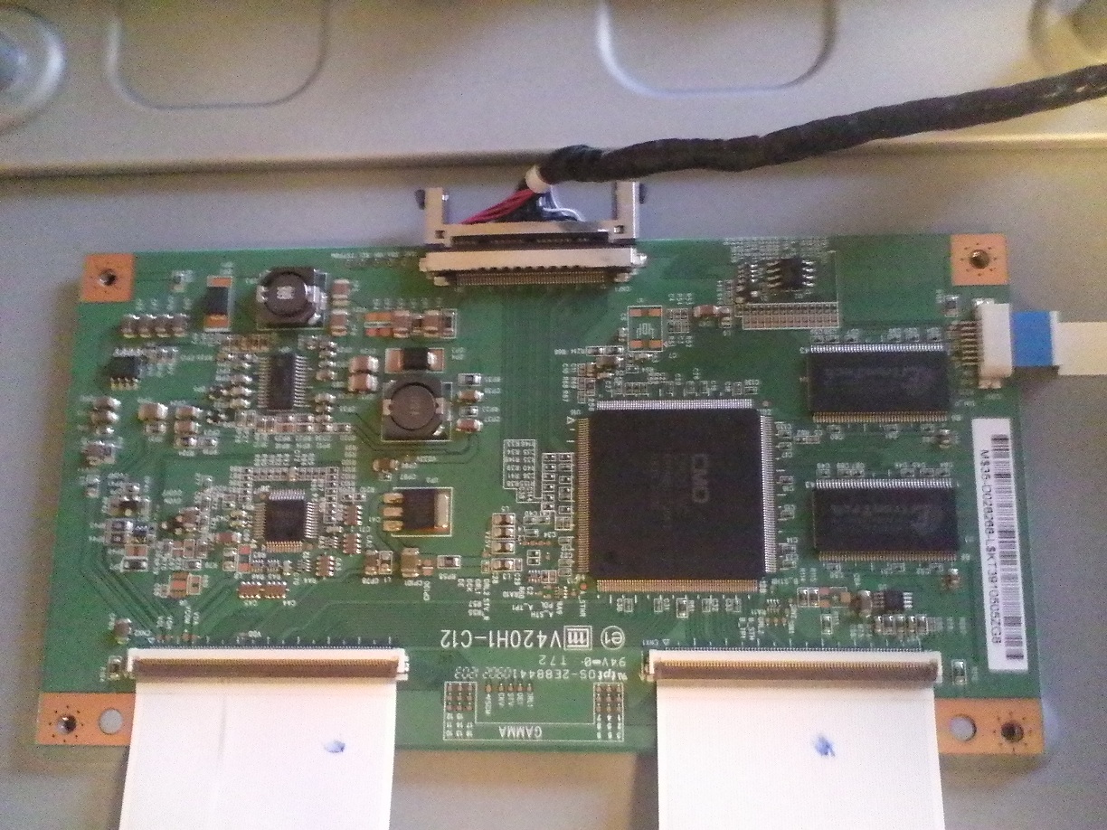

                Well i feel dumb... received new t-con in the mail via shopjimmy.com, knowing it was the wrong board i tried to plug it in to see if maybe it could work. Nope. Now i think i shorted a fuse because i get no power. Plug it in and no light.

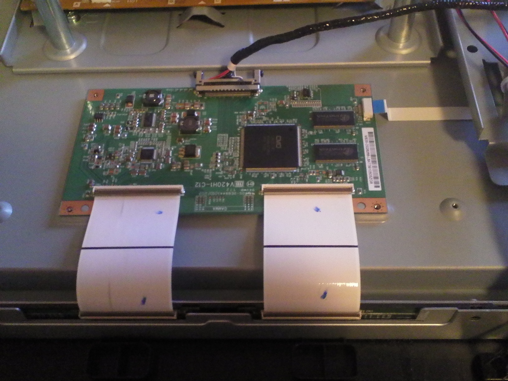

                        Finally got my hands on a multimeter. Where should i begin testing? I was wrong about the backlight, it doesn't turn on. A new one was only $40 on ShopJimmy.com so i swapped it out but no luck. The white power light comes on, i hear a zap noise when i turn the tv on and off (stays on), but black screen. I can hear sound and flip through the channels. Thanks for sticking with me on this guys, i should have got the multimeter sooner

                              How can i test the T-Con? Multimeter newb here...

                                  Pictures of inverter are posted above in the OP. How do i go about testing the T-Con board? That is my main culprit since i have swapped the inverter, main, and backlight with no luck (i plan to return these).
