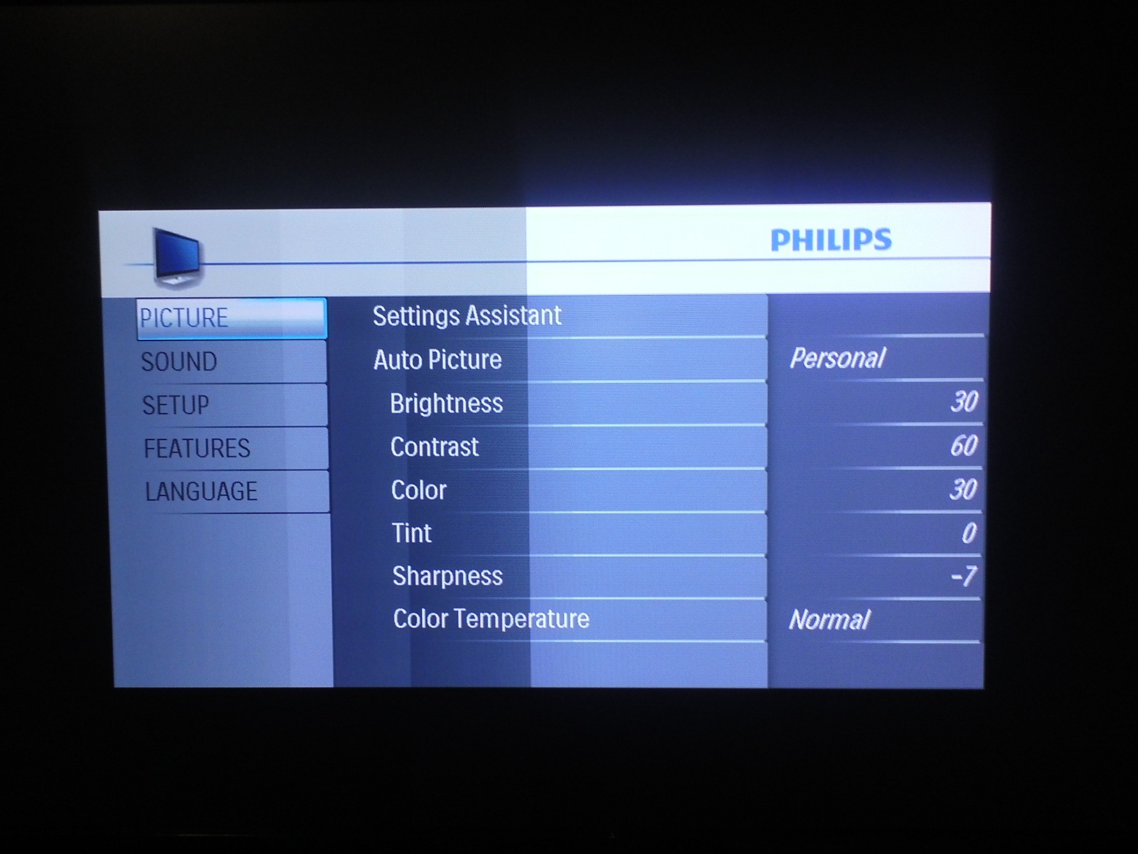

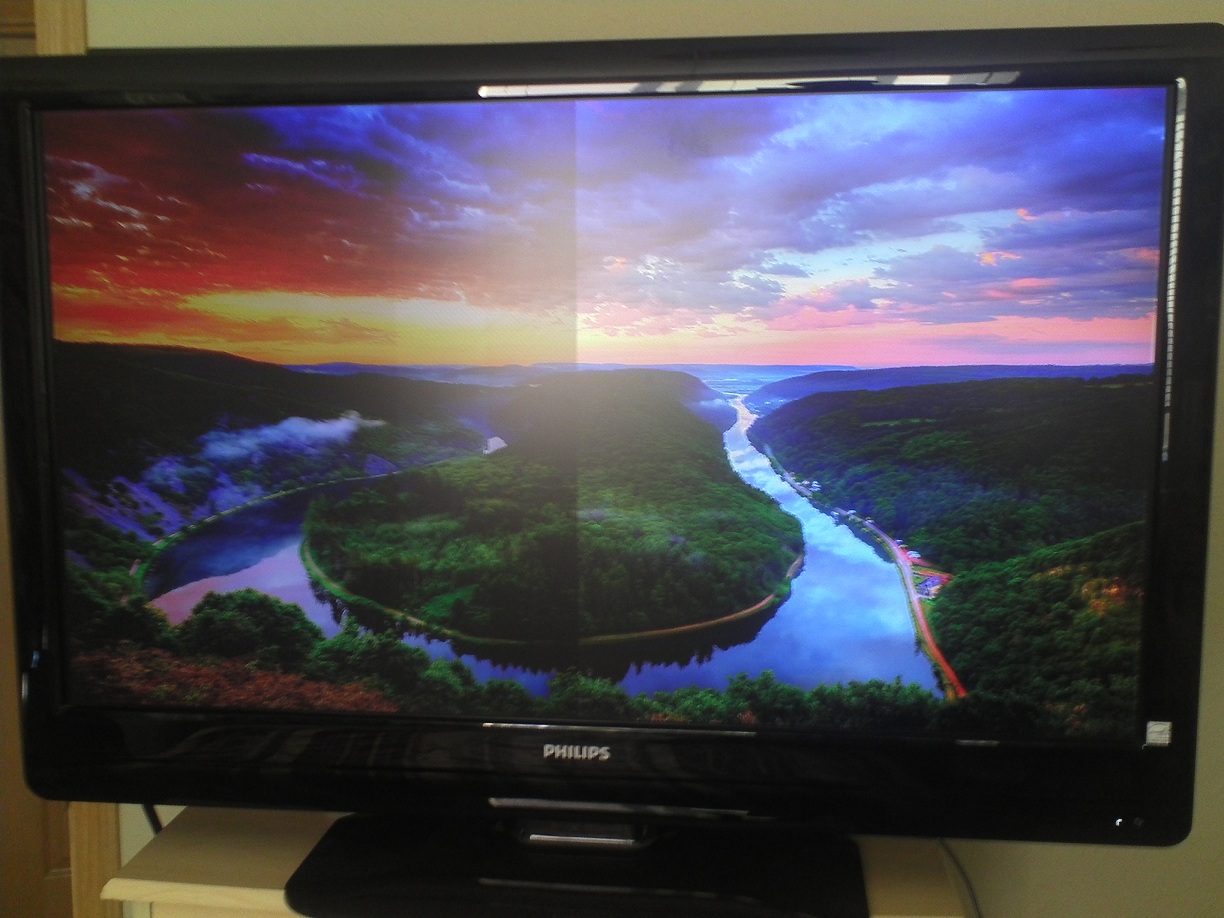

        Finally have picture. Now i need to figure out what is causing the vertical line down the middle...
          Re: 42PFL3704D/F7 No picture
          That looks like you got a dud T-con.

                    Swapped TCon with replacement and i get the same issue. This thing is a PITA. I'm about ready to throw it in the dumpster.

                        Put it on craigslist for best offer and see what you get for it. Its got to be a bad panel now but you dont have to list it that way on craigslist.

                          I didn't notice that there was also a different brightness bar in the darker area.
                          Although the panel could be bad, some T-cons and main boards can be calibrated to deal with different levels. Try entering the service mode.
                          Some people will buy a TV even with that problem as it's fine for gaming/OTA TV, just doesn't look as good but I once lived with a CRT which had a large horizontal grey bar appear on the screen next to anything bright (probably a bad HV supply), didn't matter that much.

                            I agree. It would be a waste to throw it in the trash. Me personally, I'd get more money by selling the Tconn board, inverter board, and power supply on ebay since I know these work. I wonder if it does this under different inputs or different resolutions on a computer?

                                How would i go about entering service mode?
                                It does this on all inputs and resolutions when connected via HDMI to computer.
