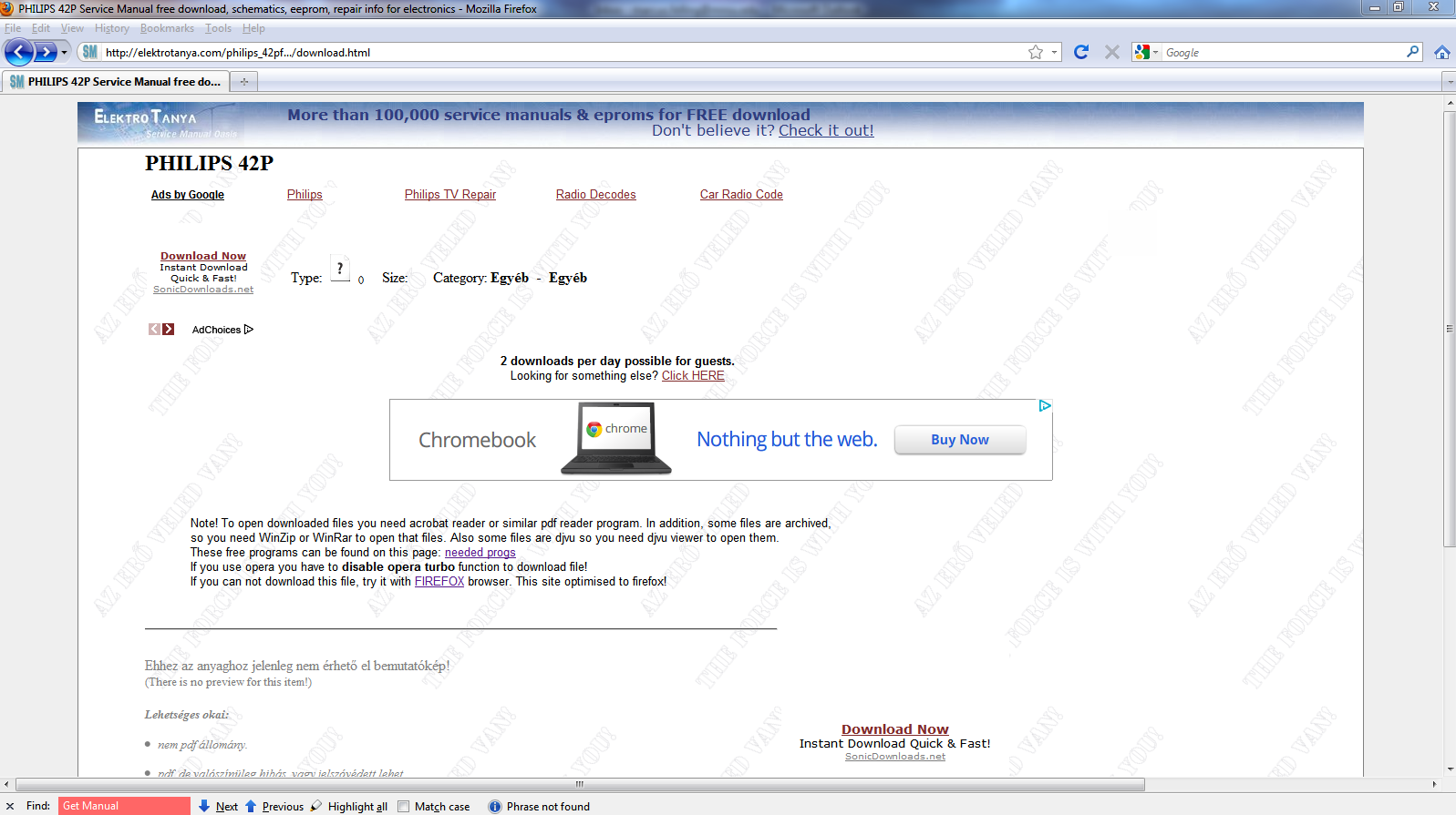

    I've never had a problem with Firefox 3.6.13 on Ubuntu with Elektrotanya. With Adblock Plus, but disabled on Elektrotanya website.
    And I'm running Firefox 7.0.1 with Adblock Plus on Windows 7 and don't have any problems. The location of the 'Get manual' button varies depending if you are logged in or not.
    Your results may vary.
    PlainBill
      #42
      Re: 42PFL3704D/F7 No picture
      Tried FF 3.6 and 7, Chrome 11, Opera, and IE 11 (unable to install earlier version). Used find function with no luck. Can somebody send me this PDF?

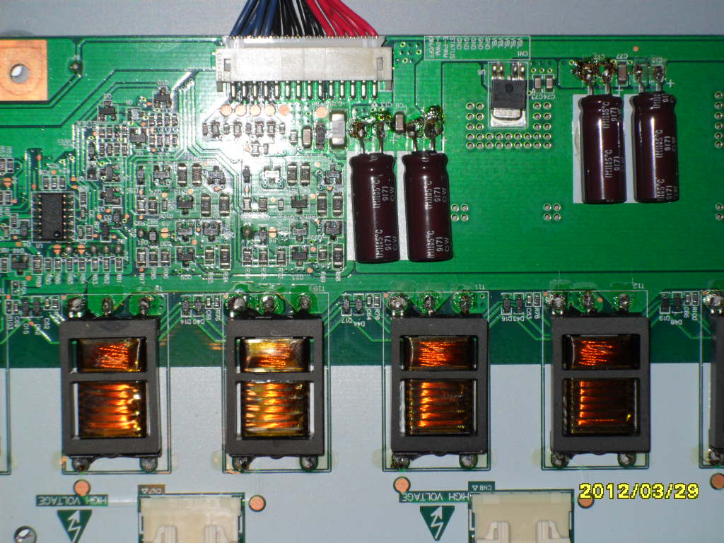

            I have a philips 42pfl3704d/a7 with no picture, Iknow it has something to do with the inverters. I have checked the voltage at the cn1804 and cn1803 connector and got 50v, isn't that to high(should be +24v )? the screen flashes when you turn on the tv everything else seems to work sound, channel changer and you can see the pic. with a flashlight.

                  Ok now I got 24v was using ac instead of dc setting, I was using the hot ground of the tv, now I suspect the invertor board to be the problem, tried resoldering all the connections on the board no help.
                    #49

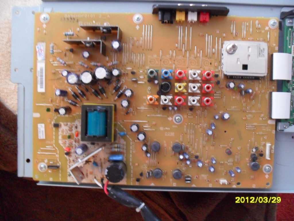

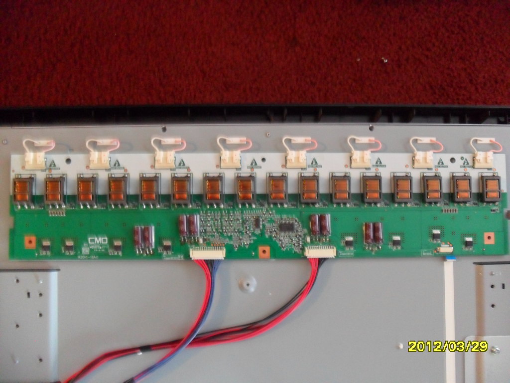

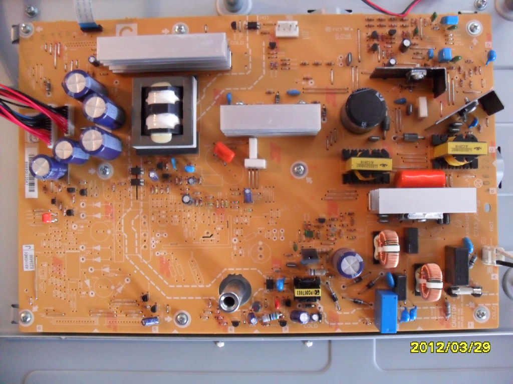

                    The standard procedure here is to provide clear focused top down view pictures of all your boards following the instructions in my sig file below exactly.
                    Afterwards, we can suggest other test points.
                    --- begin sig file ---
                    --- end sig file ---

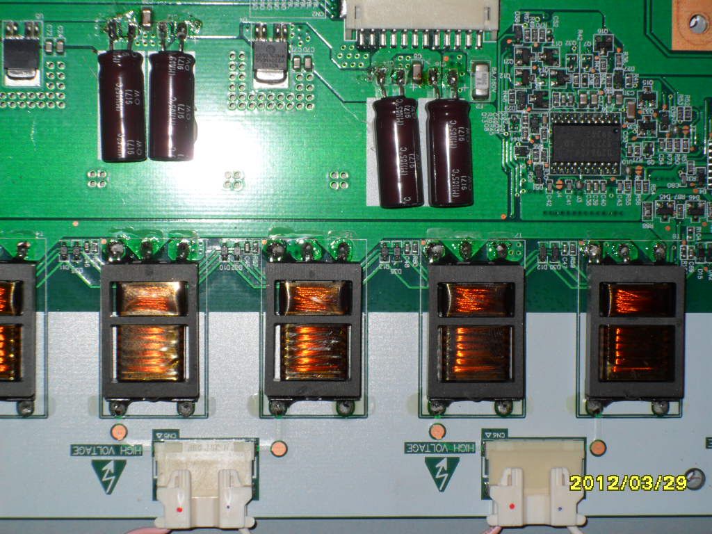

                      #50
                      Here are the pictures of my boards
                        #51

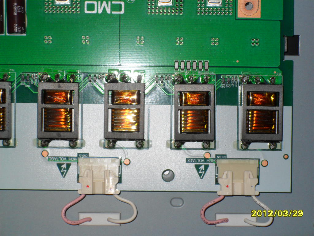

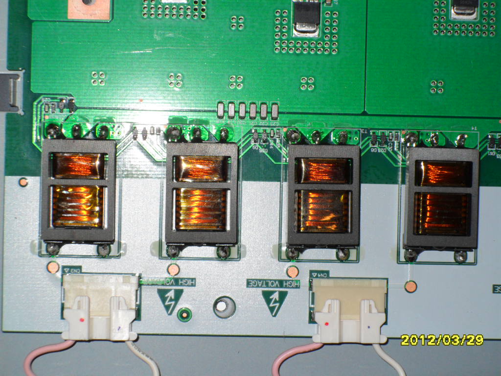

                        Can we get CLEAR closed up pictures of the inverter board where the connectors (white connectors with red/black wires) are?
                          #52
                          hope these are better, I'm not much of a photographer.

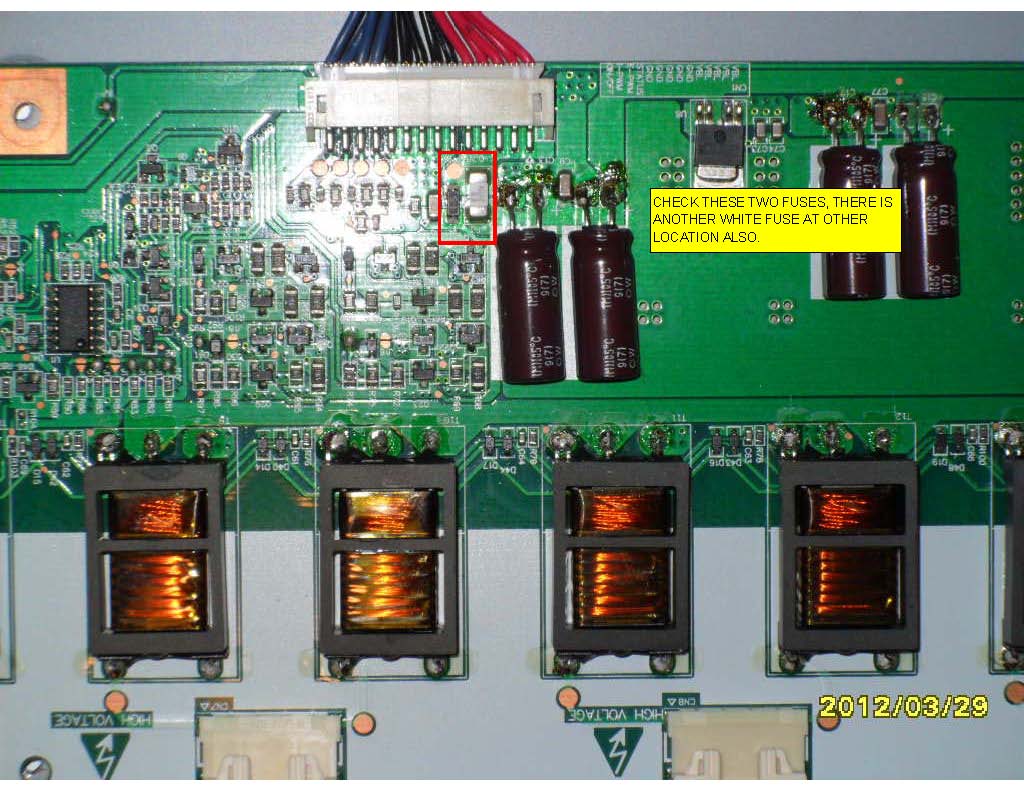

                              Originally posted by dadsfishin View Post
                              just not sure exactly where to test inside the tv.
                              Check to see if the SMD fuse on the inverter board is good. A good fuse should measure less than 1.0 ohms.

                                    #57
                                    @s10outhpaw, check the fuses on the inverter boards, see redlined picture.
