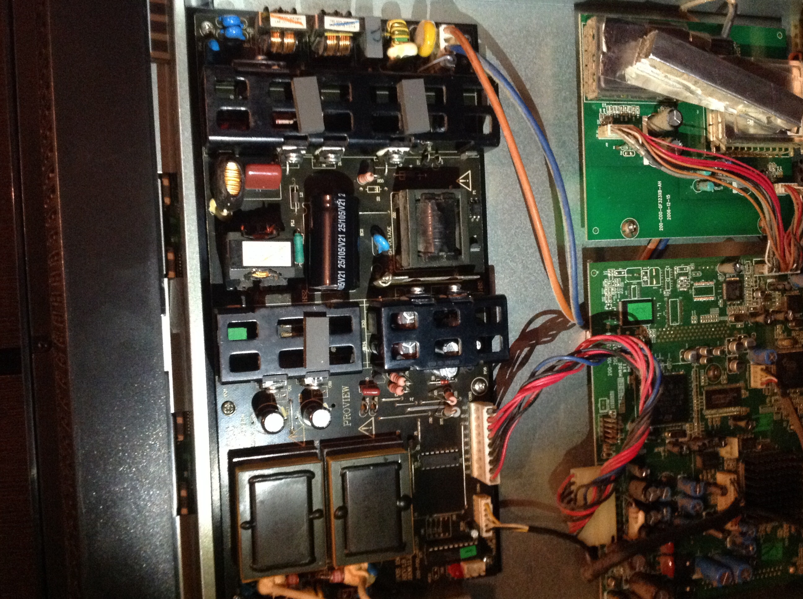

              Re: Polaroid TDA-03211c IPOS150 Power Supply Problem
              Where is the inverter located? Here's the pictures
              http://imgur.com/4L9cMlA
              http://imgur.com/lZRUKcr
                Also whenever I put a flash light against the TV I can see the blue screen, whenever I press the menu button I can see the menu pop up.. I tried to play a music cd in the dvd player and the sound works.
                  You have power supply/inverter board combo.
                  The two lytics caps just above 'PROVIEW' are the commonly fail caps for the inverter circuits, the two transformers to the left of the caps are high voltage inverter transformer.
                  You have make sure first that the PFC Voltage booster cicuit is working by checking the DCV right at the two legs of the cap, when TV is switched on, the DCV should be >360VDC, the inverter circuit needs that to operate + other command signals.
                  Bad cap can look normal.
                          The red stuff is the adhesive used for keeping the part in place during the soldering phase.
                              OK, I replaced the 2 22uf 450v that you guys mention, and now the tv is working,.. I guess you were right about bad caps looking normal..
