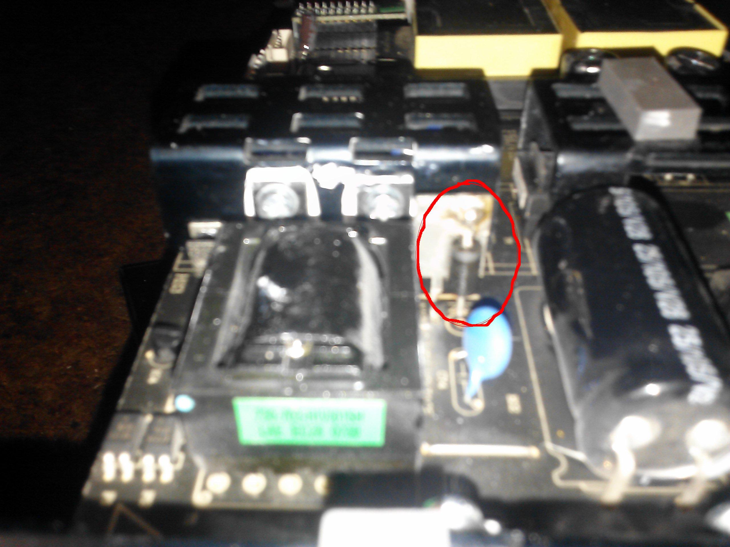

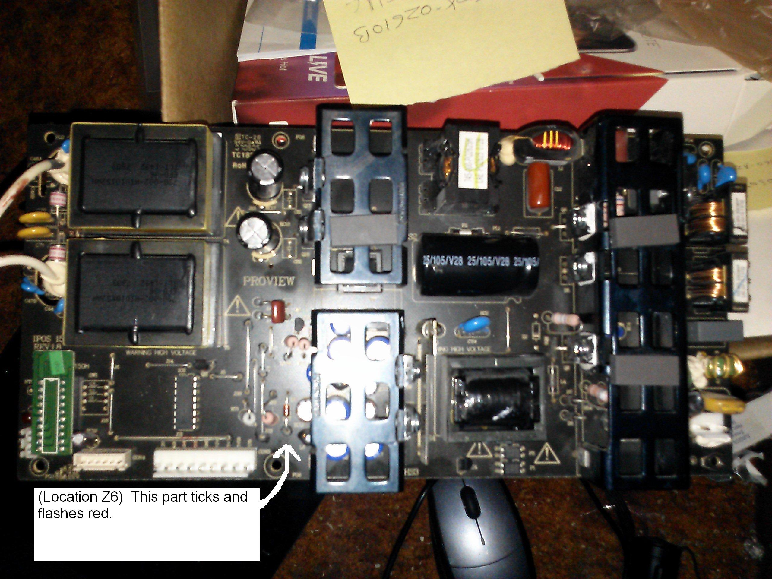

            Can u identify the part I said was flashing? I have no clue what it is but I might be able to get a part number off it. It looks glass with a rusty color. Tracing backwards from 5vsb to the part that flickers, to capacitors, to diode.

              That looks like some type of zenor diode. I've never seen them flash before. That's a new one to me.
              I'm not sure what the voltage was off of the heatsink of the diode but I know one is there. I think it might have been about 24VDC.

                Re: Polaroid TDA-03211c IPOS150 Power Supply Problem
                It is a zener diode. I guess it doesn't flash, more like a tiny spark inside
                I'm pretty sure your right about 24vdc from diode, I think I saw that somewhere else
                I'll check back in a few days when I have a chance to test more.
                Thanks for the help and quik response so far.
                  If it is flashing, the zener is shorted out, and you are seeing the silicon glow red hot, screaming for mercy .
                  I suggest you try to figure out what circuit it is on. More than likely, it's some kind of protection for a voltage rail, so you can find a zener with a similar voltage rating (plus a few volts) as the rail it is on.
                      ZD6 is a Zener 6.2V Zener diode, it is connected across the 5BSV output and Ground (Anode to Ground, Cathode to 5VSB pin) to clamp it down incase the 5V goes higher than 6.2V.
                      And Yes, you should have 24VDC on the heat sink of D10, Cathode is pointed up.
                        D10 diode tested 18.5-22v. It seemed to spike at the same time the zener diode sparked. I get .185v at the 5vsb con
                        I went ahead and ordered the whole cage for $40 but I really want to learn about these tv's and fix this board.
                        I figure I'll replace d10 diode, caps under heatsink, and zener diode but I'm conserned about the voltage going into d10 diode
                        On the bottom of the board there is a tiny part between 2 capacitor leads. (This cap is under heat sink) should I test this and how? If u need a pic I'll get one.
                          It sounds like you 5V is higher than 6.2V Zener diode is try to clamp down, it is shorted out.
                              Can you remove that Zener from the board and use OHM mode (if the diode is shorted out, it will not be reading like diode any more, more likely to be really low Ohm in both directions).
                                Zener diode is bad 0.0 ohms (0.0v in diode test mode)
