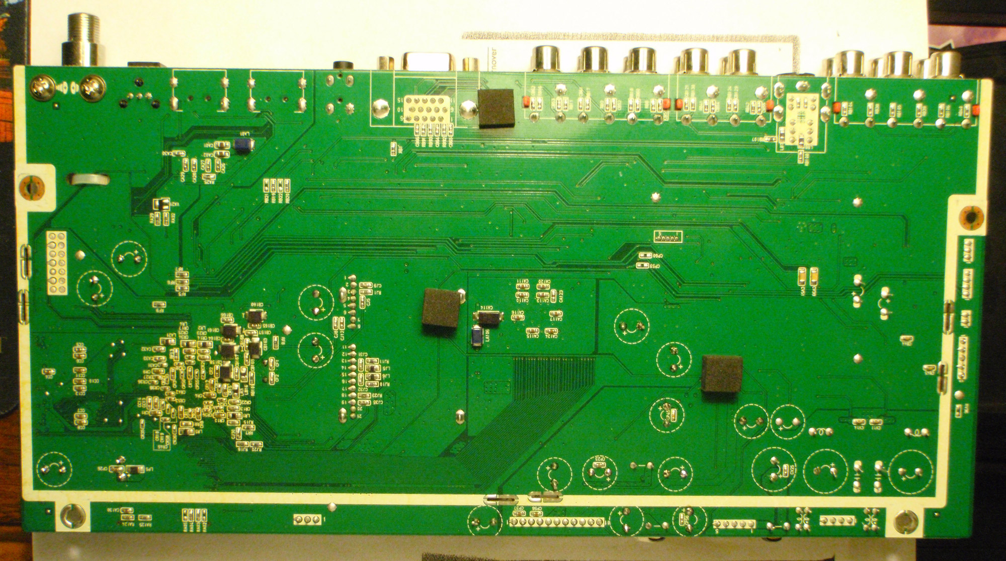

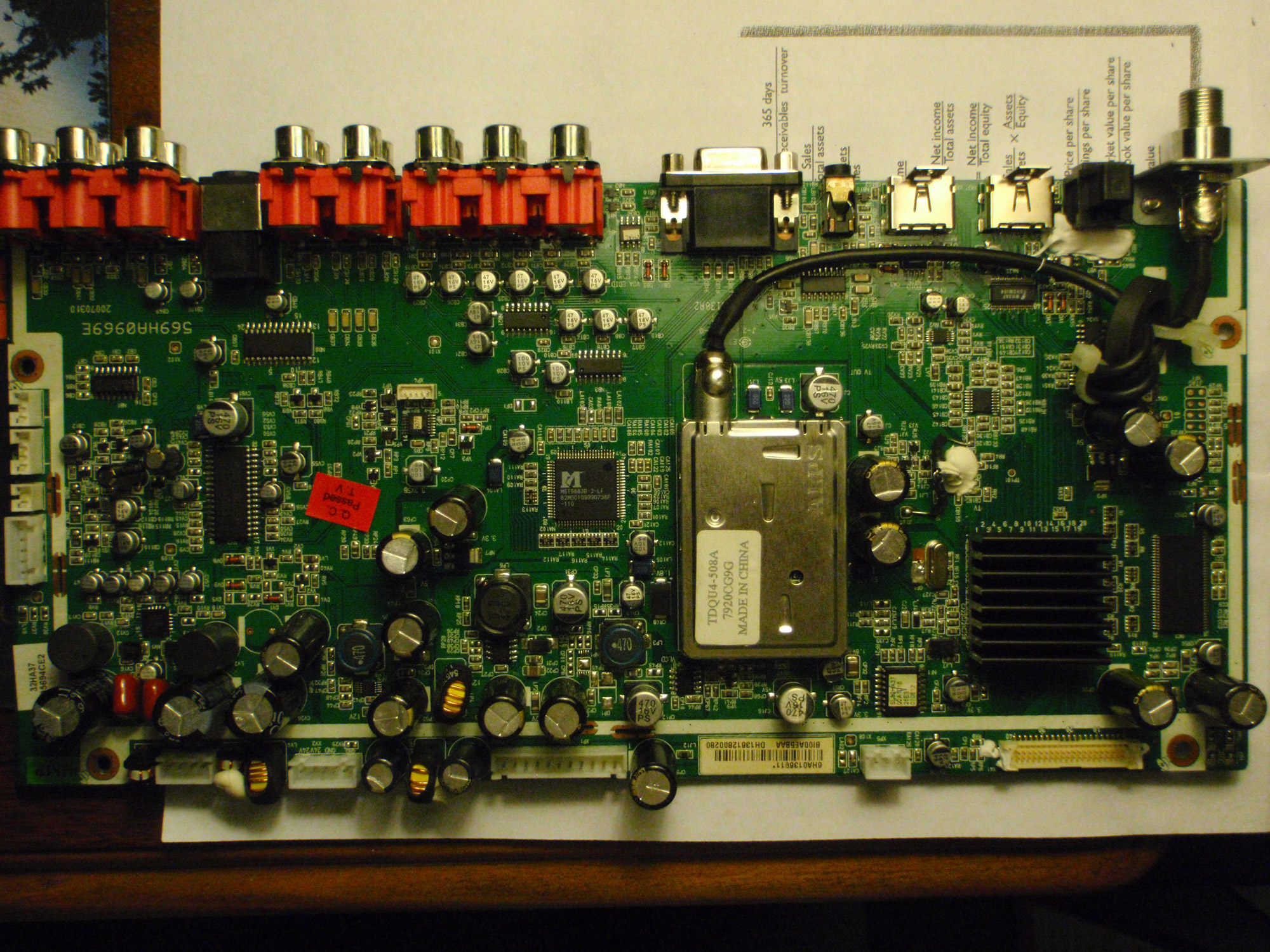

    Hey guys, everything is working great on the Insignia NS-LCD32 except for the tuner.
    Could you give some direction on how to troubleshoot the tuner portion of the main board? I posted some ~2000 pixel images of the top and bottom of the main board.
    The tv says it's scanning for channels, but it doesn't pick up any ATSC or digital channels. I have measured the voltages going to the board and they are all correct and stable. I also measured the voltage at LP11 which is located between CP63 and CP43 - it was a constant 5V. Thank you!

    Re: Guidance troubleshooting tuner
    Check continuity from the antenna jack to the board inside the tuner box.
    Also are you connecting to an OTA antenna or what?
      Also make certain you are scanning for the correct type of signal. I had one where the owner had selected 'Cable', but was connected to an antenna.
        Thanks guys. I borrowed another antenna to try and it worked fine! Go figure!
        Plainbill - Haha I have done that accidentally, but luckily I realized it right away.
