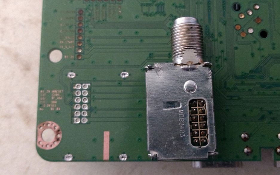

    I can hear Fred Sanford now...."YOU BIG DUMMY".....I pulled the "F" connector out of the tuner by accident. The tuner number is BN40-00248B. Low and behold I had a scrap board with tuner number BN40-00248A. Although the tuner is different (according to Encompass.com) it's footprint on the board is exactly the same as the 248B so I decided to de-solder the tuner off the scrap board to see what I was getting in to.
    As you can see in the picture the terminals and solder pads are super small. No matter what I tried I could not get either the terminals or support tabs to de-solder from the board using a soldering iron, de-soldering pump or braid. The only way I was able to get the tuner off the board was to pop it in a toaster oven I use for re-flows, heat it for 10min and it popped right off.
    The Main Boards on the F8500 are scarce as hen's teeth and I don't want to mess it up when swapping the tuner out. Because of that I don't want to bake it in an oven. Are these intended to be removed with hot air? I don't think the tip on my soldering iron is too big for the job. It's about 1.5mm wide and the tip comes to a point. It appears I'm making enough contact for heat transfer to happen but they simply won't desolder.
    Does anyone have any ideas?

    turn up the iron temp. add fresh solder and suck it away .

      Thanks!
