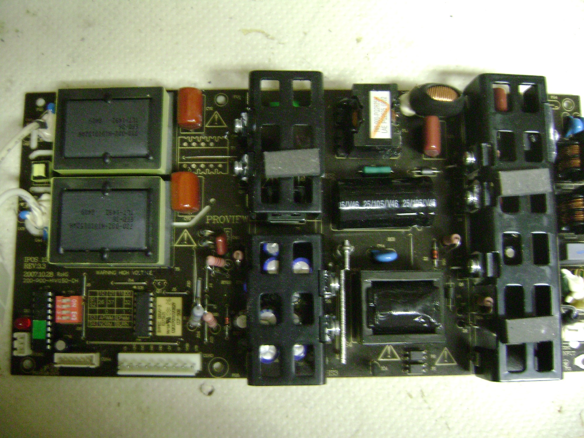

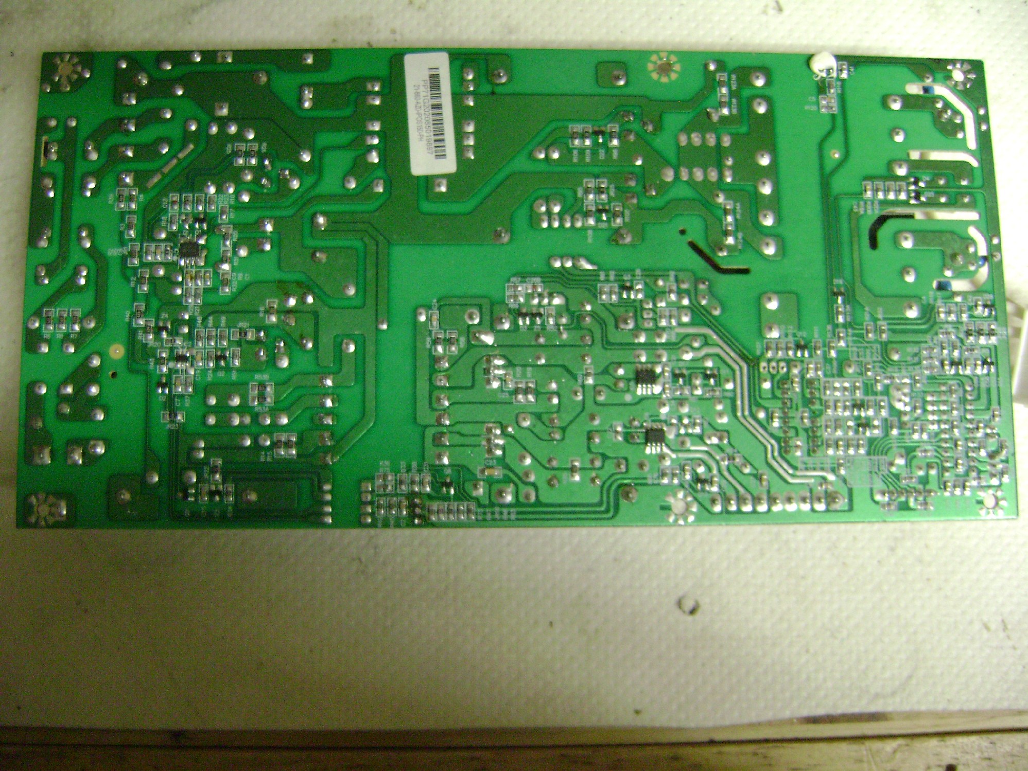

    This one is stumping me for the moment.
    THE PROBLEM - No power at all. No power LED. No visual or audible changes when plugged in or power button pressed. "CON3" shows no output voltages to the digital board. IC8 is
    CHECKED COMPONENTS - Both fuses, all electrolytics (under HS3 - heatsink 3) were checked and confirmed. MOSFET's all checked good.
    CHANGED COMPONENTS - IC4 (KA431AZBU Shunt Regulator), IC8 (PWM chip), IC1 (on back)
    If you notice Q1 wasnt on the board, it will be shortly. I just removed it for the moment. It is a 2n4403. It checks ok as well.
    I have no documentation on this power supply. I find lots of people fix these on ebay. This board is listed on there either as IPOS 150 or 120. This one is the IPOS 150 Rev.3.3. (200-P00-HIVI150-CH).

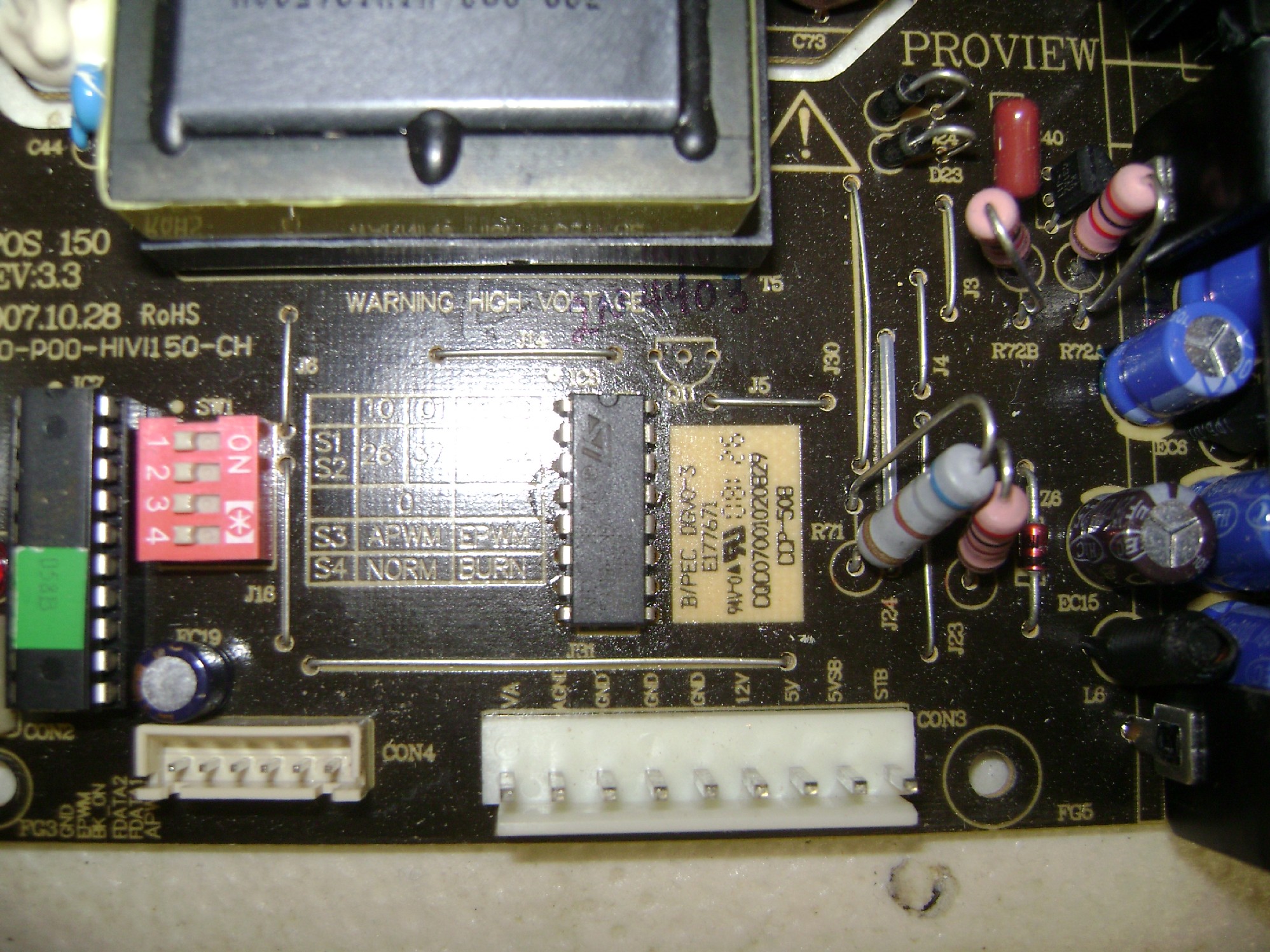

    Do you see 5V standby voltage on CON3?

      Re: Memorex MLT3221 - No Power
      Nope, no 5 volts there.
        That's a problem. The pin labeled "5vsb" should always have 5v present on it.
        Seeing that there are HEC caps used on this power supply, it's very possible that the PSU start-up capacitor has dried. I see 2 small capacitors under the primary heatsink right behind Q6. One of them (or possibly both) is responsible for starting up the PSU. If they are of a known unreliable brand, change both.
        Before you do that, though, check the voltage across the big primary capacitor (EC2?). There should be around 165v. If present, then change the two caps I mentioned above.

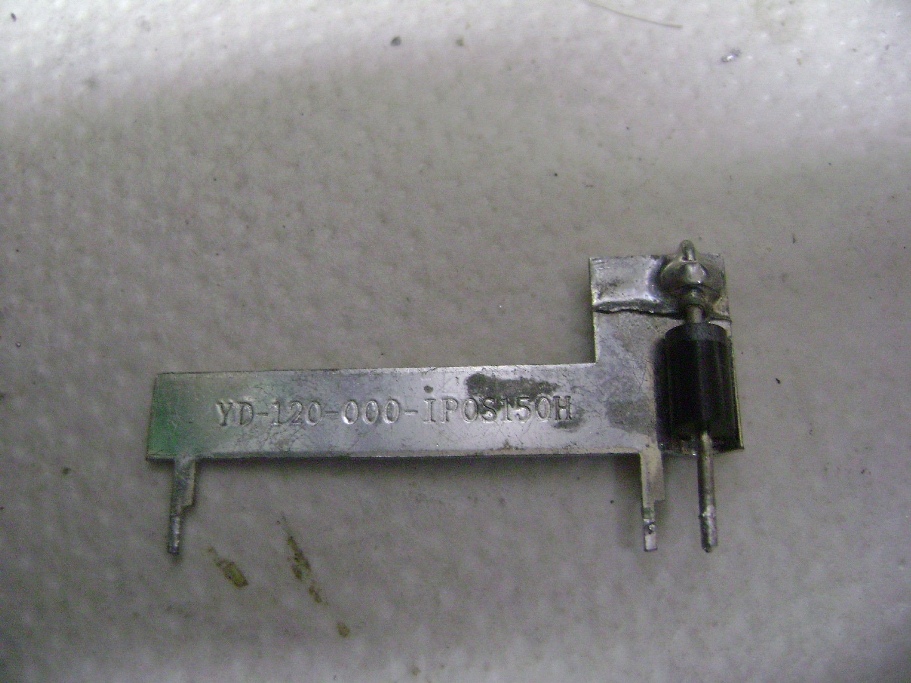

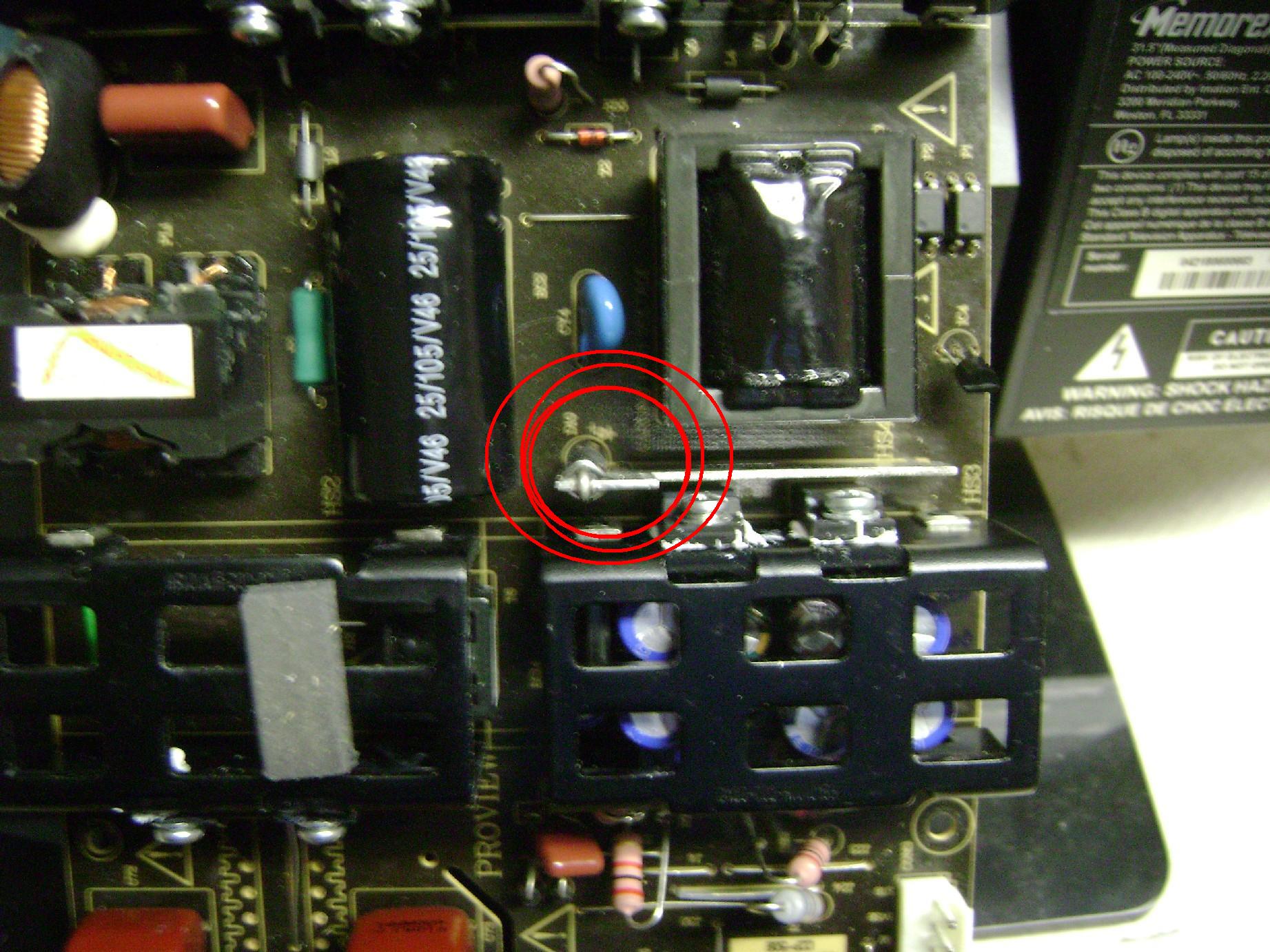

                              It was my mistake, you were right about the part number. I checked out those components and found that they were good. I changed the cap just to be sure - same result.
                              I did find a shorted diode at D10. This diode is marked as HER304. I have circled it on the attatched photo. It is attatched to a heatsink and is standing upright. As also seen in the 2nd photo. This is the classic case of "I thought I checked that before". Taking notes would have made all the difference.
                              Now I have to find a solution for a match if I cant find the exact component.
                                Is this out of circuit or in-circuit measurement? If in-circuit, measure it again out of circuit just to make sure.
                                Looking at the HER304 datasheet, just about any fast-recovery diode capable of 3A @ 50C should work.
                                Basically just match the Forward Current (Amp) rating and the Maximum Reverse Recovery Time rating. HER304 has 50 ns (nanoseconds) recovery time. As for the voltage rating - I doubt this PSU has any voltage on the secondary side above 30v, so even a 100v diode would likely work fine.
                                *EDIT*
                                Looking at second photo above, the solder joint between the heatsink and the diode seems cracked. Perhaps this is what caused the diode to short?

                                  I apreaciate the help momaka. Yes, the readings were out of circuit. After checking Digikey and Fairchild, I finally found it at Allied. I will post the result once I get the part. Thanks again.
                                  • Dgtech
                                    E. Technician
                                    • Apr 2009
                                    • 1462
                                    • Steeler
                                    Everything works well after replacing that diode. All powered up and scanning for digital channels now. Thanks again momaka. I apreciated your help and guidance.
