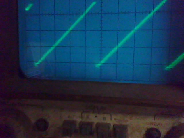

        With my TV running normally, I took a photo on my scope of the output pulses on IC8. The upper waveform is output A (pin 11) and the lower waveform is output B (pin 14).
        The scope is set up on 5 microseconds/division and the verticals are set up for 5v/division each.
        As you can see, both A and B are about 12v DC (above COLD ground).
        They are also 180 degrees out of phase with each other and each has about a 50% duty cycle.
        Because one full cycle of A takes 15 microseconds, I calculate that these pulses have a frequency of 66.6kHz

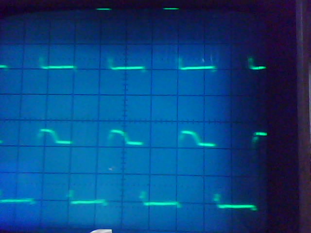

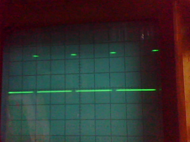

            dear graywebdesign hi

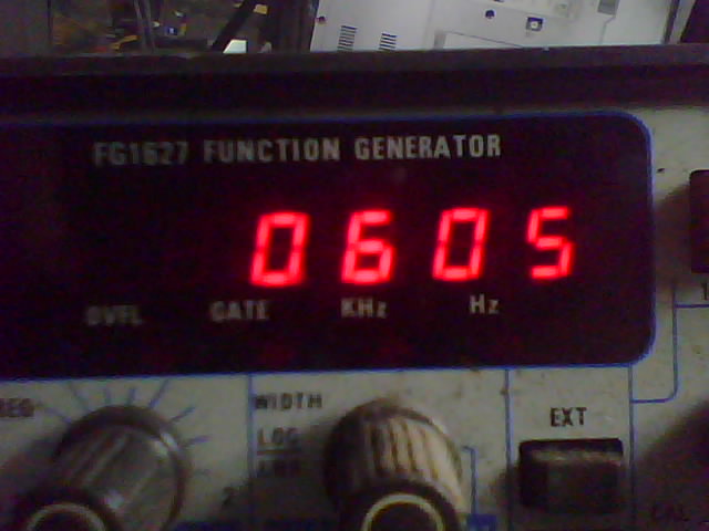

            yes it is the seem at my HP scop as you can see at the pic,i hope i am not mistaken on my calculation the volt button is 2v per square and the time 2usec[micro] per square.
            i also checked with frequency counter i get+-60.0khz you can see at the pic
            this 2 measures was test at pin 14 of ic8.do not forgot i have only 1.5sec to make all my test measures,and the frequency is change i also see it at the HP scop.

              Your waveform on IC8 pin 14 looks good to me. Also your frequency of 60kHz looks good.

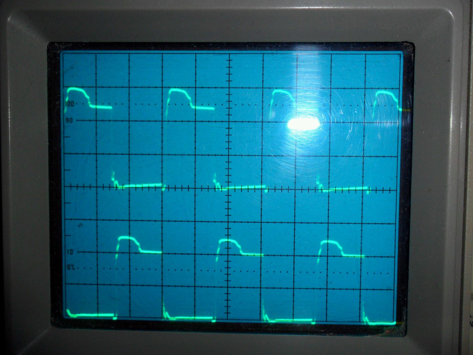

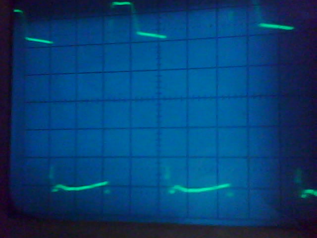

                dear graywebdesign hi,
                this is my measure at ic8:
                pin1 go up to 3.5v then down to 1.5v
                pin2 go up to 3.5v
                pin3 got pules -Img00013 this pules came after CCFL off and it is constant
                pin 4 not used
                pin5-pin16 the seem your measures
                pin 11,14 img11,12,10
                on connector 6 pin 1,4 are the seem

                  Thank you for your explaination of how your HP scope frame is isolated from your probe return connector. I have a TEK scope and have never tried to set up mine the same way.
                  Your waveforms of the pulses on IC8 pin 11 and pin 14 look VERY GOOD ! They actually look identical to mine while my set is running normally.

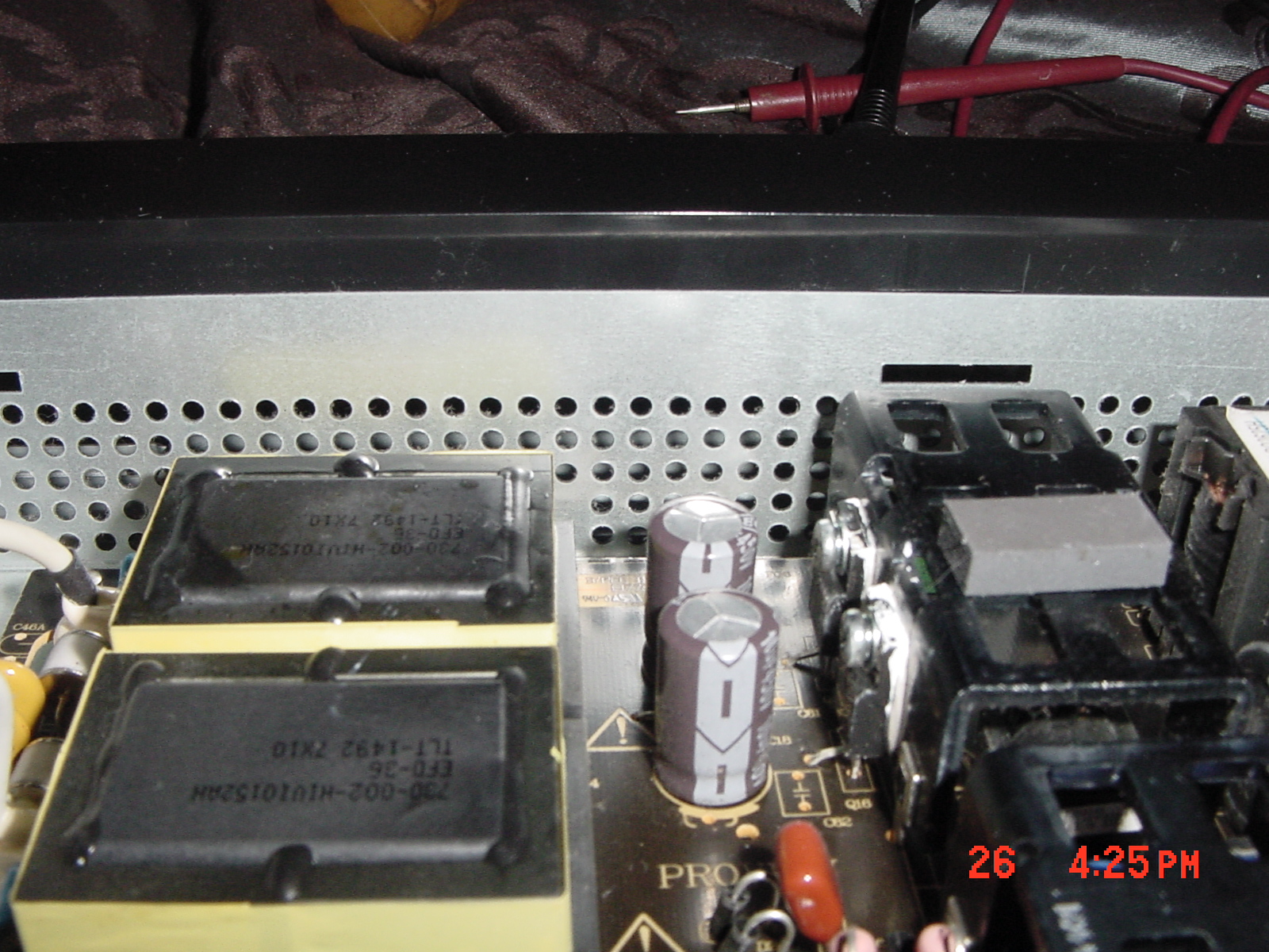

                                          Those two brown caps above the word Proview look bloated to me.
