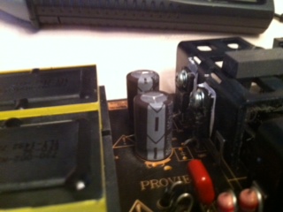

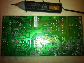

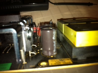

        I was able to remove the power supply board and can see that one of the caps is buldging on top.
        I will get some photos and post them
        • sguthrie@cisaz.com
          • Jun 2011
          • 8
          #44
          Re: Memorex MLT3221 - No Power

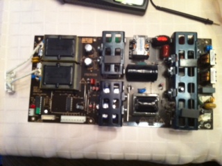

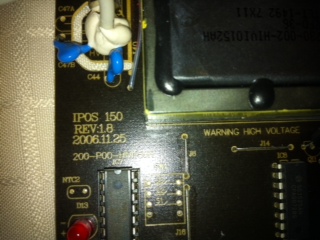

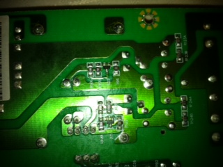

          Ok so here goes with the photos........
          1) MLT3221 PSU Front view (MLTPSUFront.JPG)
          2) MLT3221 PSU Back view (MLTPSUBack.JPG)
          3) Capacitors with bad one at back (MLTCapsBadAtBack.JPG)
          4) Bad Capacitor showing bulge on top (MLTBadCap.JPG)
          5) Board Rev Data (MLTPSURev.JPG)
          Looks like I need to replace that Bad EC17.

            #45
            A little more information
            The Rev info is
            IPOS 150
            REV: 1.8
            2006.11.25
            200-P00-HM150H

              #46
              Change both of these caps out - side by side. You'll have to verify the cap values but I think these were 10uF 350V or something like that. You might be good after this replacement, however, I have one in my shop now that, for some reason, does not work right even after the cap replacement. Start with that and most likely that will fix it.

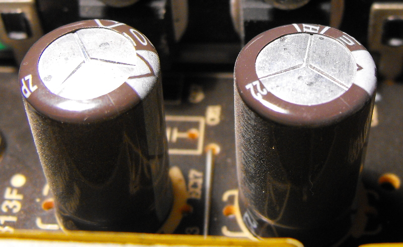

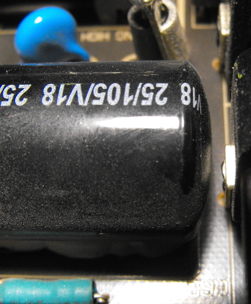

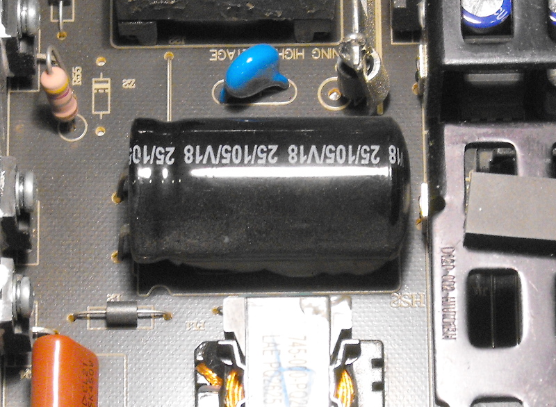

                                I'm working on this same TV. The red LED on the power supply board blinks about once a second when the set is on. It has sound, but the backlight does not appear to come on. The large EC2 cap has a dome on top, which I normally associate with a bad cap, but it passes doing the "reverse-the-DVM-leads-and-see-if-it-charges" test. There is no burnt odor to indicate anything really bad happened. I checked all the diodes on the front side of the board, and the zener, and they seem OK. EC17 has an ever-so-slight appearance that it may have domed. EC7 and EC8 to the right of L6 look OK and pass the DVM charge test. Any thoughts of what to check next? This is the same revision board as shown earlier in the thread- dated 2006.11.25. Any assistance would be appreciated. It belongs to an elderly lady who is bedridden, and I'm trying to "save" it for her.
                                -Web in Myrtle Beach, SC
                                • retiredcaps
                                  • Apr 2010
                                  • 9271
                                  #56

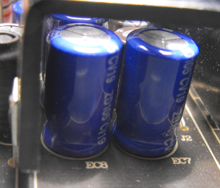

                                  Post pictures following the guidelines in my sig file below for a 2nd opinion on whether your caps are bad or not. The test you are doing doesn't accurately measure uF and ESR.

                                    Here are two photos of the capacitor that I suspect may be bad. I think doming is obvious, but is it possible that it was manufactured like this?
                                    I checked the voltage at this cap- 165V spot-on with the set on, and on the 5VSB test point, definitely 5.110 volts is present. When the set is turned on, definitely 5.110 volts on the 5V test point.

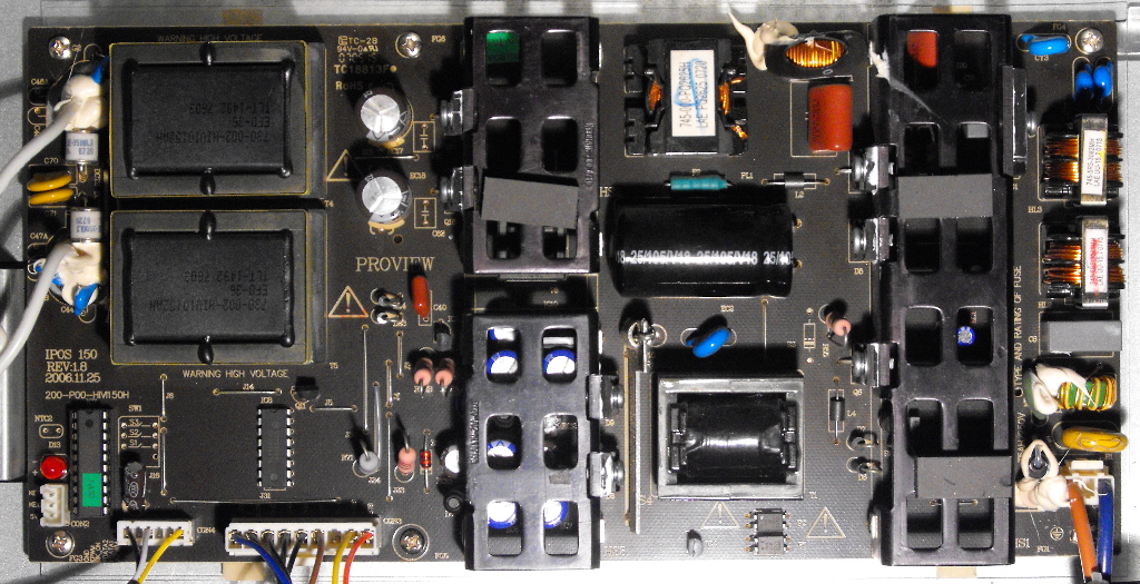

                                      What about EC7, EC8 and EC17 (the ones that I wanted to see) in post #56?
                                      In fact, please post a picture of the entire power board (top down view).

                                        They look unremarkable, really nothing domed-looking about them. Here are those photos. Thanks, -Web

                                          #60
                                          Whole board photo
