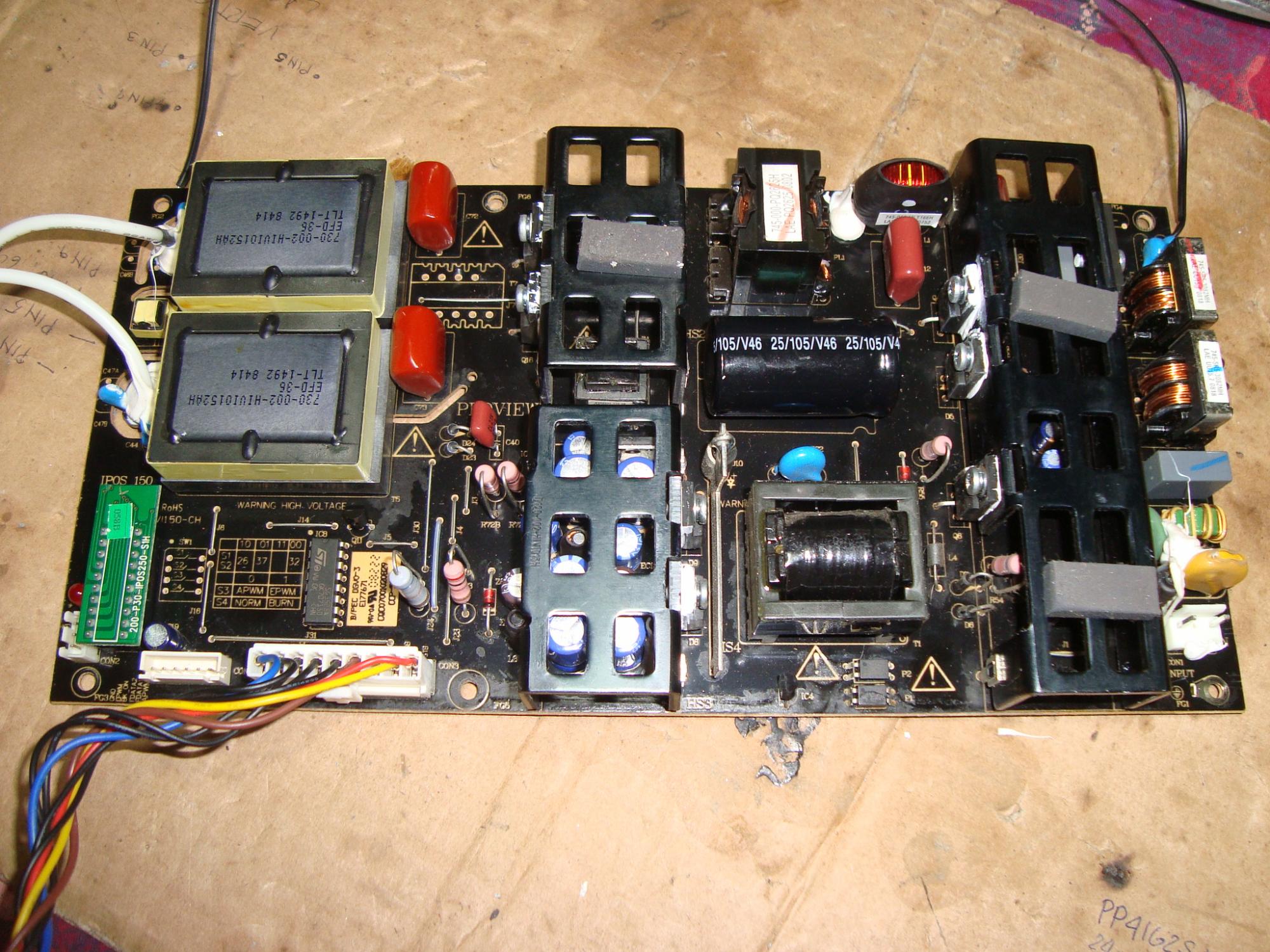

                    need help!!!good day i have mlt3221 when i plug it i see red led light after a second it goes blank....

                      #130
                      Re: Memorex MLT3221 - No Power
                      Did you check the things that were mentioned in the first few pages of this thread? If you've done this already and you still need more advice, post pictures of your power board and we'll go from there.

                        #131
                        i already cheack 5volts,12 volts ok....
                        • mattmarkgo
                          • Nov 2011
                          • 15
                          #132
                          thanks in advance.....
                          • mattmarkgo
                            • Nov 2011
                            • 15
                            #133
                            24 volts ok,when i plug i see a red light i a seconds black screen......
                            • mattmarkgo
                              • Nov 2011
                              • 15
                              #134
                              any suggestions please!!!!!!!

                                #135
                                what are the voltages that you see all the way across the output connector - in order?
                                • mattmarkgo
                                  • Nov 2011
                                  • 15
                                  #136
                                  they have pin1-3v, pin2-5v, pin3-5v, pin4-11.5, pin5-o, pin6-0,pin7-0v,pin8-0v, pin9-23volts in con3,
                                  connector4
                                  pin1 - 3volts
                                  pin2 - 0 volts
                                  pin3 - 0volt
                                  pin4 - 0volt
                                  pin5 - 5volts
                                  pin6 - gnd...
                                  • mattmarkgo
                                    • Nov 2011
                                    • 15
                                    #137
                                    result of ic2#52722
                                    pin1- 0V
                                    pin2- 7V
                                    pin3- 9V
                                    pin4- 0V
                                    pin5- 14V
                                    pin6- 4V
                                    • mattmarkgo
                                      • Nov 2011
                                      • 15
                                      #138
                                      resistance to hot ground to pin 1 of IC2 is shorted....need help.......please!!!!!
                                      • Dgtech
                                        E. Technician
                                        • Apr 2009
                                        • 1462
                                        • Steeler
                                        #139
                                        I'm looking around for IC2 but I cannot find it on your picture. Please specify. Also, I recently got a similar set working after I found the transformer above the main cap to be bad. It was arching intermittently. Whenever the set would fail, the LED on the bottom left hand side would come on. I had to replace the whole board cause there were no replacement transformers to be found for this board. Good luck.
