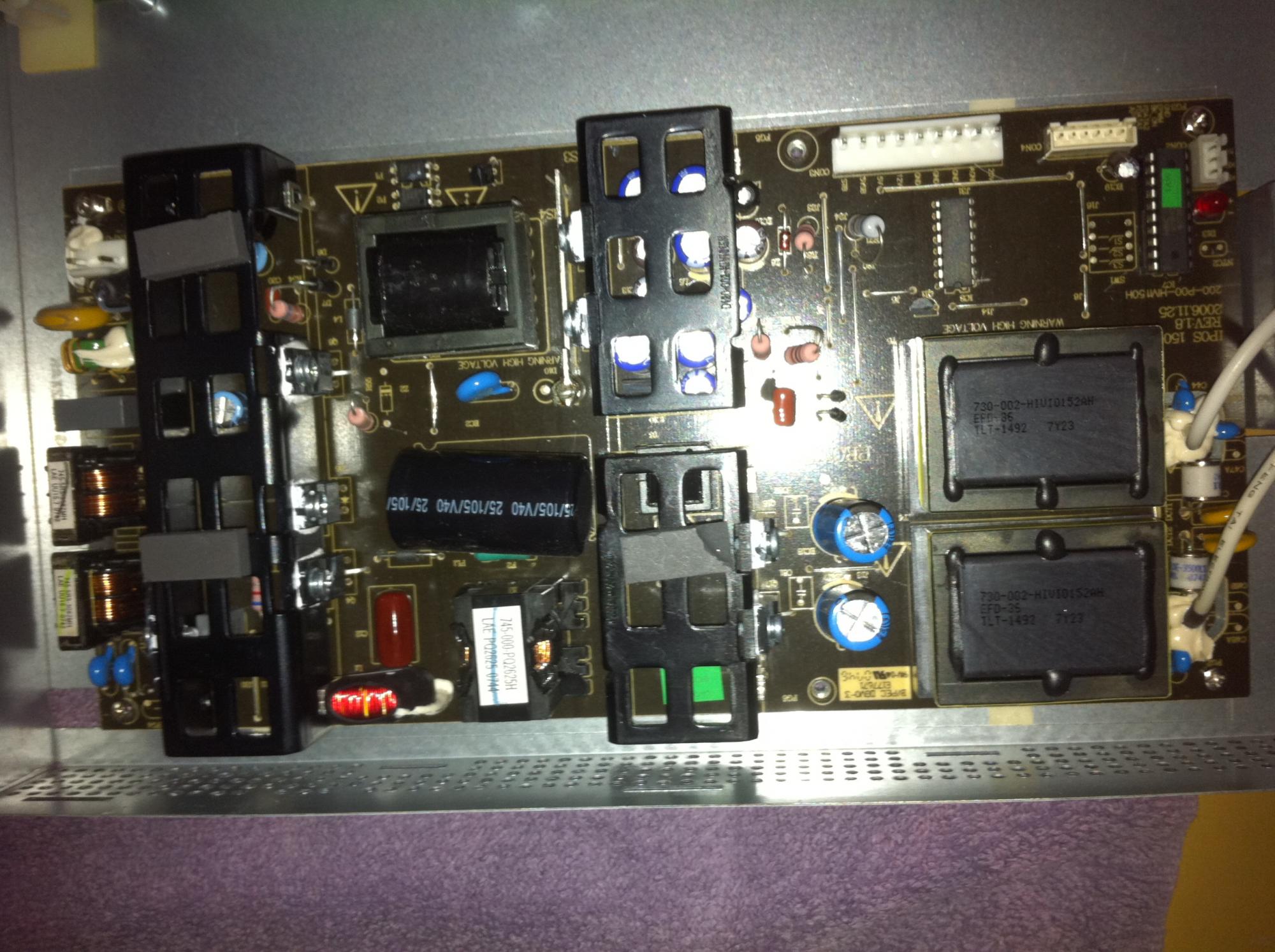

              Re: Memorex MLT3221 - No Power
              This power supply board has different revisions to it. Please post a picture of your board with the model number and rev number.
                IPOS 150
                REV:1.8
                2006.11.25
                200-P00-HM150H
                Thse are the specs on the supply board. The Rev number is there... not sure which is the model number. Also i should mention that i could only find one fuse on this Tv.

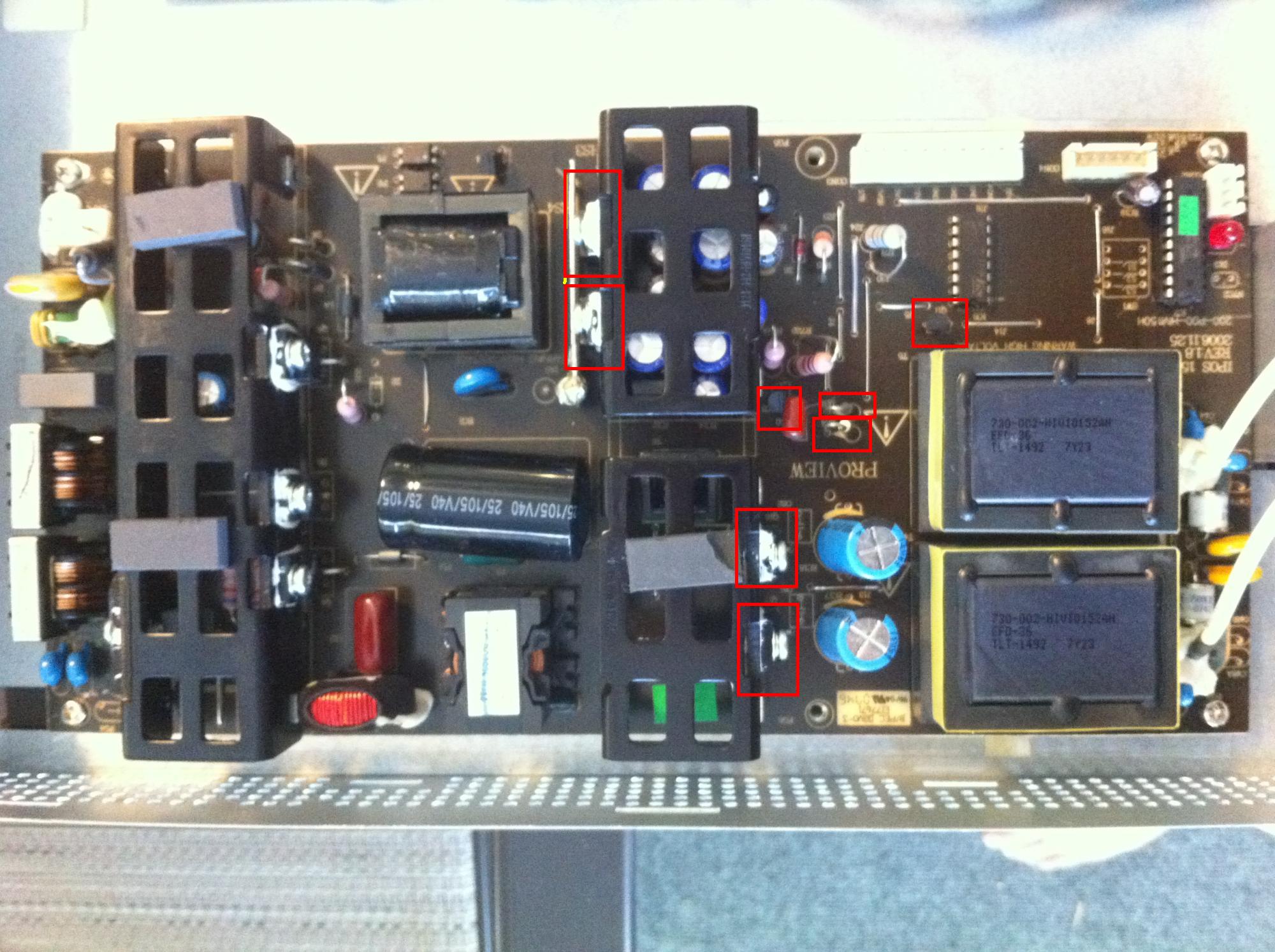

                                I'm going to give you a list of components to check. First, though, I want to make sure the main fuse did not blow.
                                Check the voltage across the main cap (largest).
                                If this is ok, (I think about 300 or so) then check:
                                Q4
                                Q6
                                D5
                                D6
                                D7
                                Check all of these for shorts. All should be taken out of circuit to check properly. Diodes are going to show a short in one direction, reverse the leads an it should not show a short.
                                        Here are eight components to check for shorts. I put a red box around them.
