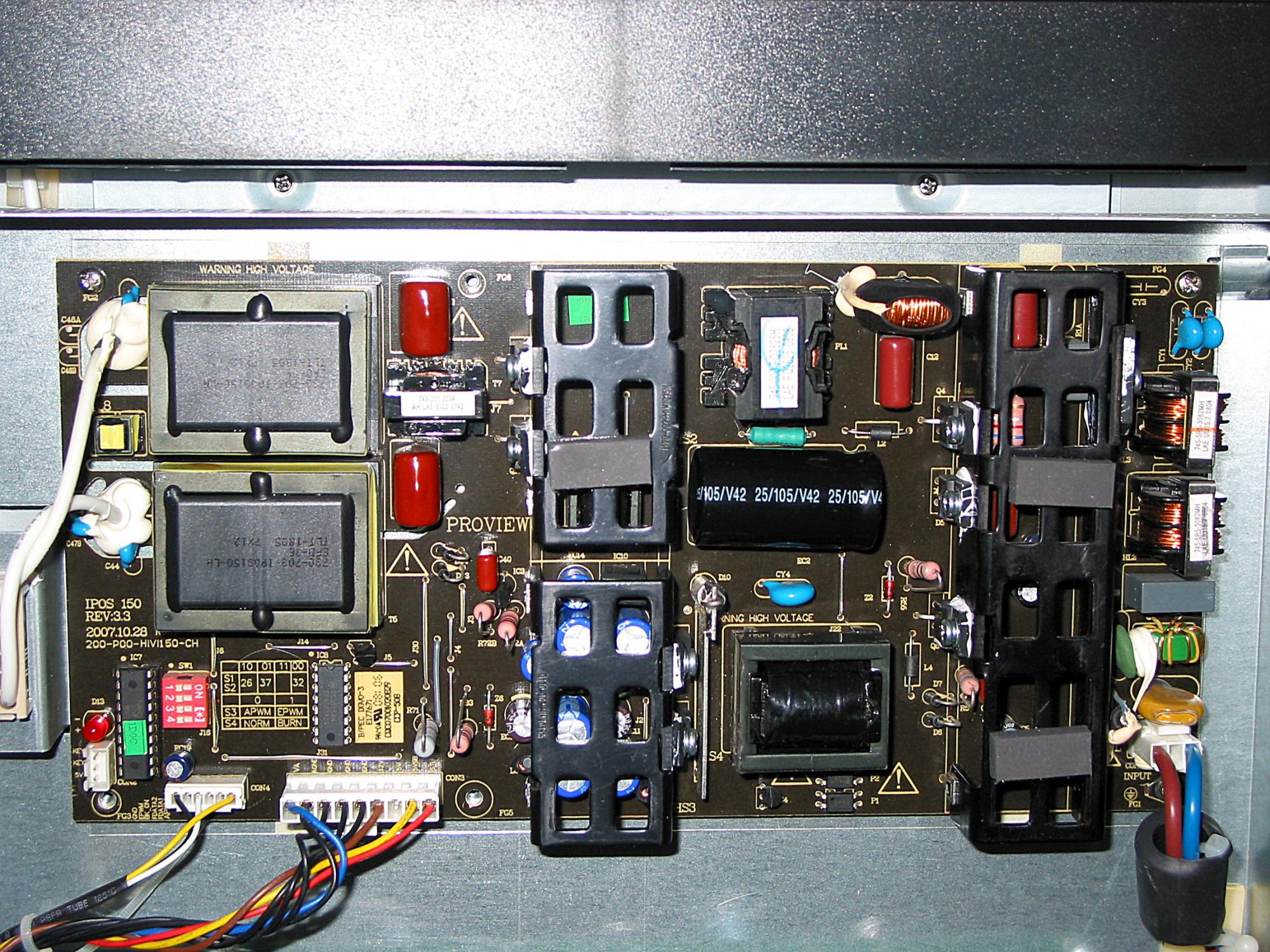

Memorex MLT3221 - No Power

    It looks like the brown colored caps are bloated from the top down view. If you have a multimeter that can measure uF, I would desolder them and measure uF.

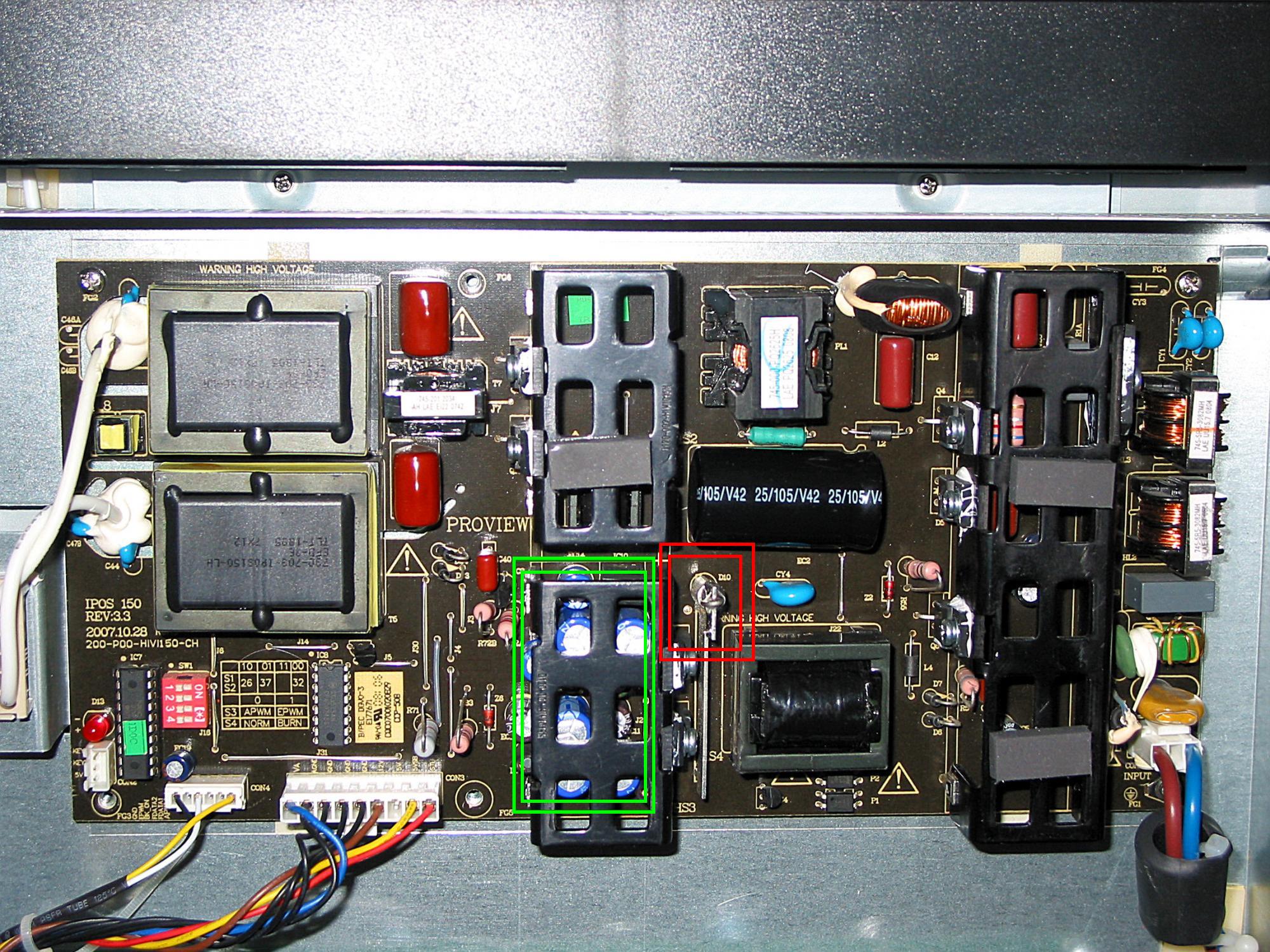

      Hi, I think I need to jump in here. IPOS Rev 3.3 board, as discussed here, on this Polaroid 32" model. Set will do nothing, tried to turn on with push button on side of set since I have no remote. When it's plugged in, the red light in lower right front blinks consistently, that's all. Red light on P/S board is off...don't know where to start, except to say I have checked the most notable caps, diodes and fuses and all seems well. There is no 5v of anykind. I can hear a faint 'tick' coming from the P/S board about the same duration of the front LED blink... Where do I begin?

        Originally posted by johnnieboy2
        Where do I begin?
        Post pictures of your board in the same format and composition as Dgtech in post #1.
        See my sig file above in the previous post for instructions and limitations.

          Re: Memorex MLT3221 - No Power
          What voltage (DC) do you have on the green fuse in the middle of the board?
          If no voltage there, check the voltage (DC) on the main cap?

            Polaroid TDA-03211C...will not turn on, LED on P/S is off, front LED blinks

              The green fuse is between the big cap and the transformer. Check both sides with a voltmeter. DC Voltage

                around 315 volts, pretty steady on the cap to ground and 400vdc across the cap...fluctuates around 312-320 on both sides of the fuse. What's the significance of the blinking red LED on front of the TV, not seen any reference to this indicator.
                You didn't ask, but I'm showing from .6 to 2.0 volts fluctuation on 5v standby.

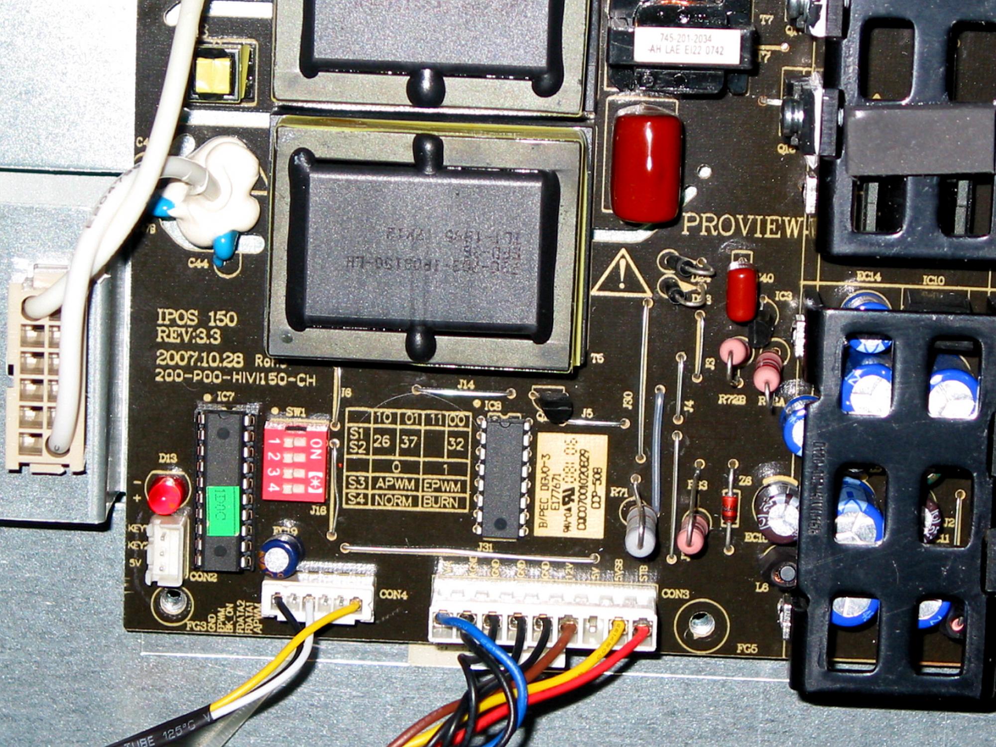

                      With power off, check the resistance of this diode (D10) that I marked in this picture (RED BOX). it is standing up and connected to a heatsink. Check front to back then back to front. You should get low resistance one way and high the other. In my set, this is the one that went bad. It read around 5 ohms both directions.
                      From my research into this set, I found that the diode mentioned above would fail whenever someone would use this TV as a monitor on a computer. Basically a design flaw.

                        Had already checked D10 out of circuit, it's fine.

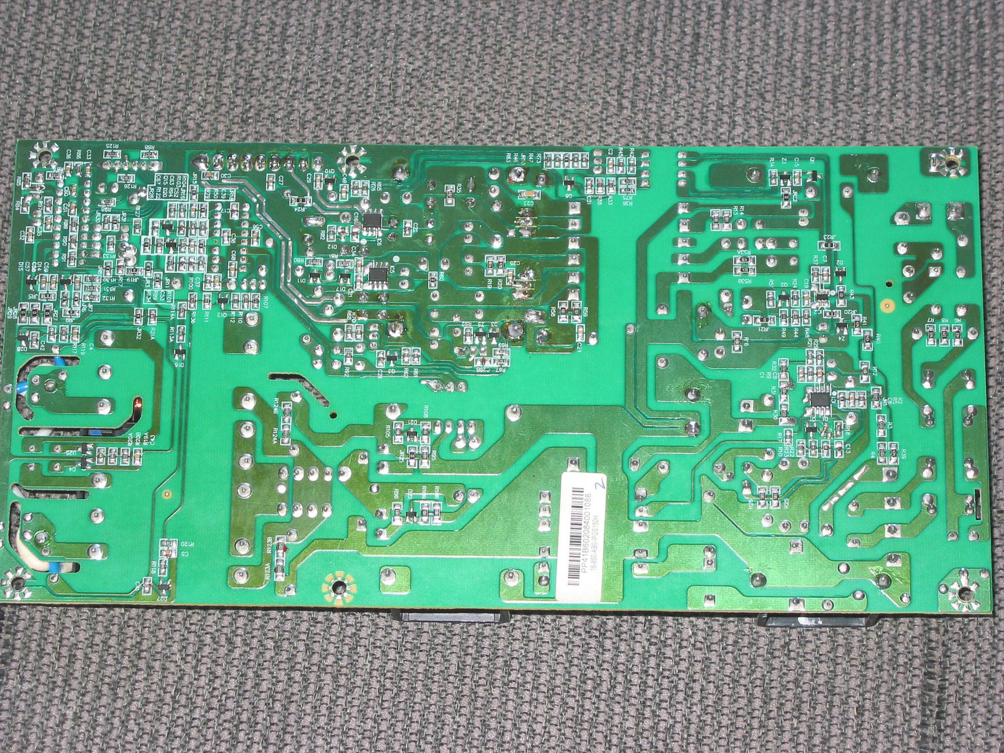

                          Instead of spinning my wheels troubleshooting individual components, I found the whole board available on shopjimmy.com for $70 and a few dollars shipping. It wasn't worth spending any more of my time checking caps in/out of circuit etc. The replacement board fixed it. If anyone wants my old board for parts (burnt traces, etc?) dated 2006, $20 and it's yours. I don't know what component is bad on it, but the largest cap on the board is very domed. On the new board, it's totally flat across the top. I suspect at the very least, that large cap will have to be replaced. -Web in Myrtle Beach
                              That's a great way to go probably if you're certain all your problems rest ONLY with the P/S board. Alas I'm not certain, so $70 might just be the beginning for me...so on with the desoldering
                                Is there a 5v reg on this board? I don't recognize any of the marking on any of the devices as being std for a regulator.
