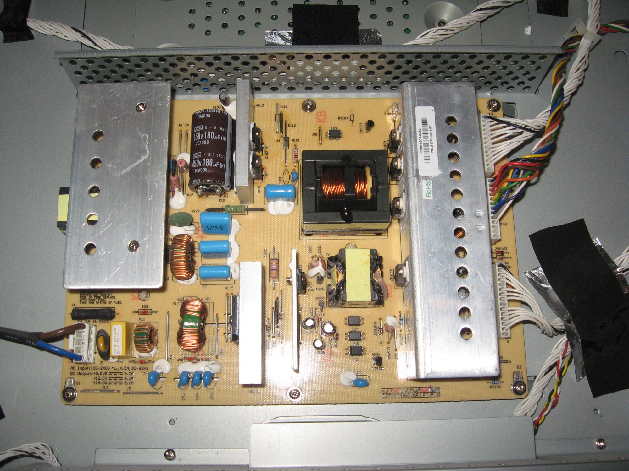

      Post a picture of this set open. In a second picture, one of the power board in question.
      • cadiman
        • Mar 2010
        • 397
        Re: Vizio VX42L HDTV10A not coming out of standby
        This has the heat sinks covering capaciters on the power supply board. I would start with those. I have done a few of these. This is a good beginner board. I have had the same problem with other L/g power supplies with the same issues you are having.
        An esr meter would help, but you will most likely see the capps that are bad on this board.
        • Eureka
          • Nov 2010
          • 7
          Here's a couple pics:

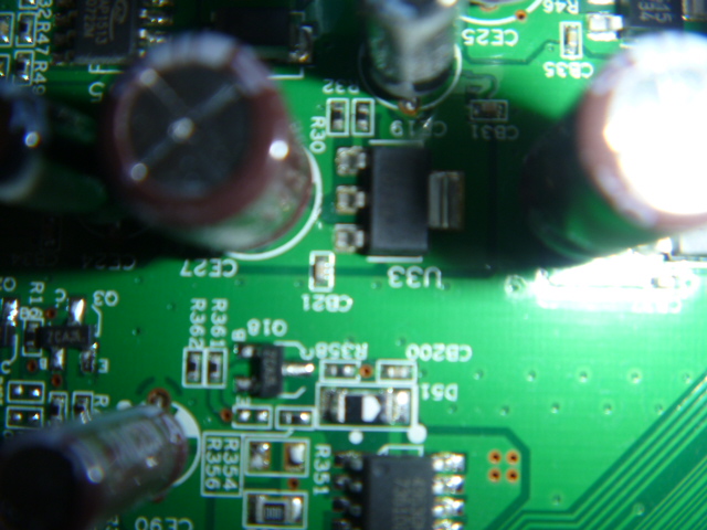

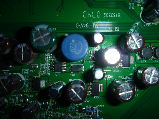

            I had Vizio VW42LHDTV1OA can turn on the logo Vizio form Orange to White color & back light on but no logo or blue screen
            Find VIZIO 3642-0102-0150 MAIN UNIT bad but still T/S maybe U33?
            http://cgi.ebay.com/VIZIO-3642-0102-...46087977104581
            • hoadle
              • Jul 2010
              • 174
              I found that thread about U33: https://www.badcaps.net/forum/showthr...&highlight=U33
              from Mr. kingofcoins
              U33: Top No # AMC1117 Where I can buy this parts?
              Bottom No # F0734J

                      because U33 need 3.3 V adj maybe (LM1117MP-3.3 or LM1117MP-3.3/NOPB/BKN)?
                      I will order both fixed and variable outputs LM1117MP-3.3 & LM1117MP-ADJ
                      • hoadle
                        • Jul 2010
                        • 174
                        I parts come in, I replace U33 finally is TV isworking
                        Thanks all you guy hepl me out
                            Thanks for PlainBill his give me parts # LM1117MP-ADJ
                            but I bought 10 LM1117MP-ADJ ($0.5083/each) & 0 LM1117MP-3.3 ($0.6847/each) at
                            https://avnetexpress.avnet.com/store...1&listIndex=-1
                            but LM1117MP-3.3 can't return that why I didn't buy, just bought LM1117MP-ADJ (fix)
                            I replace with LM1117MP-ADJ on U33
                            Now my TV working again

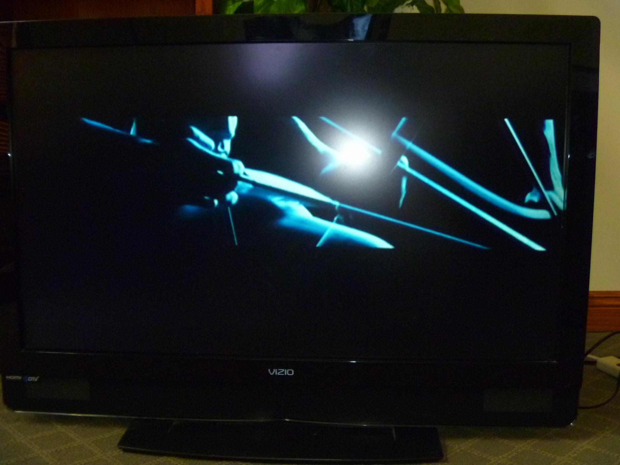

                              • hoadle
                                • Jul 2010
                                • 174
                                Here picture my Tv after done replace U33
