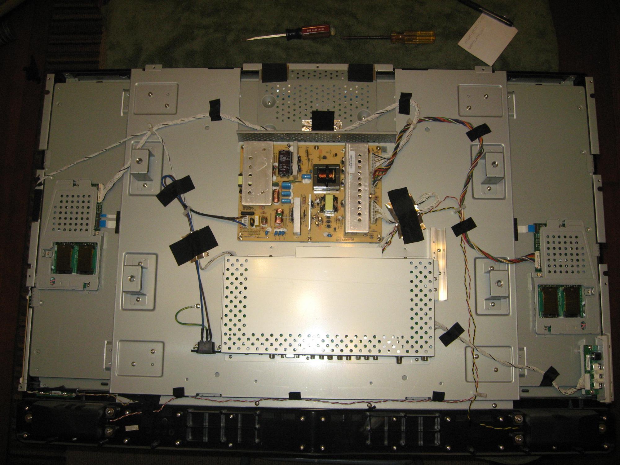

      Re: Vizio VX42L HDTV10A not coming out of standby
      Post a picture of this set open. In a second picture, one of the power board in question.
          Here's a couple pics:

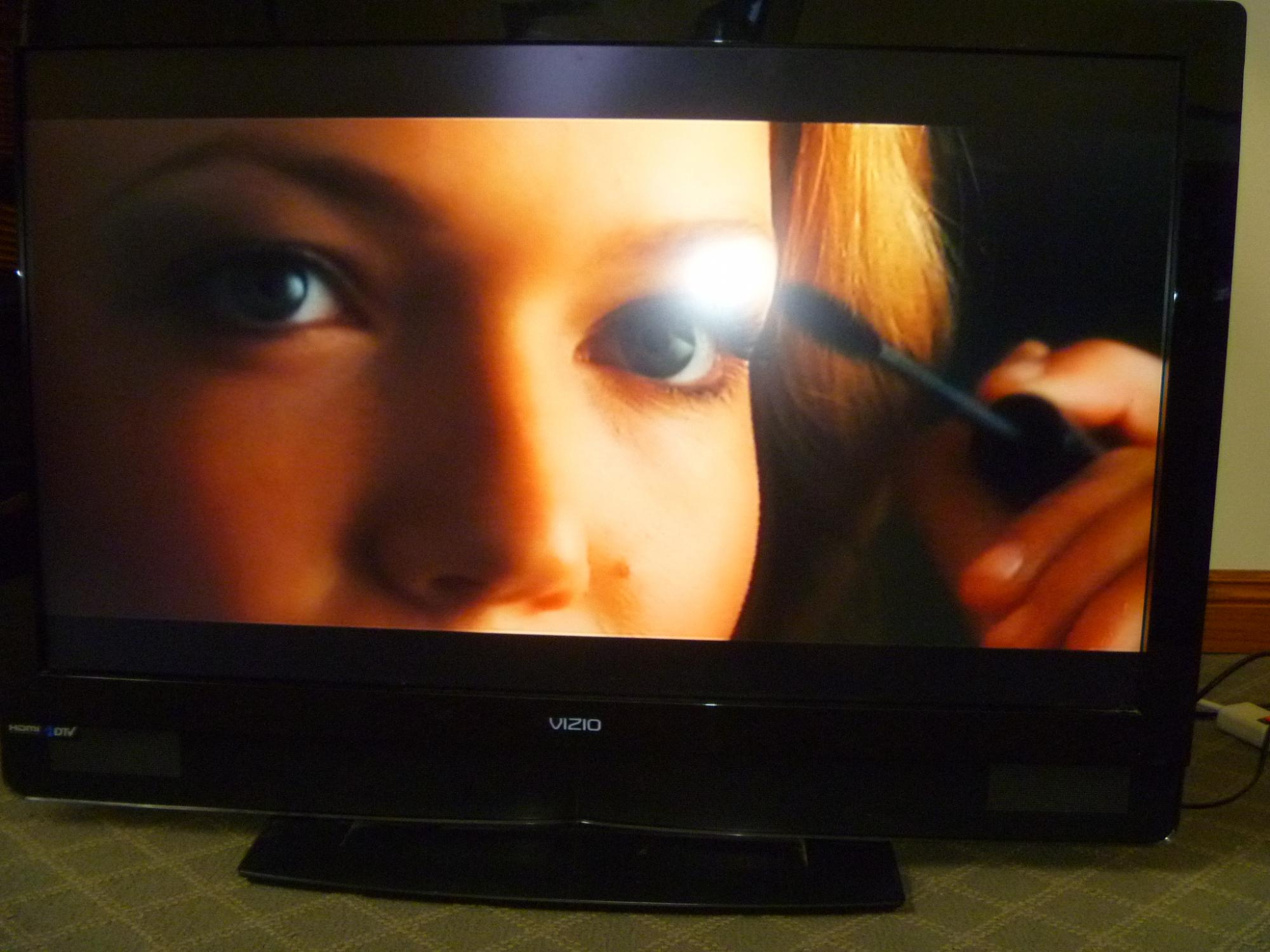

                        I parts come in, I replace U33 finally is TV isworking
                        Thanks all you guy hepl me out
                                Here picture my Tv after done replace U33
