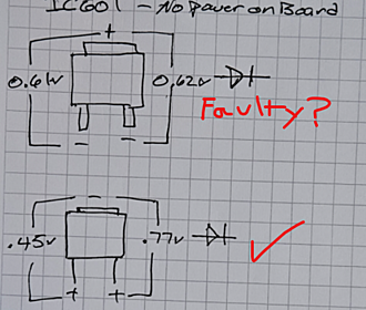

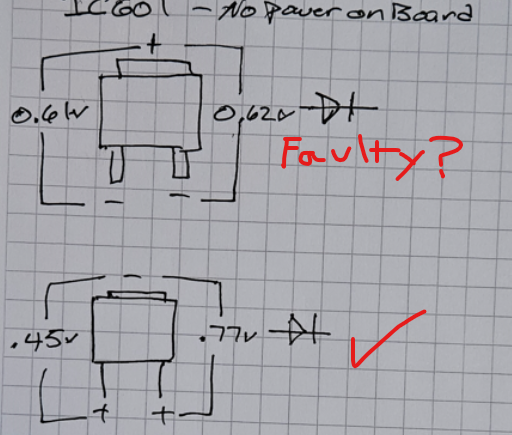

          When I tested the IC601, I get a reading with the "+" probe on the anode and "-" on the cathode. When I reverse the leads, shouldn't this now read "0" for a good diode? I get a reading >0 when I do this for both legs. Does this not mean the diode is faulty?
          I tested IC601, IC602 and IC204, To me all three seem to be faulty. Am I testing these wrong?

            IC601 stands for Integrated Circuit 601, why you tell about anode, cathode?

              I thought you said IC601 was a double diode. I have been treating and testing it as such.
              Refer to post#16 above.

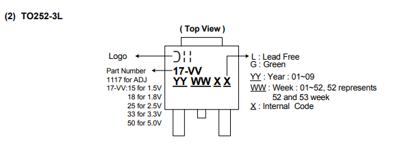

                After much searching, I finally found a datasheet on this component. This component is made by "Diodes Incorporated". This is a voltage regulator. A link to the data sheet is here.
                https://cdn.badcaps-static.com/pdfs/...fca50db500.pdf

                  There was no need, it's a common 1117, so what you have on tab of ic601? if 3,3v it's ok, then software issue..stop..
