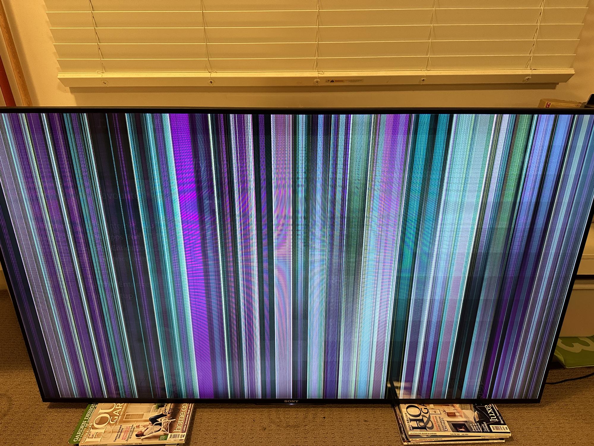

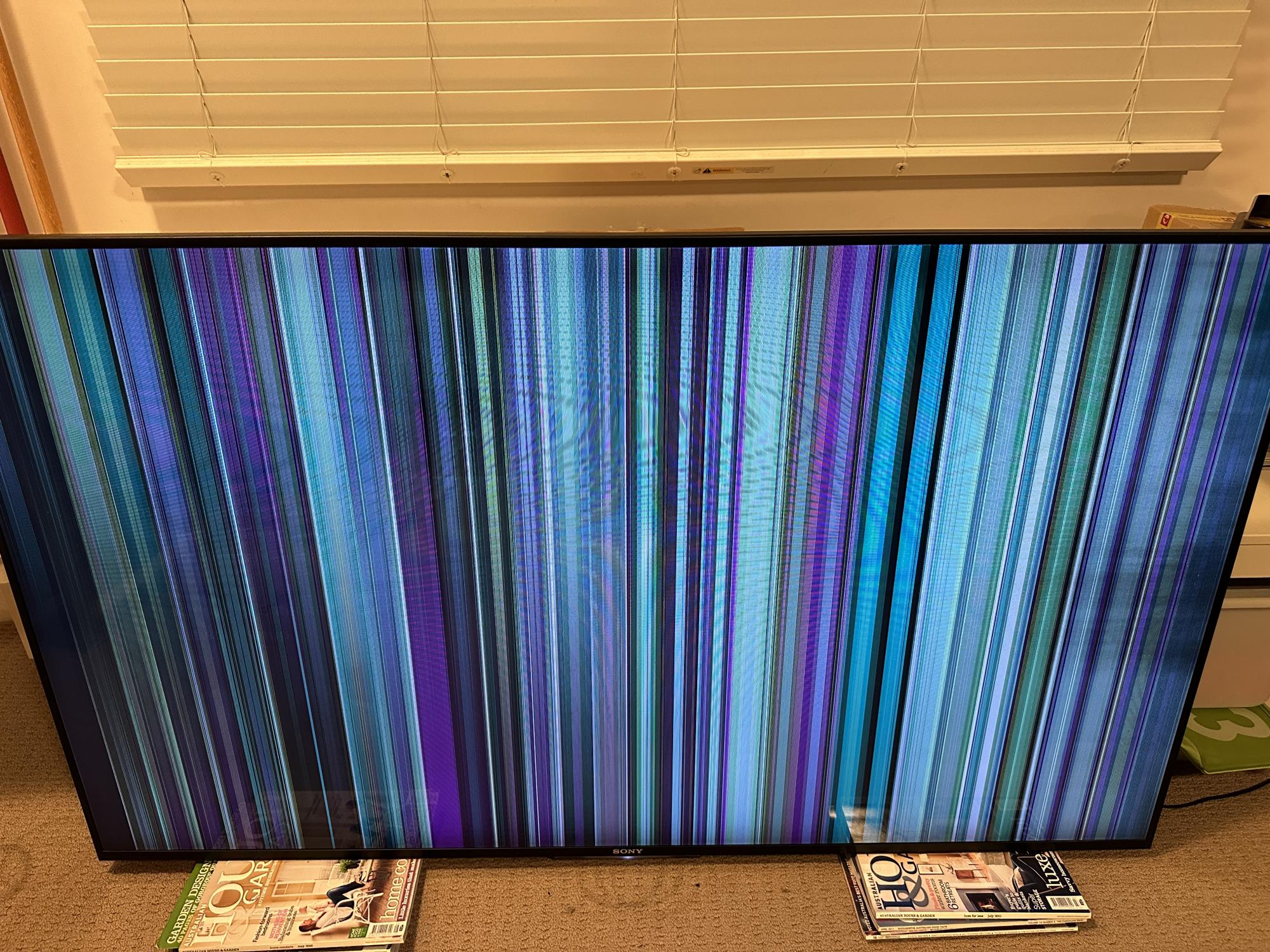

    Hi, hoping for some views on this one which I've not come across before. The TV generates an image that has 12 noticeable bands across it. The image is still there and accurate, but the colour (or perhaps the brightness) changes gradually across each band which creates a noticeable 'step change' at the edge of each band. Given it's a 4K TV with 2160 rows of pixels, I'm guessing the 12 bands correspond to 12 gate drivers of 180 rows each. If this guess is right, then perhaps:
    a) all the gate drivers are malfunctioning the same way (which seems unlikely), or
    b) the Tcon board is malfunctioning, or
    c) something else
    My guess is b), do folks agree? I'm not sure what Tcon malfunction would cause this effect. Maybe not enough power to the gate drivers so the image fades out as it works down the rows?? Which makes me wonder whether if the power board could be the culprit instead...?
    The other thing that might be relevant is that moving images suffer from some degree of retention. So that prior images seem to remain faintly in the background for a little while. Does this imply a problem with the clearing voltage from the Tcon? 15,000 hours on the panel (see service pic) seems a lot but what I read says it should last 40,000+ hours

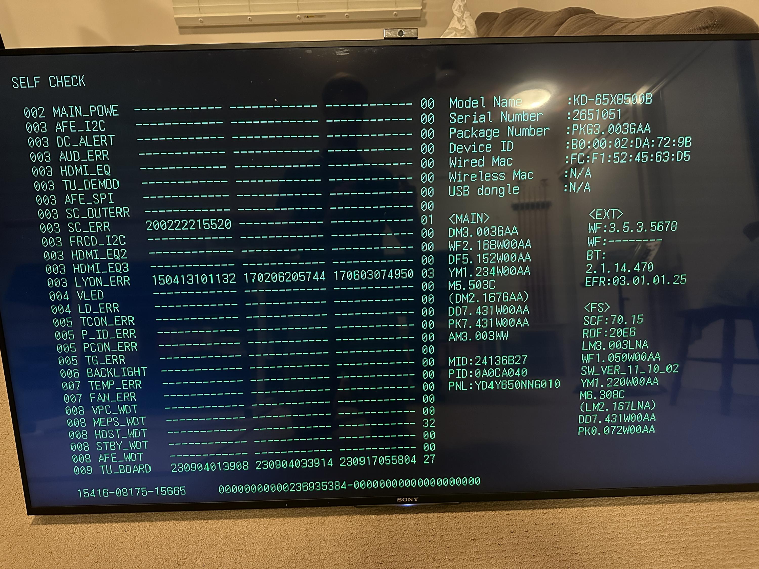

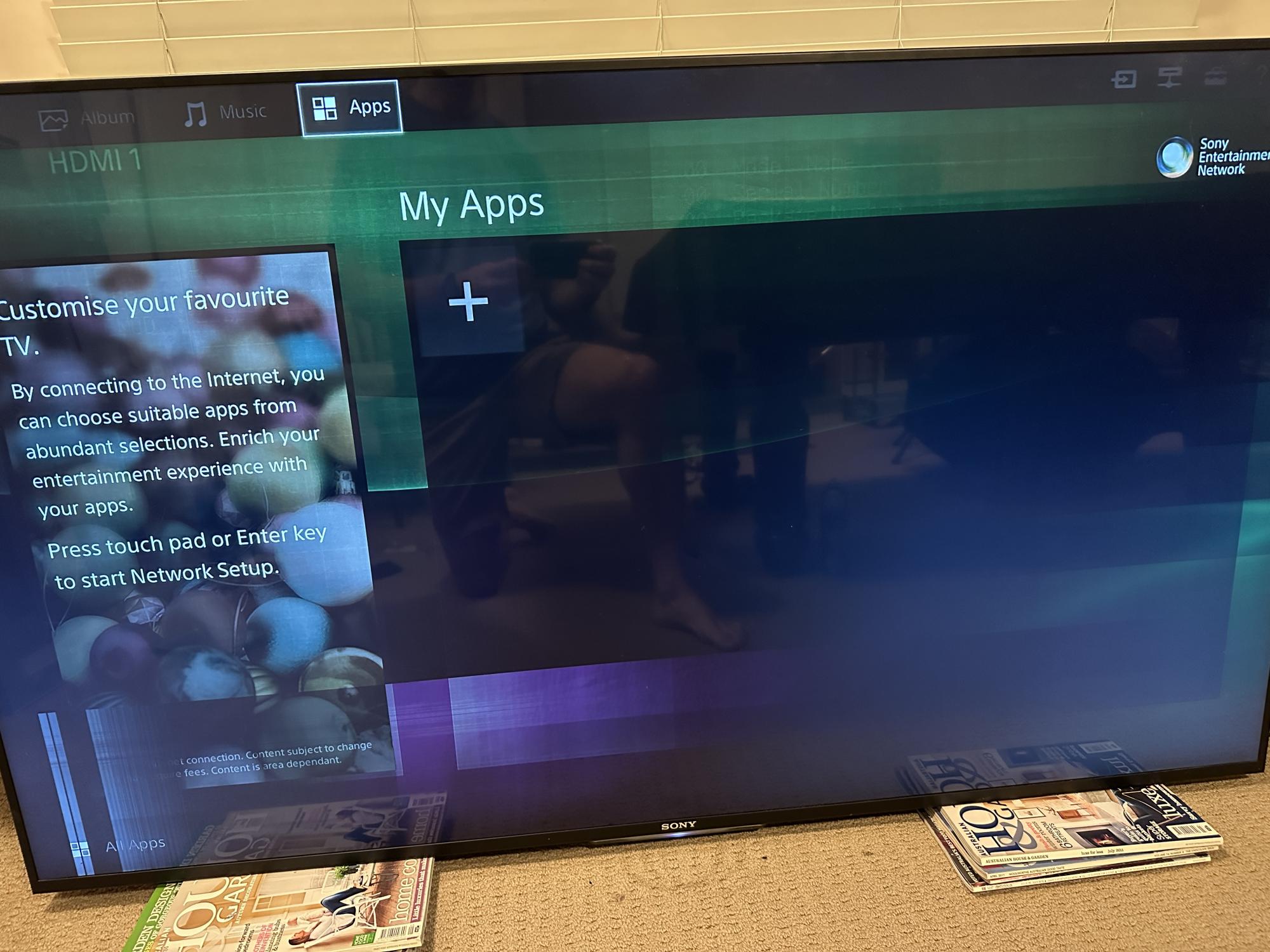

    I've also attached the TV's Service page. It doesn't seem to suffer from the banding, which is curious. It shows some recent errors associated with the TV tuner, but I doubt if that is related to the image issue, which is the problem I want to fix. There are also some very old errors (2015, 2017, 2020) which can most likely be ignored.

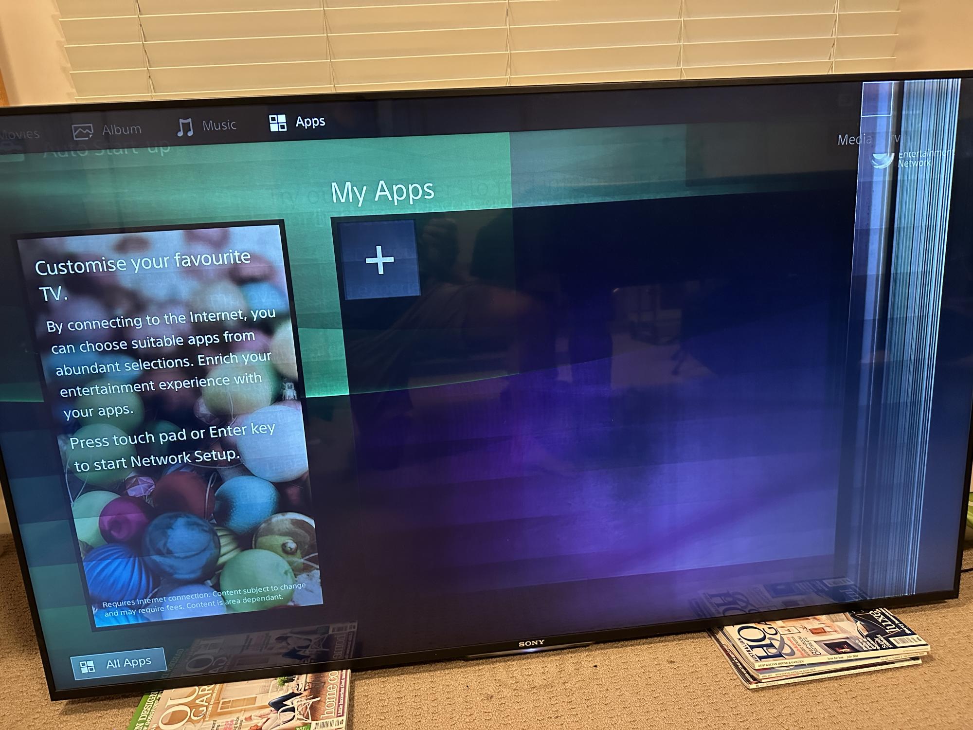

      Re: Sony KD-65x8500b - bad Tcon or panel?
      Here are the pics with each ribbon cable removed (only 1 disconnected at a time). Picture order is top right cable removed, top left removed, bottom left removed, bottom right removed. The banding is visible in pics 1,2; maybe not visible in pic3,4. The image retention is visible in pic3.
      Any help greatly appreciated!

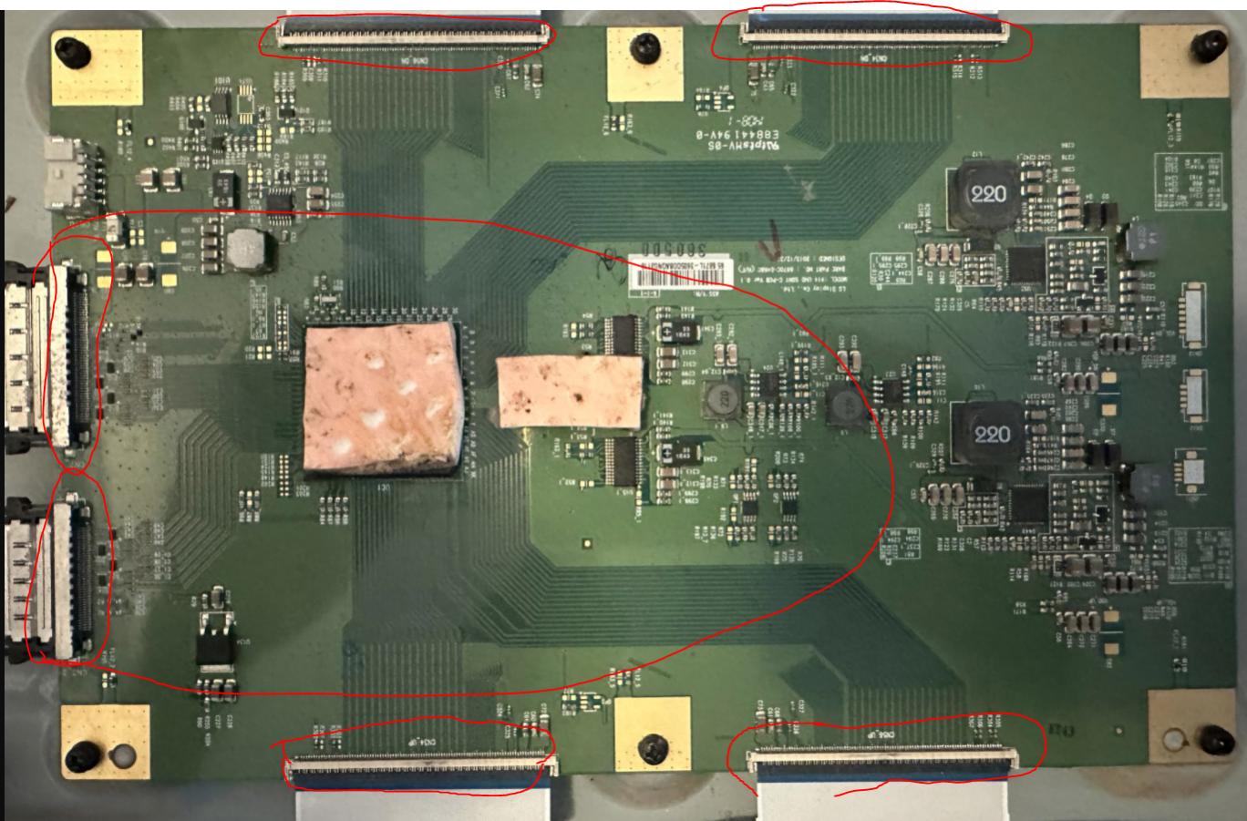

          TOP and BOTTOM?? never seen a tcon with both sides connected... photograph the rear of tv..

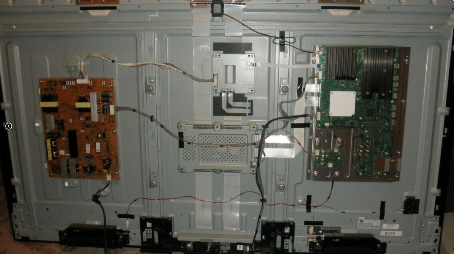

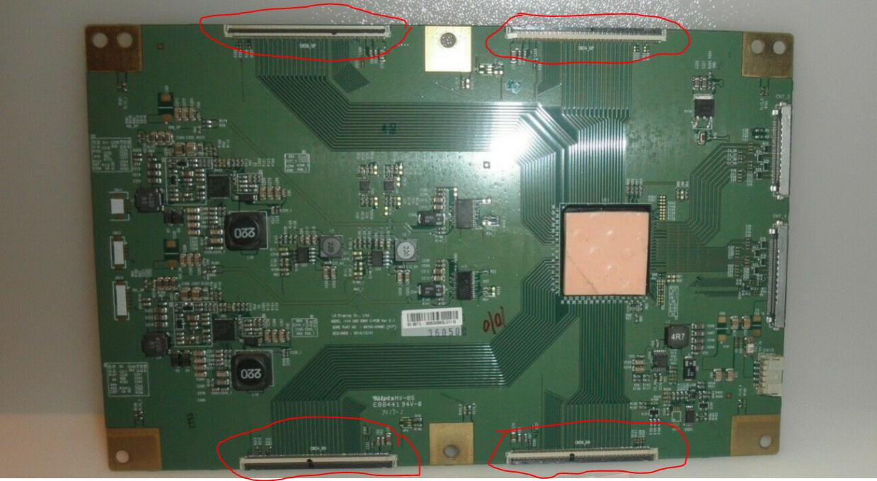

              Like this...
              • Davi.p
                Hobbist Tech
                • Sep 2009
                • 4536
                • Italy - Milan
                Damn.. how odd!... Is there any testpoint to photograph on tcon? For me it's bad tcon.. but wait..

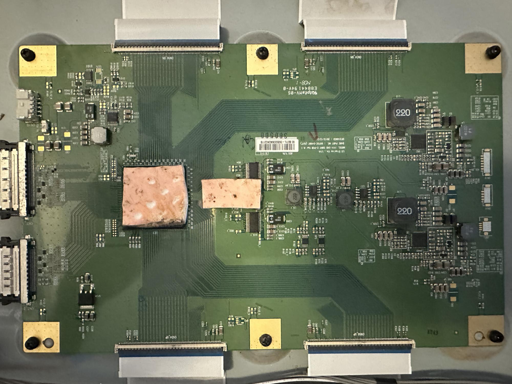

                  Yep, those pics are identical to the TV and Tcon board.
                  It's an LCD.
                  A second hand tcon is about $50 including postage (a big factor in getting boards to Oz). I was just wondering if folks could say for sure that bands for each gate driver meant a bad tcon…

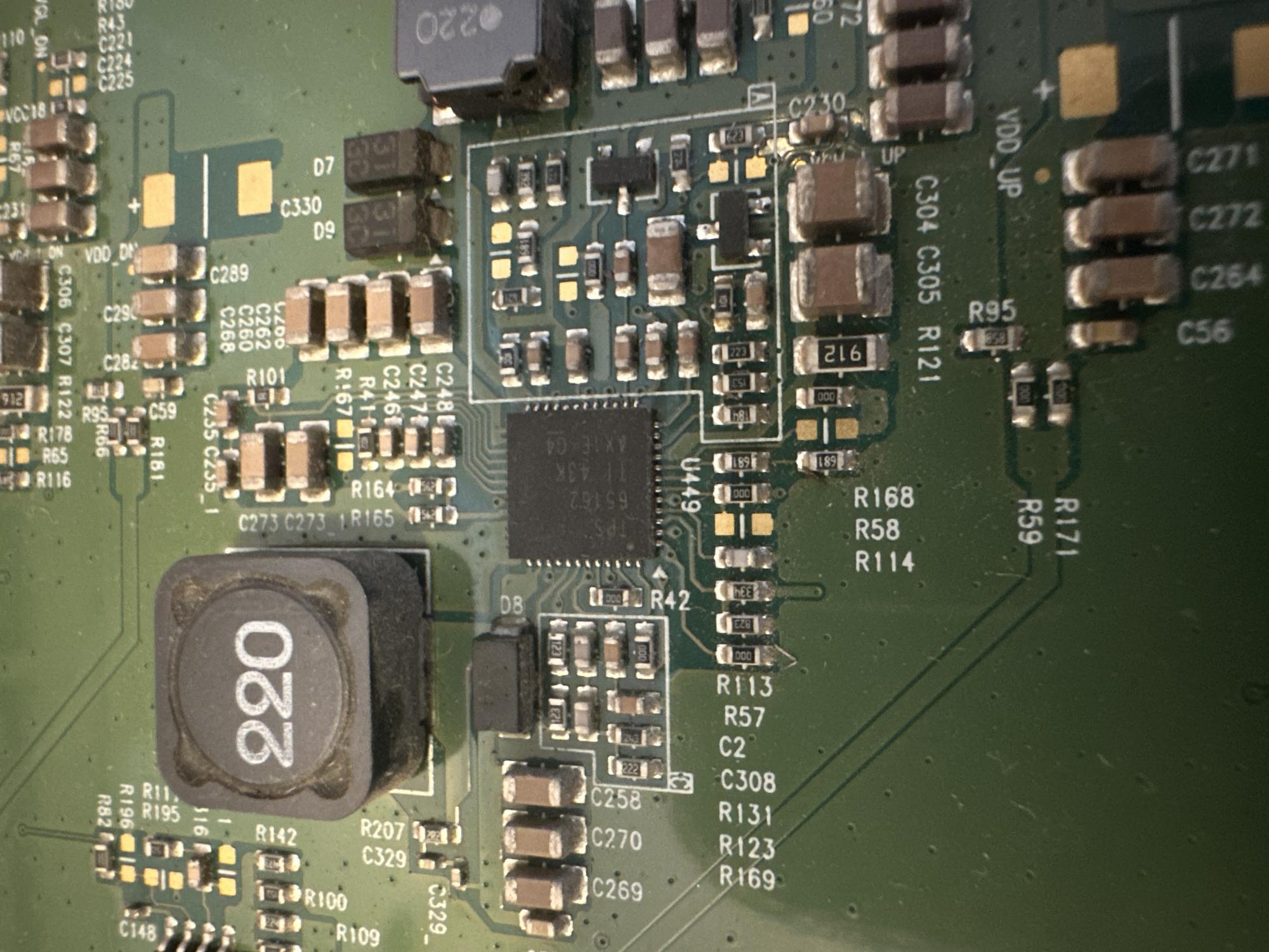

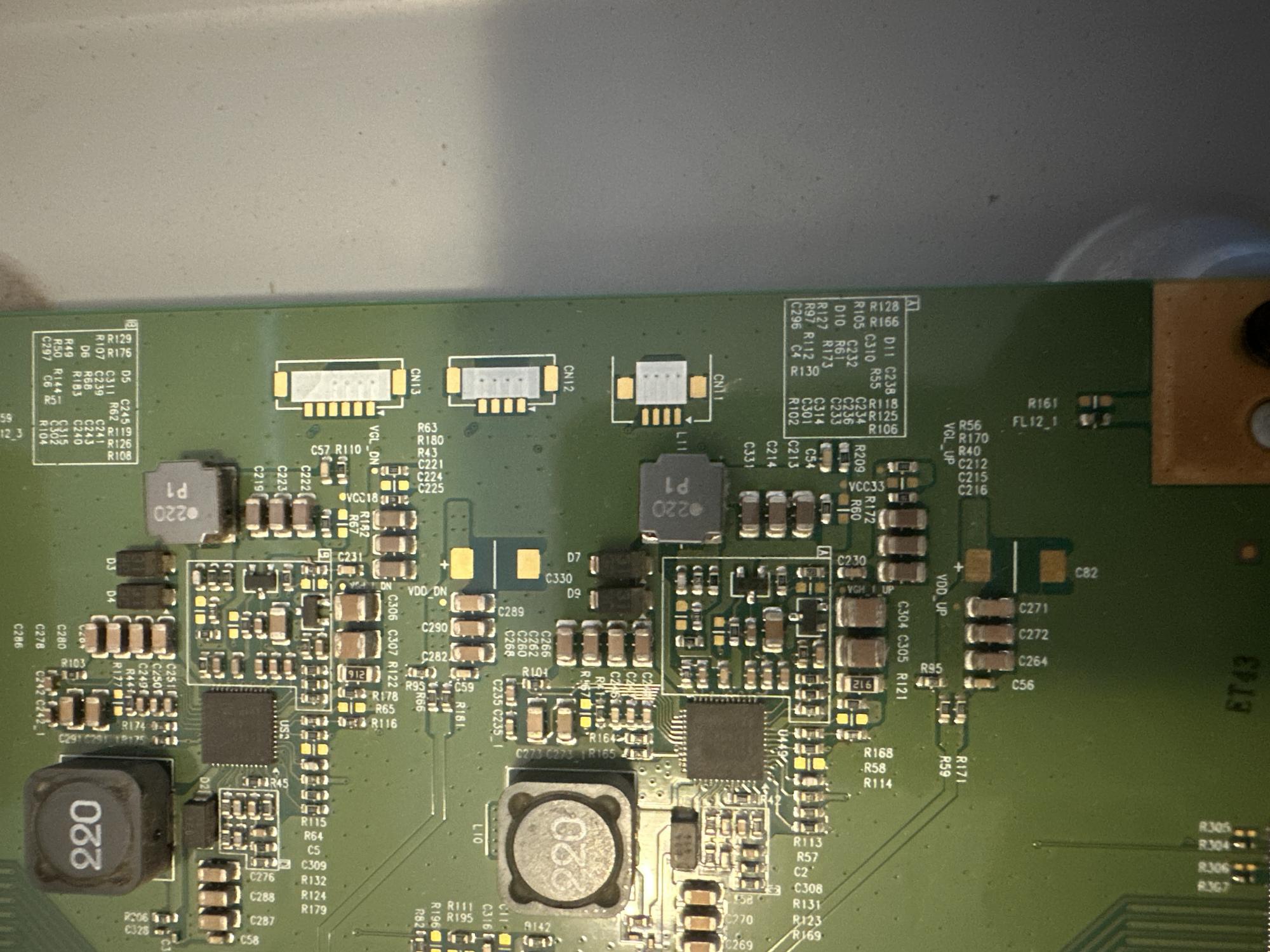

                      Thanks for helping, Here's a pic of the Tcon, and what could be test points. What tests did you have in mind? I have an AC/DC digital multimeter.
                      Also a pic of one the two square ICs. Hard to read, but maybe it says ‘TPS, 65162, TI 43K, AXIE G4'.
                          Check in ohm or replace every condenser on the Sup & Avin pins of TPS ic
                          this tcon design appears almost rubbish, few powerful for a very big tv..

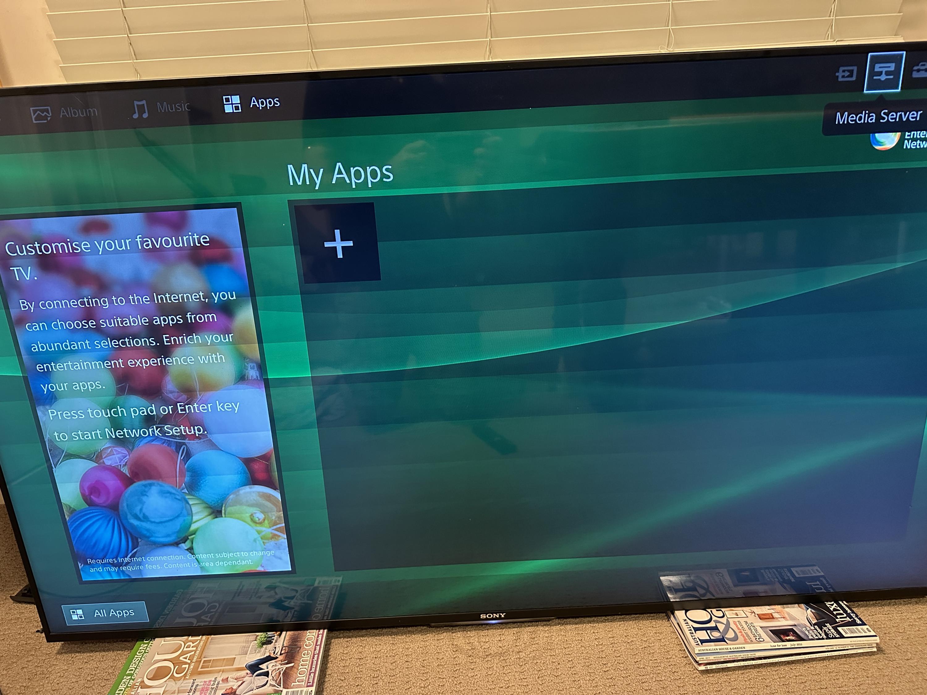

                              Whoa! Did a bit more fiddling today. Turned it on, same problem with the bands. But service screen didn’t have bands. Figured it *must* be the Tcon. Turned it off. Reconnected all 4 ribbon cables just in case. Turned it on. Seemed a bit darker. Odd. Turned it off. Redid all 4 cables. Turned it on. Tcon board now emitting a faint buzz, and the picture is fine! Buzz is coming from the end of the board near the TPS ICs.
                              So, definitely not the panel, yay! Now I’m wondering… is it the Tcon or the ribbon connection? Is a faint buzz from a Tcon normal? It’s loud enough to hear 1m away from the *front* of the TV (zero TV volume in a totally quiet room).
