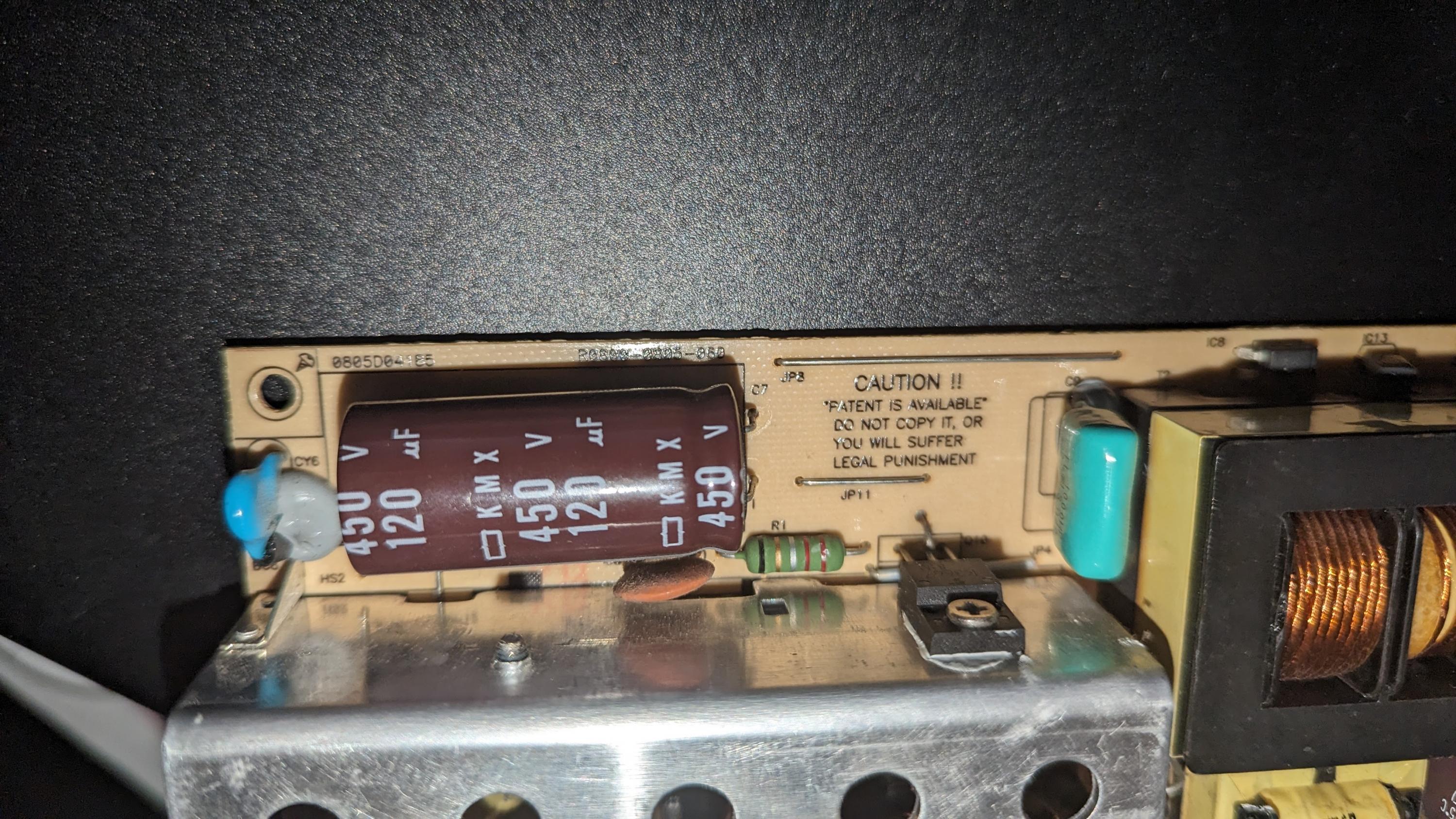

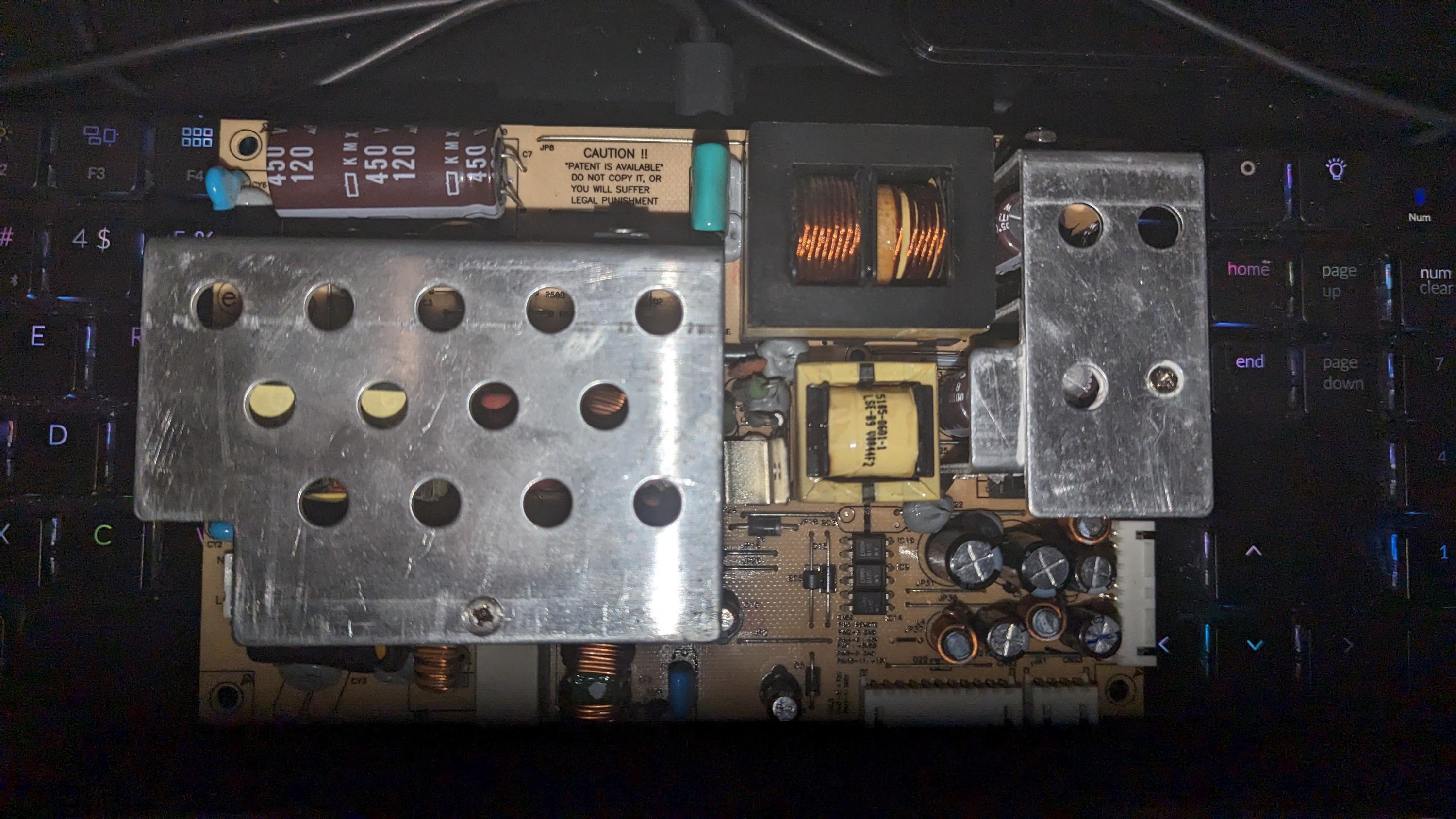

    1st Post here guys. I have a T280H that the cat knocked over. Everything else was fine before the fall, but now there is no display. There is a yellow LED that pulsates dim to bright.
    I have taken out the power supply, R0800-0805-060.
    I tried to test the pin outs 12v, see pic, which reads 0.00
    I do have 5v.
    Also, I noticed, the 2 metal heat sinks, checking the voltage between the 2 of them reads ~60v, but I am not sure if that is normal.
    I have looked at another post, similar PS, but a little different.
    Thanks in advance for any recommended suggestions.
    Craig

                          Re: Hannspree T280H not turning on
                          So, everything is reconnected, I tried to heat the board with hair dryer, and measured leads with meter.
                          12v = 0
                          5v = 0
                          5vsb = 5.2
                          The large brown cap, 450v 120uF reads 169v and does not change when power button is pressed.

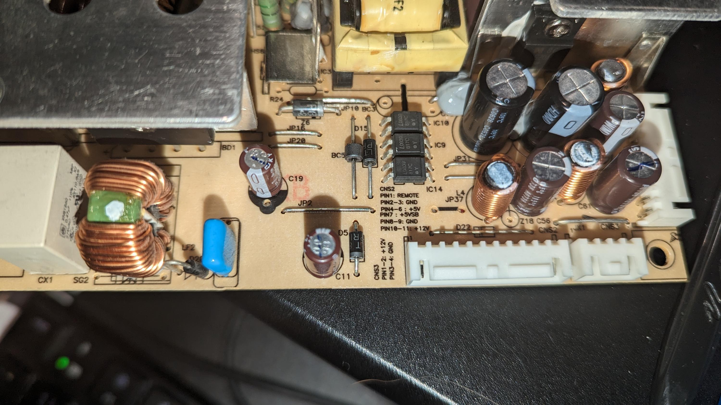

                            Most likely, your power supply is only in standby mode; in order for it to go into working mode, it needs to give a command - this must be done by the motherboard (3-5V) to turn on the “remote” pin.
                            • nomoresonys
                              • Jan 2013
                              • 12206
                              • U.S.
                              Ok, so try powerboard as stand alone, prolly easiest way is unhook cable from powerboard to mainboard on mainboard side, leave it off for test, trace wires back and jumper #1 remote pin and #7 5vSB pin, so you are jumping thru the UNPLUGGED connector. Then plug power cord in and see if you have those missing voltages and see if the backlights come on.
                                        I was able to jumper #1 & #7, I couldn't find a 1kohm resistor.
                                        No backlight, also no 12v or 5v.
